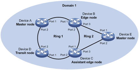

Basic concepts in RRPP
Figure 1 RRPP network diagram
RRPP domain
The interconnected devices with the same domain ID and control VLANs constitute an RRPP domain. The major elements of an RRPP domain includes the primary ring, subring, control VLAN, master node, transit node, primary port, secondary port, common port, and edge port.
As shown in Figure 1, Domain 1 is an RRPP domain, including two RRPP rings: Ring 1 and Ring 2. All the nodes on the two RRPP rings belong to the RRPP domain.

Node
Each device on an RRPP ring is a node. The role of a node is configurable. RRPP has the following node roles:
·     Master node—Each ring has one and only one master node. The master node initiates the polling mechanism and determines the operations to be performed after a change in topology.
·     Transit node—Transit nodes include all nodes except the master node on the primary ring and all nodes on subrings except the master nodes and the nodes where the primary ring intersects with the subrings. A transit node monitors the state of its directly-connected RRPP links and notifies the master node of the link state changes, if any. Based on the link state changes, the master node decides the operations to be performed.
·     Edge node—A special node residing on both the primary ring and a subring at the same time. An edge node serves as a master node or transit node on the primary ring and an edge node on the subring.
·     Assistant-edge node—A special node residing on both the primary ring and a subring at the same time. An assistant-edge node serves as a master node or transit node on the primary ring and an assistant-edge node on the subring. This node works in conjunction with the edge node to detect the integrity of the primary ring and perform loop guard.

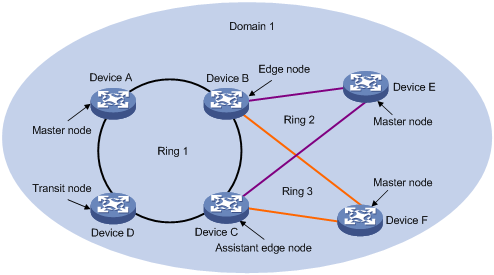

As shown in Figure 1, Ring 1 is the primary ring and Ring 2 is a subring. Device A is the master node of Ring 1, Device B, Device C and Device D are the transit nodes of Ring 1. Device E is the master node of Ring 2, Device B is the edge node of Ring 2, and Device C is the assistant-edge node of Ring 2.

Common port and edge port
The ports connecting the edge node and assistant-edge node to the primary ring are common ports. The ports connecting the edge node and assistant-edge node only to the subrings are edge ports.
As shown in Figure 1, Device B and Device C lie on Ring 1 and Ring 2. Device B's Port 1 and Port 2 and Device C's Port 1 and Port 2 access the primary ring, so they are common ports. Device B's Port 3 and Device C's Port 3 access only the subring, so they are edge ports.

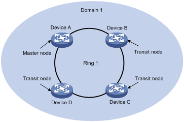

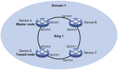

Single ring
As shown in Figure 2, only a single ring exists in the network topology. You only need to define an RRPP domain.
Figure 2 Schematic diagram for a single-ring network

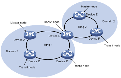

Tangent rings
As shown in Figure 3, two or more rings are in the network topology and only one common node exists between rings. You must define an RRPP domain for each ring.
Figure 3 Schematic diagram for a tangent-ring network

As shown in Figure 5, two or more rings are in the network topology and two similar common nodes exist between rings. You only need to define an RRPP domain, and configure one ring as the primary ring and the other rings as subrings.
Figure 5 Schematic diagram for a dual-homed-ring network

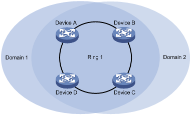

Single-ring load balancing
In a single-ring network, you can achieve load balancing by configuring multiple domains.
As shown in Figure 6, Ring 1 is configured as the primary ring of both Domain 1 and Domain 2. Domain 1 and Domain 2 are configured with different protected VLANs. In Domain 1, Device A is configured as the master node of Ring 1; in Domain 2, Device B is configured as the master node of Ring 1. Such configurations enable the ring to block different links based on VLANs and achieve single-ring load balancing.
Figure 6 Schematic diagram for a single-ring load balancing network

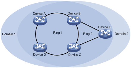

Intersecting-ring load balancing
In an intersecting-ring network, you can also achieve load balancing by configuring multiple domains.
As shown in Figure 7, Ring 1 is the primary ring and Ring 2 is the subring in both Domain 1 and Domain 2. Domain 1 and Domain 2 are configured with different protected VLANs. Device A is configured as the master node of Ring 1 in Domain 1; Device D is configured as the master node of Ring 1 in Domain 2. Device E is configured as the master node of Ring 2 in both Domain 1 and Domain 2. However, different ports on Device E are blocked in Domain 1 and Domain 2. With the configurations, you can enable traffic from different VLANs to travel over different paths in the subring and primary ring, achieving intersecting-ring load balancing.
Figure 7 Schematic diagram for an intersecting-ring load balancing network

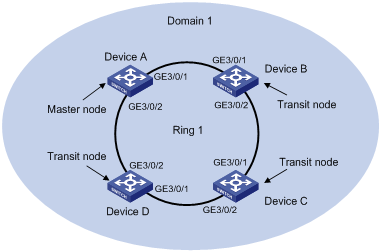

Single ring configuration example
Networking requirements
As shown in Figure 8,
·     Device A, Device B, Device C, and Device D form RRPP domain 1. Specify the primary control VLAN of RRPP domain 1 as VLAN 4092, and specify that RRPP domain 1 protects VLANs 1 through 30.
·     Device A, Device B, Device C and Device D form primary ring 1.
Specify Device A as the master node of primary ring 1, GigabitEthernet 3/0/1 as the primary port and GigabitEthernet 3/0/2 as the secondary port.
Specify Device B, Device C and Device D as the transit nodes of primary ring 1, their GigabitEthernet 3/0/1 as the primary port and GigabitEthernet 3/0/2 as the secondary port.
Figure 8 Network diagram
Configuration procedure

[DeviceB-GigabitEthernet3/0/1] quit
[DeviceB] interface gigabitethernet 3/0/2
[DeviceB-GigabitEthernet3/0/2] link-delay 0
[DeviceB-GigabitEthernet3/0/2] undo stp enable
[DeviceB-GigabitEthernet3/0/2] port link-type trunk
[DeviceB-GigabitEthernet3/0/2] port trunk permit vlan 1 to 30
[DeviceB-GigabitEthernet3/0/2] quit
# Create RRPP domain 1, configure VLAN 4092 as the primary control VLAN of RRPP domain 1, and configure the VLANs mapped to MSTI 1 as the protected VLANs of RRPP domain 1.
[DeviceB] rrpp domain 1
[DeviceB-rrpp-domain1] control-vlan 4092
[DeviceB-rrpp-domain1] protected-vlan reference-instance 1
# Configure Device B as the transit node of primary ring 1, with GigabitEthernet 3/0/1 as the primary port and GigabitEthernet 3/0/2 as the secondary port, and enable ring 1.
[DeviceB-rrpp-domain1] ring 1 node-mode transit primary-port gigabitethernet 3/0/1 secondary-port gigabitethernet 3/0/2 level 0
[DeviceB-rrpp-domain1] ring 1 enable
[DeviceB-rrpp-domain1] quit
# Enable RRPP.
[DeviceB] rrpp enable

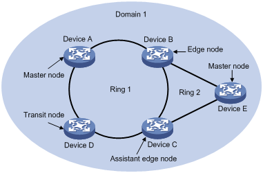

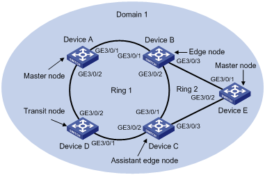

Intersecting ring configuration example
As shown in Figure 9,
·     Device A, Device B, Device C, Device D, and Device E form RRPP domain 1, VLAN 4092 is the primary control VLAN of RRPP domain 1, and RRPP domain 1 protects VLANs 1 through 30.
·     Device A, Device B, Device C and Device D form primary ring 1, and Device B, Device C and Device E form subring 2.
·     Device A is the master node of primary ring 1, with GigabitEthernet 3/0/1 as the primary port and GigabitEthernet 3/0/2 the secondary port.
·     Device E is the master node of subring 2, with GigabitEthernet 3/0/1 as the primary port and GigabitEthernet 3/0/2 the secondary port.
·     Device B is the transit node of primary ring 1 and the edge node of subring 2, and GigabitEthernet 3/0/3 is the edge port.
·     Device C is the transit node of primary ring 1 and the assistant-edge node of subring 1, and GigabitEthernet 3/0/3 is the edge port.
·     Device D is the transit node of primary ring 1, with GigabitEthernet 3/0/1 as the primary port and GigabitEthernet 3/0/2 the secondary port.
Figure 9 Network diagram

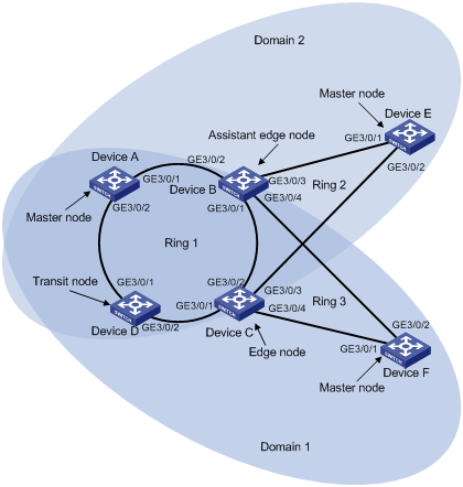

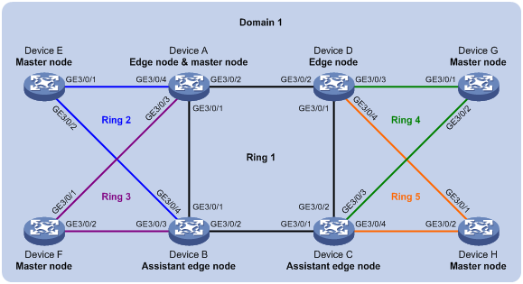

Dual homed rings configuration example
As shown in Figure 10,
·     Device A through Device H form RRPP domain 1. Specify the primary control VLAN of RRPP domain 1 as VLAN 4092, and specify that RRPP domain 1 protects VLANs 1 through 30.
·     Device A through Device D form primary ring 1. Device A, Device B, and Device E form subring 2. Device A, Device B, and Device F form subring 3. Device C, Device D, and Device G form subring 4. Device C, Device D, and Device H form subring 5.
Specify Device A as the master node of primary ring 1, GigabitEthernet 3/0/1 as the primary port and GigabitEthernet 3/0/2 as the secondary port. Specify Device E as the master node of subring 2, GigabitEthernet 3/0/1 as the primary port and GigabitEthernet 3/0/2 as the secondary port. Specify Device F as the master node of subring 3, GigabitEthernet 3/0/1 as the primary port and GigabitEthernet 3/0/2 as the secondary port. Specify Device G as the master node of subring 4, GigabitEthernet 3/0/1 as the primary port and GigabitEthernet 3/0/2 as the secondary port. Specify Device H as the master node of subring 5, GigabitEthernet 3/0/1 as the primary port and GigabitEthernet 3/0/2 as the secondary port.
Specify Device A as the edge node of the connected subrings, its GigabitEthernet 3/0/3 and GigabitEthernet 3/0/4 as the edge ports. Specify Device D as the transit node of the primary ring and edge node of the connected subrings, its GigabitEthernet 3/0/3 and GigabitEthernet 3/0/4 as the edge ports. Specify Device B and Device C as the transit node of the primary ring and assistant-edge nodes of the connected subrings, their GigabitEthernet 3/0/3 and GigabitEthernet 3/0/4 as the edge ports.
Configure the primary and secondary ports on the master nodes correctly to make sure other protocols still work correctly when data VLANs are denied by the secondary ports.
Figure 10 Network diagram
1.     Configure Device A:
# Create VLANs 1 through 30, map these VLANs to MSTI 1, and activate the MST region configuration.
<DeviceA> system-view
[DeviceA] vlan 1 to 30
[DeviceA] stp region-configuration
[DeviceA-mst-region] instance 1 vlan 1 to 30
[DeviceA-mst-region] active region-configuration
[DeviceA-mst-region] quit
# Set the physical state change suppression interval to 0 seconds on GigabitEthernet 3/0/1 through GigabitEthernet 3/0/4, disable the spanning tree feature, configure the four ports as trunk ports, and assign them to VLANs 1 through 30.
[DeviceA] interface gigabitEthernet3/0/1
[DeviceA-GigabitEthernet3/0/1] link-delay 0
[DeviceA-GigabitEthernet3/0/1] undo stp enable
[DeviceA-GigabitEthernet3/0/1] port link-type trunk
[DeviceA-GigabitEthernet3/0/1] port trunk permit vlan 1 to 30
[DeviceA-GigabitEthernet3/0/1] quit
[DeviceA] interface gigabitEthernet3/0/2
[DeviceA-GigabitEthernet3/0/2] link-delay 0
[DeviceA-GigabitEthernet3/0/2] undo stp enable
[DeviceA-GigabitEthernet3/0/2] port link-type trunk
[DeviceA-GigabitEthernet3/0/2] port trunk permit vlan 1 to 30
[DeviceA-GigabitEthernet3/0/2] quit
[DeviceA] interface gigabitEthernet3/0/3
[DeviceA-GigabitEthernet3/0/3] link-delay 0
[DeviceA-GigabitEthernet3/0/3] undo stp enable
[DeviceA-GigabitEthernet3/0/3] port link-type trunk
[DeviceA-GigabitEthernet3/0/3] port trunk permit vlan 1 to 30
[DeviceA-GigabitEthernet3/0/3] quit
[DeviceA] interface gigabitEthernet3/0/4
[DeviceA-GigabitEthernet3/0/4] link-delay 0
[DeviceA-GigabitEthernet3/0/4] undo stp enable
[DeviceA-GigabitEthernet3/0/4] port link-type trunk
[DeviceA-GigabitEthernet3/0/4] port trunk permit vlan 1 to 30
[DeviceA-GigabitEthernet3/0/4] quit
[DeviceA] rrpp domain 1
[DeviceA-rrpp-domain1] control-vlan 4092
[DeviceA-rrpp-domain1] protected-vlan reference-instance 1
# Configure Device A as the master node of primary ring 1, with GigabitEthernet 3/0/1 as the primary port and GigabitEthernet 3/0/2 as the secondary port, and enable ring 1.
[DeviceA-rrpp-domain1] ring 1 node-mode master primary-port gigabitEthernet3/0/1 secondary-port gigabitEthernet3/0/2 level 0
[DeviceA-rrpp-domain1] ring 1 enable
# Configure Device A as the edge node of subring 2, with GigabitEthernet 3/0/4 as the edge port, and enable subring 2.
[DeviceA-rrpp-domain1] ring 2 node-mode edge edge-port gigabitEthernet3/0/4
[DeviceA-rrpp-domain1] ring 2 enable
# Configure Device A as the edge node of subring 3, with GigabitEthernet 3/0/3 as the edge port, and enable subring 3.
[DeviceA-rrpp-domain1] ring 3 node-mode edge edge-port gigabitEthernet3/0/3
[DeviceA-rrpp-domain1] ring 3 enable
[DeviceA-rrpp-domain1] quit
# Enable RRPP.
[DeviceA] rrpp enable
2.     Configure Device B:
<DeviceB> system-view
[DeviceB] vlan 1 to 30
[DeviceB] stp region-configuration
[DeviceB-mst-region] instance 1 vlan 1 to 30
[DeviceB-mst-region] active region-configuration
[DeviceB-mst-region] quit
[DeviceB] interface gigabitEthernet3/0/1
[DeviceB-GigabitEthernet3/0/1] link-delay 0
[DeviceB-GigabitEthernet3/0/1] undo stp enable
[DeviceB-GigabitEthernet3/0/1] port link-type trunk
[DeviceB-GigabitEthernet3/0/1] port trunk permit vlan 1 to 30
[DeviceB] interface gigabitEthernet3/0/2
[DeviceB] interface gigabitEthernet3/0/3
[DeviceB-GigabitEthernet3/0/3] link-delay 0
[DeviceB-GigabitEthernet3/0/3] undo stp enable
[DeviceB-GigabitEthernet3/0/3] port link-type trunk
[DeviceB-GigabitEthernet3/0/3] port trunk permit vlan 1 to 30
[DeviceB-GigabitEthernet3/0/3] quit
[DeviceB] interface gigabitEthernet3/0/4
[DeviceB-GigabitEthernet3/0/4] link-delay 0
[DeviceB-GigabitEthernet3/0/4] undo stp enable
[DeviceB-GigabitEthernet3/0/4] port link-type trunk
[DeviceB-GigabitEthernet3/0/4] port trunk permit vlan 1 to 30
[DeviceB-GigabitEthernet3/0/4] quit
[DeviceB-rrpp-domain1] ring 1 node-mode transit primary-port gigabitEthernet3/0/1 secondary-port gigabitEthernet3/0/2 level 0
# Configure Device B as the assistant-edge node of subring 2, with GigabitEthernet 3/0/4 as the edge port, and enable subring 2.
[DeviceB-rrpp-domain1] ring 2 node-mode assistant-edge edge-port gigabitEthernet3/0/4
[DeviceB-rrpp-domain1] ring 2 enable
# Configure Device B as the assistant-edge node of subring 3, with GigabitEthernet 3/0/3 as the edge port, and enable subring 3.
[DeviceB-rrpp-domain1] ring 3 node-mode assistant-edge edge-port gigabitEthernet3/0/3
[DeviceB-rrpp-domain1] ring 3 enable
# Enable RRPP.
3.     Configure Device C:
<DeviceC> system-view
[DeviceC] vlan 1 to 30
[DeviceC] stp region-configuration
[DeviceC-mst-region] instance 1 vlan 1 to 30
[DeviceC-mst-region] active region-configuration
[DeviceC-mst-region] quit
[DeviceC] interface gigabitEthernet3/0/1
[DeviceC-GigabitEthernet3/0/1] link-delay 0
[DeviceC-GigabitEthernet3/0/1] undo stp enable
[DeviceC-GigabitEthernet3/0/1] port link-type trunk
[DeviceC-GigabitEthernet3/0/1] port trunk permit vlan 1 to 30
[DeviceC-GigabitEthernet3/0/1] quit
[DeviceC] interface gigabitEthernet3/0/2
[DeviceC-GigabitEthernet3/0/2] link-delay 0
[DeviceC-GigabitEthernet3/0/2] undo stp enable
[DeviceC-GigabitEthernet3/0/2] port link-type trunk
[DeviceC-GigabitEthernet3/0/2] port trunk permit vlan 1 to 30
[DeviceC-GigabitEthernet3/0/2] quit
[DeviceC] interface gigabitEthernet3/0/3
[DeviceC-GigabitEthernet3/0/3] link-delay 0
[DeviceC-GigabitEthernet3/0/3] undo stp enable
[DeviceC-GigabitEthernet3/0/3] port link-type trunk
[DeviceC-GigabitEthernet3/0/3] port trunk permit vlan 1 to 30
[DeviceC-GigabitEthernet3/0/3] quit
[DeviceC] interface gigabitEthernet3/0/4
[DeviceC-GigabitEthernet3/0/4] link-delay 0
[DeviceC-GigabitEthernet3/0/4] undo stp enable
[DeviceC-GigabitEthernet3/0/4] port link-type trunk
[DeviceC-GigabitEthernet3/0/4] port trunk permit vlan 1 to 30
[DeviceC-GigabitEthernet3/0/4] quit
[DeviceC] rrpp domain 1
[DeviceC-rrpp-domain1] control-vlan 4092
[DeviceC-rrpp-domain1] protected-vlan reference-instance 1
# Configure Device C as the transit node of primary ring 1, with GigabitEthernet 3/0/1 as the primary port and GigabitEthernet 3/0/2 as the secondary port, and enable ring 1.
[DeviceC-rrpp-domain1] ring 1 node-mode transit primary-port gigabitEthernet3/0/1 secondary-port gigabitEthernet3/0/2 level 0
[DeviceC-rrpp-domain1] ring 1 enable
# Configure Device C as the assistant-edge node of subring 4, with GigabitEthernet 3/0/3 as the edge port, and enable subring 4.
[DeviceC-rrpp-domain1] ring 4 node-mode assistant-edge edge-port gigabitEthernet3/0/3
[DeviceC-rrpp-domain1] ring 4 enable
# Configure Device C as the assistant-edge node of subring 5, with GigabitEthernet 3/0/4 as the edge port, and enable subring 5.
[DeviceC-rrpp-domain1] ring 5 node-mode assistant-edge edge-port gigabitEthernet3/0/4
[DeviceC-rrpp-domain1] ring 5 enable
[DeviceC-rrpp-domain1] quit
# Enable RRPP.
[DeviceC] rrpp enable
4.     Configure Device D:
<DeviceD> system-view
[DeviceD] vlan 1 to 30
[DeviceD] stp region-configuration
[DeviceD-mst-region] instance 1 vlan 1 to 30
[DeviceD-mst-region] active region-configuration
[DeviceD-mst-region] quit
[DeviceD] interface gigabitEthernet3/0/1
[DeviceD-GigabitEthernet3/0/1] link-delay 0
[DeviceD-GigabitEthernet3/0/1] undo stp enable
[DeviceD-GigabitEthernet3/0/1] port link-type trunk
[DeviceD-GigabitEthernet3/0/1] port trunk permit vlan 1 to 30
[DeviceD-GigabitEthernet3/0/1] quit
[DeviceD] interface gigabitEthernet3/0/2
[DeviceD-GigabitEthernet3/0/2] link-delay 0
[DeviceD-GigabitEthernet3/0/2] undo stp enable
[DeviceD-GigabitEthernet3/0/2] port link-type trunk
[DeviceD-GigabitEthernet3/0/2] port trunk permit vlan 1 to 30
[DeviceD-GigabitEthernet3/0/2] quit
[DeviceD] interface gigabitEthernet3/0/3
[DeviceD-GigabitEthernet3/0/3] link-delay 0
[DeviceD-GigabitEthernet3/0/3] undo stp enable
[DeviceD-GigabitEthernet3/0/3] port link-type trunk
[DeviceD-GigabitEthernet3/0/3] port trunk permit vlan 1 to 30
[DeviceD-GigabitEthernet3/0/3] quit
[DeviceD] interface gigabitEthernet3/0/4
[DeviceD-GigabitEthernet3/0/4] link-delay 0
[DeviceD-GigabitEthernet3/0/4] undo stp enable
[DeviceD-GigabitEthernet3/0/4] port link-type trunk
[DeviceD-GigabitEthernet3/0/4] port trunk permit vlan 1 to 30
[DeviceD-GigabitEthernet3/0/4] quit
[DeviceD] rrpp domain 1
[DeviceD-rrpp-domain1] control-vlan 4092
[DeviceD-rrpp-domain1] protected-vlan reference-instance 1
# Configure Device D as the transit node of primary ring 1, with GigabitEthernet 3/0/1 as the primary port and GigabitEthernet 3/0/2 as the secondary port, and enable ring 1.
[DeviceD-rrpp-domain1] ring 1 node-mode transit primary-port gigabitEthernet3/0/1 secondary-port gigabitEthernet3/0/2 level 0
[DeviceD-rrpp-domain1] ring 1 enable
# Configure Device D as the edge node of subring 4, with GigabitEthernet 3/0/3 as the edge port, and enable subring 4.
[DeviceD-rrpp-domain1] ring 4 node-mode edge edge-port gigabitEthernet3/0/3
[DeviceD-rrpp-domain1] ring 4 enable
# Configure Device D as the edge node of subring 5, with GigabitEthernet 3/0/4 as the edge port, and enable subring 5.
[DeviceD-rrpp-domain1] ring 5 node-mode edge edge-port gigabitEthernet3/0/4
[DeviceD-rrpp-domain1] ring 5 enable
[DeviceD-rrpp-domain1] quit
# Enable RRPP.
[DeviceD] rrpp enable
5.     Configure Device E:
<DeviceE> system-view
[DeviceE] vlan 1 to 30
[DeviceE] stp region-configuration
[DeviceE-mst-region] instance 1 vlan 1 to 30
[DeviceE-mst-region] active region-configuration
[DeviceE-mst-region] quit
# Set the physical state change suppression interval to 0 seconds on GigabitEthernet 3/0/1 and GigabitEthernet 3/0/2, disable the spanning tree feature, configure the two ports as trunk ports, and assign them to VLANs 1 through 30.
[DeviceE] interface gigabitEthernet3/0/1
[DeviceE-GigabitEthernet3/0/1] link-delay 0
[DeviceE-GigabitEthernet3/0/1] undo stp enable
[DeviceE-GigabitEthernet3/0/1] port link-type trunk
[DeviceE-GigabitEthernet3/0/1] port trunk permit vlan 1 to 30
[DeviceE-GigabitEthernet3/0/1] quit
[DeviceE] interface gigabitEthernet3/0/2
[DeviceE-GigabitEthernet3/0/2] link-delay 0
[DeviceE-GigabitEthernet3/0/2] undo stp enable
[DeviceE-GigabitEthernet3/0/2] port link-type trunk
[DeviceE-GigabitEthernet3/0/2] port trunk permit vlan 1 to 30
[DeviceE-GigabitEthernet3/0/2] quit
[DeviceE] rrpp domain 1
[DeviceE-rrpp-domain1] control-vlan 4092
[DeviceE-rrpp-domain1] protected-vlan reference-instance 1
# Configure Device E as the master node of subring 2, with GigabitEthernet 3/0/1 as the primary port and GigabitEthernet 3/0/2 as the secondary port, and enable subring 2.
[DeviceE-rrpp-domain1] ring 2 node-mode master primary-port gigabitEthernet3/0/1 secondary-port gigabitEthernet3/0/2 level 1
[DeviceE-rrpp-domain1] ring 2 enable
[DeviceE-rrpp-domain1] quit
# Enable RRPP.
[DeviceE] rrpp enable
6.     Configure Device F:
<DeviceF> system-view
[DeviceF] vlan 1 to 30
[DeviceF] stp region-configuration
[DeviceF-mst-region] instance 1 vlan 1 to 30
[DeviceF-mst-region] active region-configuration
[DeviceF-mst-region] quit
[DeviceF] interface gigabitEthernet3/0/1
[DeviceF-GigabitEthernet3/0/1] link-delay 0
[DeviceF-GigabitEthernet3/0/1] undo stp enable
[DeviceF-GigabitEthernet3/0/1] port link-type trunk
[DeviceF-GigabitEthernet3/0/1] port trunk permit vlan 1 to 30
[DeviceF-GigabitEthernet3/0/1] quit
[DeviceF] interface gigabitEthernet3/0/2
[DeviceF-GigabitEthernet3/0/2] link-delay 0
[DeviceF-GigabitEthernet3/0/2] undo stp enable
[DeviceF-GigabitEthernet3/0/2] port link-type trunk
[DeviceF-GigabitEthernet3/0/2] port trunk permit vlan 1 to 30
[DeviceF-GigabitEthernet3/0/2] quit
[DeviceF] rrpp domain 1
[DeviceF-rrpp-domain1] control-vlan 4092
[DeviceF-rrpp-domain1] protected-vlan reference-instance 1
# Configure Device F as the master node of subring 3, with GigabitEthernet 3/0/1 as the primary port and GigabitEthernet 3/0/2 as the secondary port, and enable subring 3.
[DeviceF-rrpp-domain1] ring 3 node-mode master primary-port gigabitEthernet3/0/1 secondary-port gigabitEthernet3/0/2 level 1
[DeviceF-rrpp-domain1] ring 3 enable
[DeviceF-rrpp-domain1] quit
# Enable RRPP.
[DeviceF] rrpp enable
7.     Configure Device G:
<DeviceG> system-view
[DeviceG] vlan 1 to 30
[DeviceG] stp region-configuration
[DeviceG-mst-region] instance 1 vlan 1 to 30
[DeviceG-mst-region] active region-configuration
[DeviceG-mst-region] quit
[DeviceG] interface gigabitEthernet3/0/1
[DeviceG-GigabitEthernet3/0/1] link-delay 0
[DeviceG-GigabitEthernet3/0/1] undo stp enable
[DeviceG-GigabitEthernet3/0/1] port link-type trunk
[DeviceG-GigabitEthernet3/0/1] port trunk permit vlan 1 to 30
[DeviceG-GigabitEthernet3/0/1] quit
[DeviceG] interface gigabitEthernet3/0/2
[DeviceG-GigabitEthernet3/0/2] link-delay 0
[DeviceG-GigabitEthernet3/0/2] undo stp enable
[DeviceG-GigabitEthernet3/0/2] port link-type trunk
[DeviceG-GigabitEthernet3/0/2] port trunk permit vlan 1 to 30
[DeviceG-GigabitEthernet3/0/2] quit
[DeviceG] rrpp domain 1
[DeviceG-rrpp-domain1] control-vlan 4092
[DeviceG-rrpp-domain1] protected-vlan reference-instance 1
# Configure Device G as the master node of subring 4, with GigabitEthernet 3/0/1 as the primary port and GigabitEthernet 3/0/2 as the secondary port, and enable subring 4.
[DeviceG-rrpp-domain1] ring 4 node-mode master primary-port gigabitEthernet3/0/1 secondary-port gigabitEthernet3/0/2 level 1
[DeviceG-rrpp-domain1] ring 4 enable
[DeviceG-rrpp-domain1] quit
# Enable RRPP.
[DeviceG] rrpp enable
8.     Configure Device H:
<DeviceH> system-view
[DeviceH] vlan 1 to 30
[DeviceH] stp region-configuration
[DeviceH-mst-region] instance 1 vlan 1 to 30
[DeviceH-mst-region] active region-configuration
[DeviceH-mst-region] quit
[DeviceH] interface gigabitEthernet3/0/1
[DeviceH-GigabitEthernet3/0/1] link-delay 0
[DeviceH-GigabitEthernet3/0/1] undo stp enable
[DeviceH-GigabitEthernet3/0/1] port link-type trunk
[DeviceH-GigabitEthernet3/0/1] port trunk permit vlan 1 to 30
[DeviceH-GigabitEthernet3/0/1] quit
[DeviceH] interface gigabitEthernet3/0/2
[DeviceH-GigabitEthernet3/0/2] link-delay 0
[DeviceH-GigabitEthernet3/0/2] undo stp enable
[DeviceH-GigabitEthernet3/0/2] port link-type trunk
[DeviceH-GigabitEthernet3/0/2] port trunk permit vlan 1 to 30
[DeviceH-GigabitEthernet3/0/2] quit
[DeviceH] rrpp domain 1
[DeviceH-rrpp-domain1] control-vlan 4092
[DeviceH-rrpp-domain1] protected-vlan reference-instance 1
# Configure Device H as the master node of subring 5, with GigabitEthernet 3/0/1 as the primary port and GigabitEthernet 3/0/2 as the secondary port, and enable subring 5.
[DeviceH-rrpp-domain1] ring 5 node-mode master primary-port gigabitEthernet3/0/1 secondary-port gigabitEthernet3/0/2 level 1
[DeviceH-rrpp-domain1] ring 5 enable
[DeviceH-rrpp-domain1] quit
# Enable RRPP.
[DeviceH] rrpp enable
9.     Verify the configuration.
Use the display command to view RRPP configuration and operational information on each device.
Intersecting-ring load balancing configuration example
As shown in Figure 11,
·     Device A, Device B, Device C, Device D, and Device F form RRPP domain 1, and VLAN 100 is the primary control VLAN of the RRPP domain. Device A is the master node of the primary ring, Ring 1; Device D is the transit node of Ring 1; Device F is the master node of the subring Ring 3; Device C is the edge node of the subring Ring 3; Device B is the assistant-edge node of the subring Ring 3.
·     Device A, Device B, Device C, Device D, and Device E form RRPP domain 2, and VLAN 105 is the primary control VLAN of the RRPP domain. Device A is the master node of the primary ring, Ring 1; Device D is the transit node of Ring 1; Device E is the master node of the subring Ring 2; Device C is the edge node of the subring Ring 2; Device B is the assistant-edge node of the subring Ring 2.
Specify VLAN 10 as the protected VLAN of domain 1, and VLAN 20 the protected VLAN of domain 2. You can implement VLAN-based load balancing on Ring 1.
As the edge node and assistant-edge node of Ring 2 is the same as those of Ring 3, and the two subrings have the same SRPTs, you can add Ring 2 and Ring 3 to the RRPP ring group to reduce Edge-Hello traffic.
Figure 11 Network diagram
# Create VLANs 10 and 20, map VLAN 10 to MSTI 1 and VLAN 20 to MSTI 2, and activate MST region configuration.
[DeviceA] vlan 10
[DeviceA-vlan10] quit
[DeviceA] vlan 20
[DeviceA-vlan20] quit
[DeviceA-mst-region] instance 1 vlan 10
[DeviceA-mst-region] instance 2 vlan 20
# Set the physical state change suppression interval to 0 seconds on GigabitEthernet 3/0/1 and GigabitEthernet 3/0/2, disable the spanning tree feature, configure the two ports as trunk ports, remove them from VLAN 1, and assign them to VLANs 10 and 20.
[DeviceA] interface gigabitethernet 3/0/1
[DeviceA-GigabitEthernet3/0/1] undo port trunk permit vlan 1
[DeviceA-GigabitEthernet3/0/1] port trunk permit vlan 10 20
[DeviceA] interface gigabitethernet 3/0/2
[DeviceA-GigabitEthernet3/0/2] undo port trunk permit vlan 1
[DeviceA-GigabitEthernet3/0/2] port trunk permit vlan 10 20
# Create RRPP domain 1, configure VLAN 100 as the primary control VLAN of RRPP domain 1, and configure the VLAN mapped to MSTI 1 as the protected VLAN of RRPP domain 1.
[DeviceA-rrpp-domain1] control-vlan 100
[DeviceA-rrpp-domain1] ring 1 node-mode master primary-port gigabitethernet 3/0/1 secondary-port gigabitethernet 3/0/2 level 0
# Create RRPP domain 2, configure VLAN 105 as the primary control VLAN of RRPP domain 2, and configure the VLAN mapped to MSTI 2 as the protected VLAN of RRPP domain 2.
[DeviceA] rrpp domain 2
[DeviceA-rrpp-domain2] control-vlan 105
[DeviceA-rrpp-domain2] protected-vlan reference-instance 2
# Configure Device A as the master node of primary ring 1, with GigabitEthernet 3/0/2 as the master port and GigabitEthernet 3/0/1 as the secondary port, and enable ring 1.
[DeviceA-rrpp-domain2] ring 1 node-mode master primary-port gigabitethernet 3/0/2 secondary-port gigabitethernet 3/0/1 level 0
[DeviceA-rrpp-domain2] ring 1 enable
[DeviceA-rrpp-domain2] quit
# Enable RRPP.
[DeviceB] vlan 10
[DeviceB-vlan10] quit
[DeviceB] vlan 20
[DeviceB-vlan20] quit
[DeviceB-mst-region] instance 1 vlan 10
[DeviceB-mst-region] instance 2 vlan 20
[DeviceB] interface gigabitethernet 3/0/1
[DeviceB-GigabitEthernet3/0/1] undo port trunk permit vlan 1
[DeviceB-GigabitEthernet3/0/1] port trunk permit vlan 10 20
[DeviceB-GigabitEthernet3/0/2] undo port trunk permit vlan 1
[DeviceB-GigabitEthernet3/0/2] port trunk permit vlan 10 20
# Set the physical state change suppression interval to 0 seconds on GigabitEthernet 3/0/3, disable the spanning tree feature, configure the port as a trunk port, remove it from VLAN 1, and assign it to VLAN 20.
[DeviceB] interface gigabitethernet 3/0/3
[DeviceB-GigabitEthernet3/0/3] undo port trunk permit vlan 1
[DeviceB-GigabitEthernet3/0/3] port trunk permit vlan 20
# Set the physical state change suppression interval to 0 seconds on GigabitEthernet 3/0/4, disable the spanning tree feature, configure the port as a trunk port, remove it from VLAN 1, and assign it to VLAN 10.
[DeviceB] interface gigabitethernet 3/0/4
[DeviceB-GigabitEthernet3/0/4] undo port trunk permit vlan 1
[DeviceB-GigabitEthernet3/0/4] port trunk permit vlan 10
[DeviceB-rrpp-domain1] control-vlan 100
# Configure Device B as a transit node of primary ring 1 in RRPP domain 1, with GigabitEthernet 3/0/1 as the primary port and GigabitEthernet 3/0/2 as the secondary port, and enable ring 1.
# Configure Device B as the assistant-edge node of subring 3 in RRPP domain 1, with GigabitEthernet 3/0/4 as the edge port, and enable subring 3.
[DeviceB-rrpp-domain1] ring 3 node-mode assistant-edge edge-port gigabitethernet 3/0/4
 [DeviceB] rrpp domain 2
[DeviceB-rrpp-domain2] control-vlan 105
[DeviceB-rrpp-domain2] protected-vlan reference-instance 2
[DeviceB-rrpp-domain2] ring 1 node-mode transit primary-port gigabitethernet 3/0/1 secondary-port gigabitethernet 3/0/2 level 0
[DeviceB-rrpp-domain2] ring 1 enable
# Configure Device B as the assistant-edge node of subring 2 in RRPP domain 2, with GigabitEthernet 3/0/3 as the edge port, and enable subring 2.
[DeviceB-rrpp-domain2] ring 2 node-mode assistant-edge edge-port gigabitethernet 3/0/3
[DeviceB-rrpp-domain2] ring 2 enable
[DeviceB-rrpp-domain2] quit
# Enable RRPP.
[DeviceC] vlan 10
[DeviceC-vlan10] quit
[DeviceC] vlan 20
[DeviceC-vlan20] quit
[DeviceC-mst-region] instance 1 vlan 10
[DeviceC-mst-region] instance 2 vlan 20
[DeviceC] interface gigabitethernet 3/0/1
[DeviceC-GigabitEthernet3/0/1] undo port trunk permit vlan 1
[DeviceC-GigabitEthernet3/0/1] port trunk permit vlan 10 20
[DeviceC] interface gigabitethernet 3/0/2
[DeviceC-GigabitEthernet3/0/2] undo port trunk permit vlan 1
[DeviceC-GigabitEthernet3/0/2] port trunk permit vlan 10 20
[DeviceC] interface gigabitethernet 3/0/3
[DeviceC-GigabitEthernet3/0/3] undo port trunk permit vlan 1
[DeviceC-GigabitEthernet3/0/3] port trunk permit vlan 20
[DeviceC] interface gigabitethernet 3/0/4
[DeviceC-GigabitEthernet3/0/4] undo port trunk permit vlan 1
[DeviceC-GigabitEthernet3/0/4] port trunk permit vlan 10
[DeviceC-rrpp-domain1] control-vlan 100
# Configure Device C as the transit node of primary ring 1 in RRPP domain 1, with GigabitEthernet 3/0/1 as the primary port and GigabitEthernet 3/0/2 as the secondary port, and enable ring 1.
[DeviceC-rrpp-domain1] ring 1 node-mode transit primary-port gigabitethernet 3/0/1 secondary-port gigabitethernet 3/0/2 level 0
# Configure Device C as the edge node of subring 3 in RRPP domain 1, with GigabitEthernet 3/0/4 as the edge port, and enable subring 3.
[DeviceC-rrpp-domain1] ring 3 node-mode edge edge-port gigabitethernet 3/0/4
[DeviceC-rrpp-domain1] ring 3 enable
[DeviceC] rrpp domain 2
[DeviceC-rrpp-domain2] control-vlan 105
[DeviceC-rrpp-domain2] protected-vlan reference-instance 2
# Configure Device C as the transit node of primary ring 1 in RRPP domain 2, with GigabitEthernet 3/0/1 as the primary port and GigabitEthernet 3/0/2 as the secondary port, and enable ring 1.
[DeviceC-rrpp-domain2] ring 1 node-mode transit primary-port gigabitethernet 3/0/1 secondary-port gigabitethernet 3/0/2 level 0
[DeviceC-rrpp-domain2] ring 1 enable
# Configure Device C as the edge node of subring 2 in RRPP domain 2, with GigabitEthernet 3/0/3 as the edge port, and enable subring 2.
[DeviceC-rrpp-domain2] ring 2 node-mode edge edge-port GigabitEthernet3/0/3
[DeviceC-rrpp-domain2] ring 2 enable
[DeviceC-rrpp-domain2] quit
# Enable RRPP.
[DeviceD] vlan 10
[DeviceD-vlan10] quit
[DeviceD] vlan 20
[DeviceD-vlan20] quit
[DeviceD-mst-region] instance 1 vlan 10
[DeviceD-mst-region] instance 2 vlan 20
[DeviceD] interface gigabitethernet 3/0/1
[DeviceD-GigabitEthernet3/0/1] undo port trunk permit vlan 1
[DeviceD-GigabitEthernet3/0/1] port trunk permit vlan 10 20
[DeviceD] interface gigabitethernet 3/0/2
[DeviceD-GigabitEthernet3/0/2] undo port trunk permit vlan 1
[DeviceD-GigabitEthernet3/0/2] port trunk permit vlan 10 20
[DeviceD-rrpp-domain1] control-vlan 100
# Configure Device D as the transit node of primary ring 1 in RRPP domain 1, with GigabitEthernet 3/0/1 as the primary port and GigabitEthernet 3/0/2 as the secondary port, and enable ring 1.
[DeviceD-rrpp-domain1] ring 1 node-mode transit primary-port gigabitethernet 3/0/1 secondary-port gigabitethernet 3/0/2 level 0
# Create RRPP domain 2, configure VLAN 105 as the primary control VLAN of RPPP domain 2, and configure the VLAN mapped to MSTI 2 as the protected VLAN of RRPP domain 2.
[DeviceD] rrpp domain 2
[DeviceD-rrpp-domain2] control-vlan 105
[DeviceD-rrpp-domain2] protected-vlan reference-instance 2
# Configure Device D as the transit node of primary ring 1 in RRPP domain 2, with GigabitEthernet 3/0/1 as the primary port and GigabitEthernet 3/0/2 as the secondary port, and enable ring 1.
[DeviceD-rrpp-domain2] ring 1 node-mode transit primary-port gigabitethernet 3/0/1 secondary-port gigabitethernet 3/0/2 level 0
[DeviceD-rrpp-domain2] ring 1 enable
[DeviceD-rrpp-domain2] quit
# Enable RRPP.
# Create VLAN 20, map VLAN 20 to MSTI 2, and activate MST region configuration.
[DeviceE] vlan 20

# Create RRPP domain 2, configure VLAN 105 as the primary control VLAN, and configure the VLAN mapped to MSTI 2 as the protected VLAN.
[DeviceE] rrpp domain 2
[DeviceE-rrpp-domain2] control-vlan 105
[DeviceE-rrpp-domain2] protected-vlan reference-instance 2
# Configure Device E as the master mode of subring 2 in RRPP domain 2, with GigabitEthernet 3/0/2 as the primary port and GigabitEthernet 3/0/1 as the secondary port, and enable ring 2.
[DeviceE-rrpp-domain2] ring 2 node-mode master primary-port gigabitethernet 3/0/2 secondary-port gigabitethernet 3/0/1 level 1
[DeviceE-rrpp-domain2] ring 2 enable
[DeviceE-rrpp-domain2] quit
# Enable RRPP.
# Create VLAN 10, map VLAN 10 to MSTI 1, and activate MST region configuration.
[DeviceF] vlan 10
[DeviceF-vlan10] quit
[DeviceF-mst-region] instance 1 vlan 10
# Set the physical state change suppression interval to 0 seconds on GigabitEthernet 3/0/1 and GigabitEthernet 3/0/2, disable the spanning tree feature, configure the two ports as trunk ports, remove them from VLAN 1, and assign them to VLAN 10.
[DeviceF] interface gigabitethernet 3/0/1
[DeviceF-GigabitEthernet3/0/1] undo port trunk permit vlan 1
[DeviceF-GigabitEthernet3/0/1] port trunk permit vlan 10
[DeviceF] interface gigabitethernet 3/0/2
[DeviceF-GigabitEthernet3/0/2] undo port trunk permit vlan 1
[DeviceF-GigabitEthernet3/0/2] port trunk permit vlan 10
# Create RRPP domain 1, configure VLAN 100 as the primary control VLAN, and configure the VLAN mapped to MSTI 1 as the protected VLAN.
[DeviceF-rrpp-domain1] control-vlan 100
# Configure Device F as the master node of subring 3 in RRPP domain 1, with GigabitEthernet 3/0/1 as the primary port and GigabitEthernet 3/0/2 as the secondary port, and enable subring 3.
[DeviceF-rrpp-domain1] ring 3 node-mode master primary-port gigabitethernet 3/0/1 secondary-port gigabitethernet 3/0/2 level 1
# Enable RRPP.
7.     Configure RRPP ring groups on Device B and Device C after the configurations:
# Create RRPP ring group 1 on Device B, and add subrings 2 and 3 to the RRPP ring group.
[DeviceB] rrpp ring-group 1
[DeviceB-rrpp-ring-group1] domain 2 ring 2
[DeviceB-rrpp-ring-group1] domain 1 ring 3
# Create RRPP ring group 1 on Device C, and add subrings 2 and 3 to the RRPP ring group.
[DeviceC] rrpp ring-group 1
[DeviceC-rrpp-ring-group1] domain 2 ring 2
[DeviceC-rrpp-ring-group1] domain 1 ring 3
8.     Verify the configuration.

Network requirements
As shown in Figure 12,
·     Device A, Device B, Device C, and Device D constitute RRPP domain 1, VLAN 4092 is the primary control VLAN of RRPP domain 1, and RRPP domain 1 protects VLANs 10 through 30.
·     Device A is the master node and supports RRPP fast detection, providing a timer resolution of 10 milliseconds (which means the default Fast-Fail and Fast-Hello timers are 60 milliseconds and 20 milliseconds, respectively); Device D is a transit node; Device B and Device C do not support RRPP.
As neither Device B nor Device C supports RRPP, when the link between them fails, the link failure cannot be detected by the master node timely. Configure RRPP fast detection to implement fast link switchover even when the link between Device B and Device C fails.
Figure 12 Network diagram
# Create VLANs 10 through 30, map these VLANs to MSTI 1, and activate MST region configuration.
# Set the physical state change suppression interval to 0 seconds on GigabitEthernet 3/0/1 and GigabitEthernet 3/0/2, disable the spanning tree feature, configure the two ports as trunk ports, and assign them to VLANs 10 through 30.
# Create RRPP domain 1, configure VLAN 4092 as the primary VLAN of RPPP domain 1, and configure the VLANs mapped to MSTI 1 as the protected VLANs of RRPP domain 1.
# Configure Device A as the master node of the primary ring Ring 1, with GigabitEthernet 3/0/1 as the primary port and GigabitEthernet 3/0/2 as the secondary port, and enable Ring 1.
# Enable fast detection, and set the Fast-Fail timer and Fast-Hello timer to 300 milliseconds and 100 milliseconds, respectively.
[DeviceA-rrpp-domain1] fast-detection enable
[DeviceA-rrpp-domain1] timer fast-fail-timer 300
[DeviceA-rrpp-domain1] timer fast-hello-timer 100
# Enable the RRPP protocol.
# Create VLAN 4092 and VLAN 4093.
[DeviceB] vlan 4092 to 4093
# Set the physical state change suppression interval to 0 seconds on GigabitEthernet 3/0/1 and GigabitEthernet 3/0/2, disable the spanning tree feature, configure the two ports as trunk ports, and assign them to VLANs 1 through 30, VLAN 4092, and VLAN 4093.
[DeviceB-GigabitEthernet3/0/1] port trunk permit vlan 1 to 30 4092 4093
[DeviceB-GigabitEthernet3/0/2] port trunk permit vlan 1 to 30 4092 4093
[DeviceC] vlan 4092 to 4093
[DeviceC-GigabitEthernet3/0/1] port trunk permit vlan 1 to 30 4092 4093
[DeviceC-GigabitEthernet3/0/2] port trunk permit vlan 1 to 30 4092 4093
# Configure Device D as a transit node of the primary ring Ring 1, with GigabitEthernet 3/0/1 as the primary port and GigabitEthernet 3/0/2 as the secondary port, and enable Ring 1.
5.     Verify the configuration.
