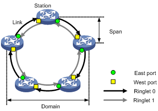

Ring structure of RPR
RPR is made up of dual unidirectional counter-rotating ringlets identified as Ringlet 0 and Ringlet 1, as shown in Figure 1.
Figure 1 Ring structure of RPR
Ringlet 0, also called the outer ring, is for clockwise or west data traffic. Ringlet 1, also called the inner ring, is for counterclockwise or east data traffic.
On Ringlet 0, stations send data frames out of east ports and receive data frames from west ports. On Ringlet 1, stations send data frames out of west ports and receive data frames from east ports.
Any two adjacent stations are connected by a pair of unidirectional logical channels called links transmitting in opposite directions. These two links form a span. Multiple continuous spans and their stations form a domain. A span on which data frames are not allowed to pass is called an edge. If a ring contains at least one detected edge, it is called open ring. If it does not contain any detected edges, it is called closed ring.

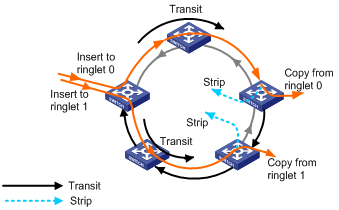

Unicast transmission
Figure 2 Unicast transmission on an RPR ring
Figure 2 shows how a unicast data frame is transmitted on an RPR ringlet:
1.     The source station inserts the unicast frame into the data stream on Ringlet 0 or Ringlet 1.
2.     Transit stations transit the frame.
3.     The frame is copied and stripped when it reaches the destination station or when its time to live (TTL) expires.

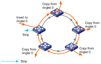

Broadcast, multicast, and unknown unicast transmission
Figure 3 Broadcast, multicast, and unknown unicast transmission on an RPR ring
Figure 3 shows how a broadcast, multicast, or unknown unicast frame is transmitted on an RPR ringlet:
1.     The source station inserts the frame into the data stream on Ringlet 0 or Ringlet 1.
2.     Transit and destination stations copy and transit the frame if the TTL of the frame has not expired.
3.     The frame is stripped when it returns to the source station or when its TTL expires.

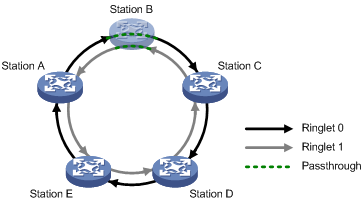

Passthrough
At present, the switch does not support the passthrough method.
The passthrough method mainly applies to station faults handling. When a station detects an internal fault, it enters the passthrough state in which it behaves like a repeater and does not handle any services on the ring. Frames arriving at this station are forwarded directly as if it was transparent, and the station is invisible on the ring. Station B shown in Figure 4 is an example.

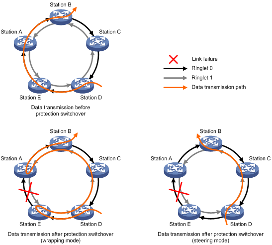

If a station is unable to forward traffic as the result of power failure or fiber cut for example, it should enter protection mode. RPR provides the following protection modes:
·     Wrapping—After a span or station fails, protected traffic is directed at the point of failure to the opposing ringlet. The two ringlets (Ringlet 0 and Ringlet 1) then form a closed single ring around the point of the failure. The wrapping mode minimizes the data frame loss, because the wrapping mode allows quick switchover, However, this mode wastes bandwidth.
·     Steering—The two stations at the two sides of a point of failure update their topology databases, and then send TP frames at fast intervals to the other stations on the ring. After a new topology database is stabilized, the source station directs protected frames to the ringlet that retains connectivity to their destinations. The steering mode can avoid the bandwidth waste. However, it can cause frame loss and service interruption because it requires topology reconvergence.
Figure 5 Schematic diagram before and after protection switchover
As shown in Figure 5, traffic travels from station D to station B along Ringlet 0. The transmission path is station D—station E—station A—station B. After the span between station A and station E fails, a protection switchover occurs.
·     In wrapping mode, traffic that should originally travel from station E to A along Ringlet 0 is directed to Ringlet 1 to reach station A. The new transmission path is station D—station E—station D—station C—station B—station A—station B.
·     In steering mode, traffic that should have traveled from station D to station B along Ringlet 0 is steered to Ringlet 1 for transmission. The new transmission path is Station D—Station C—Station B.

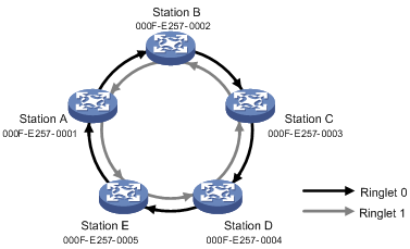

Layer 3 RPR interface binding configuration example
Network requirements
As shown in Figure 6, stations A through E form an RPR ring. The system working mode of the switches is hybrid.
Bind the RPR physical ports to the RPR logical interface on each station.
Figure 6 Network diagram
Configuration procedure
1.     Create an RPR logical interface and bind two RPR physical ports to the RPR logical interface.
# On Station A, create Layer 3 RPR logical interface RPR1, and bind RPR physical ports RPRPOS 2/1/1 (the west port) and RPRPOS 2/1/2 (the east port) to RPR 1.
<StationA> system-view
[StationA] interface rpr 1
[StationA-RPR1] rpr bind rprpos 2/1/1 ringlet0
[StationA-RPR1] rpr bind rprpos 2/1/2 ringlet1
[StationA-RPR1] quit
Configure Station B, C, D, and E in the same way Station A is configured.
2.     Verify the configuration:
# Display RPR interface binding information on Station A.
[StationA-RPR1] display rpr bind-info
Bind information on interface: RPR1
 PHY-Interface    Ringlet-ID    Role       Mate-Port
 RPRPOS2/1/1        Ringlet0      Master     Up
 RPRPOS2/1/2        Ringlet1      Slave      Up
# Display the RPR topology summary on Station A.
[StationA] display rpr topology all summary
Topology information items
Psw:protection state, west       Pse:protection state, east
Esw:edge state, west             Ese:edge state, east
Wc:wrap protection configured    Jp:jumbo frame preferred
Ring-level topology information on interface: RPR1
 Ringlet0 Ringlet1 Ring Jumbo-Prefer Topology-Type
  4        4       5    Regular      Closed ring
Local station topology information on interface: RPR1
 MAC-Address    Psw  Pse  Esw Ese Wc Jp IP-Address        Station-Name
000f-e257-0001 Idle Idle 0   0   0  0  0.0.0.0
Station topology information on interface: RPR1
 Station entry on ringlet0
000f-e257-0005 Idle Idle 0   0   0  0  0.0.0.0
000f-e257-0004 Idle Idle 0   0   0  0  0.0.0.0
000f-e257-0003 Idle Idle 0   0   0  0  0.0.0.0
000f-e257-0002 Idle Idle 0   0   0  0  0.0.0.0
Station entry on ringlet1
The topology information shows that the RPR ring is closed.
