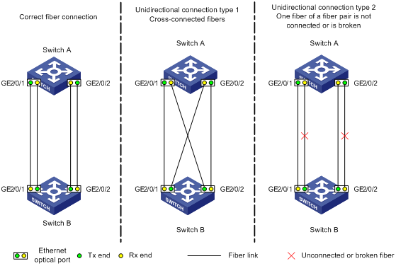

Unidirectional links occur when one end of a link can receive packets from the other end, but the other end cannot receive packets sent by the first end. Unidirectional links result in problems such as loops in an STP-enabled network.
For example, the link between Switch A and Switch B is bidirectional when they are connected through a fiber pair, with one fiber used for sending packets from A to B and the other for sending packets from B to A. This link is a two-way link. If one of these fibers gets broken, the link becomes unidirectional (one-way link).
There are two types of unidirectional fiber links. One occurs when fibers are cross-connected. The other occurs when a fiber is not connected, or when one fiber of a fiber pair gets broken. Figure 1 shows a correct fiber connection and the two types of unidirectional fiber connection.
Figure 1 Correct and incorrect fiber connections

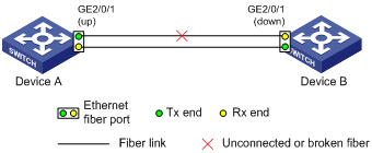

Enhanced DLDP mode is designed for addressing black holes. It prevents situations where one end of a link is up and the other is down.
If you configure forced speed and full duplex mode on a port, the situation shown in Figure 2 might occur (take the fiber link for example). Without DLDP enabled, the port on Switch B is actually down but its state cannot be detected by common data link protocols, so the port on Switch A is still up. However, in enhanced DLDP mode, the following occurs:
The port on Device B is in Inactive DLDP state because it is physically down.
The port on Switch A tests the peer port on Switch B after the Entry timer for the port on Switch B expires. The port on Switch A transits to the Disable state if it does not receive an Echo packet from the port on Switch B when the Echo timer expires.
Figure 2 A scenario for enhanced DLDP mode

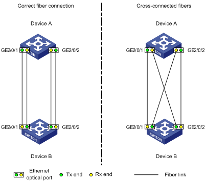

DLDP configuration examples
IMPORTANT:
By default, Ethernet, VLAN, and aggregate interfaces are in DOWN state. Before configuring these interfaces, use the undo shutdown command to bring them up.
Automatically shutting down unidirectional links
Network requirements
As shown in Figure 3,
·     Two switches, Device A and Device B, are connected with two fiber pairs.
·     Configure DLDP to automatically shut down the faulty port upon detecting a unidirectional link, and automatically bring up the port after the fault is cleared.
Figure 3 Network diagram
Configuration procedure
1.     Configure Device A:
# Enable DLDP globally.
<DeviceA> system-view
[DeviceA] dldp enable
# Configure Gigabitethernet 2/0/1 to operate in full duplex mode, configure the port rate as 1000 Mbps, and enable DLDP on the port.
[DeviceA] interface gigabitethernet 2/0/1
[DeviceA-Gigabitethernet2/0/1] duplex full
[DeviceA-Gigabitethernet2/0/1] speed 1000
[DeviceA-Gigabitethernet2/0/1] dldp enable
[DeviceA-Gigabitethernet2/0/1] quit
# Configure Gigabitethernet 2/0/2 to operate in full duplex mode, configure the port rate as 1000 Mbps, and enable DLDP on the port.
[DeviceA] interface gigabitethernet 2/0/2
[DeviceA-Gigabitethernet2/0/2] duplex full
[DeviceA-Gigabitethernet2/0/2] speed 1000
[DeviceA-Gigabitethernet2/0/2] dldp enable
[DeviceA-Gigabitethernet2/0/2] quit
# Set the DLDP mode to enhanced.
[DeviceA] dldp work-mode enhance
# Set the port shutdown mode to auto.
[DeviceA] dldp unidirectional-shutdown auto
2.     Configure Device B:
# Enable DLDP globally, configure Gigabitethernet 2/0/1 and Gigabitethernet 2/0/2 to operate in full duplex mode, and then enable DLDP on the two ports.
<DeviceB> system-view
[DeviceB] dldp enable
[DeviceB] interface gigabitethernet 2/0/1
[DeviceB-Gigabitethernet2/0/1] duplex full
[DeviceB-Gigabitethernet2/0/1] speed 1000
[DeviceB-Gigabitethernet2/0/1] dldp enable
[DeviceB-Gigabitethernet2/0/1] quit
[DeviceB] interface gigabitethernet 2/0/2
[DeviceB-Gigabitethernet2/0/2] duplex full
[DeviceB-Gigabitethernet2/0/2] speed 1000
[DeviceB-Gigabitethernet2/0/2] dldp enable
[DeviceB-Gigabitethernet2/0/2] quit
[DeviceB] dldp work-mode enhance
[DeviceB] dldp unidirectional-shutdown auto
3.     Verify the configuration:
After the configurations are complete, you can use the display dldp command to display the DLDP configuration information on ports.
# Display the DLDP configuration information on all the DLDP-enabled ports of Device A.
[DeviceA] display dldp
 DLDP global status : enable
 DLDP interval : 5s
 DLDP work-mode : enhance
 DLDP authentication-mode : none
 DLDP unidirectional-shutdown : auto
 DLDP delaydown-timer : 1s
 The number of enabled ports is 2.
Interface Gigabitethernet2/0/1
 DLDP port state : advertisement
 DLDP link state : up
 The neighbor number of the port is 1.
         Neighbor mac address : 0023-8956-3600
         Neighbor port index : 59
         Neighbor state : two way
         Neighbor aged time : 11
Interface Gigabitethernet2/0/2
         Neighbor port index : 60
         Neighbor aged time : 12
The output shows that both Gigabitethernet 2/0/1 and Gigabitethernet 2/0/2 are in Advertisement state, which means both links are bidirectional.
# Enable system information monitoring on Device A, and enable the display of log and trap information.
[DeviceA] quit
<DeviceA> terminal monitor
<DeviceA> terminal logging
<DeviceA> terminal trapping
The following log and trap information is displayed on Device A:
<DeviceA>
#Jan 18 17:36:18:798 2010 DeviceA DLDP/1/TrapOfUnidirectional: -Slot=2; Trap 1.3.6.1.4.1.25506.2.43.2.1.1<hh3cDLDPUnidirectionalPort>: DLDP detects a unidirectional link in port 17825792.
%Jan 18 17:36:18:799 2010 DeviceA IFNET/3/LINK_UPDOWN: Gigabitethernet2/0/1 link status is DOWN.
%Jan 18 17:36:18:799 2010 DeviceA DLDP/3/DLDP_UNIDIRECTION_AUTO: -Slot=2; DLDP detects a unidirectional link on port Gigabitethernet2/0/1. The transceiver has malfunction in the Tx direction or cross-connected links exist between the local device and its neighbor. The shutdown mode is AUTO. DLDP shuts down the port.
#Jan 18 17:36:20:189 2010 DeviceA DLDP/1/TrapOfUnidirectional: -Slot=2; Trap 1.3.6.1.4.1.25506.2.43.2.1.1<hh3cDLDPUnidirectionalPort> : DLDP detects a unidirectional link in port 17825793.
%Jan 18 17:36:20:189 2010 DeviceA IFNET/3/LINK_UPDOWN: Gigabitethernet2/0/2 link status is DOWN.
%Jan 18 17:36:20:190 2010 DeviceA DLDP/3/DLDP_UNIDIRECTION_AUTO: -Slot=2; DLDP detects a unidirectional link on port Gigabitethernet2/0/2. The transceiver has malfunction in the Tx direction or cross-connected links exist between the local device and its neighbor. The shutdown mode is AUTO. DLDP shuts down the port.
%Jan 15 16:54:56:040 2010 DeviceA DLDP/3/DLDP_UNIDIRECTION_AUTO_ENHANCE: -Slot=2; In enhanced DLDP mode, port Gigabitethernet2/0/1 cannot detect its aged-out neighbor. The transceiver has malfunction in the Tx direction or cross-connected links exist between the local device and its neighbor. The shutdown mode is AUTO. DLDP shuts down the port.
The output shows that both Gigabitethernet 2/0/1 and Gigabitethernet 2/0/2 are down. DLDP has detected a unidirectional link on both ports, and has automatically shut them down.
Assume that in this example, the unidirectional links are caused by cross-connected fibers. Correct the fiber connections on detecting the unidirectional link problem. As a result, the ports shut down by DLDP automatically recover, and Device A displays the following log information:
<DeviceA>
%Jan 18 17:47:33:869 2010 DeviceA IFNET/3/LINK_UPDOWN: Gigabitethernet2/0/1 link status is UP.
%Jan 18 17:47:35:894 2010 DeviceA IFNET/3/LINK_UPDOWN: Gigabitethernet2/0/2 link status is UP.
The output shows that the link status of both Gigabitethernet 2/0/1 and Gigabitethernet 2/0/2 is now up.

After you shut down Gigabitethernet 2/0/1 and Gigabitethernet 2/0/2, the following log information is displayed:
[DeviceA-Gigabitethernet2/0/1] shutdown
%Jan 18 18:16:12:044 2010 DeviceA IFNET/3/LINK_UPDOWN: Gigabitethernet2/0/1 link status is DOWN.
[DeviceA-Gigabitethernet2/0/2] shutdown
%Jan 18 18:18:03:583 2010 DeviceA IFNET/3/LINK_UPDOWN: Gigabitethernet2/0/2 link status is DOWN.
The output shows that the link status of both Gigabitethernet 2/0/1 and Gigabitethernet 2/0/2 is down.
Assume that in this example, the unidirectional links are caused by cross-connected fibers. Correct the fiber connections, and then bring up the ports shut down earlier.
# On Device A, bring up Gigabitethernet 2/0/1 and Gigabitethernet 2/0/2:
[DeviceA-Gigabitethernet2/0/2] undo shutdown
%Jan 18 18:22:11:698 2010 DeviceA IFNET/3/LINK_UPDOWN: Gigabitethernet2/0/2 link status is UP.
[DeviceA-Gigabitethernet2/0/1] undo shutdown
%Jan 18 18:22:46:065 2010 DeviceA IFNET/3/LINK_UPDOWN: Gigabitethernet2/0/1 link status is UP.
The output indicates that the link status of both Gigabitethernet 2/0/1 and Gigabitethernet 2/0/2 is now up.
