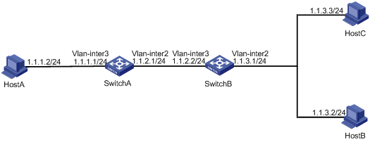

Network requirements
As shown in Figure 1, the interface of Host A and VLAN-interface 3 of Switch A are located on network segment 1.1.1.0/24. VLAN-interface 2 of Switch A and VLAN-interface 3 of Switch B are located on network segment 1.1.2.0/24. VLAN-interface 2 of Switch B, Host B, and Host C are located on network segment 1.1.3.0/24. The default gateway of Host A is VLAN-interface 3 (IP address 1.1.1.1/24) of Switch A. The default gateway of Host B and Host C is VLAN-interface 2 (IP address 1.1.3.1/24) of Switch B.
Configure static routes on Switch A and Switch B for reachability between Host A and Host B, and Host A and Host C, respectively.
Enable forwarding of directed broadcasts on Switch A and Switch B so that Host C and Host B can receive directed broadcasts from Host A.
Figure 1 Network diagram
Configuration procedure
1.     Configure Switch A:
# Configure a static route on Switch A.
<SwitchA> system-view
[SwitchA] ip route-static 1.1.3.0 255.255.255.0 1.1.2.2
# Configure IP addresses for VLAN-interface 3 and VLAN-interface 2.
[SwitchA] interface vlan-interface 3
[SwitchA-Vlan-interface3] ip address 1.1.1.1 24
[SwitchA-Vlan-interface3] quit
[SwitchA-Vlan-interface2] ip address 1.1.2.1 24
# Enable VLAN-interface 2 to forward directed broadcasts.
[SwitchA-Vlan-interface2] ip forward-broadcast
2.     Configure Switch B:
# Configure a static route on Switch B.
<SwitchB> system-view
[SwitchB] ip route-static 1.1.1.0 255.255.255.0 1.1.2.1
[SwitchB] interface vlan-interface 3
[SwitchB-Vlan-interface3] ip address 1.1.2.2 24
[SwitchB-Vlan-interface3] quit
[SwitchB-Vlan-interface2] ip address 1.1.3.1 24
[SwitchB-Vlan-interface2] ip forward-broadcast
Ping the subnet broadcast address 1.1.3.255 of VLAN-interface 2 of Switch B from Host A. The ping packets can be received by Host B and Host C.
