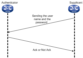

PAP authentication
PAP is a two-way handshake authentication protocol using plain text passwords. It operates as follows.
1.     The requester sends its username and password to the authenticator.
2.     The authenticator then checks the local user list to see if the username and password are correct and returns an acknowledgement or negative acknowledge.
Figure 1 PAP authentication
During PAP authentication, the password is transmitted on the link in plain text. In addition, the supplicant sends the username and the password repeatedly through the established PPP link until the authentication is over. Therefore, PAP is not a secure authentication protocol. It cannot prevent attacks.

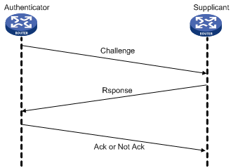

CHAP authentication
CHAP is a three-way handshake authentication protocol using cipher text password.
Two types of CHAP authentication exist: one-way CHAP authentication and two-way CHAP authentication. By one-way CHAP authentication, one side of the link acts as the authenticator and the other acts as the supplicant. By two-way authentication, each side serves as both the authenticator and the supplicant. Generally, one-way CHAP authentication is adopted.
In one-way CHAP authentication, the authenticator can be optionally configured with a username. It is recommended that you configure a username for the authenticator, which makes it easier to identify the authenticator.
If the authenticator is configured with a username, CHAP authentication is performed as follows:
1.     The authenticator initiates an authentication by sending a randomly-generated packet (Challenge) to the supplicant. The packet carries the local username with it in addition.
2.     When the supplicant receives the authentication request, it searches the local user list for the password of the username carried in the received packet, encrypts the packet by using the MD5 algorithm, with the packet ID and the password as the parameters, and then sends the encrypted packet and the local username to the authenticator (Response).
3.     The authenticator encrypts the original randomly-generated packet by using the MD5 algorithm, with the password of the supplicant it maintains as the parameter, compares the encrypted packet with the one received from the supplicant, and returns an Acknowledge or Not Acknowledge packet depending on the comparison result.
If the authenticator is not configured with a username, the CHAP authentication is performed as follows:
2.     When the supplicant receives the authentication request, it encrypts the packet by using the MD5 algorithm, with the packet ID and the default CHAP password as the parameters, and then sends the encrypted packet and its own username to the authenticator (Response).
Figure 2 CHAP authentication

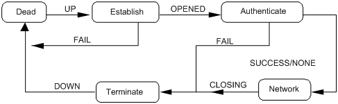

PPP link phases
Figure 3 illustrates the PPP operating mechanism with the following workflow:
1.     A PPP link is in the Establish phase when it is about to be established. In this phase, LCP negotiation is performed, where LCP-related settings are determined, including operating mode (SP or MP), the authentication mode, and the Maximum Transmission Unit (MTU). If the negotiation is successful, the link enters the Opened state, indicating that the underlying layer link has been established.
2.     If the authentication (the remote verifies the local or the local verifies the remote) is configured, the PPP link goes to the Authenticate phase, where PAP, CHAP, MS-CHAP, or MS-CHAP-V2 authentication is performed.
3.     If the supplicant fails to pass the authentication, the link goes to the Terminate phase, where the link is torn down and LCP goes down. If the supplicant passes the authentication, the link goes to the Network phase. In this phase, NCP negotiation is performed, the LCP state remains Opened, and the state of the IP Control Protocol (IPCP) is changed from Initial to Request.
4.     NCP negotiation supports the negotiation of IPCP, through which the IP addresses of both sides can be determined. NCP negotiation also determines and configures the network layer protocol to be used. A PPP link can carry a network layer protocol only after the NCP negotiation is successful.
5.     After the NCP negotiation is performed, the PPP link remains active until an LCP or NCP frame close it explicitly or some external events take place (for example, the intervention of a user).
Figure 3 PPP operation flow chart
For more information about PPP, see RFC 1661.
