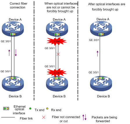

Bringing up Ethernet interfaces and subinterfaces
You can use the commands in this section to bring up a single Ethernet interface in Ethernet interface view, or to bring up multiple Ethernet interfaces in port group view.
To bring up Ethernet interfaces:
Step
Remarks
N/A
2.     Enter Ethernet interface or subinterface view, or port group view.
·     Enter Ethernet interface view:
interface
interface-type interface-number
·     Enter Ethernet subinterface view:
interface
interface-type interface-number.subnumber
·     Enter port group view:
port-group
manual port-group-name
Use any command.
To shut down an Ethernet interface or subinterface, enter Ethernet interface or subinterface view. To shut down all Ethernet interfaces in a port group, enter port group view.
You can enter Ethernet subinterface view only when the Ethernet interface operates in Layer 3 mode.
3.     Bring up Ethernet interfaces.
undo shutdown
Optional.
By default, Ethernet interfaces are in DOWN state.

Forcibly bringing up an Ethernet interface
As shown in Figure 2, a fiber port uses separate wires for transmitting and receiving packets. The physical state is up only when both transmit and receive fibers are present. If one of the fibers is disconnected, the fiber port does not work.
To enable a fiber port to perform one-way forwarding when only one fiber is present, you can use the port up-mode command. This command brings up an Ethernet fiber port by force, even when no fiber links or transceiver modules are present. If one fiber link is present and up, the fiber port can forward packets over the link unidirectionally.
Figure 2 Forcibly bring up an Ethernet interface
·     Only the general GE fiber port and the 10-GE fiber port operating in LAN mode can be forcibly brought up. Copper ports and combo interfaces do not support this function.
·     The port up-mode command cannot be used together with any of the shutdown, speed, duplex, or loopback commands.
·     When a fiber-to-copper media converter, 100/1000-Mbps transceiver module, or 100-Mbps transceiver module is inserted into a fiber GE port forcibly brought up, traffic cannot be forwarded correctly; when a copper transceiver module is inserted into the 10-GE fiber port forcibly brought up, the traffic cannot be forwarded correctly. To enable such an interface to forward traffic correctly, use the undo port up-mode command on the interface.
