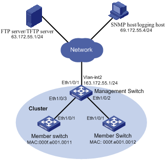

Cluster Overview
Introduction to HGMP
A cluster contains a group of switches. Through cluster management, you can manage multiple geographically dispersed in a centralized way.
Cluster management is implemented through Huawei group management protocol (HGMP). HGMP version 2 (HGMPv2) is used at present.
A switch in a cluster plays one of the following three roles:
l          Management device
l          Member device
l          Candidate device
A cluster comprises of a management device and multiple member devices. To manage the devices in a cluster, you need only to configure an external IP address for the management switch. Cluster management enables you to configure and manage remote devices in batches, reducing the workload of the network configuration. Normally, there is no need to configure external IP addresses for member devices.
Figure 2-1 illustrates a cluster implementation.
Figure 2-1 A cluster implementation
HGMP V2 has the following advantages:
l          It eases the configuration and management of multiple switches: You just need to configure a public IP address for the management device instead of for all the devices in the cluster; and then you can configure and manage all the member devices through the management device without the need to log onto them one by one.
l          It provides the topology discovery and display function, which assists in monitoring and maintaining the network.
l          It allows you to configure and upgrade multiple switches at the same time.
l          It enables you to manage your remotely devices conveniently regardless of network topology and physical distance.
l          It saves IP address resource.

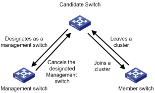

Figure 2-2 illustrates the state machine of cluster role.
Figure 2-2 State machine of cluster role
l          A candidate device becomes a management device when you create a cluster on it. Note that a cluster must have one (and only one) management device. On becoming a management device, the device collects network topology information and tries to discover and determine candidate devices, which can then be added to the cluster through configurations.
l          A candidate device becomes a member device after being added to a cluster.
l          A member device becomes a candidate device after it is removed from the cluster.
l          A management device becomes a candidate device only after the cluster is removed.

Introduction to Cluster
A cluster must have one and only one management device. Note the following when creating a cluster:
l          You need to designate a management device for the cluster. The management device of a cluster is the portal of the cluster. That is, any operations from outside the network intended for the member devices of the cluster, such as accessing, configuring, managing, and monitoring, can only be implemented through the management device.
l          The management device of the cluster recognizes and controls all the member devices in the cluster, no matter where they are located in the network and how they are connected.
l          The management device collects topology information about all member/candidate devices to provide useful information for you to establish the cluster.
l          By collecting NDP/NTDP information, the management device learns network topology, so as to manage and monitor network devices.
l          Before performing any cluster-related configuration task, you need to enable the cluster function first.
On the management device, you need to enable the cluster function and configure cluster parameters. On the member/candidate devices, however, you only need to enable the cluster function so that they can be managed by the management device.
Cluster maintenance
1)        Adding a candidate device to a cluster
To create a cluster, you need to determine the device to operate as the management device first. The management device discovers and determines candidate devices through NDP and NTDP, and adds them to the cluster. You can also add candidate devices to a cluster manually.
After a candidate device is added to a cluster, the management device assigns a member number and a private IP address (used for cluster management) to it.

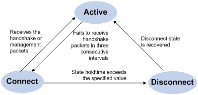

2)        Communications within a cluster
In a cluster, the management device maintains the connections to the member devices through handshake packets. Figure 2-3 illustrates the state machine of the connection between the management device and a member device.
Figure 2-3 State machine of the connection between the management device and a member device
l          After a cluster is created and a candidate device is added to the cluster as a member device, both the management device and the member device store the state information of the member device and mark the member device as Active.
l          The management device and the member devices exchange handshake packets periodically. Note that the handshake packets exchanged keep the states of the member devices to be Active and are not responded.
l          If the management device does not receive a handshake packet from a member device after a period three times of the interval to send handshake packets, it changes the state of the member device from Active to Connect. Likewise, if a member device fails to receive a handshake packet from the management device after a period three times of the interval to send handshake packets, the state of the member device will also be changed from Active to Connect.
l          If the management device receives a handshake packet or management packet from a member device that is in Connect state within the information holdtime, it changes the state of the member device to Active; otherwise, it changes the state of the member device (in Connect state) to Disconnect, in which case the management device considers the member device disconnected. Likewise, if this member device, which is in Connect state, receives a handshake packet or management packet from the management device within the information holdtime, it changes its state to Active; otherwise, it changes its state to Disconnect.
l          If the connection between the management device and a member device in Disconnect state is recovered, the member device will be added to the cluster again. After that, the state of the member device will turn to Active both locally and on the management device.
Besides, handshake packets are also used by member devices to inform the management device of topology changes.

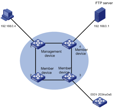

Tracing a device in a cluster
In practice, you need to implement the following in a cluster sometimes:
l          Know whether there is a loop in the cluster
l          Locate which port on which switch initiates a network attack
l          Determine the port and switch that a MAC address corresponds to
l          Locate which switch in the cluster has a fault
l          Check whether a link in the cluster and the devices on the link comply with the original plan
In these situations, you can use the tracemac command to trace a device in the cluster by specifying a destination MAC address or IP address.
The procedures are as follows:
1)        Determine whether the destination MAC address or destination IP address is used to trace a device in the cluster
l          If you use the tracemac command to trace the device by its MAC address, the switch will query its MAC address table according to the MAC address and VLAN ID in the command to find out the port connected with the downstream switch.
l          If you use the tracemac command to trace the device by its IP address, the switch will query the corresponding ARP entry of the IP address to find out the corresponding MAC address and VLAN ID, and thus find out the port connected with the downstream switch.
2)        After finding out the port connected with the downstream switch, the switch will send a multicast packet with the VLAN ID and specified hops to the port. Upon receiving the packet, the downstream switch compares its own MAC address with the destination MAC address carried in the multicast packet:
l          If the two MAC addresses are the same, the downstream switch sends a response to the switch sending the tracemac command, indicating the success of the tracemac command.
l          If the two MAC addresses are different, the downstream switch will query the port connected with its downstream switch based on the MAC address and VLAN ID, and then forward the packet to its downstream switch. If within the specified hops, a switch with the specified destination MAC address is found, this switch sends a response to the switch sending the tracemac command, indicating the success of the tracemac command. If no switch with the specified destination MAC address (or IP address) is found, the multicast packet will not be forwarded to the downstream any more.
l          If the queried IP address has a corresponding ARP entry, but the MAC address entry corresponding to the IP address does not exist, the trace of the device fails.
l          To trace a specific device using the tracemac command, make sure that all the devices passed support the tracemac function.
l          To trace a specific device in a management VLAN using the tracemac command, make sure that all the devices passed are within the same management VLAN as the device to be traced.

Configuring inside-outside interaction for a cluster
Follow these steps to configure inside-outside interaction for a cluster:
Operation
Description
Enter system view
Enter cluster view
cluster
Required
Configure a shared FTP server for the cluster
ftp-server ip-address
Optional
By default, the management device acts as the shared FTP server.
Configure a shared TFTP server for the cluster
tftp-server ip-address
Optional
By default, no shared TFTP server is configured.
Configure a shared logging host for the cluster
logging-host ip-address
Optional
By default, no shared logging host is configured.
Configure a shared SNMP host for the cluster
snmp-host ip-address
Optional
By default, no shared SNMP host is configured.

Accessing the shared FTP/TFTP server from a member device
Follow these steps to access the shared FTP/TFTP server from a member device:
Operation
Description
Access the shared FTP server of the cluster
ftp cluster
Optional
Download a file from the shared TFTP server of the cluster
tftp cluster get source-file [ destination-file ]
Optional
Upload a file to the shared TFTP server of the cluster
tftp cluster put source-file [ destination-file ]
Optional

Cluster Configuration Example
Basic Cluster Configuration Example
Network requirements
Three switches compose a cluster, where:
l          An S3100 series switch serves as the management device.
l          The rest are member devices.
Serving as the management device, the S3100 switch manages the two member devices. The configuration for the cluster is as follows:
l          The two member devices connect to the management device through Ethernet 1/0/2 and Ethernet 1/0/3.
l          The management device connects to the Internet through Ethernet 1/0/1.
l          Ethernet 1/0/1 belongs to VLAN 2, whose interface IP address is 163.172.55.1.
l          All the devices in the cluster share the same FTP server and TFTP server.
l          The FTP server and TFTP server use the same IP address: 63.172.55.1.
l          The NMS and logging host use the same IP address: 69.172.55.4.
Network diagram
Figure 2-4 Network diagram for HGMP cluster configuration
Configuration procedure
1)        Configure the member devices (taking one member as an example)
# Enable NDP globally and on Ethernet1/0/1.
<Sysname> system-view
[Sysname] ndp enable
[Sysname] interface Ethernet 1/0/1
[Sysname-Ethernet1/0/1] ndp enable
[Sysname-Ethernet1/0/1] quit
# Enable NTDP globally and on Ethernet1/0/1.
[Sysname] ntdp enable
[Sysname-Ethernet1/0/1] ntdp enable
# Enable the cluster function.
[Sysname] cluster enable
2)        Configure the management device
# Enable NDP globally and on Ethernet 1/0/2 and Ethernet 1/0/3.
[Sysname] interface Ethernet 1/0/2
[Sysname-Ethernet1/0/2] ndp enable
[Sysname-Ethernet1/0/2] quit
[Sysname] interface Ethernet 1/0/3
[Sysname-Ethernet1/0/3] ndp enable
[Sysname-Ethernet1/0/3] quit
# Set the holdtime of NDP information to 200 seconds.
[Sysname] ndp timer aging 200
# Set the interval to send NDP packets to 70 seconds.
[Sysname] ndp timer hello 70
# Enable NTDP globally and on Ethernet 1/0/2 and Ethernet 1/0/3.
[Sysname-Ethernet1/0/2] ntdp enable
[Sysname-Ethernet1/0/3] ntdp enable
 # Set the topology collection range to 2 hops.
[Sysname] ntdp hop 2
# Set the member device forward delay for topology collection requests to 150 ms.
[Sysname] ntdp timer hop-delay 150
# Set the member port forward delay for topology collection requests to 15 ms.
[Sysname] ntdp timer port-delay 15
# Set the interval to collect topology information to 3 minutes.
[Sysname] ntdp timer 3
# Enter cluster view.
[Sysname] cluster
[Sysname-cluster]
# Configure a private IP address pool for the cluster. The IP address pool contains six IP addresses, starting from 172.16.0.1.
[Sysname-cluster] ip-pool 172.16.0.1 255.255.255.248
# Name and build the cluster.
[Sysname-cluster] build aaa
[aaa_0.Sysname-cluster]
# Add the attached two switches to the cluster.
[aaa_0.Sysname-cluster] add-member 1 mac-address 000f-e20f-0011
[aaa_0.Sysname-cluster] add-member 17 mac-address 000f-e20f-0012
# Set the holdtime of member device information to 100 seconds.
[aaa_0.Sysname-cluster] holdtime 100
# Set the interval to send handshake packets to 10 seconds.
[aaa_0.Sysname-cluster] timer 10
# Configure the shared FTP server, TFTP server, Logging host and SNMP host for the cluster.
[aaa_0.Sysname-cluster] ftp-server 63.172.55.1
[aaa_0.Sysname-cluster] tftp-server 63.172.55.1
[aaa_0.Sysname-cluster] logging-host 69.172.55.4
[aaa_0.Sysname-cluster] snmp-host 69.172.55.4
3)        Perform the following operations on the member devices (taking one member as an example)
After adding the devices under the management device to the cluster, perform the following operations on a member device.
# Connect the member device to the remote shared FTP server of the cluster.
<aaa_1.Sysname> ftp cluster
# Download the file named aaa.txt from the shared TFTP server of the cluster to the member device.
<aaa_1.Sysname> tftp cluster get aaa.txt
# Upload the file named bbb.txt from the member device to the shared TFTP server of the cluster.
<aaa_1.Sysname> tftp cluster put bbb.txt
l          After completing the above configuration, you can execute the cluster switch-to { member-number | mac-address H-H-H } command on the management device to switch to member device view to maintain and manage a member device. After that, you can execute the cluster switch-to administrator command to return to management device view.
l          In addition, you can execute the reboot member { member-number | mac-address H-H-H } [ eraseflash ] command on the management device to reboot a member device. For detailed information about these operations, refer to the preceding description in this chapter.
l          After the above configuration, you can receive logs and SNMP trap messages of all cluster members on the NMS.
Enhanced Cluster Feature Configuration Example
l          The cluster operates properly.
l          Add the device with the MAC address 0001-2034-a0e5 to the cluster blacklist, that is, prevent the device from being managed and maintained by the cluster.
l          Save the current cluster topology as the base topology and save it in the flash of the local management device in the cluster.
Network diagram
Figure 2-5 Network diagram for the enhanced cluster feature configuration
<aaa_0.Sysname> system-view
[aaa_0.Sysname] cluster
# Add the MAC address 0001-2034-a0e5 to  the cluster blacklist.
[aaa_0.Sysname-cluster] black-list add-mac 0001-2034-a0e5
# Backup the current topology.
[aaa_0.Sysname-cluster] topology accept all save-to local-flash
