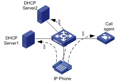

Figure 1-1 Network diagram for IP phones
As shown in Figure 1-1, the IP phone needs to work in conjunction with the DHCP server and the NCP to establish a path for voice data transmission. An IP phone goes through the following three phases to become capable of transmitting voice data.
2)        After the IP phone is powered on, it sends an untagged DHCP request message containing four special requests in the Option 184 field besides the request for an IP address. The message is broadcast in the default VLAN of the receiving port. After receiving the DHCP request message, DHCP Server 1, which resides in the default VLAN of the port receiving the message, responds as follows:
l          If DHCP Server 1 does not support Option 184, it returns the IP address assigned to the IP phone but ignores the other four special requests in the Option 184 field. Without information about voice VLAN, the IP phone can only send untagged packets in the default VLAN of the port the IP phone is connected to. In this case, you need to manually configure the default VLAN of the port as a voice VLAN.
In cases where an IP phone obtains an IP address from a DHCP server that does not support Option 184, the IP phone directly communicates through the gateway after it obtains an IP address. It does not go through the steps described below.
l          If DHCP Server 1 supports Option 184, it returns the IP address assigned to the IP phone, the IP address of the NCP, the voice VLAN ID, and so on.
3)        On acquiring the voice VLAN ID and NCP address from DHCP Server 1, the IP phone communicates with the specified NCP to download software, ignores the IP address assigned by DHCP Server 1, and sends a new DHCP request message carrying the voice VLAN tag to the voice VLAN.
4)        After receiving the DHCP request, DHCP Server 2 residing in the voice VLAN assigns a new IP address to the IP phone and sends a tagged response message to the IP phone. After the IP phone receives the tagged response message, it sends voice data packets tagged with the voice VLAN tag to communicate with the voice gateway. In this case, the port connecting to the IP phone must be configured to allow the packets tagged with the voice VLAN tag to pass.
l          An untagged packet carries no VLAN tag.
l          A tagged packet carries the tag of a VLAN.
To set an IP address and a voice VLAN for an IP phone manually, just make sure that the voice VLAN ID to be set is consistent with that of the switch and the NCP is reachable to the IP address to be set.

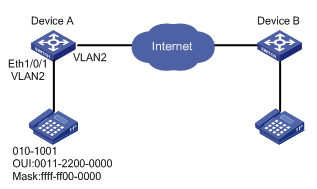

Voice VLAN Configuration Example
Voice VLAN Configuration Example (Automatic Voice VLAN Assignment Mode)
Network requirements
Create a voice VLAN and configure it to operate in automatic voice VLAN assignment mode to enable the port to which an IP phone is connected to join or exit the voice VLAN automatically and voice traffic to be transmitted within the voice VLAN.
l          Create VLAN 2 and configure it as the voice VLAN, with the aging timer being 100 minutes.
l          The IP phone sends tagged packets. It is connected to Ethernet 1/0/1, a hybrid port, with VLAN 6 being its default VLAN. Set this port to operate in automatic voice VLAN assignment mode.
l          You need to add a user-defined OUI address 0011-2200-000, with the mask being ffff-ff00-0000 and the description string being “test”.
Network diagram
Figure 1-2 Network diagram for voice VLAN configuration (automatic voice VLAN assignment mode)
Configuration procedure

Voice VLAN Configuration Example (Manual Voice VLAN Assignment Mode)
Create a voice VLAN and configure it to operate in manual voice VLAN assignment mode. Add the port to which an IP phone is connected to the voice VLAN to enable voice traffic to be transmitted within the voice VLAN.
l          Create VLAN 2 and configure it as a voice VLAN. Set the voice VLAN to operate in security mode
l          The IP phone sends untagged packets. It is connected to Ethernet 1/0/1, a hybrid port. Set this port to operate in manual voice VLAN assignment mode.
Network diagram
Figure 1-3 Network diagram for voice VLAN configuration (manual voice VLAN assignment mode)
