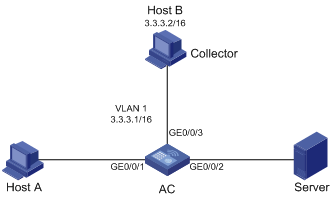

Network requirements
l          Host A and Server are connected to AC through GigabitEthernet 0/0/1 and GigabitEthernet 0/0/2 respectively.
l          Host B works as an sFlow collector with IP address 3.3.3.2 and port number 6343, and is connected to AC through GigabitEthernet 0/0/3.
l          GigabitEthernet 0/0/3 belongs to VLAN 1, having an IP address of 3.3.3.1.
Run sFlow agent on AC, and enable sFlow on GigabitEthernet 0/0/1 to monitor traffic on this interface. AC sends sFlow packets through GigabitEthernet 0/0/3 to Host B, which then analyzes the sFlow packets and displays the results.
Network diagram
Figure 1-1 Network diagram for sFlow configuration
