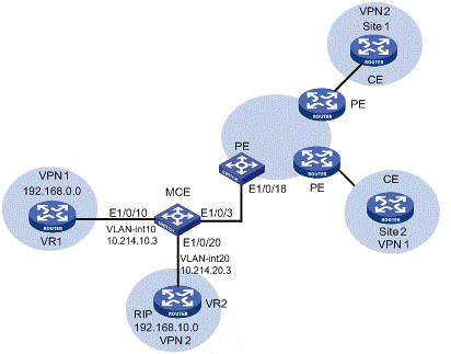

1.1.4  How MCE Works
Figure 1-3 illustrates how MCE creates and maintains routing entries of multiple VPNs and how the MCE exchanges VPN routes with PEs.
Figure 1-3 How MCE works
In Figure 1-3, the two VPN sites on the left side (Site 1 and Site 2) are connected to the backbone network through an MCE device. Two VPN tunnels are expected between them and the remote VPNs at Site 2 and Site 1.
With MCE enabled, routing tables can be created for VPN 1 and VPN 2 individually, VLAN-interface 2 can be bound to VPN 1, and VLAN-interface 3 can be bound to VPN 2. When receiving a piece of routing information, MCE determines the source of the routing information according to the number of the interface receiving the information and then maintains the corresponding routing table accordingly.
You need to also to bind the interfaces/sub-interfaces to the VPNs on PE 1 in the same way as those on the MCE device. The MCE device is connected to PE 1 through a trunk, which permits packets of VLAN 2 and VLAN 3 with VLAN tags carried. In this way, PE 1 can determine the VPN a received packet belongs to according to the VLAN tag of the packet and passes the packet to the corresponding tunnel.

2.5  MCE Configuration Example
2.5.1  MCE Configuration Example (A)
I. Network requirements
l           An MCE device connects to VPN1 (with the address range being 192.168.0.0/16) through VLAN-interface 10 (with the IP address being 10.214.10.3) and connects to VPN2 (with the address range being 192.168.10.0/24) through VLAN-interface 20 (with the IP address being 10.214.20.3). VPN2 has RIP enabled.
l           It is required that the MCE device isolate routes of VPN1 from those of VPN2 and advertise all the VPN routes to the PE device using OSPF.
II. Network diagram
Figure 2-1 Network diagram for MCE configuration (A)

l           Configure the routing protocol running between MCE and a site
MCE is directly connected to VPN1, which has no routing protocol enabled. You can configure to use static routes between MCE and a site.
Configuration on VR1: Assume VR1 is an S3610 switch, configure IP address 10.214.10.2/24 for the interface connecting to MCE and IP address 192.168.0.1/24 for the interface connecting to VPN1. The operation of adding a port to a VLAN and configuring IP address for a VLAN-interface is omitted here.
# Configure a default route on VR1, specifying the next hop address to 10.214.10.3.
<VR1> system-view
[VR1] ip route-static 0.0.0.0 0.0.0.0 10.214.10.3
# Define a static route on MCE, specify the next hop address 10.214.10.2 for packets destined for the network segment 192.168.0.0, and bind this route to VPN1.
[MCE-Vlan-interface10] quit
[MCE] ip route-static vpn-instance vpn1 192.168.0.0 16 10.214.10.2

# RIP is running within VPN2, so you can configure RIP on MCE and involve the RIP on MCE in the routing computation in the site to update the routing information automatically. Create RIP process 20 and bind it VPN2.
[MCE] rip 20 vpn-instance vpn2
# Advertise the network segment 10.214.10.0.
[MCE-rip-20] network 10.0.0.0
# On VR2, configure IP address 10.214.20.2/24 for the interface connecting to MCE (configuration procedures omitted), enable RIP and advertise the network segments 192.168.10.0 and 10.214.20.0.

l           Configure the routing protocol running between the MCE and a PE
# MCE uses Ethernet 1/0/3 to connect to Ethernet 1/0/18 of PE. Configure the two ports to be trunk ports and permit tagged packets of VLAN 10 and VLAN 20.
