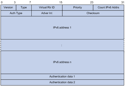

II. IPv6-based VRRP packet format
Figure 1-4 IPv6-based VRRP packet format
As shown in Figure 1-4, an IPv6-based VRRP packet consists of the following fields:
l           Version: Version number of the protocol, 3 for VRRPv3.
l           Type: Type of the VRRP packet. Only one VRRP packet type is present, that is, VRRP advertisement, which is represented by 1.
l           Virtual Rtr ID (VRID): Number of the virtual router, that is, number of the standby group. It ranges from 1 to 255.
l           Priority: Priority of the switch in the standby group, in the range 0 to 255. A greater value represents a higher priority.
l           Count IPv6 Addrs: Number of virtual IPv6 addresses for the standby group. A standby group can have multiple virtual IPv6 addresses.
l           Auth Type: Authentication type. 0 means no authentication, 1 means simple authentication. VRRPv3 does not support MD5 authentication.
l           Adver Int: Interval for sending advertisement packets, in centiseconds. The default is 100.
l           Checksum: 16-bit checksum for validating the data in VRRPv3 packets.
l           IPv6 Address: Virtual IPv6 address entry of the standby group. The allowed number is given by the Count IPv6 Addrs field.
l           Authentication Data: Authentication key. Currently, this field is used only for simple authentication and is 0 for any other authentication modes.
