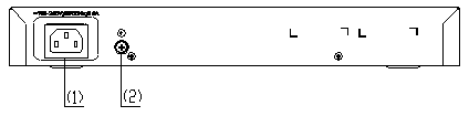

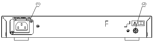

Figure 1-2 shows the rear panel of an S3100-26T-SI Ethernet switch.
(1) AC power socket
(2) Grounding screw
Figure 1-2 Rear panel of an S3100-26T-SI Ethernet switch
III. Power system
S3100-26T-SI Ethernet switches support AC input.
l           Rated voltage range: 100 VAC to 240 VAC, 50 Hz/60 Hz
l           Input voltage range: 90 VAC to 264 VAC, 47 Hz to 63 Hz

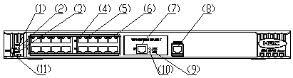

1.2.2  S3100-16T-SI
I. Front panel

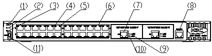

S3100-16T-SI Ethernet switches each provide sixteen auto-sensing 10/100Base-TX Ethernet ports, one 10/100/1000Base-T Ethernet port, and one console port.
Figure 1-3 shows the front panel of an S3100-16T-SI Ethernet switch.
(1) Power LED
(2) A/L LED
(3) D/S LED
(4) Port status LED on the left (yellow)
(5) Port status LED on the right (green)
(6) 10/100 Base-TX port
(7) 10/100/1000 Base-T port
(8) Console port
(9) Link LED (green)
(10) Active LED (yellow)
(11) Mode button
Figure 1-3 Front panel of an S3100-16T-SI Ethernet switch
&  Note:
For details about LEDs on the front panel, refer to section 1.4   “Introduction to Front Panel LEDs”.

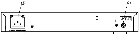

II. Rear panel

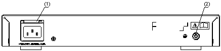

Figure 1-4 shows the rear panel of an S3100-16T-SI Ethernet switch.
(1) AC power socket
(2) Grounding screw
Figure 1-4 Rear panel of an S3100-16T-SI Ethernet switch

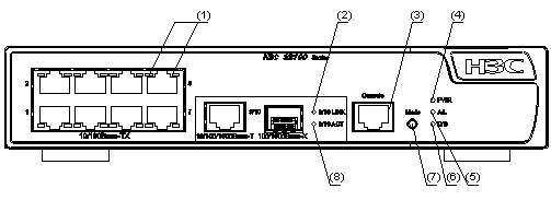

1.2.3  S3100-8T-SI

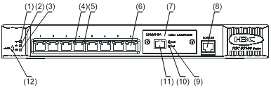

I. Front panel

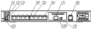

S3100-8T-SI Ethernet switches each provide eight auto-sensing 10/100Base-TX Ethernet ports, one 10/100/1000Base-T Ethernet port, and one console port.
Figure 1-5 shows the front panel of an S3100-8T-SI Ethernet switch.
(1) Power LED
(2) A/L LED
(3) D/S LED
(8) Console port
(11) Mode button
Figure 1-5 Front panel of an S3100-8T-SI Ethernet switch
&  Note:

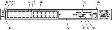

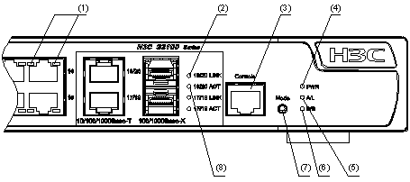

1.2.4  S3100-26C-SI
Both AC-powered switches and DC-powered switches are available to this model.
I. Front panel

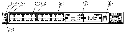

S3100-26C-SI Ethernet switches each provide twenty-four auto-sensing 10/100Base-TX Ethernet ports, two expansion slots, and one console port.
S3100-26C-SI Ethernet switches have the same front panel, as shown in Figure 1-7.
(1) Power LED
(2) A/L LED
(3) D/S LED
(6) 10/100 BASE-TX port
(7) Expansion slot
(8) Console port
(9) Mode button
Figure 1-7 Front panel of an S3100-26C-SI Ethernet switch
&  Note:
l      With a PoE card inserted in one expansion slot, an S3100-26C-SI Ethernet switch will be a powered device (PD). In this case, the other expansion slot becomes unavailable.
l      For details about LEDs on the front panel, refer to section section 1.4   “Introduction to Front Panel LEDs”.

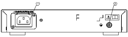

II. Rear panel
Figure 1-8 shows the rear panel of an S3100-26C-SI AC-powered Ethernet switch.
(1) AC power socket
(2) Grounding screw
Figure 1-8 Rear panel of an S3100-26C-SI AC-powered Ethernet switch

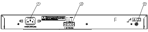

Figure 1-9 shows the rear panel of an S3100-26C-SI DC-powered Ethernet switch.
(1) DC input terminal block
(2) Grounding screw
Figure 1-9 Rear panel of an S3100-26C-SI DC-powered Ethernet switch

1.2.5  S3100-16C-SI
I. Front panel
S3100-16C-SI Ethernet switches each provide sixteen auto-sensing 10/100Base-TX Ethernet ports, two expansion slots, and one console port.
S3100-16C-SI Ethernet switches have the same front panel, as shown in Figure 1-10.
(1) Power LED
(2) A/L LED
(3) D/S LED
(7) Expansion slot
(8) Console port
(9) Mode button
Figure 1-10 Front panel of an S3100-16C-SI Ethernet switch
&  Note:
l      With a PoE card inserted in one expansion slot, an S3100-16C-SI Ethernet switch will be a powered device (PD). In this case, the other expansion slot becomes unavailable.
l      For details about LEDs on the front panel, refer to section 1.4   “Introduction to Front Panel LEDs”.

Figure 1-11 shows the rear panel of an S3100-16C-SI AC-powered Ethernet switch.
(1) AC power socket
(2) Grounding screw
Figure 1-11 Rear panel of an S3100-16C-SI AC-powered Ethernet switch
Figure 1-12 shows the rear panel of an S3100-16C-SI DC-powered Ethernet switch.
(2) Grounding screw
Figure 1-12 Rear panel of an S3100-16C-SI DC-powered Ethernet switch

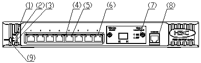

I. Front panel
S3100-8C-SI Ethernet switches each provide eight auto-sensing 10/100Base-TX Ethernet ports, one expansion slot, and one console port.
S3100-8C-SI Ethernet switches have the same front panel, as shown in Figure 1-13.
(1) Power LED
(2) A/L LED
(3) D/S LED
(7) Expansion slot
(8) Console port
(9) Mode button
Figure 1-13 Front panel of an S3100-8C-SI Ethernet switch
&  Note:
II. Rear panel
Figure 1-14 shows the rear panel of an S3100-8C-SI AC-powered Ethernet switch.
(1) AC power socket
(2) Grounding screw
Figure 1-14 Rear panel of an S3100-8C-SI AC-powered Ethernet switch

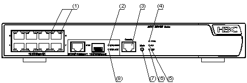

1.3  Introduction to S3100-EI Series Ethernet Switches

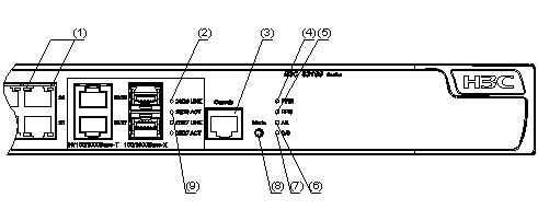

1.3.1  S3100-26TP-EI-W

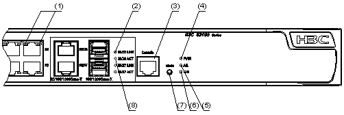

I. Front panel
S3100-26TP-EI-W Ethernet switches each provide twenty-four auto-sensing 10/100/1000Base-TX Ethernet ports, two 10/100/1000BASE-T Ethernet ports, two 100/1000Base-X SFP ports, and one console port. Each SFP port and the corresponding 10/100/1000BASE-T Ethernet port form a Combo port. For each Combo port, either the SFP port or the corresponding 10/100/1000BASE-T Ethernet port can be used at a time.
Figure 1-16 shows the front panel of an S3100-26TP-EI-W Ethernet switch.
(1) Auto-sensing 10/100Base-TX Ethernet port status LED
(2) Link LED for Combo port
(3) Console port
(4) Power LED (PWR)
(5) RPS DC power LED
(6) A/L LED
(7) D/S LED
(8) Mode button
(9) Active LED for Combo port
Figure 1-16 Front panel of an S3100-26TP-EI-W Ethernet switch
&  Note:

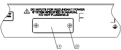

II. Rear panel
Figure 1-17 shows the rear panel of an S3100-26TP-EI-W Ethernet switch.
(1) AC power socket
(2) RPS DC power socket
(3) Grounding screw
Figure 1-17 Rear panel of an S3100-26TP-EI-W Ethernet switch
III. Power system
S3100-26TP-EI-W Ethernet switches can adopt AC input, or RPS 12 VDC input, or both to provide backup. Only the recommended RPS can be used.

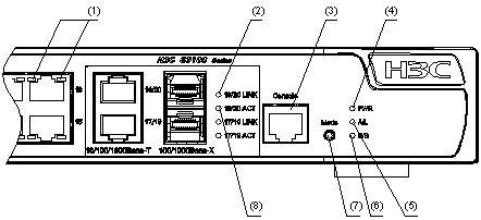

S3100-16TP-EI-W Ethernet switches each provide sixteen auto-sensing 10/100Base-TX Ethernet ports, two 10/100/1000Base-T Ethernet ports, two 100/1000Base-X SFP ports, and one console port. Each SFP port and the corresponding 10/100/1000BASE-T Ethernet port form a Combo port. For each Combo port, either the SFP port or the corresponding 10/100/1000BASE-T Ethernet port can be used at a time.
Figure 1-18 shows the front panel of an S3100-16TP-EI-W Ethernet switch.
(3) Console port
(4) Power LED (PWR)
(5) A/L LED
(6) D/S LED
(7) Mode button
(8) Active LED for Combo port
Figure 1-18 Front panel of an S3100-16TP-EI-W Ethernet switch
&  Note:

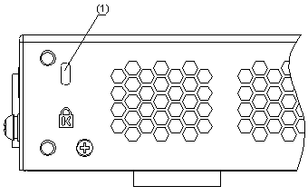

III. Side panel
Each S3100-16TP-EI-W Ethernet switch provides a security slot, through which you can lock the device together with an irremovable object to prevent theft.
The security slot is located at the rear end of the left side panel, as shown in Figure 1-20.
(1) Security slot
Figure 1-20 Security slot on left side panel of an S3100-16TP-EI-W Ethernet switch
&  Note:
If the left screw hole above the security slot is used, the security slot cannot be used.

S3100-16TP-PWR-EI Ethernet switches each provide sixteen auto-sensing 10/100Base-TX Ethernet ports, two 10/100/1000Base-T Ethernet ports, two 100/1000Base-X SFP ports, and one console port. Each SFP port and the corresponding 10/100/1000BASE-T Ethernet port form a Combo port. For each Combo port, either the SFP port or the corresponding 10/100/1000BASE-T Ethernet port can be used at a time.
Figure 1-25 shows the front panel of an S3100-16TP-PWR-EI Ethernet switch.
(3) Console port
(4) Power LED (PWR)
(5) A/L LED
(6) D/S LED
(7) Mode button
Figure 1-25 Front panel of an S3100-16TP-PWR-EI Ethernet switch
&  Note:
II. Rear panel
(1) AC power socket
(2) Grounding screw
Figure 1-26 Rear panel of an S3100-16TP-PWR-EI Ethernet switch

S3100-8TP-PWR-EI Ethernet switches each provide eight auto-sensing 10/100Base-TX Ethernet ports, one 10/100/1000Base-T Ethernet port, one 100/1000Base SFP ports, and one console port. The SFP port and the 10/100/1000BASE-T Ethernet port form a Combo port. Either the SFP port or the 10/100/1000BASE-T Ethernet port can be used at a time.
Figure 1-27 shows the front panel of an S3100-8TP-PWR-EI Ethernet switch.
(3) Console port
(4) Power LED (PWR)
(5) A/L LED
(6) D/S LED
(7) Mode button
Figure 1-27 Front panel of an S3100-8TP-PWR-EI Ethernet switch
&  Note:

1.3.7  S3100-26C-EPON-EI
I. Front panel
The S3100-26C-EPON-EI provides 24 x 10/100Base-TX ports, one Gigabit uplink PON port, one expansion slot, and one console port.
Figure 1-29 shows the front view of the S3100-26C-EPON-EI.
(1): Power Led (PWR)
(2): A/L LED
(3): D/S LED
(4): Port status LED, left (yellow)
(5): Port status LED, right (green)
(6): 10/100 Base-TX port
(7): ONU module
(8): Console port
(9): LINK LED for the uplink PON port
(10): ACT LED for the uplink PON port
(11): 1000 Mbps uplink PON port
(12): Expansion slot
(13): MODE button
Figure 1-29 Front panel of the S3100-26C-EPON-EI
&  Note:
l      The S3100-26C-EPON-EI provides one expansion slot. You can order one more ONU module (1000Base- PX20) as needed. For more information about ONU modules, refer to section 1.7  ONU Modules”.
l      For details about the LEDs on the front panel, refer to section 1.4  Introduction to Front Panel LEDs”.

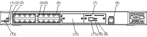

The S3100-16C-EPON-EI provides 16 x 10/100Base-TX Ethernet ports, one 1000 Mbps uplink PON port, and one console port.
Figure 1-31 shows the front panel of the S3100-16C-EPON-EI.
(2): A/L LED
(3): D/S LED
(7): ONU module
(8): Console port
(12): Expansion slot (disabled)
(13): MODE button
Figure 1-31 Front panel of the S3100-16C-EPON-EI
&  Note:
l      The S3100-16C-EPON-EI supports only one ONU module (required).

1.3.9  S3100-8C-EPON-EI
I. Front panel
The S3100-8C-SI provides 8 x 10/100Base-TX Ethernet ports, one 1000 Mbps uplink PON port, and one console port.
Figure 1-33 shows the front panel of the S3100-8C-EPON-EI.
(1): Power LED (PWR)
(2): A/L LED
(3): D/S LED
(7): ONU module
(8): Console port
(9): Link LED for the uplink PON port
(12): MODE button
Figure 1-33 Front panel of the S3100-8C-EPON-EI
&  Note:
II. Rear panel
(1) AC power socket
(2) Grounding screw
Figure 1-34 Rear panel of an S3100-8C-EPON-EI Ethernet switch
III. Power system
S3100-8C-EPON-EI Ethernet switches support AC input.
IV. Cooling system
The S3100-8C-EPON-EI cool off naturally.

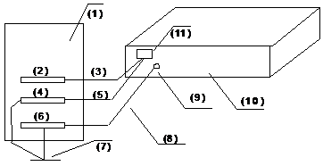

2.2.3  Anti-interference Requirements
A switch in use may be affected by the interference from outside the system by way of capacitance coupling, inductance coupling, electromagnetic radiation, public impedance (including the grounding system) coupling or conducting line (power line, signaling line, and transmission line). Therefore, you should pay attention to the following:
l           If AC supply system is TN system, AC power socket should be a single-phase three-line power socket with Protection Earth (PE) so that the filter circuit on the equipment can effectively filter out the interference coming from the power supply system.
l           Keep the switch far away from high-power radio transmitters, radars, and high-frequency heavy-current devices.
l           Adopt electromagnetic shielding measure if necessary. For example, you can adopt shielded interface cable.
l           Wire interface cables indoors. Do not wire cables outdoors in case that over-voltage and over-current damage the device.

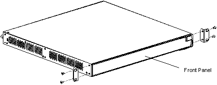

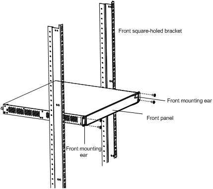

II. Use front mounting ears to install a switch
Follow these steps to mount a switch into a 19-inch standard cabinet:
1)         Wear an ESD-preventive wrist strap to check the grounding and stability of the cabinet.
2)         Take out the screws which are packed together with the front mounting ears, and fix one end of mounting ears to the switch, as shown in Figure 3-3.
Figure 3-3 Fix front mounting ears (1)
3)         Place the switch horizontally in a proper position, and fix the other end of mounting ears to the front brackets with screws and captive nuts, as shown in Figure 3-4.
Figure 3-4 Fix front mounting ears (2)

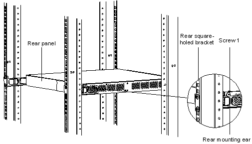

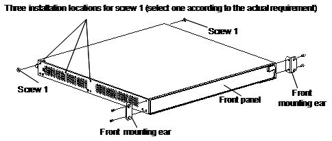

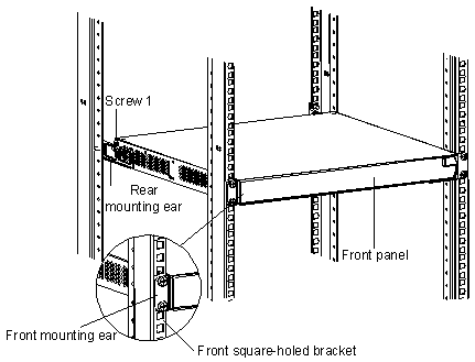

IV. Use front and rear mounting ears
Follow these steps to install a switch into a 19-inch standard cabinet:
3)         Take out the load-bearing screws (packed together with the rear mounting ears) and place them in a proper position on the sides of the switch, as shown in Figure 3-5.
Screw 1: Load-bearing screw
Figure 3-5 Fix front mounting ears and load-bearing screws
&  Note:
There are three positions to mount a load-bearing screw on both sides of a switch. You should select a proper position according to the actual requirements. The rear mounting ears tightly contacted with the load-bearing screws can support the switch.
4)         Select a position to install the switch and fix the rear mounting ears to the rear brackets with screws and captive nuts, as shown in Figure 3-6.
Figure 3-6 Fix rear mounting ears

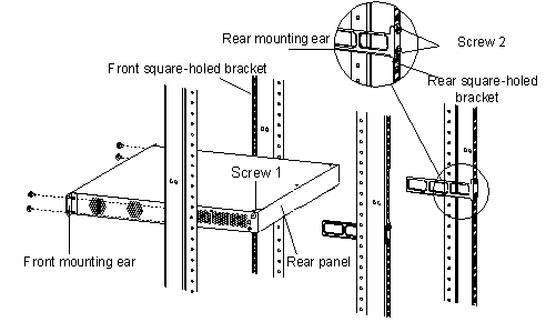

5)         Hold the bottom of the switch with one hand and the front part of the switch with the other hand, and push the switch into the cabinet gently, as shown in Figure 3-7.
Screw 1: Used to bear the weight
Screw 2: Used to fix rear mounting ears to rear brackets
Figure 3-7 Fix front and rear mounting ears
After the switch is pushed into the cabinet, ensure that the upper edge of rear mounting ears is tightly contacted with the load-bearing screw, as shown in Figure 3-8.
Figure 3-8 Effect diagram of front and rear mounting ear installation (1)
6)         Fix the other end of the front mounting ears to the front brackets with screws and captive nuts and ensure that front and rear mounting ears have fixed the switch in the cabinet securely, as shown in Figure 3-9.
Figure 3-9 Effect diagram of front and rear mounting ear installation (2)

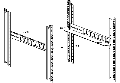

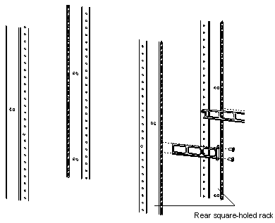

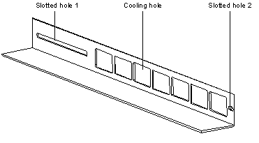

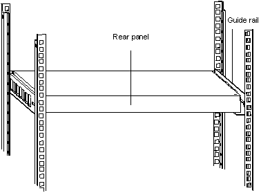

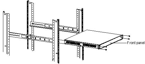

V. Use front mounting ears and guide rails
l           Introduction to guide rail
Figure 3-10 shows the appearance of a guide rail.
Slotted hole 1: Used to fix the guide rail to the rear bracket. You can adjust the screw hole position according to the position of the switch.
Cooling hole: Used for heat dissipation between switch and cabinet
Slotted hole 2: Used to fix the guide rail to the front bracket
Figure 3-10 Appearance of a guide rail
&  Note:
Guide rails purchased from H3C apply only to standard cabinets 1,000 mm (39.4 in) deep. Use other supports to substitute for guide rails in the case of other cabinet depths.
l           Installation procedure
2)         Take out the screws packed together with the front mounting ears and fix one end of the front mounting ears to the switch, as shown in Figure 3-3.
3)         Install guide rails on the brackets on both sides of the cabinet with M5 self-tapping screws. Figure 3-11 is for reference only.
Figure 3-11 Install guide rails
4)         Hold the two sides of the switch and slide it gently along the guide rails into the cabinet until it is located in a proper position, as shown in Figure 3-12. Ensure that the bottom side of the guide rails and the switch are in close contact.
Figure 3-12 Install front mounting ears and guide rails
5)         Fix the other end of front mounting ears to the front brackets of the cabinet with M6 screws and captive nuts and ensure that the front mounting ears and guide rails have fixed the switch in the cabinet securely, as shown in Figure 3-13.
Figure 3-13 Effect diagram of front mounting ear and guide rail installation
&  Note:
l      No guide rails are delivered with the device.
l      Ensure a clearance of 1U (44.45 mm, namely, 1.75 inches) between devices for the purpose of heat dissipation.

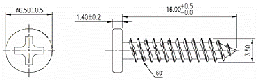

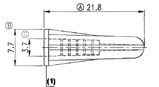

I. Introduction to screw and anchor kit
Figure 3-14 and Figure 3-15 show the recommended sizes (in mm) of screws and anchor kits used for mounting:
Figure 3-14 Screw
(1) Outside edge of anchor kit
Figure 3-15 Anchor kit

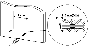

1)         As shown in Figure 3-16, drill two holes 5 mm across in the wall on the same horizontal line, with a distance of X mm.
&  Note:
l      The distance X between holes varies with devices. For specific distances, see Table 3-4.
l      Drill two holes according to the sizes of anchor kits and screws so that anchor kits could go into the holes, only the edges could remain outside the wall, and the screws could be fixed on the wall tightly.
2)         Insert anchor kits into the holes and keep only the edges outside the wall.
3)         Drive screws into the anchor kits, keeping the inside of screw head at least 1.5 mm (0.06 in) away from the edge of the anchor kit so that the switch could hang on the screws securely.
Figure 3-16 Wall mounting

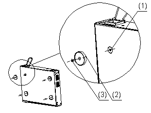

3.1.4  Magnet Mounting
The following four models support magnet mounting:
l           S3100-8TP-EI-W
l           S3100-8TP-PWR-EI
l           S3100-16TP-EI-W
l           S3100-16TP-PWR-EI
I. Introduction to magnetic mounting accessories
A set of magnetic mounting accessories consists of one permanent magnets and one M3*6 countersunk head screws, as shown in Figure 3-17. Four sets of magnetic mounting accessories are needed for each S3100 switch.
(1) Permanent magnet
(2) M3*6 countersunk head screw
Figure 3-17 Magnet and countersunk head screw
II. Installation procedure
Follow these steps to complete magnet mounting:
1)         As shown in Figure 3-18, use a Phillips screwdriver to pass the countersunk head screw through the round hole at the center of the permanent magnet, fasten it to a blind nut in the dent of the switch bottom, and ensure that the permanent magnet and the switch are fastened reliably.
&  Note:
l      Remove the cushion, if any, from the dent before installation.
l      To ensure the firmness of installation, be sure to use four permanent magnets to secure each S3100 switch.
2)         Attach the magnet-mounted device to the specified location. Take care not to get your fingers stuck between because the magnetism is very huge.
(1) Blind nut in the dent of the switch bottom
(2) Permanent magnet
(3) M3*6 countersunk head screw
Figure 3-18 Magnet mounting
  Caution:
l      Apply magnet mounting to only the above four models. Otherwise, a falloff or mis-operation may occur.
l      Select the installation location carefully. In the case of poor surface, magnet mounting may not be reliable.
l      Put the device at a stable place free from vibrations or shocks. Otherwise, personal injuries or equipment damage may occur.
l      Avoid installing the device at a high place because personal injuries or equipment damage may occur in case of a falloff.

3.3  Connection of Power Cable and Grounding Cable
3.3.1  Connecting AC Power Cable
I. AC power socket (recommended)
You are recommended to use a mono-phase three-core power socket with a neutral point or a multi-function power socket for computers. The neutral point of the power in your building must be well grounded. Normally, the neutral point of the power supply system in your building has already been grounded during the construction and wiring; but you should make sure this is the fact.
Figure 3-19 Recommended AC power socket
II. Connecting AC power cable
1)         Connect one end of the grounding cable (delivered with the switch) to the grounding screw on the rear of the chassis and the other end to the ground nearby.
2)         Connect one end of the power cable to the power socket on the rear panel of the chassis and the other end to an outside AC power socket.

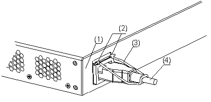

3)         Install the power cord retainer for the AC power cord on S3100-TP-PWR-EI series Ethernet Switches. Insert the two ends of the power cord retainer into the slots at both sides of the AC power input, and then set the power cord into the notch of the power cord retainer, as shown in Figure 3-20.
(1): Rear panel
(2): Power cord retainer holder
(3): Power cord retainer
(4): Power cord
Figure 3-20 Install the power cord retainer
&  Note:
l      Currently, only the S3100-TP-PWR-EI series Ethernet Switches are equipped with an AC power cord retainer to prevent the power cord from accidentally falling off.
l      The location of the power cord retainer holder varies with S3100-TP-PWR-EI series Ethernet Switches.
4)         Check whether the PWR LED on the front panel of the switch is ON. If yes, the power is properly connected.
  Caution:
Before powering on the switch, you should properly connect the grounding cable.

I. DC power cable connection for S3100-C-SI DC-powered Ethernet switch
(1) Screw 1
(2) Screw 2
(3) RTN (+) terminal
(4) NEG(-) terminal (–48 V to –60 V)
(5) Grounding screw
Figure 3-21 DC input terminal block of S3100-C-SI DC-powered Ethernet switch
&  Note:
The location of the DC input terminal block varies with devices.
1)         Connect one end of the grounding cable (delivered with the switch) to the grounding screw and the other end to the ground nearby.
2)         Use a flat-blade screwdriver to loosen the two screws on the DC input terminal blocks. Connect the power ground return cable to the RTN(+) terminal and the power output cable to the NEG(-) terminal. Tighten the two screws respectively to fix the power cables.
3)         Check whether the PWR LED on the front panel of the switch is ON. If yes, the power is properly connected.
  Caution:
l      Before powering on the switch, you should properly connect the grounding cable.
l      The DC power cable should be less than 3 meters long.

3.3.3  Connecting Grounding Cable
  Caution:
You should properly connect the switch grounding cable since it is crucial to the lightning protection and electromagnetic shield (EMS) of your switch.
The power input end of the switch is connected with a noise filter, whose central ground is directly connected to the chassis, forming the so-called chassis ground (commonly known as PGND). This chassis ground must be securely connected to the earth so that the faradism and leakage electricity can be safely released to the earth, enhancing the EMS capability of the switch.
Ground the switch as follows:
l           When a grounding strip is available at the installation site, attach one end of the yellow-green grounding cable of the switch to the grounding screw on the grounding strip and fasten the captive nut. (Note that the fire main and lightning rod of your building are not suitable for grounding the switch. The grounding cable of the switch should be connected to the construction engineering ground of the equipment room.)
(1) Power input
(2) Grounding screw
(3) Protection grounding cable
(4) Grounding strip
Figure 3-28 Ground the switch through a grounding strip

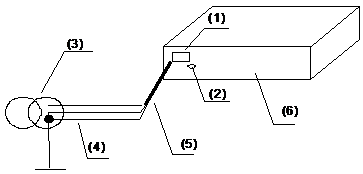

l           For an AC-powered switch, if none of the above two conditions is available, ground it through the PE cable of the AC power supply. In this case, make sure this PE cable is well connected to the ground at the power distribution room or AC transformer.
(1) AC power socket
(2) Grounding screw
(3) Power transformer
(4) PE cable
(5) 3-core cable for AC power input
(6) Ethernet switch
Figure 3-30 Ground the switch through AC PE cable
l           For a DC-powered switch (–48 VDC), if none of the first two conditions is available, ground it through the return cable (RTN) of the DC power supply. In this case, make sure this RTN cable is well connected to the ground at the DC output of the DC power cabinet.
(1) AC/DC power cabinet
(2) –48V strip
(3) –48V
(4) RTN strip
(5) RTN
(6) PGND strip
(7) Grounding to the earth
(8) Grounding cable
(9) Screw
(10) Ethernet switch
(11) DC power input
Figure 3-31 Ground the switch through the PGND of the power cabinet

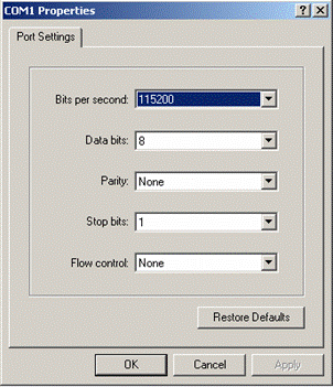

4.3  Setting Terminal Parameters
Step 1: Start the PC and run the terminal emulation program such as the Terminal of Windows3.1 or the HyperTerminal of Windows95/98/NT/2000/XP.
Step 2: Set terminal parameters (take the HyperTerminal of Windows2000 as an example).
Parameter requirements: Set bits per second to 9600, data bits to 8, parity check to none, stop bits to 1 and flow control to none. Select VT100 as terminal emulation. The following is the specific procedure:

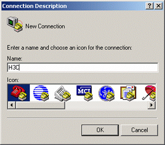

1)         Select [Start/Program/Accessories/Communications/HyperTerminal] to enter the HyperTerminal window, where click the  icon to establish a new connection. The system displays the Connection Description interface, as shown in the following figure.
Figure 4-2 Connection description interface of HyperTerminal

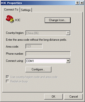

2)         Type in the name of the new connection in the connection description interface and click <OK>. The system pops up the following interface. Select the serial port to be used from [Connect using].
Figure 4-3 Setting the serial port used by the HyperTerminal connection
3)         Click <OK> after selecting a serial port and the system pops up the following interface. In the interface, set the bits per second to 9600, data bits to 8, parity check to none, stop bits to 1, and flow control to none.
Figure 4-4 Setting serial port parameters

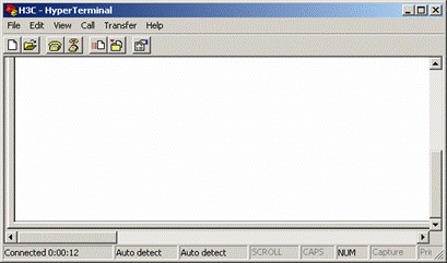

4)         Click <OK> after setting the serial port parameters, and the system enters the following interface.
Figure 4-5 HyperTerminal
Choose [Properties] in the HyperTerminal dialog box to enter the properties window. Click [Settings] to enter the following properties setting window, and select VT100 as the terminal emulation. Click <OK> when the selection is done.
Figure 4-6 Set terminal emulation in H3C Properties window

Step 4: Select [File/Properties] in HyperTerminal, click <Configuration> in the popup dialog box, and select the bits per second of 115200bps in the appeared console port configuration dialog box.
Figure 5-1 Properties dialog box
Figure 5-2 Console port configuration dialog box
Step 5: Click the <Disconnect> button to disconnect the HyperTerminal from the switch and then click the <Call> button to reconnect the HyperTerminal to the switch.
Figure 5-3 Call and disconnect buttons
&  Note:
The new bits per second takes effect only after you disconnect and reconnect the terminal emulation program.

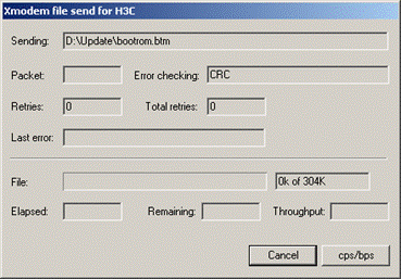

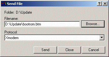

Step 7: Choose [Transfer/Send File] in the HyperTerminal’s window, and in the following popup dialog box click <Browse>, select the software you need to download, and set the protocol to XModem.
Figure 5-4 Send file dialog box
Step 8: Click <Send>. The system displays the following page.
Figure 5-5 Sending file page

I. Troubleshooting when there is no terminal display
If there is no output information after the configuration is powered on, please check that:
l           The power supply is normal
l           The console cable is properly connected
If no problems are found after the above-mentioned items have been checked, the cause may lie in the console cable or the settings of the terminal (such as HyperTerminal) parameters. Please perform the corresponding check.
II. Troubleshooting when the terminal display is illegible
If there is illegible display at the configuration terminal, the cause might lie in the parameter setting error at the terminal (such as HyperTerminal). Please confirm the following terminal parameter (such as HyperTerminal) settings:
l           Bits per second: 9600
l           Data bits: 8
l           Parity check: None
l           Stop bits: 1
l           Flow control: None
Terminal emulation: VT100.
