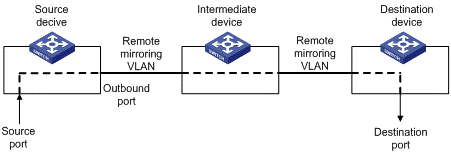

II. Remote port mirroring
Remote port mirroring is achieved through the cooperation of remote source port mirroring group and remote destination port mirroring group.
Figure 1-2 illustrates a remote port mirroring implementation.
Figure 1-2 A remote mirroring implementation
The devices in Figure 1-2 function as follows:
l           Source device
Source device contains source mirroring ports, and remote source port mirroring groups are created on source devices. A source device duplicates the packets passing the source ports on it and sends them to the outbound port. The packets are then broadcast in the remote mirroring VLAN and are received by the intermediate device or destination device.
l           Intermediate device
Intermediate devices are used to connect source devices and destination devices. An intermediate device forwards the mirrored packets to the next intermediate device or the destination device. If the source device is directly connected to the destination device, no intermediate device is needed. In a remote mirroring VLAN, the source devices and the destination device need to be able to communicate with one another on Layer 2.
l           Destination device
Destination device contains destination mirroring port, and remote destination port mirroring groups are created on destination devices. Upon receiving a mirrored packet, the destination device checks to see if the VLAN ID of the received packet is the same as that of the remote mirroring VLAN of the remote destination port mirroring group. If yes, the destination device forwards the packet to the monitoring device through the destination mirroring port.

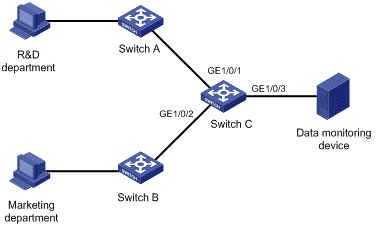

1.5.1  Local Port Mirroring Configuration Example
I. Network requirements
The departments of a company connect to each other through Ethernet switches:
l           Research and Development (R&D) department is connected to Switch C through GigabitEthernet 1/0/1.
l           Marketing department is connected to Switch C through GigabitEthernet 1/0/2.
l           Data monitoring device is connected to Switch C through GigabitEthernet 1/0/3
The administrator wants to monitor the packets received on and sent from the R&D department and the marketing department through the data monitoring device.
Use the local port mirroring function to meet the requirement. Perform the following configurations on Switch C.
l           Configure GigabitEthernet 1/0/1 and GigabitEthernet 1/0/2 as mirroring source ports.
l           Configure GigabitEthernet 1/0/3 as the mirroring destination port.
II. Network diagram
Figure 1-3 Network diagram for local port mirroring configuration
III. Configuration procedure
Configure Switch C.
# Create a local port mirroring group.
<SwitchC> system-view
[SwitchC] mirroring-group 1 local
# Add port GigabitEthernet 1/0/1 and GigabitEthernet 1/0/2 to the port mirroring group as source ports. Add port GigabitEthernet 1/0/3 to the port mirroring group as the destination port.
[SwitchC] mirroring-group 1 mirroring-port GigabitEthernet 1/0/1 GigabitEthernet 1/0/2 both
[SwitchC] mirroring-group 1 monitor-port GigabitEthernet 1/0/3
# Display the configuration of all the port mirroring groups.
[SwitchC] display mirroring-group all
mirroring-group 1:
    type: local
    status: active
    mirroring port:
        GigabitEthernet1/0/1  both
        GigabitEthernet1/0/2  both
    monitor port: GigabitEthernet1/0/3
After finishing the configuration, you can monitor all the packets received and sent by R&D department and Marketing department on the Data monitoring device.

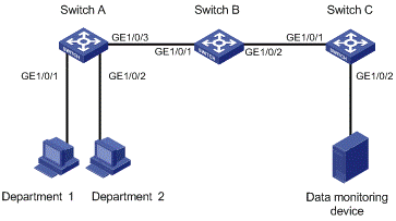

1.5.2  Remote Port Mirroring Configuration Example
l           Department 1 is connected to GigabitEthernet 1/0/1 of Switch A.
l           Department 2 is connected to GigabitEthernet 1/0/2 of Switch A.
l           GigabitEthernet 1/0/3 of Switch A connects to GigabitEthernet 1/0/1 of Switch B.
l           GigabitEthernet 1/0/2 of Switch B connects to GigabitEthernet 1/0/1 of Switch C.
l           The data monitoring device is connected to GigabitEthernet 1/0/2 of Switch C.
The administrator wants to monitor the packets sent from Department 1 and 2 through the data monitoring device.
Use the remote port mirroring function to meet the requirement. Perform the following configurations:
l           Use Switch A as the source device, Switch B as the intermediate device, and Switch C as the destination device.
l           On Switch A, create a remote source mirroring group; create VLAN 2 and configure it as the remote port mirroring VLAN; add port GigabitEthernet 1/0/1 and GigabitEthernet 1/0/2 to the port mirroring group as two source ports. Configure port GigabitEthernet 1/0/3 as the outbound mirroring port.
l           Configure port GigabitEthernet 1/0/3 of Switch A, port GigabitEthernet 1/0/1 and GigabitEthernet 1/0/2 of Switch B, and port GigabitEthernet 1/0/1 of Switch C as trunk ports and configure them to permit packets of VLAN 2.
l           Create a remote destination mirroring group on Switch C. Configure VLAN 2 as the remote port mirroring VLAN and port GigabitEthernet 1/0/2, to which the data monitoring device is connected, as the destination port.
II. Network diagram
Figure 1-4 Network diagram for remote port mirroring configuration
1)         Configure Switch A (the source device).
# Create a remote source port mirroring group.
<SwitchA> system-view
[SwitchA] mirroring-group 1 remote-source
# Create VLAN 2.
[SwitchA] vlan 2
[SwitchA-vlan2] quit
# Configure VLAN 2 as the remote port mirroring VLAN of the remote port mirroring group. Add port GigabitEthernet 1/0/1 and GigabitEthernet 1/0/2 to the remote port mirroring group as source ports. Configure port GigabitEthernet 1/0/3 as the outbound mirroring port.
[SwitchA] mirroring-group 1 remote-probe vlan 2
[SwitchA] mirroring-group 1 mirroring-port GigabitEthernet 1/0/1 GigabitEthernet 1/0/2 inbound
[SwitchA] mirroring-group 1 monitor-egress GigabitEthernet 1/0/3
# Configure port GigabitEthernet 1/0/3 as a trunk port and configure the port to permit the packets of VLAN 2.
[SwitchA] interface GigabitEthernet 1/0/3
[SwitchA-GigabitEthernet1/0/3] port link-type trunk
[SwitchA-GigabitEthernet1/0/3] port trunk permit vlan 2
2)         Configure Switch B (the intermediate device).
# Configure port GigabitEthernet 1/0/1 as a trunk port and configure the port to permit the packets of VLAN 2.
<SwitchB> system-view
[SwitchB] interface GigabitEthernet 1/0/1
[SwitchB-GigabitEthernet1/0/1] port link-type trunk
[SwitchB-GigabitEthernet1/0/1] port trunk permit vlan 2
[SwitchB-GigabitEthernet1/0/1] quit
# Configure port GigabitEthernet 1/0/2 as a trunk port and configure the port to permit the packets of VLAN 2.
[SwitchB] interface GigabitEthernet 1/0/2
[SwitchB-GigabitEthernet1/0/2] port link-type trunk
[SwitchB-GigabitEthernet1/0/2] port trunk permit vlan 2
3)         Configure Switch C (the destination device).
[SwitchC] interface GigabitEthernet 1/0/1
[SwitchC-GigabitEthernet1/0/1] port link-type trunk
[SwitchC-GigabitEthernet1/0/1] port trunk permit vlan 2
[SwitchC-GigabitEthernet1/0/1] quit
# Create a remote destination port mirroring group.
[SwitchC] mirroring-group 1 remote-destination
# Create VLAN 2.
[SwitchC] vlan 2
[SwitchC-vlan2] quit
# Configure VLAN 2 as the remote port mirroring VLAN of the remote destination port mirroring group. Add port GigabitEthernet 1/0/2 to the remote destination port mirroring group as the destination port.
[SwitchC] mirroring-group 1 remote-probe vlan 2
[SwitchC] mirroring-group 1 monitor-port GigabitEthernet 1/0/2
[SwitchC] interface GigabitEthernet 1/0/2
[SwitchC-GigabitEthernet1/0/2] port access vlan 2
After finishing the configuration, you can monitor all the packets sent by Department 1 and Department 2 on the Data monitoring device.
