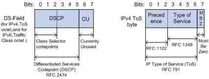

1)         IP precedence, ToS precedence, and DSCP precedence
Figure 2-1 DS field and ToS field
The ToS field in an IP header contains eight bits, which are described as follows:
l           The first three bits indicate IP precedence in the range of 0 to 7.
l           Bit 3 to bit 6 indicate ToS precedence in the range of 0 to 15.
l           RFC2474 re-defines the ToS field in the IP packet header, which is called the DS field. The first six (bit 0 to bit 5) bits of the DS field indicate DSCP precedence in the range of 0 to 63. The last two bits (bit 6 and bit 7) are reserved bits.

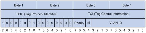

2)         802.1p precedence
802.1p precedence lies in Layer 2 packet headers and is applicable to occasions where the Layer 3 packet header does not need analysis but QoS must be assured at Layer 2.
Figure 2-2 An Ethernet frame with an 802.1Q tag header
As shown in the figure above, the 4-byte 802.1Q tag header contains a 2-byte Tag Protocol Identifier (TPID) whose value is 8100 and a 2-byte Tag Control Information (TCI). TPID is a new class defined by IEEE to indicate a packet with an 802.1Q tag. Figure 2-3 describes the detailed contents of an 802.1Q tag header.
Figure 2-3 802.1Q tag headers
In the figure above, the 3-bit priority field in TCI is 802.1p precedence in the range of 0 to 7. In the figure above, the priority field (three bits in length) in TCI is 802.1p precedence (also known as CoS precedence), which ranges from 0 to 7.

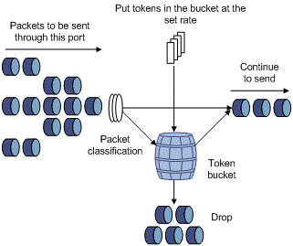

A token bucket can be considered as a container with a certain capacity to hold tokens. The system puts tokens into the bucket at a pre-set rate. When the token bucket is full, the extra tokens will overflow and the number of tokens in the bucket stops increasing.
Figure 2-4 Evaluate traffic with a token bucket
2.3.2  Evaluating Traffic with a Token Bucket
The evaluation for the traffic specification is based on whether the number of tokens in the bucket can meet the need of packet forwarding. If the number of tokens in the bucket is enough to forward the packets, the traffic is conforming to the specification; otherwise, the traffic is nonconforming or excess.
When the token bucket evaluates the traffic, its parameter configurations include:
l           Average rate: The rate at which tokens are put into the bucket, namely, the permitted average rate of the traffic. It is generally set to committed information rate (CIR).
l           Burst size: The capacity of the token bucket, namely, the maximum traffic size that is permitted in each burst. It is generally set to committed burst size (CBS). The set burst size must be greater than the maximum packet length.

2.3.5  LR
Port rate limiting refers to limiting the total rate of inbound or outbound packets on a port.
Port rate limiting can be implemented through token buckets. That is, if you perform port rate limiting configuration for a port, the token bucket determines the way to process the packets to be sent by this port or packets reaching the port. Packets can be sent or received if there are enough tokens in the token bucket; otherwise, they will be dropped.
Compared to TP, port rate limiting applies to all the packets passing a port. It is a simpler solution if you want to limit the rate of all the packets passing a port.

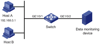

7.4.1  Network Requirements
The user's network is as described below:
l           Host A (with the IP address 192.168.0.1) and Host B are connected to GigabitEthernet1/0/1 of the switch.
l           The data monitoring device is connected to GigabitEthernet1/0/2 of the switch.
It is required to monitor and analyze packets sent by Host A on the data monitoring device.
Figure 7-1 Network diagram for configuring traffic mirroring to a port
7.4.2  Configuration Procedure
Configure Switch:
# Enter system view.
<Sysname> system-view
# Configure basic IPv4 ACL 2000 to match packets with the source IP address 192.168.0.1.
[Sysname] acl number 2000
[Sysname-acl-basic-2000] rule permit source 192.168.0.1 0
[Sysname-acl-basic-2000] quit
# Configure a traffic classification rule to use ACL 2000 for traffic classification.
[Sysname] traffic classfier 1
[Sysname-classifier-1] if-match acl 2000
[Sysname-classifier-1] quit
# Configure a traffic behavior and define the action of mirroring traffic to GigabitEthernet1/0/2 in the traffic behavior.
[Sysname] traffic behavior 1
[Sysname-behavior-1] mirror-to interface GigabitEthernet 1/0/2
[Sysname-behavior-1] quit
# Configure a QoS policy and associate traffic behavior 1 with classification rule 1.
[Sysname] qos policy 1
[Sysname-policy-1] classifier 1 behavior 1
[Sysname-policy-1] quit
# Apply the policy in the inbound direction of GigabitEthernet1/0/1.
[Sysname] interface GigabitEthernet 1/0/1
[Sysname-GigabitEthernet1/0/1] qos apply policy 1 inbound
After the configurations, you can monitor all packets sent from Host A on the data monitoring device.
