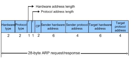

1.1.2  ARP Message Format
Figure 1-1 ARP message format
The following explains the fields in Figure 1-1.
l           Hardware type: This field specifies the hardware address type. The value “1” represents Ethernet.
l           Protocol type: This field specifies the type of the protocol address to be mapped. The hexadecimal value “0x0800” represents IP.
l           Hardware address length and protocol address length: They respectively specify the length of a hardware address and a protocol address, in bytes. For an Ethernet address, the value of the hardware address length field is "6”. For an IP(v4) address, the value of the protocol address length field is “4”.
l           OP: Operation code. This field specifies the type of ARP message. The value “1” represents an ARP request and “2” represents an ARP reply.
l           Sender hardware address: This field specifies the hardware address of the device sending the message.
l           Sender protocol address: This field specifies the protocol address of the device sending the message.
l           Target hardware address: This field specifies the hardware address of the device the message is being sent to.
l           Target protocol address: This field specifies the protocol address of the device the message is being sent to.

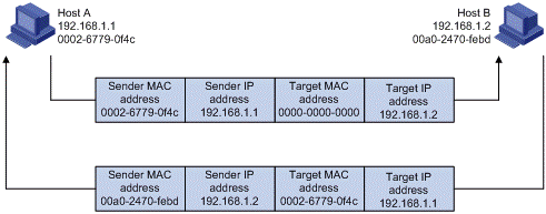

1.1.3  ARP Address Resolution Process
Suppose that Host A and Host B are on the same subnet and that Host A sends a message to Host B, as show in Figure 1-2. The resolution process is as follows:
1)         Host A looks in its ARP mapping table to see whether there is an ARP entry for Host B. If Host A finds it, Host A uses the MAC address in the entry to encapsulate the IP packet into a data link layer frame and sends the frame to Host B.
2)         If Host A finds no entry for Host B, Host A buffers the packet and broadcasts an ARP request, in which the source IP address and source MAC address are respectively the IP address and MAC address of Host A and the destination IP address and MAC address are respectively the IP address of Host B and an all-zero MAC address. Because the ARP request is sent in broadcast mode, all hosts on this subnet can receive the request, but only the requested host (namely, Host B) will process the request.
3)         Host B compares its own IP address with the destination IP address in the ARP request. If they are the same, Host B saves the source IP address and source MAC address into its ARP mapping table, encapsulates its MAC address into an ARP reply, and unicasts the reply to Host A.
4)         After receiving the ARP reply, Host A adds the MAC address of Host B into its ARP mapping table for subsequent packet forwarding. Meanwhile, Host A encapsulates the IP packet and sends it out.
Figure 1-2 ARP address resolution process

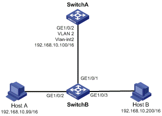

2.4.2  Local Proxy ARP Configuration Example in Case of Port Isolation
I. Network requirements
l           Host A and Host B belong to the same VLAN, and are connected to GigabitEthernet 1/0/2 and GigabitEthernet 1/0/3 of Switch B respectively.
l           Switch B is connected to Switch A via GigabitEthernet 1/0/1.
l           GigabitEthernet 1/0/2 and GigabitEthernet 1/0/3 isolated at Layer 2 can implement Layer 3 communication.
II. Network diagram
Figure 2-2 Network diagram for local proxy ARP between isolated ports
III. Configuration procedure
1)         Configure Switch B
# Create VLAN 2 on Switch B, on which GigabitEthernet 1/0/1, GigabitEthernet 1/0/2 and GigabitEthernet 1/0/3 belong to VLAN 2. Host A and Host B are isolated and unable to exchange Layer 2 packets.
<SwitchB> system-view
[SwitchB] vlan 2
[SwitchB-vlan2] port gigabitethernet 1/0/1
[SwitchB-vlan2] port gigabitethernet 1/0/2
[SwitchB-vlan2] port gigabitethernet 1/0/3
[SwitchB-vlan2] quit
[SwitchB] interface gigabitethernet 1/0/2
[SwitchB-GigabitEthernet1/0/2] port-isolate enable
[SwitchB-GigabitEthernet1/0/2] quit
[SwitchB] interface gigabitethernet 1/0/3
[SwitchB-GigabitEthernet1/0/3] port-isolate enable
[SwitchB-GigabitEthernet1/0/3] quit
2)         Configure Switch A
# Configure an IP address of VLAN-interface 2.
[SwitchA] vlan 2
[SwitchA-vlan2] port gigabitethernet 1/0/2
[SwitchA-vlan2] quit
[SwitchA-Vlan-interface2] ip address 192.168.10.100 255.255.0.0
Ping Host B on Host A to verify that the two hosts cannot be pinged through, which indicates they are isolated at Layer 2.
# Configure local proxy ARP to let Host A and Host B communicate at Layer 3.
[SwitchA-Vlan-interface2] local-proxy-arp enable
Ping Host B on Host A to verify that the two hosts can be pinged through, which indicates Layer 3 communication is implemented.
