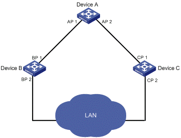

Figure 1-1 shows designated bridges and designated ports. In the figure, AP1 and AP2, BP1 and BP2, and CP1 and CP2 are ports on Device A, Device B, and Device C respectively.
l           If Device A forwards BPDUs to Device B through AP1, the designated bridge for Device B is Device A, and the designated port is the port AP1 on Device A.
l           Two devices are connected to the LAN: Device B and Device C. If Device B forwards BPDUs to the LAN, the designated bridge for the LAN is Device B, and the designated port is the port BP2 on Device B.
Figure 1-1 A schematic diagram of designated bridges and designated ports

The following is an example of how the STP algorithm works. The specific network diagram is shown in Figure 1-2. In the feature, the priority of Device A is 0, the priority of Device B is 1, the priority of Device C is 2, and the path costs of these links are 5, 10 and 4 respectively.
Figure 1-2 Network diagram for the STP algorithm

CP1: {0, 0, 0, AP2}
CP2: {1, 0, 1, BP2}
By comparison:
l      The configuration BPDU of CP1 is elected as the optimum configuration BPDU, so CP1 is identified as the root port, the configuration BPDUs of which will not be changed.
l      Device C compares the calculated designated port configuration BPDU {0, 10, 2, CP2} with the configuration BPDU of CP2, and CP2 becomes the designated port, and the configuration BPDU of this port will be replaced with the calculated configuration BPDU.
Root port CP1:
{0, 0, 0, AP2}
Designated port CP2:
{0, 10, 2, CP2}
l      Next, port CP2 receives the updated configuration BPDU of Device B {0, 5, 1, BP2}. Because the received configuration BPDU is superior to its old one, Device C launches a BPDU update process.
l      At the same time, port CP1 receives configuration BPDUs periodically from Device A. Device C does not launch an update process after comparison.
CP1: {0, 0, 0, AP2}
CP2: {0, 5, 1, BP2}
By comparison:
l      Because the root path cost of CP2 (9) (root path cost of the BPDU (5) plus path cost corresponding to CP2 (4)) is smaller than the root path cost of CP1 (10) (root path cost of the BPDU (0) + path cost corresponding to CP2 (10)), the BPDU of CP2 is elected as the optimum BPDU, and CP2 is elected as the root port, the messages of which will not be changed.
l      After comparison between the configuration BPDU of CP1 and the calculated designated port configuration BPDU, port CP1 is blocked, with the configuration BPDU of the port remaining unchanged, and the port will not receive data from Device A until a spanning tree calculation process is triggered by a new condition, for example, the link from Device B to Device C becomes down.
Blocked port CP2:
{0, 0, 0, AP2}
Root port CP2:
{0, 5, 1, BP2}
After the comparison processes described in the table above, a spanning tree with Device A as the root bridge is stabilized, as shown in Figure 1-3.

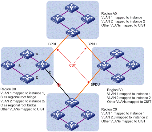

Assume that all the four switches in Figure 1-4 are running MSTP. In light with the diagram, the following paragraphs will present some basic concepts of MSTP.
Figure 1-4 Basic concepts in MSTP

For example, all the devices in region A0 in Figure 1-4 have the same MST region configuration:
l           The same region name,
l           The same VLAN-to-instance mapping (VLAN 1 is mapped to MST instance 1, VLAN 2 to MST instance 2, and the rest to the command and internal spanning tree (CIST). CIST refers to MST instance 0), and
l           The same MSTP revision level (not shown in the figure).

In Figure 1-4, for example, the CIST has a section in each MST region, and this section is the IST in the respective MST region.
4)         CST
The CST is a single spanning tree that connects all MST regions in a switched network. If you regard each MST region as a “device”, the CST is a spanning tree calculated by these devices through STP or RSTP. For example, the red lines in Figure 1-4 describe the CST.
5)         CIST
Jointly constituted by ISTs and the CST, the CIST is a single spanning tree that connects all devices in a switched network.
In Figure 1-4, for example, the ISTs in all MST regions plus the inter-region CST constitute the CIST of the entire network.
6)         MSTI
Multiple spanning trees can be generated in an MST region through MSTP, one spanning tree being independent of another. Each spanning tree is referred to as a multiple spanning tree instance (MSTI). In Figure 1-4, for example, multiple spanning tree can exist in each MST region, each spanning tree corresponding to a VLAN. These spanning trees are called MSTIs.
7)         Regional root bridge
The root bridge of the IST or an MSTI within an MST region is the regional root bridge of the MST or that MSTI. Based on the topology, different spanning trees in an MST region may have different regional roots.
For example, in region D0 in Figure 1-4, the regional root of instance 1 is device B, while that of instance 2 is device C.
8)         Common root bridge
The common root bridge is the root bridge of the CIST.
In Figure 1-4, for example, the common root bridge is a device in region A0.

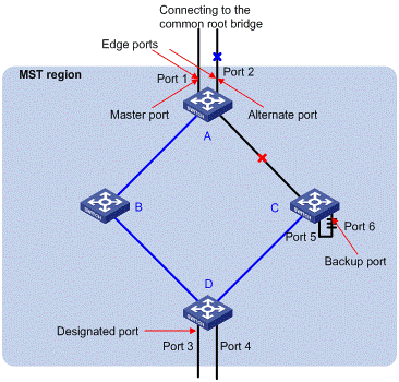

Figure 1-5 Port roles
Figure 1-5 helps understand these concepts. Where,
l           Devices A, B, C, and D constitute an MST region.
l           Port 1 and port 2 of device A connect to the common root bridge.
l           Port 5 and port 6 of device C form a loop.
l           Port 3 and port 4 of device D connect downstream to other MST regions.

l      The role a boundary port plays in an MSTI is consistent with the role it plays in the CIST. The master port, which is a root port in the CIST while a master port in the other MSTIs, is an exception.
l      For example, in Figure 1-5, port 1 on switch A is a boundary port. It is a root port in the CIST while a master port in all the other MSTIs in the region.
A port state is not exclusively associated with a port role. Table 1-6 lists the port state(s) supported by each port role (“√” indicates that the port supports this state, while “—“ indicates that the port does not support this state).

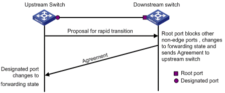

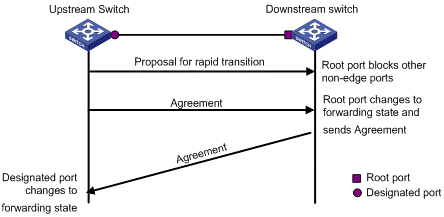

Two types of messages are used for rapid state transition on designated RSTP and MSTP ports:
l           Proposal: sent by designated ports to request rapid transition
l           Agreement: used to acknowledge rapid transition requests
Both RSTP and MSTP switches can perform rapid transition operation on a designated port only when the port receives an agreement packet from the downstream switch. The differences between RSTP and MSTP switches are:
l           For MSTP, the downstream device’s root port sends an agreement packet only after it receives an agreement packet from the upstream device.
l           For RSTP, the down stream device sends an agreement packet regardless of whether an agreement packet from the upstream device is received.
Figure 1-7 and Figure 1-8 show the rapid state transition mechanism on MSTP and RSTP designated ports.
Figure 1-7 Rapid state transition of a designated port in MSTP
Figure 1-8 Rapid state transition of a designated port in RSTP
If the upstream device comes from another vendor, the rapid state transition implementation may be limited. For example, when the upstream device adopts RSTP, the downstream device adopts MSTP and does not support RSTP mode, the root port on the downstream device receives no agreement packet from the upstream device and thus sends no agreement packets to the upstream device. As a result, the designated port of the upstream switch fails to transit rapidly and can only change to the forwarding state after a period twice the Forward Delay.
In this case, you can enable the No Agreement Check feature on the downstream device’s port to perform rapid state transition.

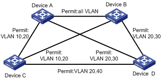

1.10  MSTP Configuration Example
I. Network requirements
Configure MSTP so that packets of different VLANs are forwarded along different spanning trees. The specific configuration requirements are as follows:
l           All devices on the network are in the same MST region.
l           Packets of VLAN 10 are forwarded along MST region 1, those of VLAN 30 are forwarded along MST instance 3, those of VLAN 40 are forwarded along MST instance 4, and those of VLAN 20 are forwarded along MST instance 0.
l           Device A and Device B are convergence layer devices, while Device C and Device D are access layer devices. VLAN 10 and VLAN 30 are terminated on the convergence layer devices, and VLAN 40 is terminated on the access layer devices, so the root bridges of MST instance 1 and MST instance 3 are Device A and Device B respectively, while the root bridge of MST instance 4 is Device C.
II. Network diagram
Figure 1-10 Network diagram for MSTP configuration
&  Note:
“Permit:“ beside each link in the figure is followed by the VLANs the packets of which are permitted to pass this link.
III. Configuration procedure
1)         Configuration on Device A
# Enter MST region view.
<DeviceA> system-view
[DeviceA] stp region-configuration
# Configure the region name, VLAN-to-instance mappings and revision level of the MST region.
[DeviceA-mst-region] region-name example
[DeviceA-mst-region] instance 1 vlan 10
[DeviceA-mst-region] instance 3 vlan 30
[DeviceA-mst-region] instance 4 vlan 40
[DeviceA-mst-region] revision-level 0
# Activate MST region configuration manually.
[DeviceA-mst-region] active region-configuration
[DeviceA-mst-region] quit
# Define Device A as the root bridge of MST instance 1.
[DeviceA] stp instance 1 root primary
# View the MST region configuration information that has taken effect.
[DeviceA] display stp region-configuration
 Oper configuration
   Format selector    :0
   Region name        :example
   Revision level     :0
   Instance   Vlans Mapped
      0       1 to 9, 11 to 29, 31 to 39, 41 to 4094
      1       10
      3       30
      4       40
2)         Configuration on Device B
<DeviceB> system-view
[DeviceB] stp region-configuration
[DeviceB-mst-region] region-name example
[DeviceB-mst-region] instance 1 vlan 10
[DeviceB-mst-region] instance 3 vlan 30
[DeviceB-mst-region] instance 4 vlan 40
[DeviceB-mst-region] revision-level 0
[DeviceB-mst-region] active region-configuration
[DeviceB-mst-region] quit
# Define Device B as the root bridge of MST instance 3.
[DeviceB] stp instance 3 root primary
[DeviceB] display stp region-configuration
 Oper configuration
   Format selector    :0
   Revision level     :0
      1       10
      3       30
      4       40
3)         Configuration on Device C
<DeviceC> system-view
[DeviceC] stp region-configuration
[DeviceC-mst-region] region-name example
[DeviceC-mst-region] instance 1 vlan 10
[DeviceC-mst-region] instance 3 vlan 30
[DeviceC-mst-region] instance 4 vlan 40
[DeviceC-mst-region] revision-level 0
[DeviceC-mst-region] active region-configuration
[DeviceC-mst-region] quit
# Define Device C as the root bridge of MST instance 4.
[DeviceC] stp instance 4 root primary
[DeviceC] display stp region-configuration
 Oper configuration
   Format selector    :0
   Revision level     :0
      1       10
      3       30
      4       40
4)         Configuration on Device D
<DeviceD> system-view
[DeviceD] stp region-configuration
[DeviceD-mst-region] region-name example
[DeviceD-mst-region] instance 1 vlan 10
[DeviceD-mst-region] instance 3 vlan 30
[DeviceD-mst-region] instance 4 vlan 40
[DeviceD-mst-region] revision-level 0
[DeviceD-mst-region] active region-configuration
[DeviceD-mst-region] quit
[DeviceD] display stp region-configuration
 Oper configuration
   Format selector    :0
   Revision level     :0
      1       10
      3       30
      4       40
