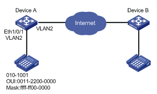

2.4  Voice VLAN Configuration Examples

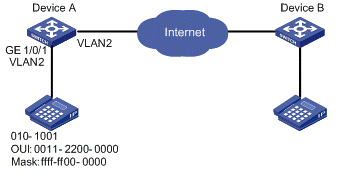

2.4.1  Automatic Voice VLAN Mode Configuration Example
I. Network requirement
l           Create VLAN 2 and configure it as a voice VLAN with an aging time of 100 minutes.
l           The voice traffic sent by the IP phones is tagged. Configure GigabitEthernet 1/0/1 as a Hybrid port and as the access port, with VLAN 6 as the default VLAN.
l           The device allows voice packets from GigabitEthernet 1/0/1 with an OUI address of 0011-2200-0000 and a mask of ffff-ff00-0000 to be forwarded through the voice VLAN.
II. Network diagram
Figure 2-1 Network diagram for automatic voice VLAN mode configuration
III. Configuration procedure
 # Create VLAN 2 and VLAN 6.
<DeviceA> system-view
[DeviceA] vlan 2
[DeviceA-vlan2] quit
[DeviceA] vlan 6

# Configure the voice VLAN aging time.
[DeviceA] voice vlan aging 100
# Configure the OUI address 0011-2200-0000 as the legal address of the voice VLAN.
[DeviceA] voice vlan mac-address 0011-2200-0000 mask ffff-ff00-0000
# Enable the voice VLAN feature globally.
[DeviceA] voice vlan 2 enable
# Configure the voice VLAN mode on GigabitEthernet 1/0/1 as automatic. (Optional, by default, the voice VLAN mode on a port is automatic mode)
[DeviceA] interface GigabitEthernet 1/0/1
[DeviceA-GigabitEthernet1/0/1] voice vlan mode auto
# Configure GigabitEthernet 1/0/1 as a Hybrid port.
[DeviceA-GigabitEthernet1/0/1] port link-type access
 Please wait... Done.
[DeviceA-GigabitEthernet1/0/1] port link-type hybrid
# Configure the default VLAN of the port as VLAN 6 and allow packets from VLAN 6 to pass through the port.
[DeviceA-GigabitEthernet1/0/1] port hybrid pvid vlan 6
[DeviceA-GigabitEthernet1/0/1] port hybrid vlan 6 tagged
# Enable the voice VLAN feature on the port.
[DeviceA-GigabitEthernet1/0/1] voice vlan enable
[DeviceA-GigabitEthernet1/0/1] return

Figure 2-2 Network diagram for manual voice VLAN mode configuration
# Configure the voice VLAN to work in security mode and only allows legal voice packets to pass through the voice VLAN enabled port. (Optional, enabled by default)

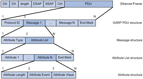

Generic Attribute Registration Protocol (GARP) provides a mechanism that allows participants in a GARP application to distribute, propagate, and register with other participants in a bridged LAN the attributes specific to the GARP application, such as the VLAN or multicast address attribute.
GARP itself does not exist on a device as an entity. GARP-compliant participants are known as GARP applications. One example is GVRP. When a GARP participant is present on a port on your device, the port is regarded as a GARP participant.
I. GARP messages and timers
1)         GARP messages
GARP participants exchange information through the following three types of messages: Join message, Leave message, and LeaveAll message.
l           A GARP participant uses Join messages to have its attributes registered on other devices. A GARP participant also sends Join messages to register attributes on other GARP participants when it receives Join messages from other GARP participants or static attributes are configured on it.
l           A GARP participant uses Leave messages to have its attributes deregistered on other devices. A GARP participant also sends Leave messages when it receives Leave messages from other GARP participants or static attributes are deregistered on it.
l           LeaveAll messages are used to deregister all the attributes, through which all the other GARP participants begin to have all their attributes registered. A GARP participant sends LeaveAll messages upon the expiration of the LeaveAll timer, which is triggered when the GARP participant is created.
Join messages, Leave messages, and LeaveAll message make sure the reregistration and deregistration of GARP attributes are performed in an orderly way.
Through message exchange, all attribute information that needs registration propagates to all GARP participants throughout a LAN.

III. GARP message format
The following figure illustrates the GARP message format.
Figure 3-1 GARP message format
Table 3-1 describes the GARP message fields.
Table 3-1 Description on the GARP message fields
Field
Description
Value
Protocol ID
Protocol identifier for GARP
1
Message
One or multiple messages, each containing an attribute type and an attribute list
Attribute Type
Defined by the concerned GARP application
0x01 for GVRP, indicating the VLAN ID attribute
Attribute List
Contains one or multiple attributes
Attribute
Consists of an Attribute Length, an Attribute Event, and an Attribute Value
Attribute Length
Number of octets occupied by an attribute, inclusive of the attribute length field
2 to 255 (in bytes)
Attribute Event
Event described by the attribute
0: LeaveAll event
1: JoinEmpty event
2: JoinIn event
3: LeaveEmpty event
4: LeaveIn event
5: Empty event
Attribute Value
Attribute value
VLAN ID for GVRP
If the Attribute Event is LeaveAll, Attribute Value is omitted.
End Mark
Indicates the end of a GARP PDU
0x00
