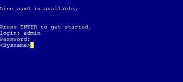

1.     Log in to the device through the console port again and press Enter as prompted.
The prompt for username login: appears.
2.     Enter the username admin.
The prompt for password Password: appears.
3.     Enter the password 123.
The user view prompt <Sysname> appears, as shown in Figure 2.
Figure 2 Console login interface

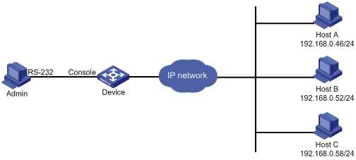

As shown in Figure 3, users need to log in to the device remotely to manage the device.
·     Configure Telnet login to enable users to Telnet to the device.
·     Configure Telnet user authentication so a Telnet user must provide the correct username and password at login.
·     Configure access control so only Telnet users at 192.168.0.46/24 and 192.168.0.52/24 can Telnet to the device.
·     Configure two local users.
¡     One local user can manage the device.
¡     One local user can use only the read commands of features.
Figure 3 Network diagram

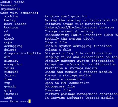

1.     Telnet to the device from Host A as userA. (Details not shown.)
2.     Display the commands available in user view, as shown in Figure 4.
The commands for device configuration and management are included in the list.
Figure 4 Commands available for userA

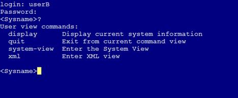

3.     Telnet to the device from Host B as userB. (Details not shown.)
4.     Display the commands available in user view, as shown in Figure 5.
Only read commands are displayed.
Figure 5 Commands available for userB

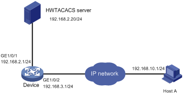

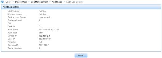

Example: Configuring login user command authorization and accounting
As shown in Figure 6, Host A needs to log in to the device to manage the device.
For device security purposes, configure the device to perform the following tasks:
·     Allow Host A to Telnet in after authentication.
·     Use the HWTACACS server to control the commands that the user can execute.
·     Send commands executed by users to the HWTACACS server to monitor and control user operations on the device.
Figure 6 Network diagram

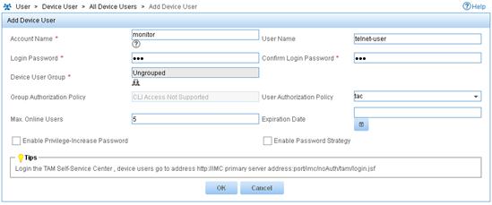

·     Configure a user account on the HWTACACS server and specify the commands for the user to use.
·     Configure the required HWTACACS scheme on the device.
Procedures
Configuring the HWTACACS server
In this example, the HWTACACS server runs on IMC PLAT 7.1 (E0302) and IMC EIA 7.1 (E0301).

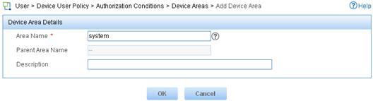

1.     Add a device area:
a.     Log in to IMC.
b.     Click the User tab.
c.     From the navigation tree, select Device User Policy > Authorization Conditions > Device Areas.
d.     Click Add.
e.     Set the area name to system and click OK.
Figure 7 Adding a device area

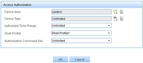

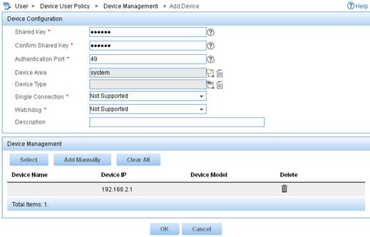

2.     Add a device:
a.     From the navigation tree, select Device User Policy > Device Management.
b.     Click Add.
c.     Enter expert for both Shared Key and Confirm Shared Key.
d.     Set the authentication port to 49.
e.     Select the device area system.
f.     Select Not Supported for Single Connection to disable establishing multiple sessions over a single TCP connection.
g.     Select Not Supported for Watchdog to disable the device from sending watchdog packets while the user is online.
h.     In the Device Management area, click Add Manually.
i.     Enter the IP address 192.168.2.1 and click OK.
j.     Click OK.
Figure 8 Adding a device

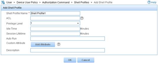

3.     Add a shell profile:
a.     From the navigation tree, select Device User Policy > Authorization Command > Shell Profiles.
b.     Click Add.
c.     Enter the profile name Shell Profile1.
d.     Select the privilege Level 1.
e.     Click OK.
Figure 9 Adding a shell profile

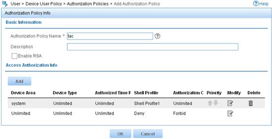

4.     Add an authorization policy:
a.     From the navigation tree, select Device User Policy > Authorization Policies.
b.     Click Add.
c.     Enter the policy name tac.
d.     In the Access Authorization Info area, click Add to configure access authorization information.
e.     Select system for Device Area.
f.     Select Unlimited for Device Type and Authorized Time Range.
g.     Select the shell profile Shell Profile1.
h.     Select Unlimited for Authorization Command Set and click OK.
i.     Click OK.
Figure 10 Configuring access authorization information
Figure 11 Adding an authorization policy
5.     Add a device user:
a.     From the navigation tree, select Device User > All Device Users.
b.     Click Add.
c.     Enter the account name monitor and username telnet-user.
d.     Enter the login password 123 and confirm the password.
e.     Select the user authorization policy tac.
f.     Enter 5 for Max. Online Users to limit the number of online users that use the account.
g.     Click OK.
Figure 12 Adding a device user

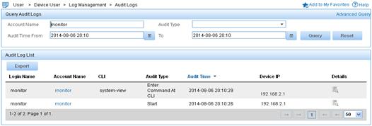

2.     Verify the command accounting feature:
a.     Log in to IMC.
c.     From the navigation tree, select Device User > Log Management > Audit Logs.
d.     In the Query Audit Logs area, enter the account name monitor, select the audit time range, and click Query.
A log for user monitor shows that the user executed the system-view command.
Figure 13 Querying audit logs

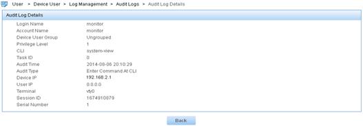

e.     Click the Details icon  for the log of the Start audit type.
Figure 14 Displaying details about the log of the Start audit type
f.     Click the Details icon  for the log of the Enter Command At CLI audit type.
Figure 15 Displaying details about the log of the Enter Command At CLI audit type

Example: Configuring Telnet login
As shown in Figure 16, users need to log in to the device remotely to manage the device.
·     Configure the device to send up to 20 lines to the configuration terminal at a time.
·     Set the command history buffer size to 100.
·     Set the maximum number of concurrent Telnet users to 10.
·     Set the session idle timeout to 20 minutes.
Figure 16 Network diagram
