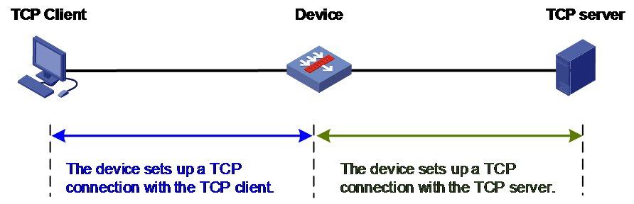

TCP proxy
As shown in Figure 1, the device implements TCP proxy for traffic between the TCP client and server. After receiving traffic from the TCP client to the server, the device becomes a TCP proxy. It proxies the server to establish a connection with the client and proxies the client to establish a connection with the server, respectively. The client and server exchange data through the two TCP connections. This mechanism provides TCP-layer isolation between the TCP client and server and helps effectively block unauthorized access attempts and malicious attacks.

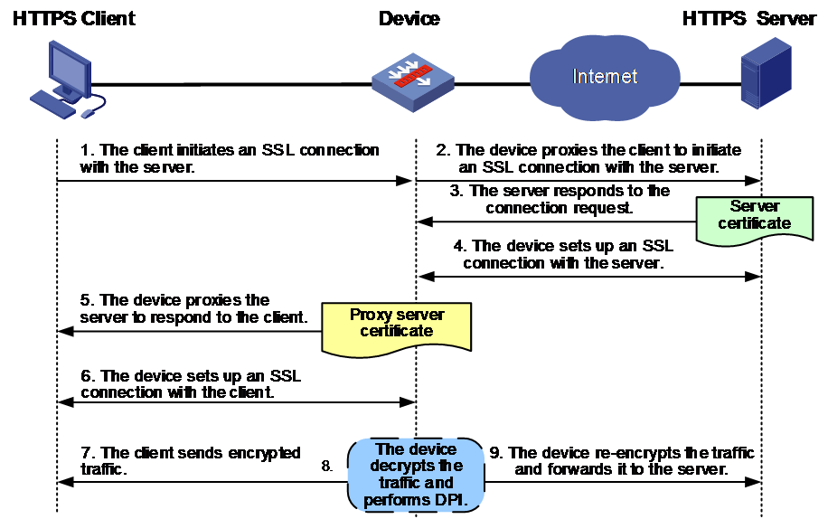

Mechanism for protecting internal clients
The SSL proxy function is implemented based on the TCP proxy function. When the device detects SSL traffic that needs SSL proxy, it first acts as the TCP proxy to set up TCP connections, and then implements SSL proxy.
Figure 3 shows how the device acts as an SSL proxy to protect the internal client when it accesses the external server.
Figure 3 SSL proxy mechanism for protecting the internal client
1.     The client sends a request to initiate an SSL connection with the server.
2.     The device receives the request from the client and proxies the client to send a new SSL connection request to the server.
3.     The server responds to the request and sends the server certificate to the device.
4.     The device verifies the legitimacy of the server certificate, completes the SSL handshake with the server on behalf of the SSL client, and sets up an SSL connection.
5.     The device acts as the SSL proxy server to respond to the client connection request and send a proxy server certificate to the client. The proxy server certificate is issued by using the SSL decryption certificate based on the content of the real server certificate.
6.     The client verifies the proxy server certificate, completes the SSL handshake with the device, and sets up an SSL connection.
7.     The client and server transmit encrypted SSL traffic with the device, respectively.
8.     The device decrypts the SSL traffic from the client or server and performs deep packet inspection and audit on the traffic.
9.     The device re-encrypts the traffic and sends it to the server.

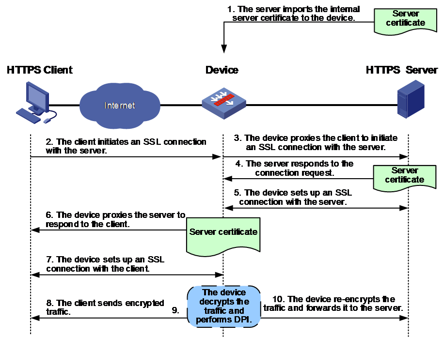

Mechanism for protecting internal servers
Figure 3 shows how the device acts as an SSL proxy to protect the internal server when it is accessed by the external client.
Figure 4 SSL proxy mechanism for protecting the internal server
1.     The administrator obtains the certificate of the internal server to be protected and imports the internal server certificate to the device.
2.     The device receives the SSL connection request from the client.
3.     The device proxies the client to send a new SSL connection request to the server.
4.     The server responds to the request and sends the server certificate to the device.
5.     The device verifies the legitimacy of the server certificate, completes the SSL handshake with the server on behalf of the SSL client, and sets up an SSL connection.
6.     The device acts as the SSL proxy server to respond to the client connection request and send the imported internal server certificate to the client.
7.     The client verifies the internal server certificate, completes the SSL handshake with the device, and sets up an SSL connection.
8.     The client and server transmit encrypted SSL traffic with the device, respectively.
9.     The device decrypts the SSL traffic from the client or server and performs deep packet inspection and audit on the traffic.
10.     The device re-encrypts the traffic and sends it to the server.

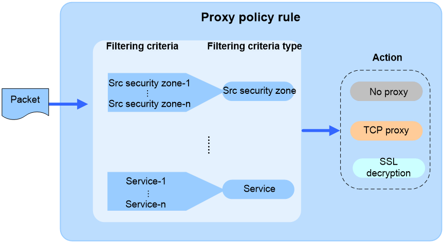

Matching process
Figure 5 Matching process
As shown in Figure 5, a packet is compared against the proxy policy rules as follows:
1.     The device compares the packet against the proxy policy rule with the highest priority.
The proxy policy rule can contain multiple filtering criteria types and each filtering criteria type can contain multiple filtering criteria. The packet matches a filtering criteria type if it matches any filtering criterion of the type.
2.     The device determines that the packet matches the proxy policy rule if the packet matches each of following filtering criteria types in the rule:
¡     Source security zone.
¡     Destination security zone.
¡     Source IP address.
¡     Destinations IP address.
¡     Service.
¡     Either the user or user group filtering criteria type.
3.     If the packet does not match the highest priority rule, the device continues the match process. The match process stops until a matching rule is found, and the action associated with the matching rule is applied.
4.     If the packet does not match any rules in the proxy policy, the device applies the default action specified in the proxy policy to the packet.

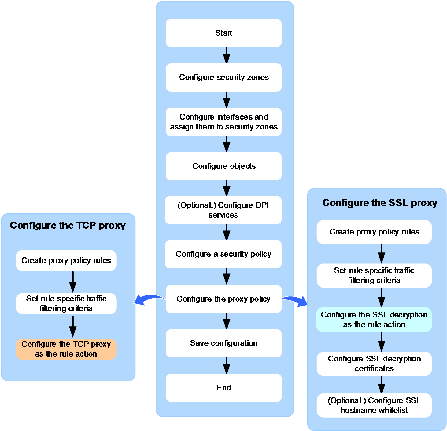

Proxy policy configuration procedure summary
Figure 6 shows how to configure the proxy policy.
Figure 6 Proxy policy configuration procedure
Proxy policy tasks at a glance
To configure the proxy policy:
1.     Configuring attributes in the proxy policy
a.     Setting the default action for the proxy policy
b.     Creating a proxy policy rule
c.     Configuring the traffic filtering criteria for a proxy policy rule
d.     Setting the action for a proxy policy rule
2.     (Optional.) Managing proxy policy rules
a.     Changing the rule match order
b.     Disabling a proxy policy rule
3.     Configuring SSL decryption certificates
The SSL decryption certifications are required in the scenario of protecting internal clients.
a.     Importing an SSL decryption certificate
b.     (Optional.) Channing the credibility of an SSL decryption certificate
c.     (Optional.) Deleting an SSL decryption certificate
4.     Configuring internal server certificates
The internal server certificates are required in the scenario of protecting internal servers.
a.     Importing an internal server certificate
b.     (Optional.) Deleting an internal server certificate
5.     (Optional.) Configuring the SSL proxy whitelist
a.     Add a hostname to the user-defined SSL hostname whitelist
b.     Disabling hostnames on the predefined SSL hostname whitelist
c.     Activating SSL hostname whitelist settings

A filtering criterion is ignored during packet matching if it is associated with a nonexistent or empty object group.
2.     Enter proxy policy view.
app-proxy-policy
3.     Enter the view of a proxy policy rule.
rule { rule-id | [ rule-id ] name rule-name }
4.     Configure the traffic filtering criteria as needed:
¡     Configure a source security zone filtering criterion.
source-zone source-zone-name
By default, a proxy policy rule does not contain any source security zone filtering criterion.
¡     Configure a destination security zone filtering criterion.
destination-zone destination-zone-name
By default, a proxy policy rule does not contain any destination security zone filtering criterion.
¡     Configure a source IP address filtering criterion.
source-ip object-group object-group-name
By default, a proxy policy rule does not contain any source IP address filtering criterion.
¡     Configure a destination IP address filtering criterion.
destination-ip object-group object-group-name
By default, a proxy policy rule does not contain any destination IP address filtering criterion.
¡     Configure a service filtering criterion.
service object-group { object-group-name | any }
By default, a proxy policy rule does not contain any service filtering criterion.
¡     Configure a user filtering criterion.
user username [ domain domain-name ]
By default, a proxy policy rule does not contain any user filtering criterion.
¡     Configure a user group filtering criterion.
user-group user-group-name [ domain domain-name ]
By default, a proxy policy rule does not contain any user group filtering criterion.
app-proxy-policy
4.     Set the action for traffic matching the proxy policy rule.
action { no-proxy | ssl-decrypt | tcp-proxy }
By default, the device transmits packets that match a proxy policy rule directly without TCP or SSL proxy.
5.     Specify an SSL decryption protection mode for the proxy policy rule.
ssl-decrypt protect-mode { client | server }
By default, the SSL decryption protection mode of a proxy policy rule is client.
Configure this command only when the SSL decryption action is used as the default action for the proxy policy.
By default, proxy policy rules are matched in the order they were created. A rule created earlier has a higher priority. You can change the rule match order by rearranging proxy policy rules. The match process stops once a matching rule is found.
app-proxy-policy
3.     Move a proxy policy rule.
¡     Move a proxy policy rule through rule IDs.
rule move id rule-id before insert-rule-id
¡     Move a proxy policy rule through rule names.
rule move name rule-name1 { before [ rule-name2 ] | after rule-name2 }
app-proxy-policy
4.     Disable the proxy policy rule.
disable
By default, a proxy policy rule is enabled.
The device supports a maximum of one trusted SSL decryption certificate and one untrusted SSL decryption certificate. Both of them must be manually imported to the device.
If you import multiple trusted or multiple untrusted SSL decryption certificates to the device, the most recent configuration takes effect.
You must install the trusted SSL decryption certificate on the client browser so the client can trust proxy server certificates issued by using the trusted SSL decryption certificate.
After an SSL decryption certificate is imported, its file extension will be changed to .cer.
2.     Import a CA certificate as a trusted or untrusted SSL decryption certificate to the device.
app-proxy ssl-decrypt-certificate import { trusted | untrusted } { pem | p12 } filename filename
The device supports only one trusted SSL decryption certificate and one untrusted SSL decryption certificate. A newly imported trusted or untrusted SSL decryption certificate will overwrite the existing one.
After an SSL decryption certificate is imported, its file extension will be changed to .cer. Append the .cer file extension when you specify the file containing the certificate whose credibility you want to change.
2.     Change the credibility of an SSL decryption certificate.
app-proxy ssl-decrypt-certificate modify { trusted | untrusted } filename filename
The device, acting as an SSL proxy, requires the correct SSL decryption certificate to issue proxy server certificates to send to clients for server authentication. If the required SSL decryption certificate is not available, the device cannot set up a connection with the client and the SSL traffic will be transmitted directly without SSL decryption.
After an SSL decryption certificate is imported, its file extension will be changed to .cer, which must be appended to the file name when you delete the certificate.
2.     Delete an SSL decryption certificate.
app-proxy ssl-decrypt-certificate delete filename filename
The internal server certifications are required in the scenario of protecting internal servers.
Each internal server certificate stored in the device has a MD5 value. If the MD5 value of an internal server certificate to be imported is the same as that stored in the device, the new certificate will overwrite the old certificate.
2.     Import an internal server certificate.
app-proxy internal-server-certificate import { p12 | pem } filename filename
When an internal server certificate expires or an internal server does not need to be protected, you can execute this command to delete the imported internal server certificate.
You can execute the display app-proxy imported internal-server-certificate command to view the MD5 values of the internal server certificates.
2.     Delete an internal server certificate.
app-proxy internal-server-certificate delete md5 md5-value
In the scenario that requires SSL client authentication or in-depth server certificate inspection, SSL proxy will cause the device (as an SSL proxy) unable to pass SSL client or server verification. By adding the server's hostname to the SSL hostname whitelist, you can disable SSL proxy for connections destined for the server so the SSL traffic is transmitted directly without SSL decryption.
2.     Add the hostname of a server to the user-defined SSL hostname whitelist.
app-proxy ssl whitelist user-defined-hostname host-name
By default, the user-defined SSL hostname whitelist does not contain any hostnames.
2.     Disable hostnames on the predefined SSL hostname whitelist.
undo app-proxy ssl whitelist predefined-hostname { chrome-hsts [ hostname ] | hostname } enable
By default, the entire predefined SSL hostname whitelist is enabled.
You must manually activate the SSL hostname whitelist settings for the following configurations to take effect:
·     Adding or removing hostnames to or from the user-defined SSL hostname whitelist.
·     Enabling or disabling hostnames on the predefined SSL hostname whitelist.
2.     Activate SSL hostname whitelist configuration.
app-proxy ssl whitelist activate
