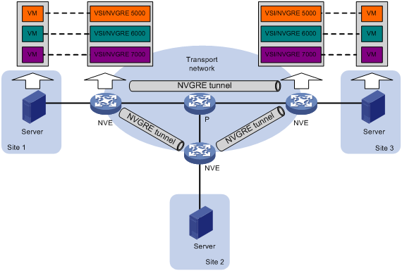

NVGRE network model
As shown in Figure 1, the transport edge devices assign VMs to different NVGRE networks, and then forward traffic between sites for VMs by using NVGRE tunnels.
The transport edge devices are network virtualization edges (NVEs). They can be servers that host VMs or independent network devices.
An H3C NVE uses VSIs and NVGRE tunnels to provide NVGRE services.
·           VSI—A virtual switch instance is a virtual Layer 2 switched domain. Each VSI provides switching services only for one NVGRE network. VSIs learn MAC addresses and forward frames independently of one another. VMs in different sites have Layer 2 connectivity if they are in the same NVGRE network.
·           NVGRE tunnel—Logical point-to-point tunnels between NVEs over the transport network. Each NVGRE tunnel can trunk multiple NVGRE networks.
NVEs encapsulate NVGRE traffic in the GRE and outer IP headers. The devices in the transport network forward NVGRE traffic only based on the outer IP header.

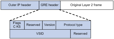

NVGRE packet format
As shown in Figure 2, an NVE encapsulates a frame in the following headers:
·           8-byte GRE header—NVGRE information for the frame.
?  Flags—Contains 4 bits. The second bit is not defined.
-       C bit—Checksum Present bit set to 0, indicating that the GRE header does not carry the GRE checksum.
-       K bit—Key Present bit set to 1, indicating that the GRE header carries the VSID.
-       S bit—Sequence Number Present bit set to 0, indicating that the GRE header does not carry a sequence number.
For more information about GRE, see Layer 3—IP Services Configuration Guide.
?  Version—GRE version number.
?  Protocol type—Passenger protocol type set to 0x6558, indicating that the payload is an Ethernet frame.
?  24-bit VSID—Virtual subnet identifier that identifies the NVGRE network of the frame.
·           20-byte outer IP header—Valid addresses of NVEs on the transport network. Devices in the transport network forward NVGRE packets based on the outer IP header.

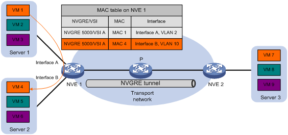

When the NVE forwards NVGRE traffic, it processes the 802.1Q tag in the inner Ethernet header depending on the VSI access mode (VLAN or Ethernet mode). In VLAN access mode, sites can use different VLANs to provide the same service. For more information, see "Access modes of VSIs."
Intra-site unicast
As shown in Figure 3, for intra-site unicast traffic, the NVE looks up the VSI's MAC address table and forwards the traffic through the matching outgoing site-facing interface.

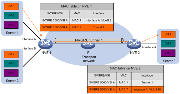

Inter-site unicast
The following process (see Figure 4) applies to a known unicast frame between sites:
1.      The source NVE encapsulates the Ethernet frame in the GRE/IP header.
In the outer IP header, the source IP address is the source NVE's NVGRE tunnel source IP address. The destination IP address is the NVGRE tunnel destination IP address.
2.      The source NVE forwards the encapsulated packet out of the outgoing NVGRE tunnel interface found in the VSI's MAC address table.
3.      The intermediate transport devices (P devices) forward the frame to the destination NVE by using the outer IP header.
4.      The destination NVE removes the headers on top of the inner Ethernet frame. It then performs MAC address table lookup in the NVGRE network's VSI to forward the frame out of the matching outgoing interface.

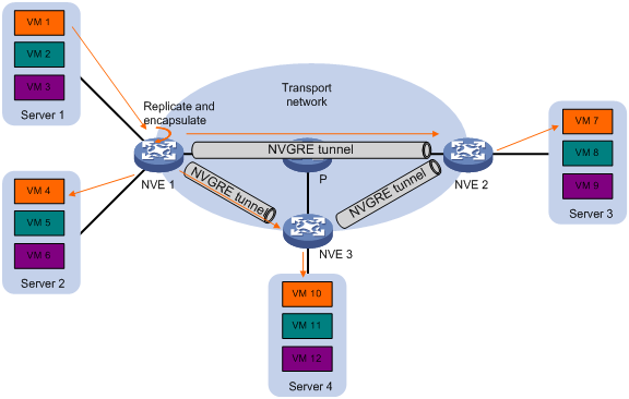

Flood
As shown in Figure 5, the NVE floods a broadcast, multicast, or unknown unicast frame to all site-facing interfaces and NVGRE tunnels in the NVGRE network, except for the incoming interface.
Each destination NVE floods the inner Ethernet frame to all the site-facing interfaces in the NVGRE network. To avoid loops, the destination NVEs do not flood the frame to NVGRE tunnels.

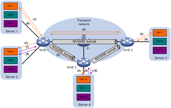

ARP flood suppression reduces ARP request broadcasts by enabling the NVE to reply to ARP requests on behalf of VMs.
As shown in Figure 6, this feature snoops ARP packets to populate the ARP flood suppression table with local and remote MAC addresses. If an ARP request has a matching entry, the NVE replies to the request on behalf of the VM. If no match is found, the NVE floods the request to both local and remote sites.
Figure 6 ARP flood suppression
ARP flood suppression uses the following workflow:
1.      VM 1 sends an ARP request to obtain the MAC address of VM 7.
2.      NVE 1 creates a suppression entry for VM 1, and floods the ARP request in the NVGRE network.
3.      NVE 2 and NVE 3 de-encapsulate the ARP request. The NVEs create a suppression entry for VM 1, and broadcast the request in the local site.
4.      VM 7 sends an ARP reply.
5.      NVE 2 creates a suppression entry for VM 7 and forwards the ARP reply to NVE 1.
6.      NVE 1 de-encapsulates the ARP reply, creates a suppression entry for VM 7, and forwards the ARP reply to VM 1.
7.      VM 4 sends an ARP request to obtain the MAC address of VM 1 or VM 7.
8.      NVE 1 creates a suppression entry for VM 4 and replies to the ARP request.
9.      VM 10 sends an ARP request to obtain the MAC address of VM 1.
10.    NVE 3 creates a suppression entry for VM 10 and replies to the ARP request.

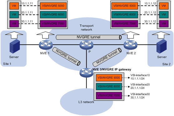

NVGRE IP gateways
An NVGRE IP gateway provides Layer 3 forwarding services for VMs in NVGRE networks. An NVGRE IP gateway can be an independent device or be collocated with an NVE. For more information about NVGRE IP gateway placement, see "Configuring NVGRE IP gateways."

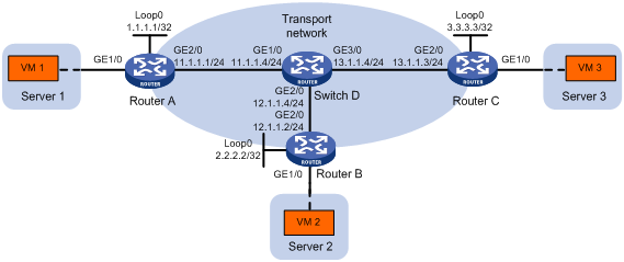

Example: Configuring a basic NVGRE network
As shown in Figure 7:
·           Configure NVGRE network 5000 on Router A, Router B, and Router C to provide Layer 2 connectivity for the VMs across the network sites.
·           Manually establish NVGRE tunnels and assign the tunnels to NVGRE network 5000.
Figure 7 Network diagram
1.      Configure IP addresses and unicast routing settings:
# Assign IP addresses to the interfaces, as shown in Figure 7. (Details not shown.)
# Configure OSPF on all transport network devices (Routers A through D). (Details not shown.)
2.      Configure Router A:
# Enable L2VPN.
<RouterA> system-view
[RouterA] l2vpn enable
# Create VSI vpna and NVGRE network 5000.
[RouterA] vsi vpna
[RouterA-vsi-vpna] nvgre 5000
[RouterA-vsi-vpna-nvgre-5000] quit
[RouterA-vsi-vpna] quit
# Assign an IP address to Loopback 0. The IP address will be used as the source IP address of the NVGRE tunnels to Router B and Router C.
[RouterA] interface loopback 0
[RouterA-Loopback0] ip address 1.1.1.1 255.255.255.255
[RouterA-Loopback0] quit
# Create an NVGRE tunnel to Router B. The tunnel interface name is Tunnel 1.
[RouterA] interface Tunnel 1 mode nvgre
[RouterA-Tunnel1] source 1.1.1.1
[RouterA-Tunnel1] destination 2.2.2.2
[RouterA-Tunnel1] quit
# Create an NVGRE tunnel to Router C. The tunnel interface name is Tunnel 2.
[RouterA] interface Tunnel 2 mode nvgre
[RouterA-Tunnel2] source 1.1.1.1
[RouterA-Tunnel2] destination 3.3.3.3
[RouterA-Tunnel2] quit
# Assign Tunnel 1 and Tunnel 2 to NVGRE network 5000.
[RouterA] vsi vpna
[RouterA-vsi-vpna-nvgre-5000] tunnel 1
[RouterA-vsi-vpna-nvgre-5000] tunnel 2
# Map GigabitEthernet 1/0 to VSI vpna.
[RouterA] interface gigabitethernet 1/0
[RouterA-GigabitEthernet1/0] xconnect vsi vpna
[RouterA-GigabitEthernet1/0] quit
3.      Configure Router B:
# Enable L2VPN.
<RouterB> system-view
[RouterB] l2vpn enable
[RouterB] vsi vpna
[RouterB-vsi-vpna] nvgre 5000
[RouterB-vsi-vpna-nvgre-5000] quit
[RouterB-vsi-vpna] quit
# Assign an IP address to Loopback 0. The IP address will be used as the source IP address of the NVGRE tunnels to Router A and Router C.
[RouterB] interface loopback 0
[RouterB-Loopback0] ip address 2.2.2.2 255.255.255.255
[RouterB-Loopback0] quit
# Create an NVGRE tunnel to Router A. The tunnel interface name is Tunnel 2.
[RouterB] interface Tunnel 2 mode nvgre
[RouterB-Tunnel2] source 2.2.2.2
[RouterB-Tunnel2] destination 1.1.1.1
[RouterB-Tunnel2] quit
# Create an NVGRE tunnel to Router C. The tunnel interface name is Tunnel 3.
[RouterB] interface Tunnel 3 mode nvgre
[RouterB-Tunnel3] source 2.2.2.2
[RouterB-Tunnel3] destination 3.3.3.3
[RouterB-Tunnel3] quit
# Assign Tunnel 2 and Tunnel 3 to NVGRE network 5000.
[RouterB] vsi vpna
[RouterB-vsi-vpna-nvgre-5000] tunnel 2
[RouterB-vsi-vpna-nvgre-5000] tunnel 3
[RouterB] interface gigabitethernet 1/0
[RouterB-GigabitEthernet1/0] xconnect vsi vpna
[RouterB-GigabitEthernet1/0] quit
4.      Configure Router C:
# Enable L2VPN.
<RouterC> system-view
[RouterC] l2vpn enable
[RouterC] vsi vpna
[RouterC-vsi-vpna] nvgre 5000
[RouterC-vsi-vpna-nvgre-5000] quit
[RouterC-vsi-vpna] quit
# Assign an IP address to Loopback 0. The IP address will be used as the source IP address of the NVGRE tunnels to Router A and Router B.
[RouterC] interface loopback 0
[RouterC-Loopback0] ip address 3.3.3.3 255.255.255.255
[RouterC-Loopback0] quit
# Create an NVGRE tunnel to Router A. The tunnel interface name is Tunnel 1.
[RouterC] interface Tunnel 1 mode nvgre
[RouterC-Tunnel1] source 3.3.3.3
[RouterC-Tunnel1] destination 1.1.1.1
[RouterC-Tunnel1] quit
# Create an NVGRE tunnel to Router B. The tunnel interface name is Tunnel 3.
[RouterC] interface Tunnel 3 mode nvgre
[RouterC-Tunnel3] source 3.3.3.3
[RouterC-Tunnel3] destination 2.2.2.2
[RouterC-Tunnel3] quit
# Assign Tunnel 1 and Tunnel 3 to NVGRE 5000.
[RouterC] vsi vpna
[RouterC-vsi-vpna-nvgre-5000] tunnel 1
[RouterC-vsi-vpna-nvgre-5000] tunnel 3
[RouterC] interface gigabitethernet 1/0
[RouterC-GigabitEthernet1/0] xconnect vsi vpna
[RouterC-GigabitEthernet1/0] quit
1.      Verify the NVGRE settings on the NVEs. This example uses Router A.
# Verify that the NVGRE tunnel interfaces on the NVE are up.
[RouterA] display interface tunnel 1
Tunnel1
Current state: UP
Line protocol state: UP
Description: Tunnel1 Interface
Bandwidth: 64 kbps
Maximum transmission unit: 64000
Internet protocol processing: disabled
Output queue - Urgent queuing: Size/Length/Discards 0/100/0
Output queue - Protocol queuing: Size/Length/Discards 0/500/0
Output queue - FIFO queuing: Size/Length/Discards 0/75/0
Last clearing of counters: Never
Tunnel source 1.1.1.1, destination 3.3.3.3
Tunnel protocol/transport GRE_NVGRE/IP
Last 300 seconds input rate: 0 bytes/sec, 0 bits/sec, 0 packets/sec
Last 300 seconds output rate: 0 bytes/sec, 0 bits/sec, 0 packets/sec
Input: 0 packets, 0 bytes, 0 drops
Output: 0 packets, 0 bytes, 0 drops
# Verify that the NVGRE tunnels have been assigned to the NVGRE network.
[RouterA] display l2vpn vsi verbose
VSI Name: vpna
  VSI Index               : 0
  VSI State               : Up
  MTU                     : 1500
  Bandwidth               : -
  Broadcast Restrain      : -
  Multicast Restrain      : -
  Unknown Unicast Restrain: -
  MAC Learning            : Enabled
  MAC Table Limit         : -
  Drop Unknown            : -
  Flooding                : Enabled
  NVGRE VSID              : 5000
  Tunnels:
    Tunnel Name          Link ID    State  Type
    Tunnel1              0x7000001  UP     Manual
    Tunnel2              0x7000002  UP     Manual
  ACs:
    AC                               Link ID    State
    GE1/0                            0          Up
# Verify that the NVE has learned the MAC addresses of remote VMs.
[RouterA] display l2vpn mac-address
MAC Address      Type       VSI Name                        Link ID   Aging Time
cc3e-5f9c-6cdb   Dynamic    vpna                            Tunnel1   Aging
cc3e-5f9c-23dc   Dynamic    vpna                            Tunnel2   Aging
--- 2 mac address(es) found  ---
2.      Verify that VM 1, VM 2, and VM 3 can ping each other. (Details not shown.)

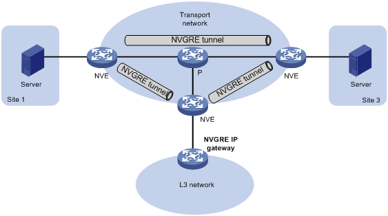

NVGRE IP gateway separated from NVEs
As shown in Figure 8, an independent NVGRE IP gateway connects a Layer 3 network to an NVE. VMs send Layer 3 traffic in Layer 2 frames to the gateway through NVGRE tunnels. When the tunneled NVGRE packets arrive, the NVE terminates the NVGRE networks and forwards the inner frames to the gateway. In this gateway placement design, the NVE does not perform Layer 3 forwarding for NVGRE networks.
Figure 8 NVGRE IP gateway separated from NVEs

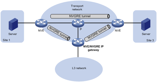

NVGRE IP gateway on an NVE
As shown in Figure 9, an NVE acts as a gateway for VMs in the NVGRE networks. The NVE both terminates the NVGRE networks and performs Layer 3 forwarding for the VMs.
Figure 9 NVGRE IP gateway on an NVE
As shown in Figure 10, the network uses the following process to forward Layer 3 traffic from VM 10.1.1.11 to the Layer 3 network:
1.      The VM sends an ARP request to obtain the MAC address of the gateway (NVE 3) at 10.1.1.1.
2.      NVE 1 floods the ARP request to all remote NVEs.
3.      NVE 3 de-encapsulates the ARP request, creates an ARP entry for the VM, and sends an ARP reply to the VM.
4.      NVE 1 forwards the ARP reply to the VM.
5.      The VM learns the MAC address of the gateway, and sends the Layer 3 traffic to the gateway.
6.      NVE 3 removes the NVGRE encapsulation and inner Ethernet header for the traffic, and forwards the traffic to the destination node.
Inter-NVGRE network forwarding is the same as this process except for the last step. At the last step of inter-NVGRE network forwarding, the gateway replaces the source-NVGRE encapsulation with the destination-NVGRE encapsulation, and then forwards the traffic.

Configuring an NVGRE IP gateway on an NVE
1.      Enter system view.
2.      Create a VSI interface and enter VSI interface view.
interface vsi-interface vsi-interface-id
3.      Assign an IP address to the VSI interface.
ip address ip-address { mask | mask-length }
By default, no IP address is assigned to a VSI interface.
4.      Enable the VSI interface.
undo shutdown
By default, a VSI interface is up.
5.      Return to system view.
6.      Enter VSI view.
vsi vsi-name
7.      Specify a gateway interface for the VSI.
gateway vsi-interface vsi-interface-id
By default, no gateway interface is specified for a VSI.

Example: Configuring a basic NVGRE IP gateway
As shown in Figure 11:
·           Configure NVGRE network 5000 on Router A, Router B, and Router C to provide connectivity for the VMs across the network sites.
·           Configure an NVGRE IP gateway on Router B to provide gateway services for NVGRE network 5000.
Figure 11 Network diagram
# Assign IP addresses to the interfaces, as shown in Figure 11. (Details not shown.)
# Configure OSPF on all transport network routers (Routers A through D). (Details not shown.)
# Configure OSPF to advertise routes to networks 10.1.1.0/24 and 20.1.1.0/24 on Router B and Router E. (Details not shown.)
# Enable L2VPN.
[RouterA] vsi vpna
[RouterA] vsi vpna
# Enable L2VPN.
[RouterB] vsi vpna
[RouterB] vsi vpna
# Create VSI-interface 1 and assign the interface an IP address. The IP address will be used as the gateway address for NVGRE network 5000.
[RouterB] interface vsi-interface 1
[RouterB-Vsi-interface1] ip address 10.1.1.1 255.255.255.0
[RouterB-Vsi-interface1] quit
# Specify VSI-interface 1 as the gateway interface for VSI vpna.
[RouterB] vsi vpna
[RouterB-vsi-vpna] gateway vsi-interface 1
# Enable L2VPN.
[RouterC] vsi vpna
# Assign Tunnel 1 and Tunnel 3 to NVGRE network 5000.
[RouterC] vsi vpna
1.      Verify the NVGRE IP gateway settings on Router B:
# Verify that the NVGRE tunnel interfaces are up on Router B.
[RouterB] display interface tunnel 2
Tunnel2
Current state: UP
Description: Tunnel2 Interface
Bandwidth: 64 kbps
Tunnel source 2.2.2.2, destination 1.1.1.1
# Verify that VSI-interface 1 is up.
[RouterB] display interface vsi-interface 1
Vsi-interface1
Current state: UP
Description: Vsi-interface1 Interface
Bandwidth: 1000000 kbps
Maximum transmission unit: 1500
Internet address: 10.1.1.1/24 (primary)
IP packet frame type: Ethernet II, hardware address: 0011-2200-0102
IPv6 packet frame type: Ethernet II, hardware address: 0011-2200-0102
Physical: Unknown, baudrate: 1000000 kbps
# Verify that the NVGRE tunnels have been assigned to the NVGRE network, and VSI-interface 1 is the gateway interface of VSI vpna.
[RouterB] display l2vpn vsi verbose
VSI Name: vpna
  VSI Index               : 0
  VSI State               : Up
  MTU                     : 1500
  Bandwidth               : -
  MAC Table Limit         : -
  Drop Unknown            : -
  Flooding                : Enabled
  Gateway interface       : VSI-interface 1
  NVGRE VSID              : 5000
  Tunnels:
    Tunnel2              0x7000002  Up     Manual
    Tunnel3              0x7000003  Up     Manual
# Verify that Router B has created ARP entries for the VMs.
[RouterB] display arp
  Type: S-Static   D-Dynamic   O-Openflow   M-Multiport  I-Invalid
IP address       MAC address    SVLAN/VSI Interface/Link ID        Aging Type
12.1.1.4         000c-2999-e04f --        GE1/0                    6     D
20.1.1.5         000c-29c1-5e46 --        GE2/0                    19    D
10.1.1.11        0000-1234-0001 --        Vsi1                     20    D
10.1.1.12        0000-1234-0002 --        Vsi1                     19    D
# Verify that Router B has created FIB entries for the VMs.
[RouterB] display fib 10.1.1.11
Destination count: 1 FIB entry count: 1
Flag:
  U:Useable   G:Gateway   H:Host   B:Blackhole   D:Dynamic   S:Static
  R:Relay     F:FRR
Destination/Mask   Nexthop         Flag     OutInterface/Token       Label
10.1.1.11/32       10.1.1.11       UH       Vsi1                     Null
2.      Verify that the VMs can access the WAN:
# Verify that VM 1 and VM 2 can ping each other. (Details not shown.)
# Verify that VM 1, VM 2, and GigabitEthernet 1/0 (20.1.1.5) on Router E can ping each other. (Details not shown.)
