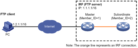

Example: Using the device as an FTP server
·          Configure the IRF fabric as an FTP server.
·          Create a local user account named abc on the FTP server. Set the password to 123456.
·          Use the user account to log in to the FTP server from the FTP client.
·          Upload the temp.bin file from the FTP client to the FTP server.
Download configuration file config.cfg from the FTP server to the FTP client for backup.
Figure 1 Network diagram
1.        Configure IP addresses as shown in Figure 1. Make sure the IRF fabric and the PC can reach each other. (Details not shown.)
2.        Configure the FTP server:
# Examine the storage space on the member devices. If the free space is insufficient, use the delete/unreserved file command to delete unused files. (Details not shown.)
# Create a local user with username abc and password 123456.
<Sysname> system-view
[Sysname] local-user abc class manage
[Sysname-luser-manage-abc] password simple 123456
# Assign the network-admin user role to the user. Set the working directory to the root directory of the flash memory on the master. (To set the working directory to the root directory of the flash memory on the subordinate member, you must include the slot number in the directory path.)
[Sysname-luser-manage-abc] authorization-attribute user-role network-admin work-directory flash:/
# Assign the service type FTP to the user.
[Sysname-luser-manage-abc] service-type ftp
[Sysname-luser-manage-abc] quit
# Enable the FTP server.
[Sysname] ftp server enable
[Sysname] quit
3.        Perform FTP operations from the FTP client:
# Log in to the FTP server at 1.1.1.1 using username abc and password 123456.
c:\> ftp 1.1.1.1
Connected to 1.1.1.1.
220 FTP service ready.
User(1.1.1.1:(none)):abc
331 Password required for abc.
Password:
230 User logged in.
# Use the ASCII mode to download configuration file config.cfg from the FTP server to the PC for backup.
ftp> ascii
200 TYPE is now ASCII
ftp> get config.cfg back-config.cfg
# Use the binary mode to upload the temp.bin file from the PC to the root directory of the flash memory on the master.
ftp> binary
200 TYPE is now 8-bit binary
ftp> put temp.bin
# Exit FTP.
ftp> bye

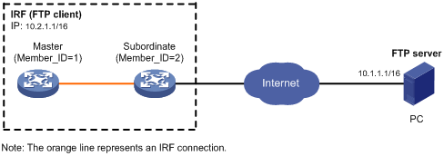

Using the device as an FTP client
FTP client configuration tasks at a glance
To use the device as an FTP server, perform the following tasks:
1.        Establishing an FTP connection

Example: Using the device as an FTP client
As shown in Figure 2, the PC is acting as an FTP server. A user account with username abc and password 123456 has been created on the PC.
·          Use the IRF fabric as an FTP client to log in to the FTP server.
·          Download the temp.bin file from the FTP server to the FTP client.
Upload configuration file config.cfg from the FTP client to the FTP server for backup.
Figure 2 Network diagram
# Configure IP addresses as shown in Figure 2. Make sure the IRF fabric and PC can reach each other. (Details not shown.)
# Log in to the FTP server at 10.1.1.1 using username abc and password 123456.
<Sysname> ftp 10.1.1.1
Press CTRL+C to abort.
Connected to 10.1.1.1 (10.1.1.1).
220 WFTPD 2.0 service (by Texas Imperial Software) ready for new user
User (10.1.1.1:(none)): abc
331 Give me your password, please
Password:
230 Logged in successfully
Remote system type is MSDOS.
ftp>
# Set the file transfer mode to binary.
ftp> binary
# Download the temp.bin file from the PC to the root directory of the flash memory on the master device.
ftp> get temp.bin
local: temp.bin remote: temp.bin
150 Connecting to port 47457
226 File successfully transferred
23951480 bytes received in 95.399 seconds (251.0 kbyte/s)
# Download the temp.bin file from the PC to the root directory of the flash memory on the subordinate member (with member ID of 2).
ftp> get temp.bin slot2#flash:/temp.bin
# Use the ASCII mode to upload configuration file config.cfg from the IRF fabric to the PC for backup.
ftp> ascii
ftp> put config.cfg back-config.cfg
local: config.cfg remote: back-config.cfg
150 Connecting to port 47461
3494 bytes sent in 5.646 seconds (618.00 kbyte/s)
ftp> bye
221-Goodbye. You uploaded 2 and downloaded 2 kbytes.
221 Logout.
<Sysname>
