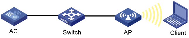

WLAN QoS configuration examples
Example: Configuring basic WMM
As shown in Figure 2, enable WMM on the AC so that the AP and the client can prioritize the traffic.
Figure 2 Network diagram
# Create a service template named market, set the SSID to market, and enable the service template.
<AC> system-view
[AC] wlan service-template market
[AC-wlan-st-market] ssid market
[AC-wlan-st-market] service-template enable
[AC-wlan-st-market] quit
# Create a manual AP named ap1, and specify the AP model and serial ID.
[AC] wlan ap ap1 model WA6320
[AC-wlan-ap-ap1] serial-id 219801A28N819CE0002T
# Enable WMM, bind service template market to radio 1, and enable radio 1.
[AC-wlan-ap-ap1] radio 1
[AC-wlan-ap-ap1-radio-1] wmm enable
[AC-wlan-ap-ap1-radio-1] service-template market
[AC-wlan-ap-ap1-radio-1] radio enable
[AC-wlan-ap-ap1-radio-1] quit
[AC-wlan-ap-ap1] quit
# Display WMM statistics for radios.
[AC] display wlan wmm radio
 AP ID : 1   AP Name : ap1
 Radio : 1
 Client EDCA updates : 0
 QoS mode     : WMM
 WMM status : Enabled
 Radio max AIFSN          : 15            Radio max ECWmin : 10
 Radio max TXOPLimit      : 32767         Radio max ECWmax : 10
 CAC information
 Clients accepted                      : 0
  Voice                                : 0
  Video                                : 0
 Total request medium time(μs)          : 0
  Voice(μs)                            : 0
  Video(μs)                            : 0
Calls rejected due to insufficient resources    : 0
Calls rejected due to invalid parameters        : 0
Calls rejected due to invalid medium time        : 0
Calls rejected due to invalid delay bound        : 0
Radio : 2
 QoS mode   : WMM
 CAC information
  Voice                          : 0
  Video                          : 0
  Voice(μs)                      : 0
  Video(μs)                      : 0
