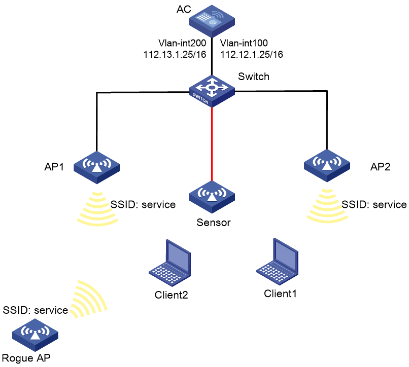

As shown in Figure 1, AP 1 and AP 2 provide wireless services for clients through SSID service.
Enable WIPS on the sensor to take countermeasures against the rogue AP that uses the same SSID as AP 1 and AP 2.
Figure 1 Network diagram
Use the serial ID labeled on the AP's rear panel to specify an AP.
