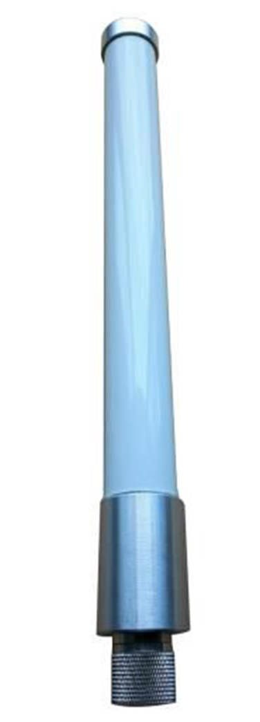

The ANT-2547V dual-band omnidirectional Wi-Fi antenna is designed for use in outdoor environments. It is connected to the device through the type N male connector.
Figure 1 Antenna view

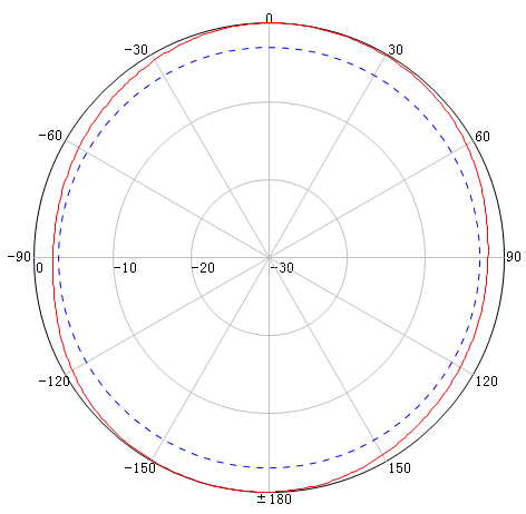

Figure 2 through Figure 5 show the horizontal and vertical radiation patterns.
Figure 2 2.4 GHz horizontal pattern
2450-H

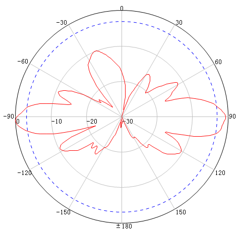

Figure 3 2.4 GHz vertical pattern
2450-E

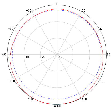

Figure 4 5 GHz horizontal pattern
5150-H

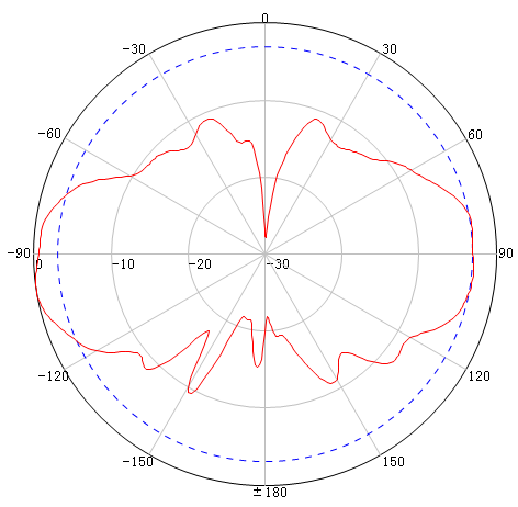

Figure 5 5 GHz vertical pattern
5850-E

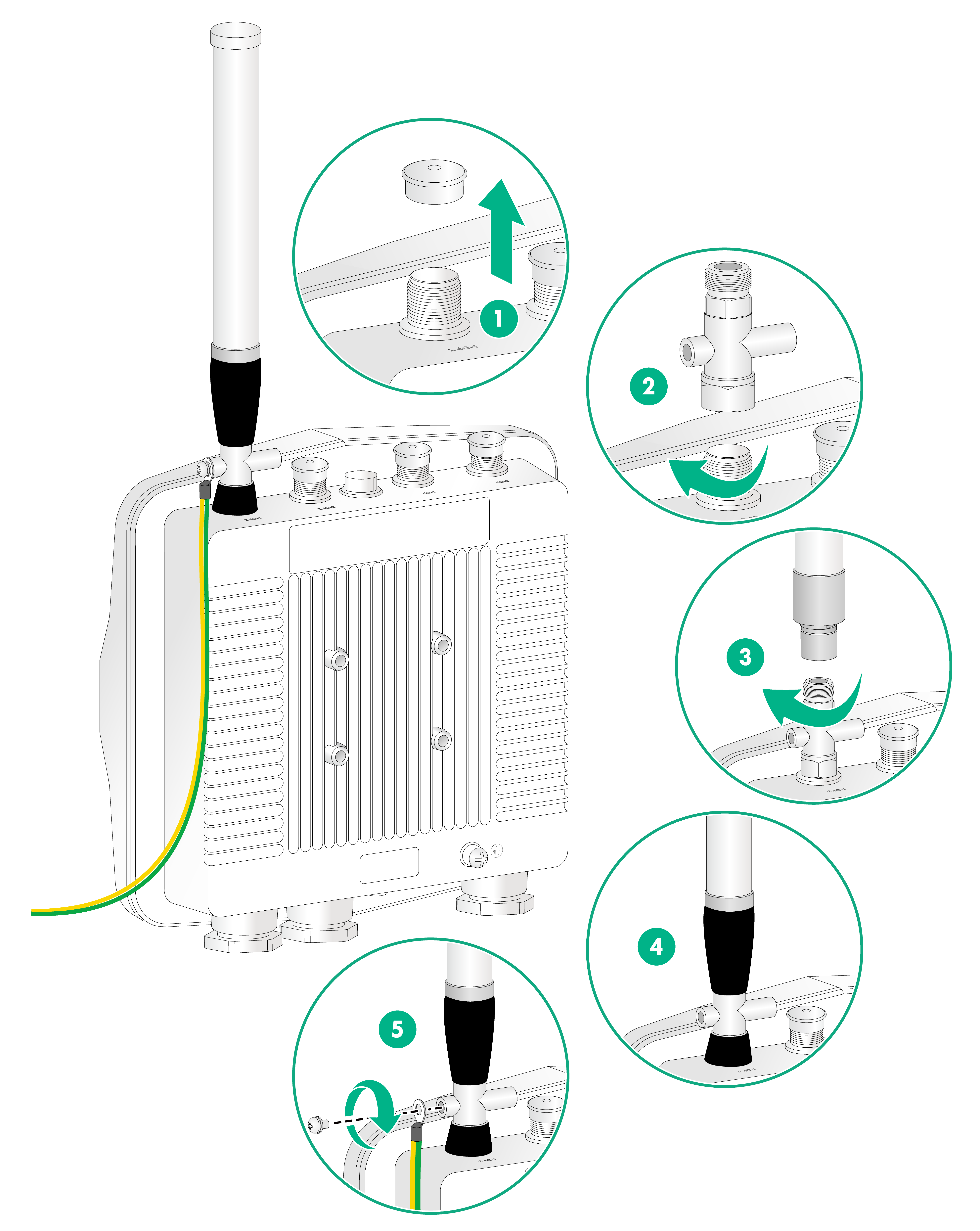

Mounting the antenna and lightning arrester
IMPORTANT
IMPORTANT:
When you apply weatherproof tape to a cable connection, follow these restrictions and guidelines:
·     Make sure you attach the adhesive side of the tape to the connector.
·     Pull the tape as needed for overlap.
·     Start wrapping at the top of the connector, and overlap the tape to half-width. Avoid creases or wrinkles and press the tape against the connection so that there are no gaps. Smooth each wrapped layer with your hands to ensure full adhesion.
The antenna is installed outdoors. You must install a lightning arrester for it. The lightning arrester can be installed on the AP or on the antenna connector. No lightning arrester is provided with the antenna. Purchase one yourself.
To mount the antenna and lighting arrester:
1.     Remove the weatherproof cap from the antenna connector on the AP.
2.     Connect a lighting arrester to the antenna connector.
3.     Connect the antenna to the lightning arrester.
4.     Wrap each connection with weatherproof tape until the entire connection is wrapped. Smooth the tape edges to ensure full adhesion.
5.     Ground the lighting arrester.
Figure 6 Mounting the antenna and lightning arrester
