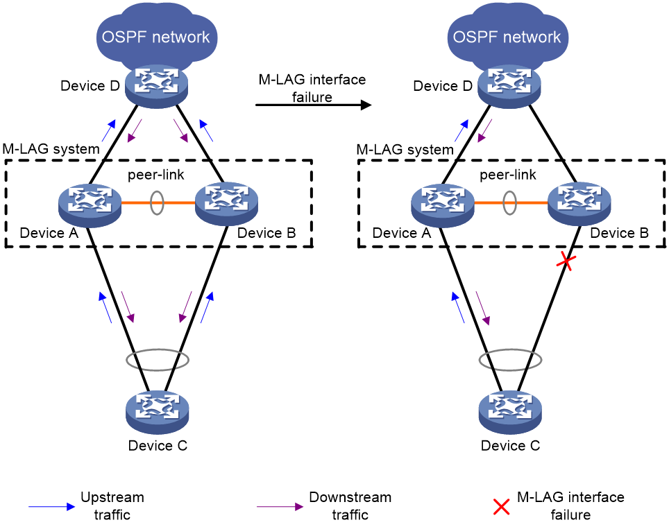

Establishing OSPF neighbor relationships on an M-LAG network
When a customer-side device accesses the OSPF network through both M-LAG member devices in an M-LAG system, the M-LAG member devices provide Layer 3 gateway services. The gateway interfaces (such as VLAN interfaces) on different M-LAG member devices might have the same IP address and the same MAC address. In this case, the M-LAG member devices cannot establish OSPF neighbor relationships with the customer-side device.
To resolve this issue, configure the gateway interfaces to use M-LAG virtual IPv4 addresses for OSPF neighbor relationship establishment. For more information about M-LAG, see M-LAG configuration in Layer 2—LAN Switching Configuration Guide.
As shown in Figure 9, Device C accesses the OSPF network through the M-LAG system that consists of Device A and Device B. Device A and Device B provide Layer 3 gateway services. The gateway interface VLAN-interface 100 on Device A and the gateway interface VLAN-interface 100 on Device B have the same IP address and the same MAC address. To ensure that both Device A and Device B can establish an OSPF neighbor relationship with Device C, perform the following tasks:
1.     Configure different M-LAG virtual IPv4 addresses for the VLAN interfaces on Device A and Device B.
2.     Configure the VLAN interface to use the M-LAG virtual IPv4 address for OSPF neighbor relationship establishment on both Device A and Device B.
Figure 9 OSPF neighbor relationship establishment on an M-LAG network
2.     Enter interface view.
3.     Configure an M-LAG virtual IPv4 address for the interface.
port m-lag virtual-ip ipv4-address { mask-length | mask }
By default, no M-LAG virtual IPv4 address is configured for an interface.
An M-LAG virtual IPv4 address is similar to a secondary IP address. For more information about this command, see M-LAG commands in Layer 2—LAN Switching Command Reference.
4.     Configure the interface to use the M-LAG virtual IPv4 address for OSPF neighbor relationship establishment.
ospf peer sub-address enable ip-address
By default, an interface uses the primary IP address for OSPF neighbor relationship establishment.
The IP address specified in this command must be the same as the IPv4 address specified in the port m-lag virtual-ip command.

Associating OSPF with Track
Perform this task to associate an OSPF interface with a track entry to adjust the cost of the interface as follows:
·     When the track entry state becomes negative, OSPF increases the cost of the interface.
·     When the track entry state becomes positive, OSPF restores the cost of the interface to the original value.
When a customer side device is dual-homed to an OSPF network through M-LAG, you can configure this feature to prevent the traffic from detouring through the M-LAG peer link. As shown in Figure 10, customer-side device Device C is dual-homed to the OSPF network through an M-LAG system formed by Device A and Device B. Device A and Device B share the traffic load between Device D and Device C. When the DR interface that connects Device B to Device C fails, the upstream traffic and downstream traffic are forwarded as follows:
·     Device C detects the M-LAG interface failure, and traffic from Device C to Device D is switched from path Device C->Device B->Device D to path Device C->Device A->Device D.
·     Device D cannot detect the M-LAG interface failure and still forwards traffic through Device B. Because the link between Device B and Device C fails, traffic from Device D to Device C is switched from path Device D->Device B->Device C to path Device D->Device B->Device A->Device C.
Figure 10 Traffic forwarding path after M-LAG interface failure
To prevent the downstream traffic from detouring through the M-LAG peer link, perform the following tasks on Device B:
1.     Execute the track interface command to create a track entry and associate it with the link state of the M-LAG interface. For more information about the track interface command, see track commands in High Availability Command Reference.
2.     Execute the ospf track adjust-cost command to associate the gateway interface with the track entry.
Then, Device B adjusts the cost of the gateway interface based on the state of the associated track entry:
·     When the M-LAG interface fails, the track entry state becomes negative, and OSPF increases the cost of the gateway interface. Then, traffic from Device D to Device C is switched to path Device D->Device A->Device C.
·     When the M-LAG interface recovers, the track entry state becomes positive, and OSPF restores the cost of the gateway interface to the original value. Then, traffic from Device D to Device C is switched back to path Device D->Device B->Device C.
Figure 11 Traffic forwarding path after associating OSPF with Track
