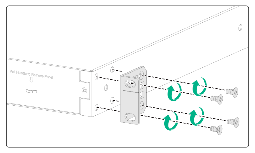

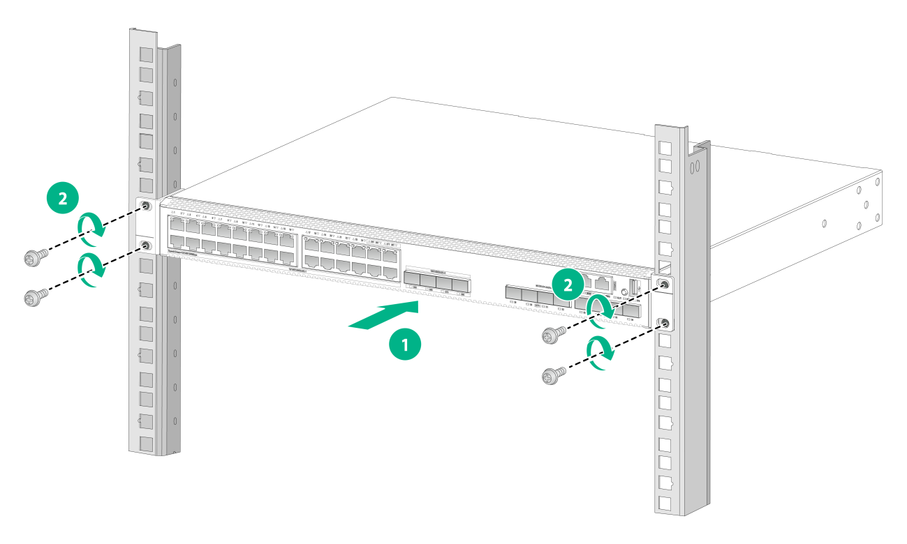

Installing the switch in a 19-inch rack

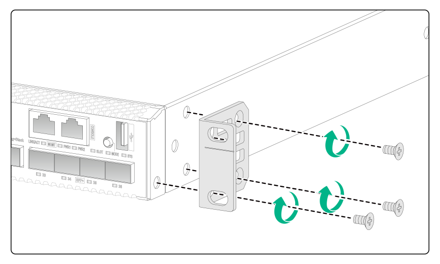

Attaching the mounting brackets to the switch
Mounting the switch in the rack

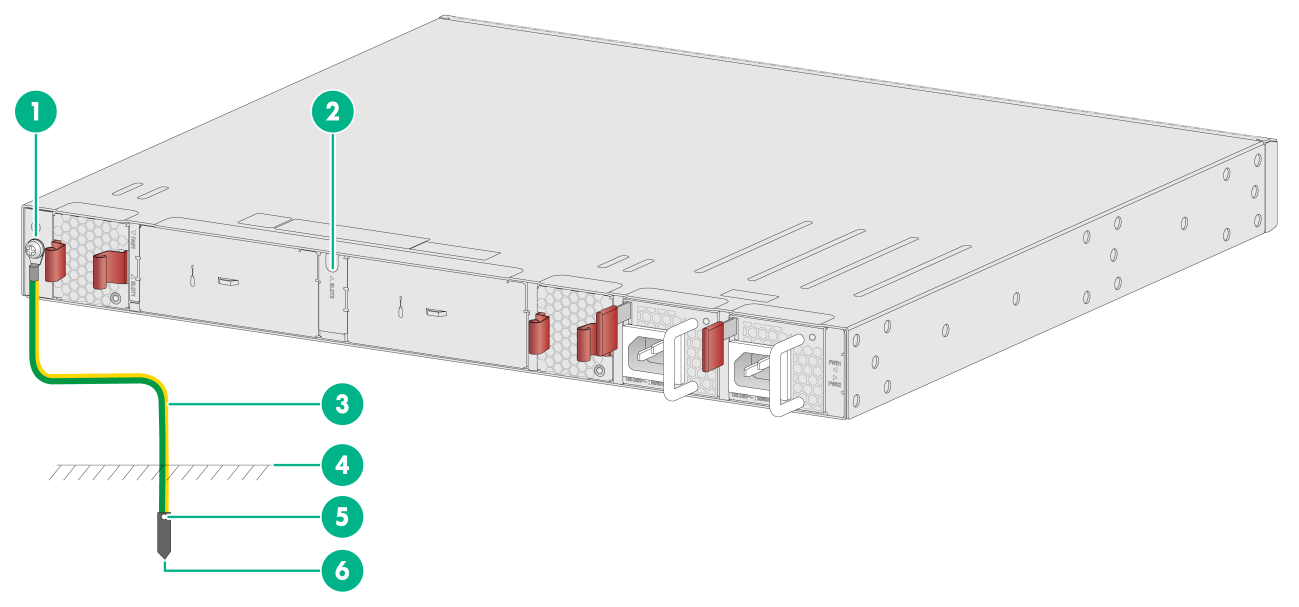

Grounding the switch by using a grounding conductor buried in the earth ground

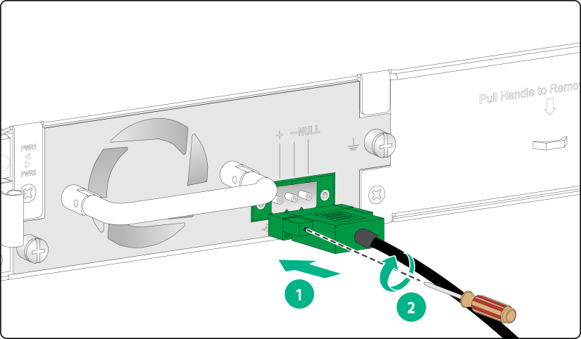

Connecting the power cord for a PSR180-12A-B or PSR180-12A-F power supply
Connecting the power cord for a PSR180-12D-B power supply

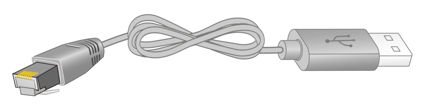

USB-to-RJ45 console cable |
1, optional |
All models |

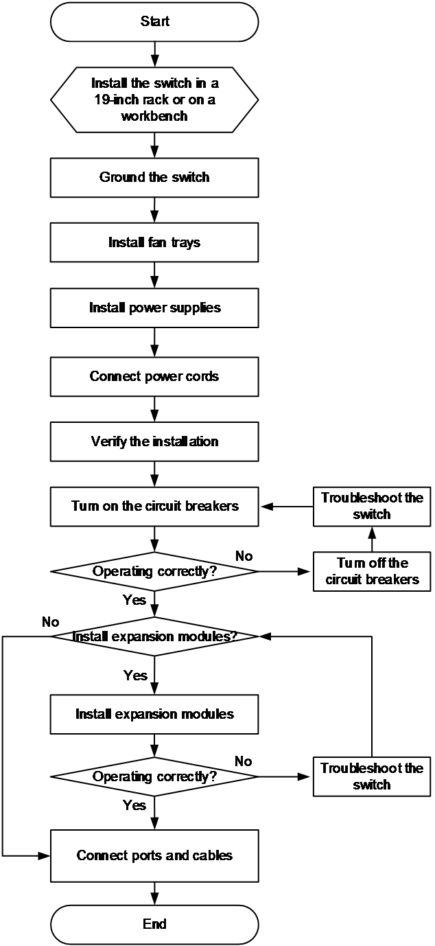

2 Installing the switch
CAUTION: Keep the tamper-proof seal on a mounting screw on the chassis cover intact, and if you want to open the chassis, contact H3C for permission. Otherwise, H3C shall not be liable for any consequence. |
Figure2-1 Hardware installation flow

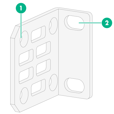

(1) Screw hole for attaching the bracket to the switch |
(2) Screw hole for attaching the bracket to the rack |
The switch has one mounting position near the network ports and the other mounting position near the power supplies for the mounting brackets. Select one position as needed.
To attach the front mounting brackets to the chassis:
1. Place the wide flange of the mounting bracket against the chassis side panel. Align the mounting bracket installation holes with the screw holes in the chassis.
¡ To install the mounting brackets at the port-side mounting position, see Figure2-3.
¡ To install the mounting brackets at the power supply-side mounting position, see Figure2-4.
2. Fasten the M4 screws (provided) to secure the mounting bracket to the switch.
3. Attach the mounting bracket to the other side of the chassis in the same way.
Figure2-3 Attaching the mounting brackets to the port-side mounting position
Figure2-4 Attaching the mounting brackets to the power supply-side mounting position
This task requires two people.
To mount the switch in the rack:
1. Wear an ESD wrist strap and make sure it makes good skin contact and is reliably grounded.
2. Verify that the mounting brackets have been securely attached to the switch chassis. See "Attaching the mounting brackets to the switch."
3. Attach cage nuts to the front rack posts.
4. One person supports the bottom of the switch, and moves the switch to an appropriate position based on the installation positions of the mounting brackets.
5. Another person uses user supplied M6 screws and cage nuts (user supplied, with anti-rust coating) to attach the mounting brackets to the rack and verifies that the brackets are level and secure.
Figure2-5 Mounting the switch in the rack

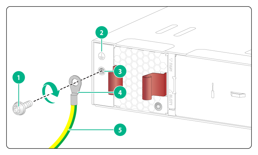

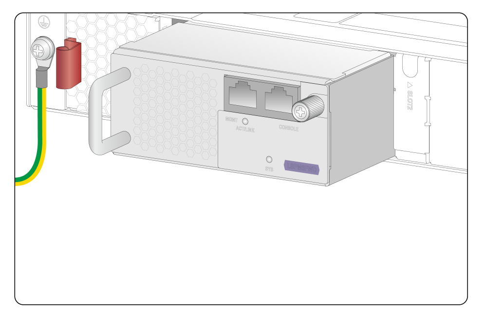

Connecting the grounding cable to the chassis
1. Remove the grounding screw in the rear panel of the chassis.
2. Use the grounding screw to attach the ring terminal of the grounding cable to the grounding screw hole. Fasten the screw. As a best practice, use a torque of 12 kgf-cm (1.18 Nm) to fasten the grounding screw.
IMPORTANT: Orient the grounding cable as shown in Figure2-6 so that you can easily install or remove the expansion cards. |
Figure2-6 Connecting the grounding cable to the chassis
(1) Grounding screw |
(2) Grounding sign |
(3) Grounding hole |
(4) Ring terminal |
(5) Grounding cable |
If the installation site does not have grounding strips, but earth ground is available, hammer a 0.5 m (1.64 ft) or longer angle iron or steel tube into the earth ground to act as a grounding conductor.
The dimensions of the angle iron must be a minimum of 50 × 50 × 5 mm (1.97 × 1.97 × 0.20 in). The steel tube must be zinc-coated and its wall thickness must be at least 3.5 mm (0.14 in).
Weld the yellow-green grounding cable to the angel iron or steel tube and treat the joint for corrosion protection.
Figure2-9 Grounding the switch by burying the grounding conductor into the earth ground
(2) Chassis rear panel |
(3) Grounding cable |
(4) Earth |
(5) Welding point |
(6) Grounding conductor |

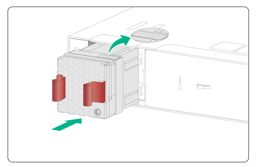

Installing a fan tray
CAUTION: To prevent damage to the fan tray or the connectors in the chassis, insert the fan tray gently. If you encounter a hard resistance while inserting the fan tray, pull out the fan tray and insert it again. |
To install a fan tray:
2. Unpack the fan tray and verify that the fan tray model is correct.
3. Grasp the two handles of the fan tray with the side marked TOP facing up, and slide the fan tray along the guide rails into the slot until the fan tray seats in the slot and has a firm contact with the backplane.
Figure2-10 Installing a fan tray

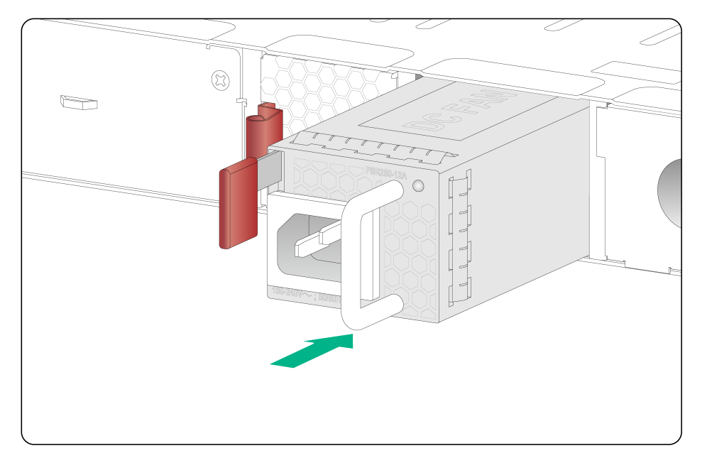

3. Unpack the power supply. Make sure the power supply model is as required.
Keep the packaging box and packaging bag for the power supply secure for future use.
4. Correctly orient the power supply. Make sure the lettering on the power supply is upward.
5. Align the power supply with the power supply slot. Grasping the handle of the power supply with one hand and supporting its bottom with the other, slide the power supply slowly into the slot along the guide rails until the latch of the power supply clicks into the slot.
To prevent damage to the power supply or the connectors on the backplane, insert the power supply gently. If you encounter a hard resistance when inserting the power supply, pull out the power supply and insert it again.
Figure2-15 Installing a power supply
Figure2-16 Installation completed

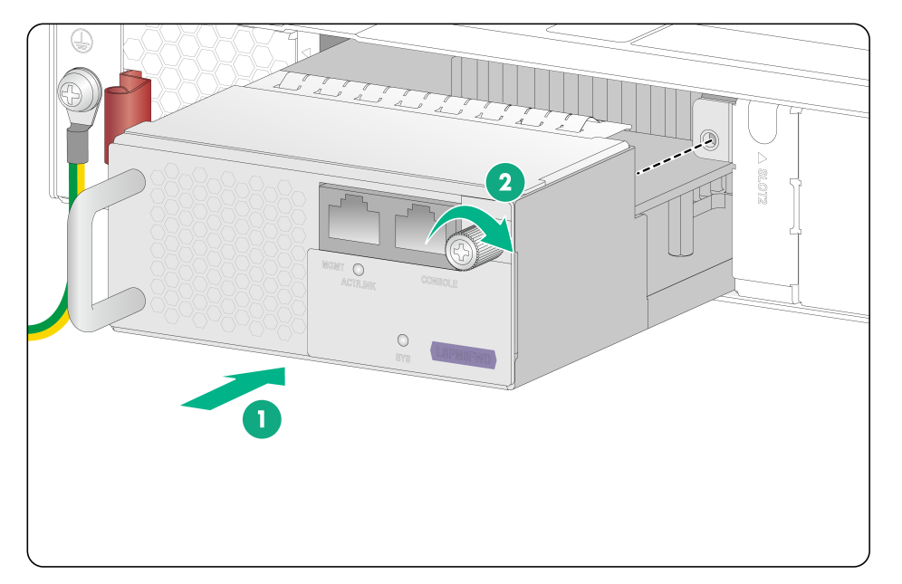

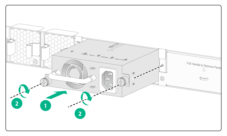

Installing a PSR180-12A-B, PSR180-12A-F, or PSR180-12D-B power supply
The installation procedure is the same for the PSR180-12A-B, PSR180-12A-F, and PSR180-12D-B power supplies. The following procedure installs a PSR180-12A-B power supply.
To install a PSR180-12A-B power supply:

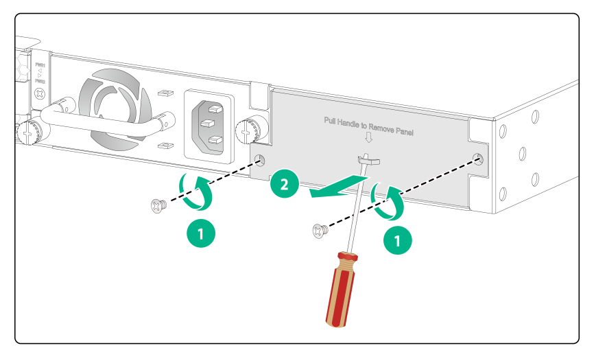

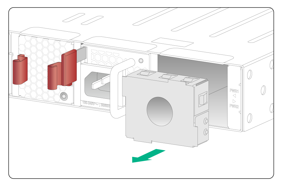

2. Remove the filler panel from the target power supply slot as follows:
a. Remove the screws from the filler panel.
b. Use a flathead screwdriver to remove the filler panel.
Figure2-18 Removing the filler panel
3. Unpack the power supply and verify that the power supply model is correct.
4. Correctly orient the power supply with the power supply slot (use the letters on the power supply faceplate for orientation), grasp the handle of the power supply with one hand and support its bottom with the other, and slide the power supply slowly along the guide rails into the slot (see callout 1 in Figure2-19).
5. Fasten the captive screws on the power supply with a Phillips screwdriver to secure the power supply in the chassis (see callout 2 in Figure2-19). If the captive screw cannot be tightly fastened, verify the installation of the power supply.
As a best practice, use a torque of 5 kgf-cm (0.49 Nm) to fasten the captive screws.
6. Install the filler panel over the empty power supply slot to prevent dust and ensure good ventilation if you install only one power supply.
Figure2-19 Installing a power supply

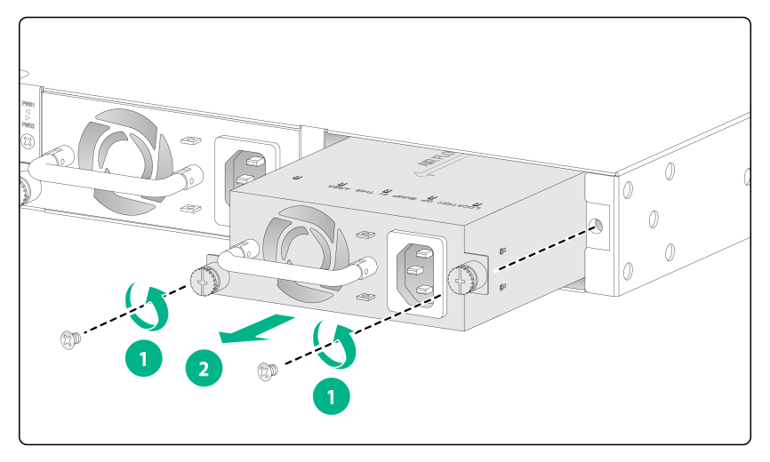

Removing a PSR180-12A-B, PSR180-12A-F, or PSR180-12D-B power supply
2. Disconnect the power cord.
3. Loosen the captive screws on the power supply with a Phillips screwdriver until they are completely disengaged.
4. Grasp the handle of the power supply with one hand and pull it out a little, support the bottom with the other hand, and pull the power supply slowly along the guide rails out of the slot.
Put away the removed power supply in an antistatic bag or the power supply package bag for future use.
Figure2-20 Removing a power supply

PSR180-12D-B |
–48 VDC power source in the equipment room |
RPS800-A or RPS1600-A |
Connecting the power cord for a PSR250-12A, PSR250-12A1, PSR920-54A-B, PSR600-54A-B, or PSR1600-54A-B supply

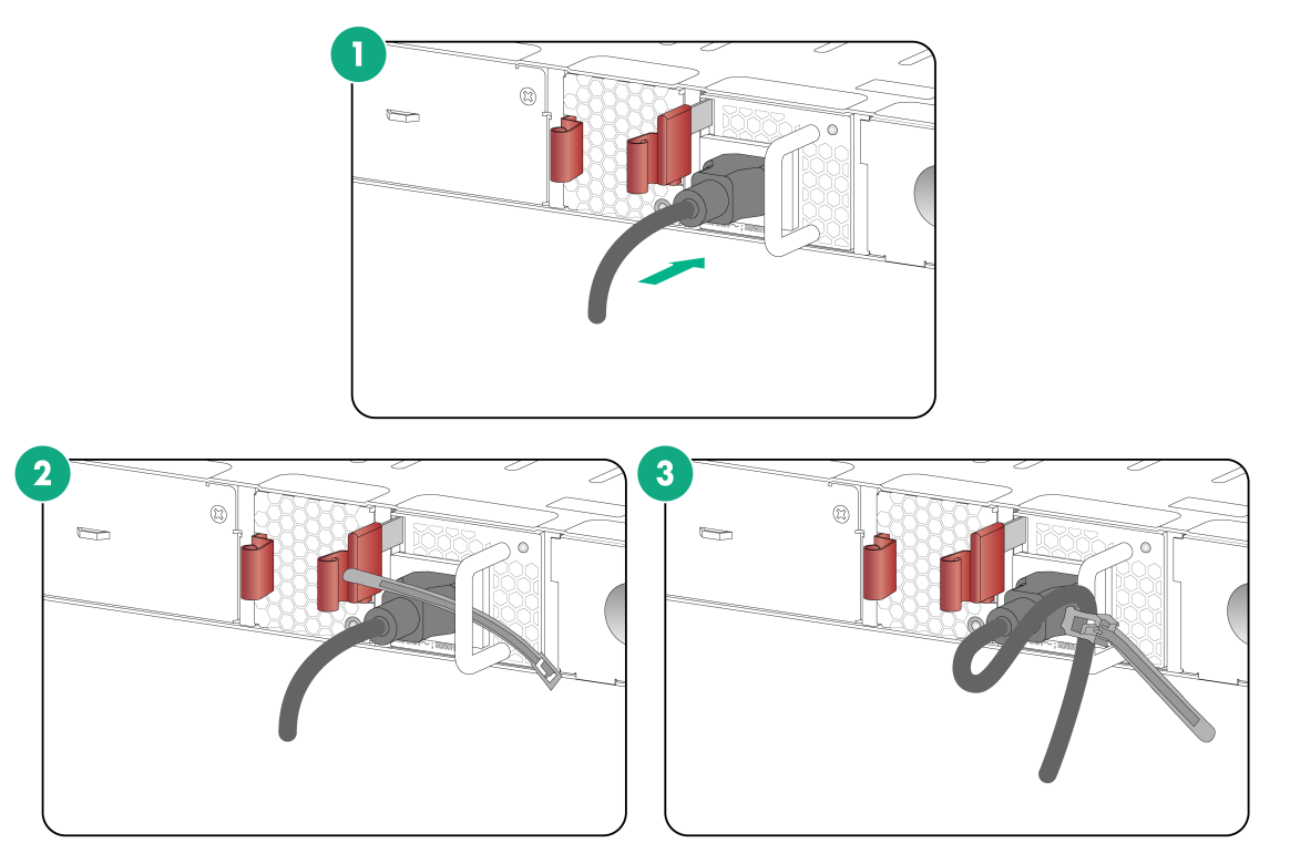

The power cord connection procedure is the same for the PSR250-12A, PSR250-12A1, PSR920-54A-B, PSR600-54A-B, and PSR1600-54A-B. The following uses a PSR250-12A1 as an example.
To connect the power cord:
1. Wear an ESD wrist strap. Make sure the strap makes good skin contact and is reliably grounded.
2. Plug the female connector of the power cord into the power receptacle on the power supply, as shown by callout 1 in Figure2-21.
3. Use a releasable cable tie to secure the power cord to the handle of the power supply, as shown by callouts 2 and 3 in Figure2-21.
4. Connect the other end of the power cord to an AC power source.
Figure2-21 Connecting the power cord for a PSR250-12A1 power supply

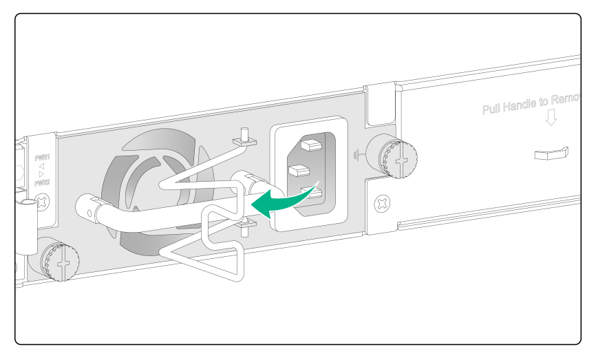

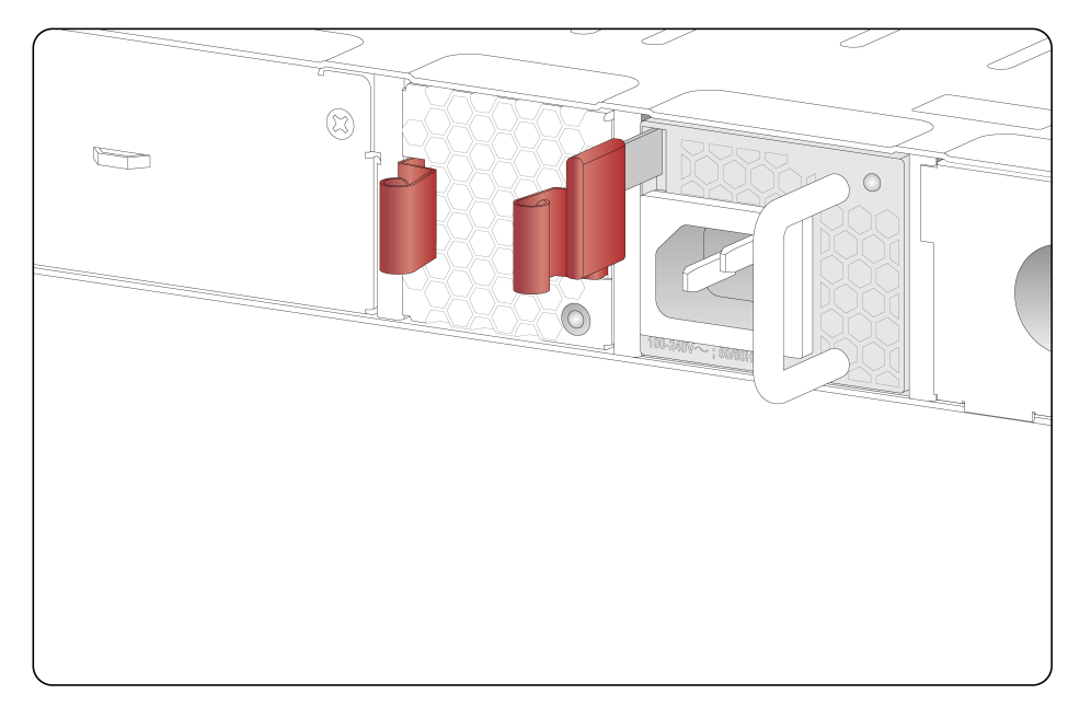

The power cord retainer clip in the following figures is for your reference only.
The power cord connection procedure is the same for the PSR180-12A-B and PSR180-12A-F power supplies. The following uses the PSR180-12A-B power supply as an example.
To connect the power cord for a PSR180-12A-B power supply:
2. Attach the power cord retainer clip (supplied with the power supply) into the two holes next to the AC-input power receptacle on the power supply, and pull the retainer clip leftwards (see Figure2-22).
3. Connect the female connector of the AC power cord supplied with the power supply to the power receptacle (see callout 1 in Figure2-23).
4. Pull the retainer clip rightwards to secure the connector to the AC-input power receptacle (see callout 2 in Figure2-23).
5. Connect the other end of the power cord to an AC power source.
Figure2-22 Connecting a power cord (1)
Figure2-23 Connecting a power cord (2)
CAUTION: · To use a –48 VDC power source to supply power to the power supply, use the DC power cord supplied with the power supply. · To use an H3C RPS to supply power to the power supply, use a compatible RPS power cord to connect the RPS to the power supply. · To connect a DC power cord to a –48 VDC power source, identify the positive (+) and negative (-) marks on the two wires of the power cord to avoid connection mistakes. |
To connect the power cord for a PSR180-12D-B power supply:
1. Correctly orient the plug at one end of the cable with the power receptacle on the power supply, and then insert the plug into the power receptacle (see callout 1 in Figure2-24).
If you orient the plug upside down, you cannot insert it into the power receptacle.
2. Fasten the screws on the plug with a flat-head screwdriver to secure the plug in the power receptacle (see callout 2 in Figure2-24).
3. Connect the other end of the power cord to a –48 VDC power source or an RPS.
Figure2-24 Connecting the power cord for a PSR180-12D-B power supply

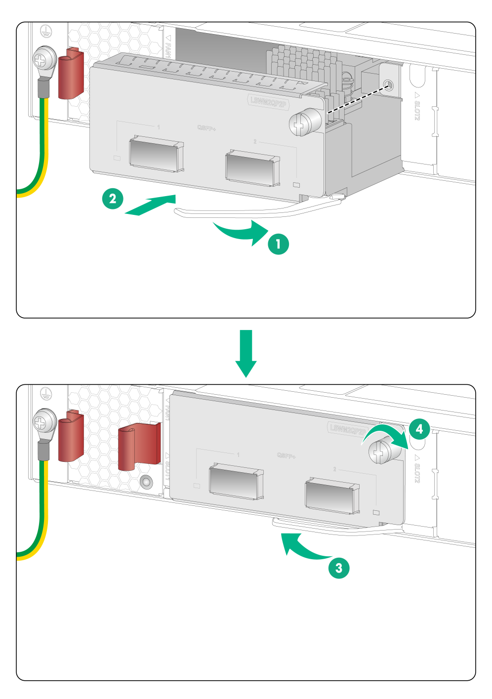

Installing an expansion card
2. Use a Phillips screwdriver to remove the mounting screw on the filler panel over the expansion slot. Then remove the filler panel.
Keep the filler panel for future use.
Figure2-25 Removing the filler panel over the expansion slot
3. Unpack the expansion card.
4. If the expansion card has an ejector lever, follow these steps to install it:
a. Rotate out the ejector lever, as shown by callout 1 in Figure2-26.
b. Gently push the expansion card into the slot along the guide rails until the expansion card has good contact with the chassis. See callout 2 in Figure2-26.
c. Rotate in the ejector lever, as shown by callout 3 in Figure2-26.
d. Use a Phillips screwdriver to tighten the captive screws on the expansion card to secure it in the slot. See callout 4 in Figure2-26.
5. If the expansion card does not have an ejector lever, follow these steps to install it:
a. Gently push the expansion card into the slot along the guide rails until the expansion card has good contact with the chassis. See callout 1 Figure2-27.
b. Use a Phillips screwdriver to tighten the captive screws on the expansion card to secure it in the slot. See callout 2 Figure2-27.
Figure2-26 Installing an expansion card with an ejector lever (LSWM2QP2P)
Figure2-27 Installing an expansion card without an ejector lever (LSPM6FWD)
Figure2-28 LSPM6FWD firewall card installed in the switch
NOTE: An LSPM6FWD firewall card (including its handle) adds 75 mm (2.95 in) to the chassis depth when installed on the device. An LSWM2EC card (including its handle) adds 76 mm (2.99 in) to the chassis depth when installed on the device. |
Removing an expansion card
2. Use a Phillips screwdriver to remove the captive screw on the expansion card.
3. (Optional.) If the expansion card has an ejector lever, rotate out the ejector lever.
Skip this step if the expansion card does not have an ejector lever.
4. Gently pull the expansion card out of the chassis along the guide rails.
5. If you are not to install a new expansion card after removing the original one, install a filler panel in the slot to prevent dust and ensure good ventilation in the switch.

Connecting a USB-to-RJ45 console cable
IMPORTANT: · To use a USB-to-RJ45 console cable to connect the switch to a configuration terminal, first download and install the USB-to-RJ45 console driver on the configuration terminal and then connect the USB-to-RJ45 console cable to the configuration terminal. · If you have connected a USB-to-RJ45 console cable to the configuration terminal before driver installation, you must remove and reconnect the USB-to-RJ45 console cable to the configuration terminal. |
Figure3-3 USB-to-RJ45 console cable
The following installs the driver on the Windows system. To install the driver on other operating systems, see the installation guide in the driver compression package named by the corresponding operating system.
To connect the switch to the configuration terminal through a USB-to-RJ45 console cable:
1. Click the following link, or copy it to the address bar on your browser and download the USB-to-RJ45 console driver.
http://www.h3c.com/en/home/USB_to_RJ45_Console/
2. View the TXT file Read me in the Windows folder to check whether the Windows system of the configuration terminal supports the driver.
3. If the Windows system supports the driver, install PL23XX-M_LogoDriver_Setup_v200_20190815.exe.
4. Click Next on the welcome page of the driver installation wizard.
Figure3-4 Driver installation wizard
5. Click Finish after the drive installation is completed.
Figure3-5 Finishing the driver installation
6. Connect the standard USB connector of the cable to the USB port of the configuration terminal.
7. Connect the RJ-45 connector of the cable to the console port of the switch.

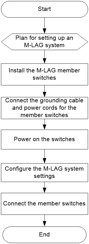

M-LAG system setup flowchart
Figure4-1 M-LAG system setup flowchart
To set up an M-LAG system:
Step |
Description |
1. Plan for setting up the M-LAG system. |
Plan for setting up the M-LAG system based on the network and device conditions: · Determine the installation locations of the switches. · Reserve physical ports for M-LAG connections. · Plan the cable connection scheme. For more information, see "Planning for setting up an M-LAG system." |
2. Install M-LAG member switches. |
3. Connect the grounding cable and power cords for the member switches. |
See "Grounding the switch" and "Connecting the power cord." |
4. Power on the switches. |
N/A |
5. Configure the M-LAG system settings. |
For detailed information about M-LAG, see M-LAG configuration in Layer 2—LAN Switching Configuration Guide for the switch series. |
6. Connect the member switches. |
Select cables or transceiver modules and optical fibers matching the rate of the physical ports of the peer link and keepalive link for connection. |

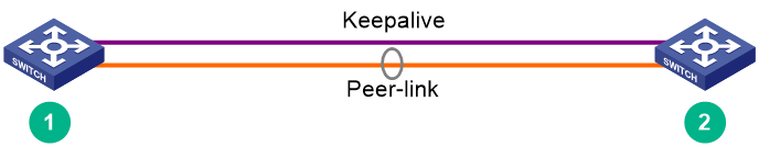

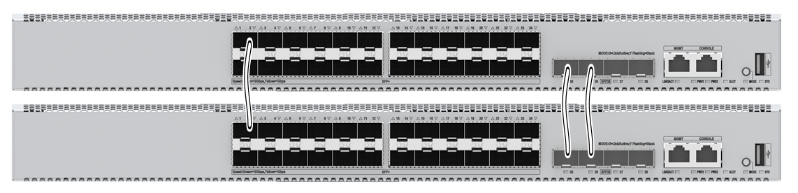

Connecting the member switches in one rack
If two M-LAG member devices are installed in the same rack, use the following connection method to connect them as a best practice.
Figure4-2 Connecting two M-LAG member devices are installed in the same rack
Figure4-3 Connection topology of two M-LAG member devices in the same rack

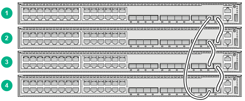

5 Setting up an IRF fabric
You can use H3C IRF technology to connect and virtualize S5590-HI, S5590-EI, or S5500V3-HI switches into a large virtual switch called an "IRF fabric" for flattened network topology, and high availability, scalability, and manageability.
A switch can set up an IRF fabric only with switches from the same switch series.

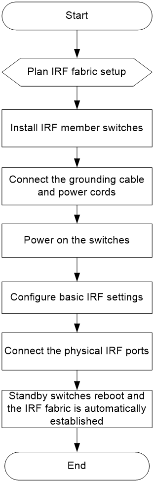

IRF fabric setup flowchart
Figure5-1 IRF fabric setup flowchart
To set up an IRF fabric:
Step |
Description |
1. Plan IRF fabric setup |
Plan the installation site and IRF fabric setup parameters: · Planning IRF fabric size and the installation site · Identifying the master switch and planning IRF member IDs · Planning IRF topology and connections |
2. Install IRF member switches |
See "Installing the switch in a 19-inch rack" or "Mounting the switch on a workbench." |
3. Connect grounding cables and power cords |
4. Power on the switches |
N/A |
5. Configure basic IRF settings |

6. Connect the physical IRF ports |
Connect physical IRF ports on switches. All switches except the master switch automatically reboot, and the IRF fabric is established. |
Planning IRF fabric setup
This section describes issues that an IRF fabric setup plan must cover.

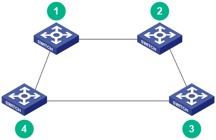

You can create an IRF fabric in daisy chain topology or more reliable ring topology. In ring topology, the failure of one IRF link does not cause the IRF fabric to split as in daisy chain topology. Instead, the IRF fabric changes to a daisy chain topology without interrupting network services.
You connect the IRF member switches through IRF ports, the logical interfaces for the connections between IRF member switches. Each IRF member switch has two IRF ports: IRF-port 1 and IRF-port 2. To use an IRF port, you must bind a minimum of one physical port to it.
When connecting two neighboring IRF member switches, you must connect the physical ports of IRF-port 1 on one switch to the physical ports of IRF-port 2 on the other switch. See Table5-1 for the available IRF physical ports. You can bind several IRF physical ports to an IRF port for increased bandwidth and availability.
Figure5-2 and Figure5-3 show the topologies of an IRF fabric made up of three S5590-28T8XC-HI switches. The IRF port connections in the two figures are for illustration only, and more connection methods are available.
Figure5-2 IRF fabric in daisy chain topology
Figure5-3 IRF fabric in ring topology

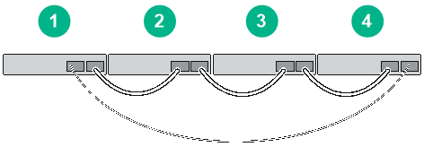

Connecting the IRF member switches in one rack
Connect the IRF member switches (4 switches in this example) in a rack as shown in Figure5-4. The switches in the ring topology (see Figure5-5) are in the same order as connected in the rack.
Figure5-4 Connecting the switches in one rack

Configuring basic IRF settings
After you install the IRF member switches, power on the switches, and log in to each IRF member switch to configure their member IDs, member priorities, and IRF port bindings.
Follow these guidelines when you configure the switches:
· Assign the master switch higher member priority than any other switch.
· Bind physical ports to IRF port 1 on one switch and to IRF port 2 on the other switch. You perform IRF port binding before or after connecting IRF physical ports depending on the software release.
· To bind the ports on an interface module to an IRF port, you must install the interface module first.
· Execute the display irf configuration command to verify the basic IRF settings.
For the S5590-48T4XC-HI and S5590-48S4XC-HI switches, you can use the port-speed-mode command to configure the port rate mode for an expansion slot. By default, the port rate mode for an expansion slot is mode0. To have the configuration take effect, you must save the configuration and restart the switch. For more information about the port-speed-mode command, see Ethernet interface commands in the command references for the switch.
To use a port on an expansion card as an IRF port, install an expansion card, and then configure IRF ports.
For more information about configuring basic IRF settings, see Virtual Technologies Configuration Guide in the configuration guides for the switch.
