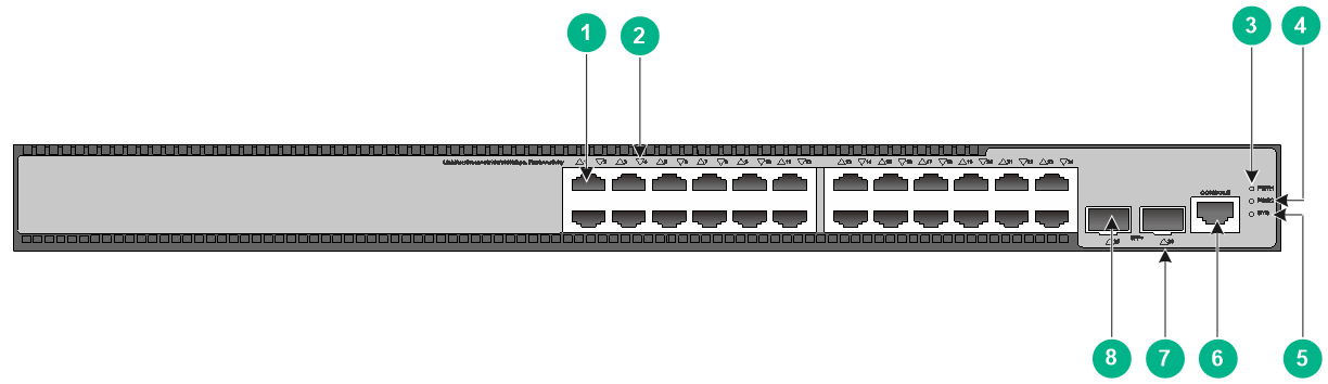

IE4320S-26S
Figure2-1 Front panel
(1) 10/100/1000BASE-T autosensing Ethernet port
(2) 10/100/1000BASE-T autosensing Ethernet port LED
(3) Power supply 1 status LED (PWR1)
(4) Power supply 2 status LED (PWR2)
(5) System status LED (SYS)
(6) Console port
(7) SFP+ port LED
(8) SFP+ port

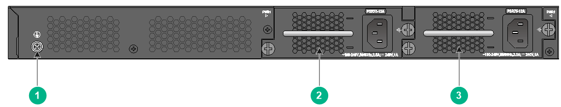

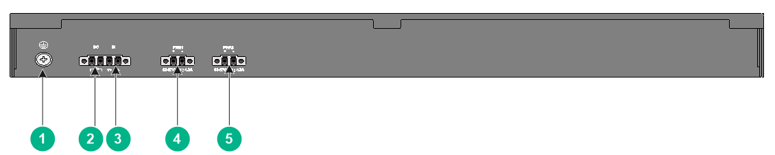

Figure2-2 Rear panel
(1) Grounding screw
(2) Removable power supply 1
(3) Removable power supply 2
The IE4320S-26S switch comes with power supply slot 1 empty and power supply slot 2 installed with a filler panel. You can install one or two power supplies for the switch as needed. In Figure2-2, two PSR75-12A AC power supplies are installed.

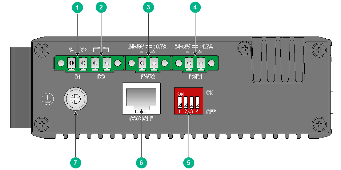

Figure2-6 Top panel
(1) Alarm input connection (DI)
(2) Alarm output connection (DO)
(3) DC power receptacle 2 (PWR2)
(4) DC power receptacle 1 (PWR1)
(5) DIP switch
(6) Console port
(7) Grounding screw

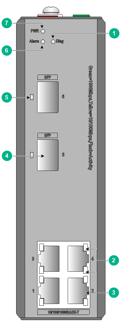

Figure2-7 Front panel
(1) Diag LED (Diag)
(3) 10/100/1000BASE-T autosensing Ethernet port
(4) SFP port
(5) SFP port LED
(6) Alarm LED (Alarm)
(7) Power supply status LED (PWR)

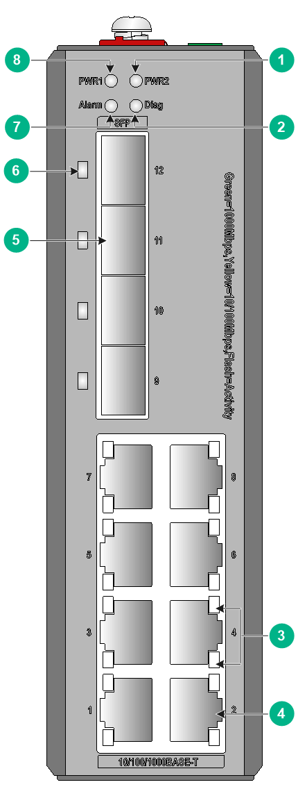

Figure2-9 Front panel
(1) Power supply status LED (PWR2)
(2) Diag LED (Diag)
(3) 10/100/1000BASE-T autosensing Ethernet port LED
(4) 10/100/1000BASE-T autosensing Ethernet port
(5) SFP port
(6) SFP port LED
(7) Alarm LED (Alarm)
(8) Power supply status LED (PWR1)

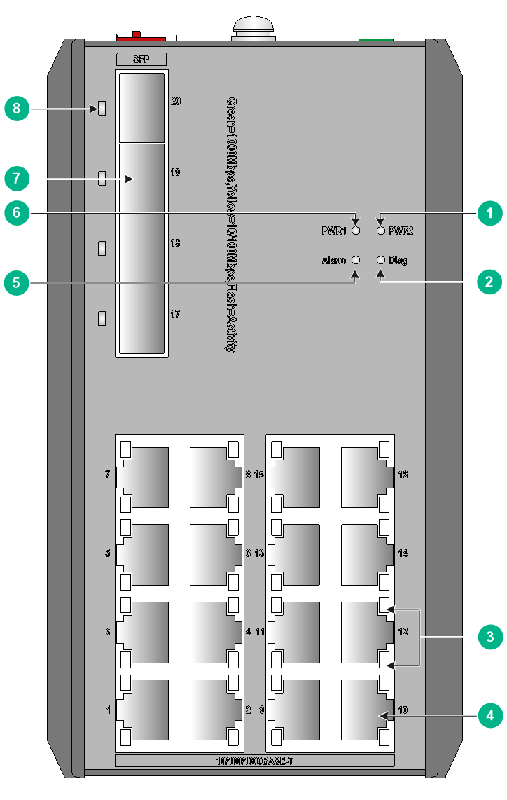

IE4320-20P
Figure2-13 Front panel
(2) Diag LED (Diag)
(5) Alarm LED (Alarm)
(6) Power supply status LED (PWR1)
(7) SFP port
(8) SFP port LED

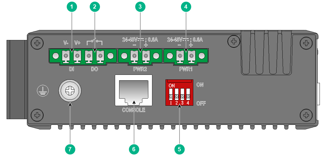

Figure2-14 Top panel
(5) DIP switch
(6) Console port
(7) Grounding screw

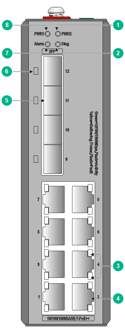

Figure2-15 Front panel
(2) Diag LED (Diag)
(5) SFP+ port
(6) SFP+ port LED

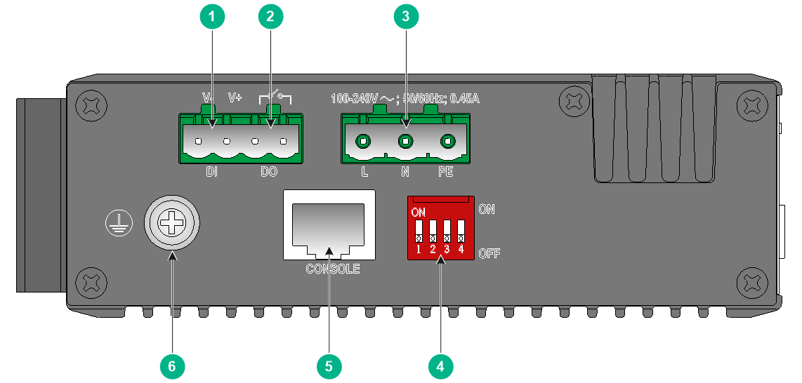

Figure2-16 Top panel
(5) DIP switch
(6) Console port
(7) Grounding screw

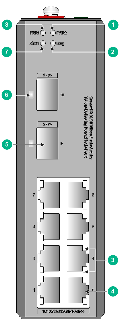

IE4320-10S-UPWR
Figure2-17 Front panel
(2) Diag LED (Diag)
(5) SFP+ port
(6) SFP+ port LED

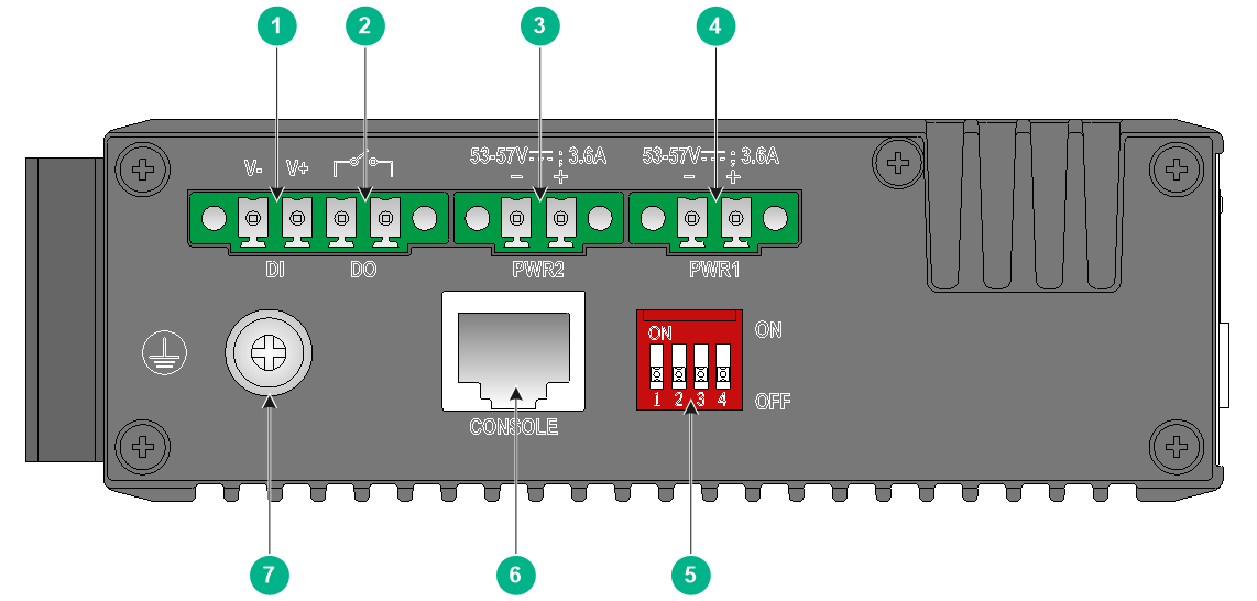

Figure2-18 Top panel
(5) DIP switch
(6) Console port
(7) Grounding screw

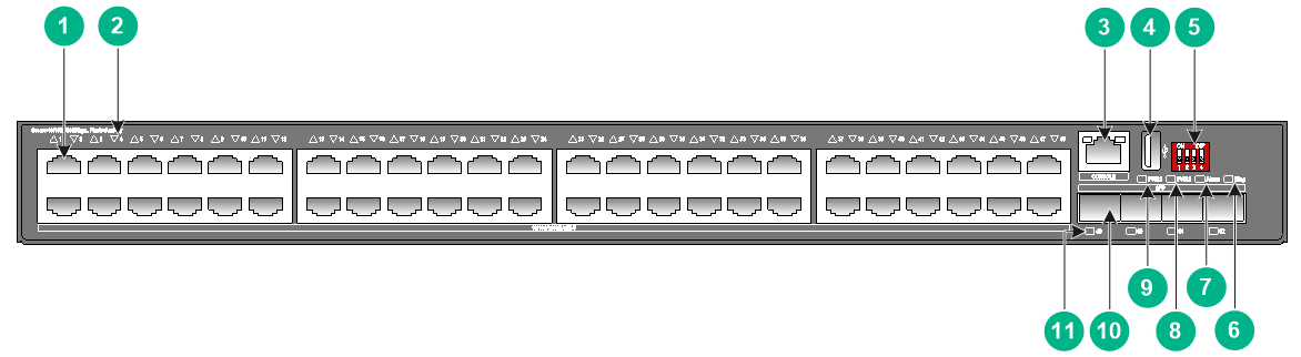

IE4320-28P

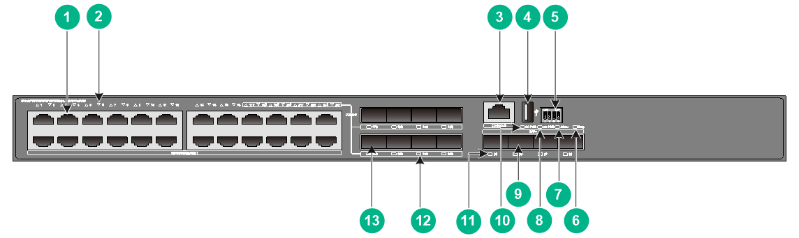

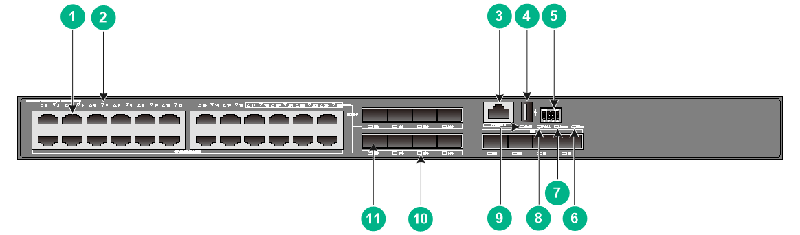

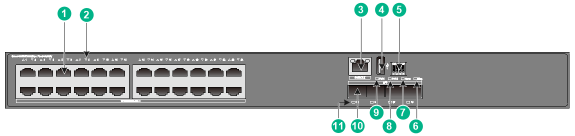

Figure2-19 Front panel
(3) Console port
(4) USB port
(5) DIP switch
(6) Diag LED
(7) Alarm LED
(8) Power supply status LED (PWR2)
(9) Power supply status LED (PWR1)
(10) SFP port LED
(11) SFP port

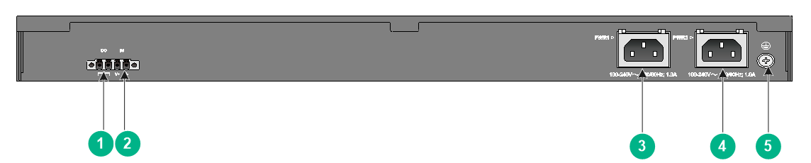

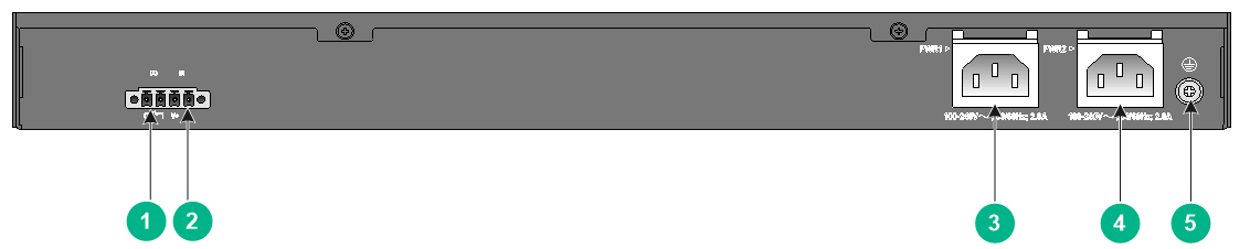

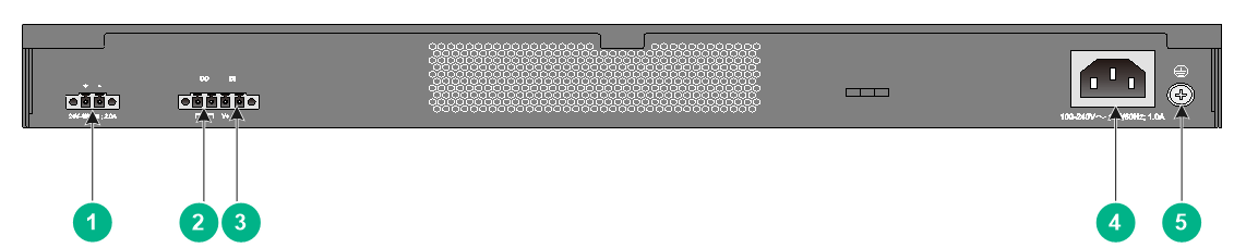

Figure2-20 Rear panel
(1) Alarm output connection (DO)
(2) Alarm input connection (DI)
(3) AC power receptacle 1
(4) AC power receptacle 2
(5) Grounding screw
The IE4320-28P switch has two fixed AC power receptacles on the rear panel. One AC power receptacle can meet the power requirement of the switch. You can use both of the AC power receptacles for redundancy.
IE4320-28P-S

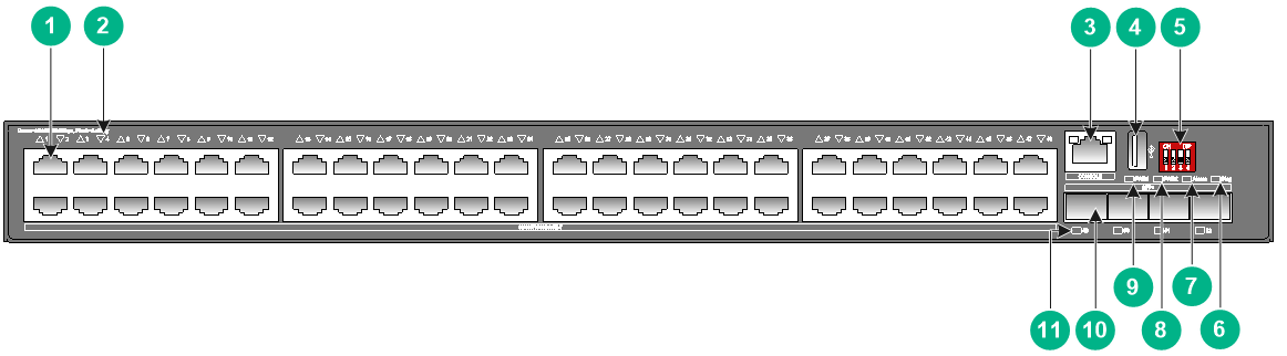

Figure2-21 Front panel
(3) Console port
(4) USB port
(5) DIP switch
(6) Diag LED
(7) Alarm LED
(10) SFP port
(11) SFP port LED
Figure2-22 Rear panel
(5) Grounding screw
The IE4320-28P-S switch has two fixed AC power receptacles on the rear panel. One AC power receptacle can meet the power requirement of the switch. You can use both of the AC power receptacles for redundancy.

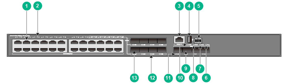

IE4320-28S

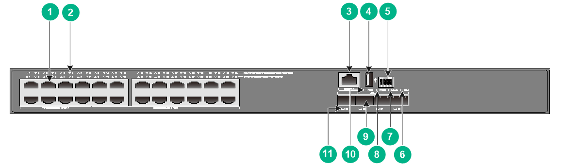

Figure2-23 Front panel
(3) Console port
(4) USB port
(5) DIP switch
(6) Diag LED
(7) Alarm LED
(9) SFP+ port
(10) Power supply status LED (PWR1)
(11) SFP+ port LED
(12) SFP port LED
(13) SFP port
Figure2-24 Rear panel
(5) Grounding screw
The IE4320-28S switch has two fixed AC power receptacles on the rear panel. One AC power receptacle can meet the power requirement of the switch. You can use both of the AC power receptacles for redundancy.
IE4320-28F

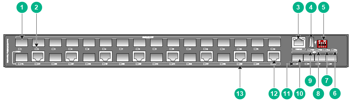

Figure2-25 Front panel
(1) SFP port
(2) SFP port LED
(3) Console port
(4) USB port
(5) DIP switch
(6) Diag LED
(7) Alarm LED
(10) SFP+ port
(11) SFP+ port LED
(12) 10/100/1000BASE-T autosensing Ethernet port
(13) 10/100/1000BASE-T autosensing Ethernet port LED

IE4320-28S-HPWR
Figure2-27 Front panel
(3) Console port
(4) USB port
(5) DIP switch
(6) Diag LED
(7) Alarm LED
(9) SFP+ port
(11) SFP+ port LED
Figure2-28 Rear panel
(1) Grounding screw
(3) Alarm input connection (DI)
(5) DC power receptacle 2
The IE4320-28S-HPWR switch supports dual DC power feeds. You can use two H3C DG-240-55XX industrial power supplies connected in parallel to achieve load sharing for high power requirements. For more information, see Table1-5.
IE4320-28S-PS1
Figure2-29 Front panel
(3) Console port
(4) USB port
(5) DIP switch
(6) Diag LED
(7) Alarm LED
(8) AC power supply status LED (AC PWR)
(9) SFP+ port
(10) DC power supply status LED (DC PWR)
(11) SFP+ port LED
(12) SFP port LED
(13) SFP port
Figure2-30 Rear panel
(1) DC power receptacle
(5) Grounding screw
The IE4320-28S-PS1 switch has one fixed AC power receptacle and one fixed DC power receptacle on the rear panel. One power receptacle can meet the power requirement of the switch. You can use both of the power receptacles for redundancy.

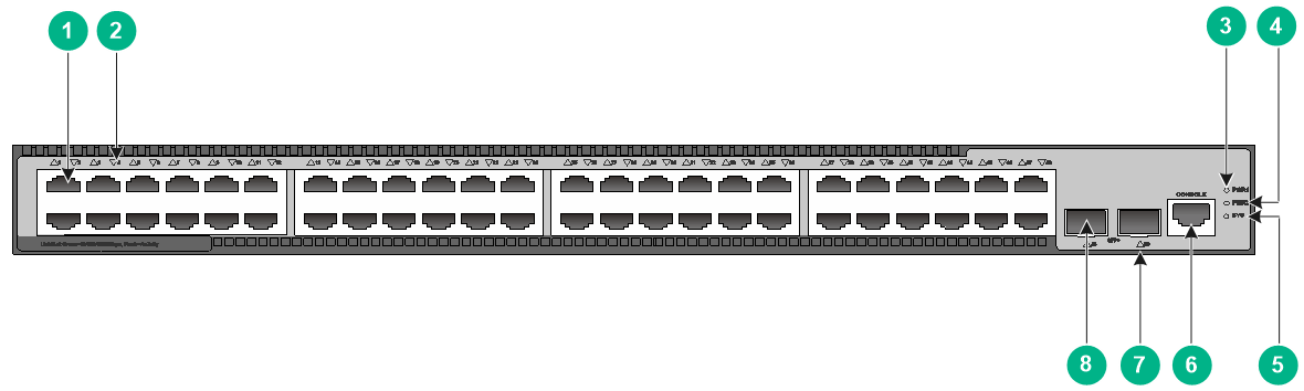

IE4320-52P
Figure2-31 Front panel
(3) Console port
(4) USB port
(5) DIP switch
(6) Diag LED
(7) Alarm LED
(10) SFP port
(11) SFP port LED
Figure2-32 Rear panel
(5) Grounding screw
The IE4320-52P switch has two fixed AC power receptacles on the rear panel. One AC power receptacle can meet the power requirement of the switch. You can use both of the AC power receptacles for redundancy.

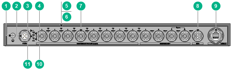

Figure2-35 Front panel
(1) Grounding screw
(2) DC power receptacle
(3) Power supply status LED (PWR1)
(4) Power supply status LED (PWR2)
(5) PoE status LED
(6) 10/100/1000BASE-T autosensing Ethernet port LED
(7) 10/100/1000BASE-T autosensing Ethernet port
(8) Alarm input/output connection (DI/DO)
(9) Console port
(10) Alarm LED
(11) Diag LED
Figure2-36 Rear panel
