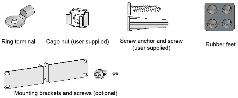

Installation accessories and tools

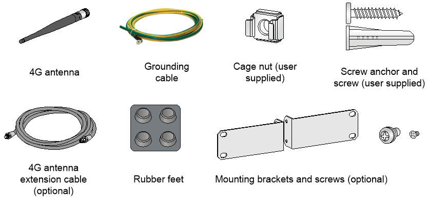

Installation accessories (RT-MSR810/RT-MSR810-W/RT-MSR810-W-DB/RT-MSR810-LM/RT-MSR810-LM-CNDE-SJK/RT-MSR810-W-LM/RT-MSR810-10-PoE-Plus/RT-MSR810-LM-HK/RT-MSR810-W-LM-HK/RT-MSR810-LM-GL/RT-MSR810-W-LM-GL)
Figure1-1 Installation accessories
IMPORTANT
IMPORTANT:
To wall-mount the router, you must prepare screw anchors and screws. Make sure the screw anchors and screws meet the following requirements:
·     The screw length is no less than 16 mm (0.63 in).
·     The screw thread diameter is between 3 mm and 3.5 mm (0.12 in to 0.14 in).
·     The screw head diameter is between 6 mm and 8 mm (0.24 in to 0.32 in).
·     The screw anchors are compatible with the screws.

·     Installation accessories supplied with the router are ready.
·     User-supplied tools are ready.

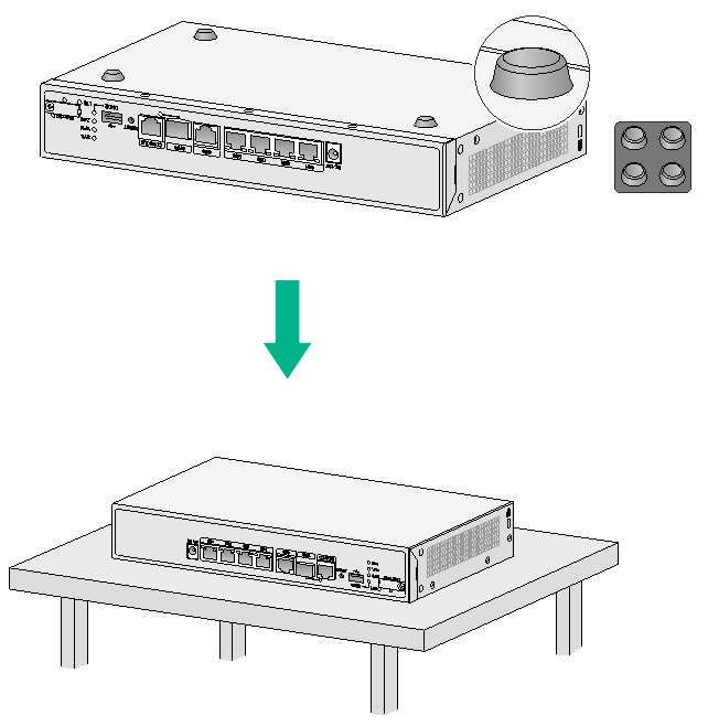

To mount the router on a workbench:
1.     Place the router upside down on the workbench and attach the rubber feet to the four round holes in the chassis bottom.
2.     Place the router upside up on the workbench.
Figure2-2 Mounting the router on a workbench

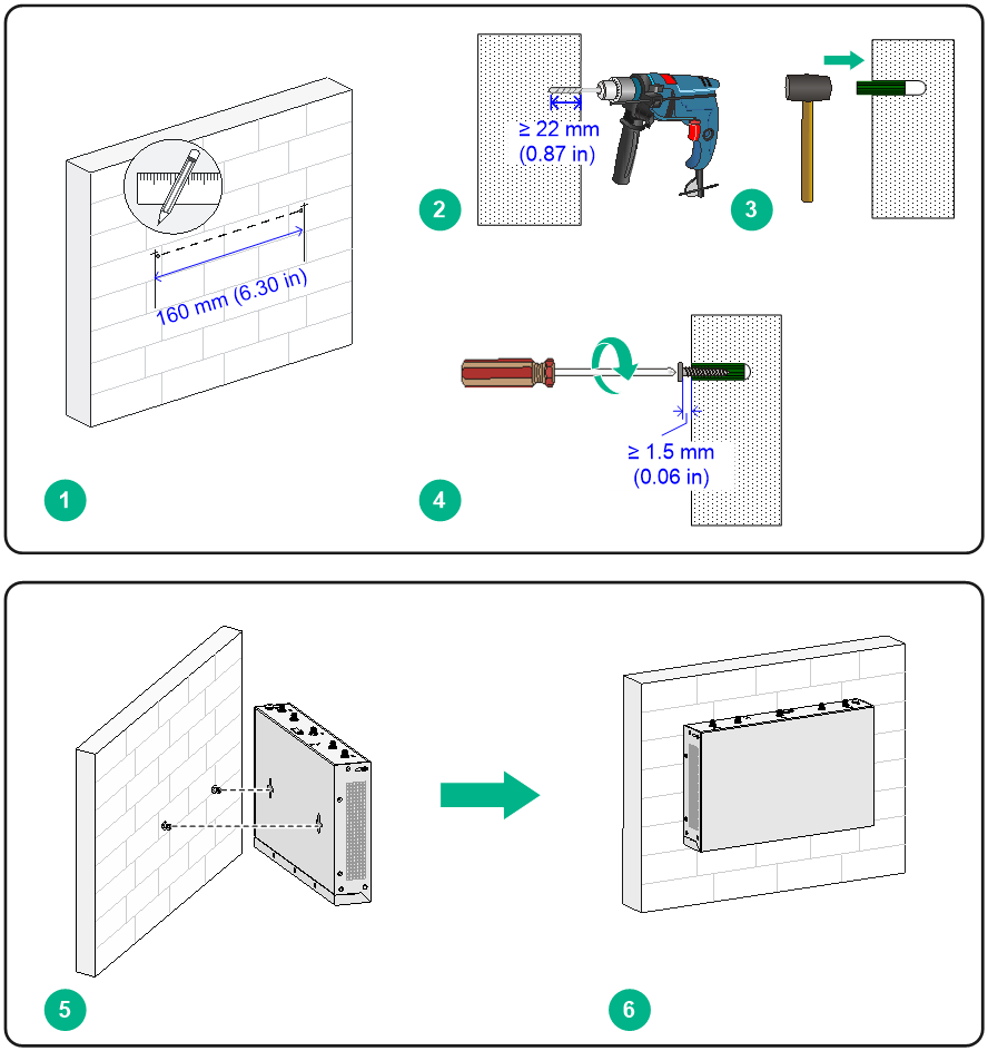

Mounting the router on a wall
Only the following routers support wall mounting:
·     RT-MSR810
·     RT-MSR810-LM
·     RT-MSR810-LM-CNDE-SJK
·     RT-MSR810-W-DB
·     RT-MSR810-W
·     RT-MSR810-W-LM
·     RT-MSR810-LM-HK
·     RT-MSR810-W-LM-HK
·     RT-MSR810-LM-GL
·     RT-MSR810-W-LM-GL
·     RT-MSR810-CNDE-SJK
·     RT-MSR810-SI
·     RT-MSR810-EI
·     RT-MSR810-LM-SI
·     RT-MSR810-LM-EA
·     RT-MSR810-LM-EI
To mount the router on a wall:
1.     Mark two screw hole locations on the wall. The horizontal spacing between the two holes varies by router model as described in Table2-1.
Table2-1 Wall mounting hole spacing
Spacing
Device models
160 mm (6.30 in)
RT-MSR810, RT-MSR810-LM, RT-MSR810-LM-CNDE-SJK, RT-MSR810-W-DB, RT-MSR810-W, RT-MSR810-W-LM, RT-MSR810-LM-HK, RT-MSR810-W-LM-HK, RT-MSR810-LM-GL, RT-MSR810-W-LM-GL, RT-MSR810-CNDE-SJK
152 mm (5.98 in)
RT-MSR810-SI, RT-MSR810-EI, RT-MSR810-LM-SI, RT-MSR810-LM-EA, RT-MSR810-LM-EI
2.     Drill holes with a minimum depth of 22 mm (0.87 in) in the marked locations.
3.     Hammer an anchor into each hole until the anchor is flush with the wall.
4.     Drive a screw into each anchor and make sure the screw protrudes a minimum of 1.5 mm (0.06 in) from the wall.
5.     Hang the router on the screws.
Position the router so the network interfaces face downwards, and the sides with ventilation openings are perpendicular to the ground, as shown in Figure2-3.
Figure2-3 Wall-mounting the router (RT-MSR810-W-LM)

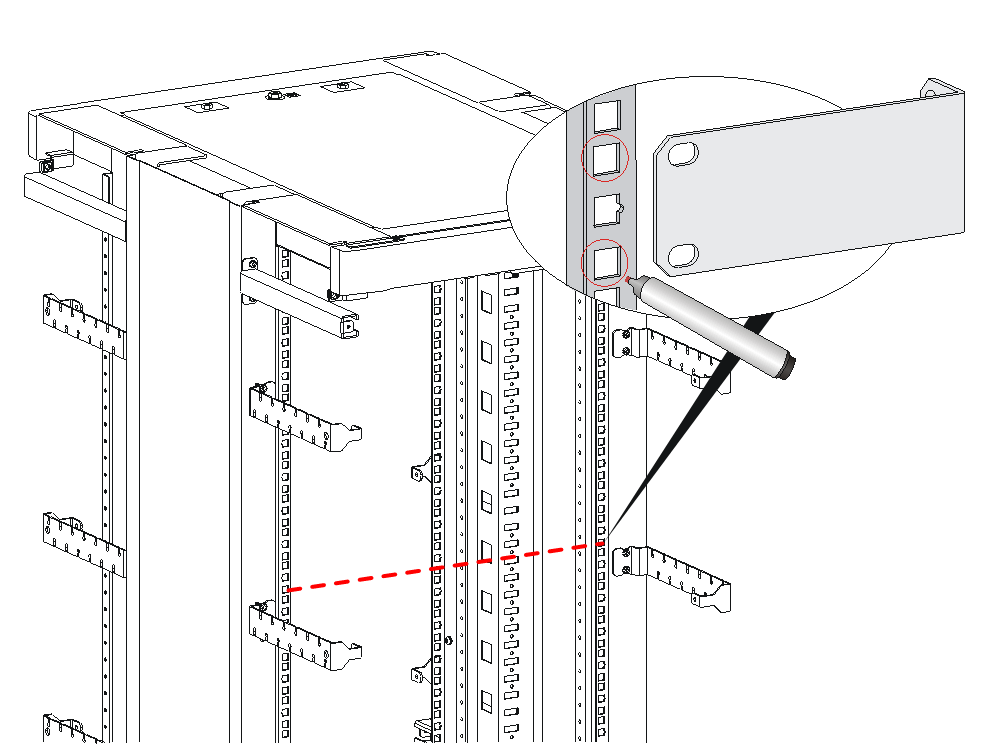

To install the router in a rack:
1.     Use a mounting bracket to mark the cage nut installation holes in the front rack posts, as shown in Figure2-4.
Make sure the cage nut installation holes on the front rack posts are on a horizontal line.
Figure2-4 Marking cage nut installation holes

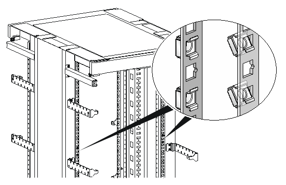

2.     Install the cage nuts, as shown in Figure2-5.
a.     Insert one ear of a cage nut into the marked installation hole.
b.     Use a flathead screwdriver to push another ear into the same hole.
Figure2-5 Installing cage nuts

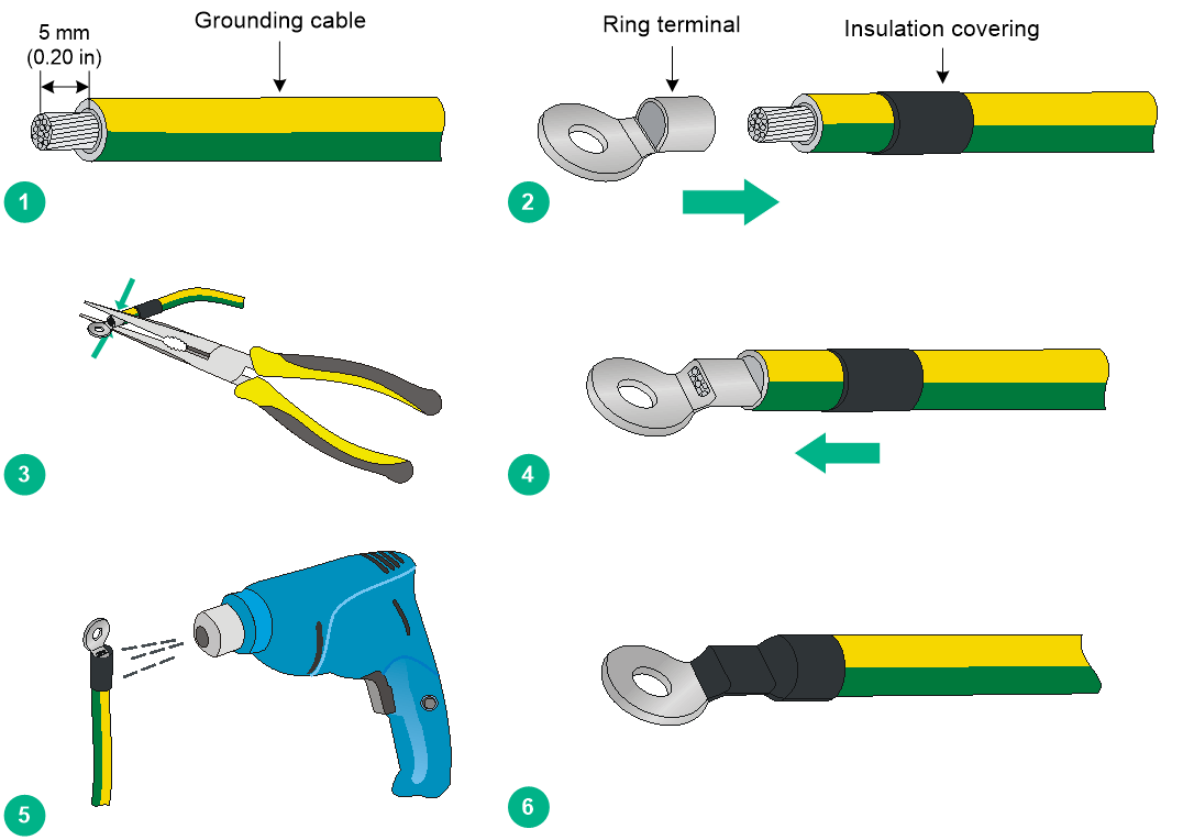

Attaching the grounding cable to the ring terminal
1.     Cut the grounding cable to the desired length.
2.     Use the wire-stripping pliers to peel 5 mm (0.20 in) of insulation sheath from one end of the grounding cable.
3.     Add a heat-shrink tubing on the cable.
4.     Insert the bare metal part of the grounding cable into the ring terminal.
5.     Use the needle-nose pliers to secure the metal part of the cable in the ring terminal.
6.     Cover the joint with the heat-shrink tubing, and use a blow dryer to shrink the tubing around the cable.
Figure2-8 Attaching the grounding cable to the ring terminal

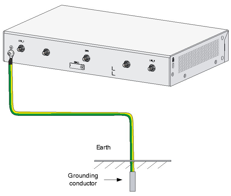

Grounding the router with a grounding conductor buried in the earth ground
If the installation site does not have any grounding strips, but earth ground is available, hammer a 0.5 m (1.64 ft) or longer angle iron or steel tube into the earth ground to serve as a grounding conductor.
Weld the yellow-green grounding cable to the angel iron or steel tube and treat the joint for corrosion protection.
Figure2-10 Grounding the router with a grounding conductor buried in the earth ground

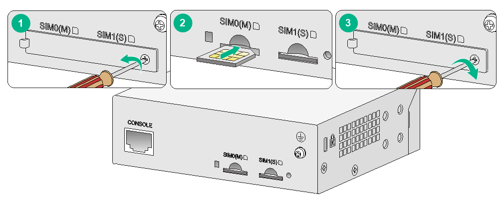

To install a 4G SIM card:
1.     Use a PH2 screwdriver to remove the M3 × 4 mm (0.16 in) countersunk screw on the 4G SIM card slot cover and then take off the cover.
2.     Orient the SIM card with its cut-off corner in the direction as shown in the label above the slot.
3.     Reinstall the cover and fasten the screw.
Figure2-11 Installing a 4G SIM card (RT-MSR810-LMS/RT-MSR810-LUS)

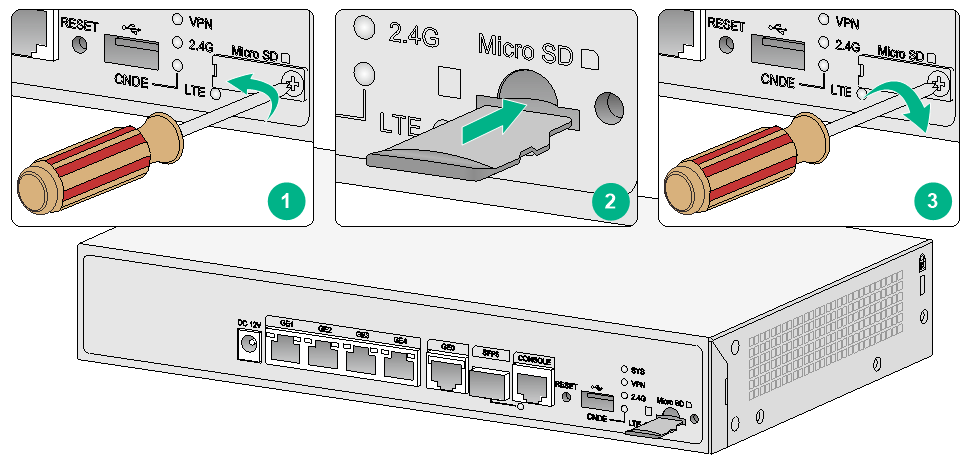

To install a Micro SD card:
1.     Use a PH2 screwdriver to remove the M3 × 4 mm (0.16 in) countersunk screw on the Micro SD card slot cover and then take off the cover.
2.     Insert the Micro SD card into the Micro SD card slot along the guide rails.
3.     Reinstall the cover and use a PH2 screwdriver to fasten the screw on the cover.
Figure2-12 Installing a Micro SD card

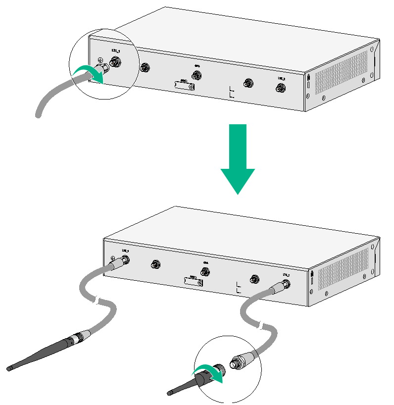

Installing a 4G antenna extension cable
Only the following routers support 4G antenna extension cables:
·     RT-MSR810-LM
·     RT-MSR810-W-LM
·     RT-MSR810-LM-HK
·     RT-MSR810-W-LM-HK
·     RT-MSR810-LM-GL
·     RT-MSR810-W-LM-GL
·     RT-MSR810-LME
·     RT-MSR810-LMS
·     RT-MSR810-LMS-EA
·     RT-MSR810-LUS
·     RT-MSR810-LM-SI
·     RT-MSR810-LM-EA
·     RT-MSR810-LM-EI
No 4G antenna extension cable is provided with the routers. Purchase one yourself if required.
Do not use 5 m (16.40 ft) and 10 m (32.81 ft) 4G antenna extension cables simultaneously for the same router.
You can connect a 4G antenna extension cable to a stick antenna or a 4G-LTE magnetic mount antenna. The connection procedure is the same. The following procedure connects a 4G antenna extension cable to a stick antenna.
To connect a 4G antenna extension cable to a stick antenna:
1.     Connect the SMA male connector (labeled with the cable product code) of the 4G antenna extension cable to the antenna port on the router and fasten the connector.
2.     Connect the SMA female connector of the cable to a 4G antenna.
Figure2-15 Connecting a 4G antenna extension cable

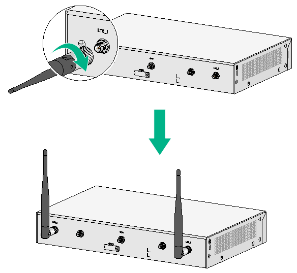

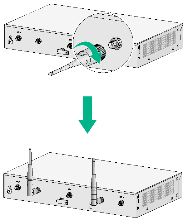

Installing a WLAN antenna
Only the following routers support WLAN antennas:
·     RT-MSR810-W
·     RT-MSR810-W-LM
·     RT-MSR810-W-DB
·     RT-MSR810-W-LM-HK
·     RT-MSR810-W-LM-GL
You can install two WLAN antennas for the RT-MSR810-W, RT-MSR810-W-LM, RT-MSR810-W-LM-HK, and RT-MSR810-W-LM-GL routers and four WLAN antennas for the RT-MSR810-W-DB router.
To install a WLAN antenna:
1.     Change the angle of the antenna orientation from vertical to horizontal.
2.     Attach the antenna to the WLAN antenna port on the router. Do not over-tighten the antenna to avoid damage.
For better signal receiving, change the antenna orientation to vertical.
Figure2-16 Installing WLAN antennas

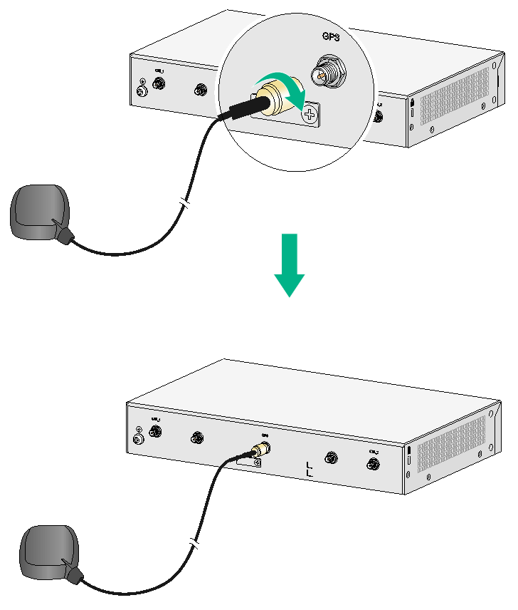

Installing a GPS antenna
Only the routers support a GPS antenna:
·     RT-MSR810-LM
·     RT-MSR810-W-LM
·     RT-MSR810-LM-HK
·     RT-MSR810-W-LM-HK
·     RT-MSR810-LM-GL
·     RT-MSR810-W-LM-GL
To install a GPS antenna:
1.     Attach the male connector of the GPS antenna to the GPS antenna port on the router.
Do not use excessive force to avoid antenna damage.
2.     Attach the magnetic antenna radome to a metal surface.
Figure2-17 Installing a GPS antenna

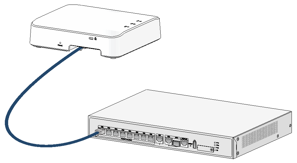

Supplying power to a terminal through PoE
Only the RT-MSR810-10-PoE-Plus router supports PoE. To supply power to a terminal, the terminal must support PoE.
To supply power to a terminal through PoE:
1.     Connect one end of the cable to an Ethernet port on the router.
2.     Connect the other end of the cable to the Ethernet port on a terminal.
3.     Examine the port LEDs on the router. For more information about the LEDs, see H3C MSR810 Routers Hardware Information and Specifications.
Figure2-18 Supplying power to a terminal

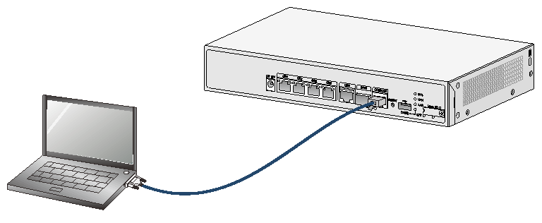

Connecting the console cable and setting terminal parameters
CAUTION
CAUTION:
The serial ports on PCs do not support hot swapping. To connect a PC to an operating router, first connect the PC end. To disconnect a PC from an operating router, first disconnect the router end.
To connect the console cable:
1.     Select a configuration terminal, which can be an ASCII terminal with an RS-232 serial port or a PC. (A PC is more commonly used.)
2.     Connect the DB-9 connector (female) of the console cable to the RS-232 serial port on the configuration terminal and the RJ-45 connector to the console port of the router.
Figure2-20 Connecting the console cable

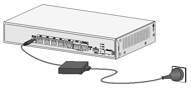

Connecting the power adapter
CAUTION
CAUTION:
To avoid power adapter damage, use the power adapter provided with the router.
To connect the power adapter:
1.     Make sure the router is reliably grounded.
2.     Connect the power adapter to the AC receptacle.
3.     Connect the DC output plug of the power adapter to the power adapter receptacle on the router.
Figure2-21 Connecting the power adapter (RT-MSR810/MSR810-LM/RT-MSR810-LM-CNDE-SJK/RT-MSR810-W-DB/RT-MSR810-W/RT-MSR810-W-LM/RT-MSR810-LM-HK/RT-MSR810-W-LM-HK/RT-MSR810-LM-GL/RT-MSR810-W-LM-GL/RT-MSR810-CNDE-SJK/RT-MSR810-SI/RT-MSR810-EI/RT-MSR810-LM-SI/RT-MSR810-LM-EA/RT-MSR810-LM-EI)

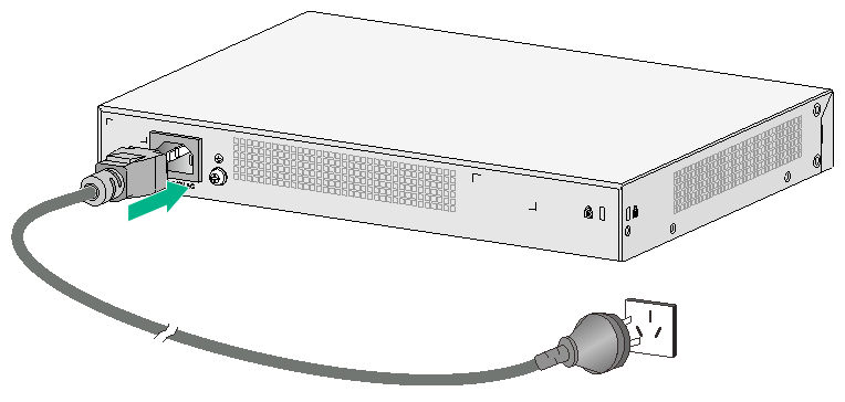

Connecting the power cord
2.     Connect the power cord to the AC receptacle.
3.     Insert the AC output plug of the power cord to the power adapter receptacle on the router.
Figure2-23 Connecting the power cord for the RT-MSR810-10-PoE-Plus
