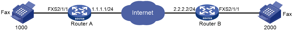

About FoIP
Fax over IP (FoIP) transmits and receives faxes over the Internet.
Figure 1 FoIP network diagram
Fax transmission operates in the following phases:
1.     Call establishment—The calling terminal sends a Calling Tone (CNG) to identify itself as a fax machine. The called terminal sends a Called Station Identifier (CED) tone to identify itself as a fax machine.
2.     Pre-message procedure—The calling or called terminals identify and negotiate the fax capabilities, including the modulation speed.
3.     In-message procedure—The calling terminal transmits fax packets in accordance with the T.4 procedure. Packet transmission control functions are performed (including packets synchronization, error detection and correction, and line monitoring).
4.     Post-message procedure—The calling or called terminal performs the control operations such as end-of-message signaling, confirmation signaling, and multipage signaling.
5.     Call release—Either the calling or called terminal disconnects the call.
