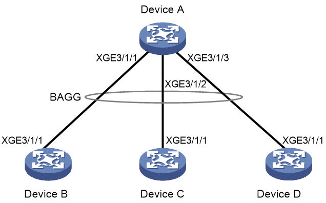

Ethernet link aggregation application scenario
As shown in Figure 1, Device A and Device B are connected by three physical Ethernet links. These physical Ethernet links are combined into an aggregate link called link aggregation 1. The bandwidth of this aggregate link can reach up to the total bandwidth of the three physical Ethernet links. At the same time, the three Ethernet links back up one another. When a physical Ethernet link fails, the traffic transmitted on the failed link is switched to the other two links.
Figure 1 Ethernet link aggregation diagram

S-MLAG
Simple multichassis link aggregation (S-MLAG) enhances dynamic link aggregation to establish an aggregation that spans multiple standalone devices to a remote device.
An S-MLAG multichassis aggregation connects one dynamic Layer 2 aggregate interface on each S-MLAG device to the remote device, as shown in Figure 4.
S-MLAG uses an S-MLAG group to manage the aggregate interfaces for each aggregation, and it runs LACP to maintain each aggregation as does dynamic link aggregation. To the remote device, the S-MLAG devices appear as one peer aggregation system.
Figure 4 S-MLAG application scenario

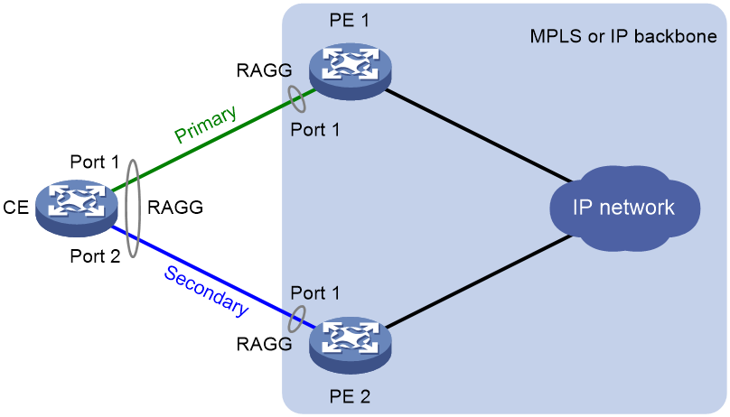

Configuring a 1+1 backup aggregation group
About 1+1 backup link aggregation
As shown in Figure 5, a 1+1 backup aggregation group is used on a CE that is dualhomed to PEs for high availability of services. A 1+1 backup aggregation group is a static Layer 3 aggregation group that contains one primary member port and one secondary member port. The primary member port is placed in Selected state to forward all traffic, and the secondary member port is placed in Unselected state as a standby.
Figure 5 Application scenarios for 1+1 backup link aggregation
1+1 backup link aggregation tasks at a glance

Enabling local-first load sharing for link aggregation
Use local-first load sharing in a multichassis link aggregation scenario to distribute traffic preferentially across member ports on the ingress slot.
When you aggregate ports on different member devices in an IRF fabric, you can use local-first load sharing to reduce traffic on IRF links, as shown in Figure 6. For more information about IRF, see Virtual Technologies Configuration Guide.
Figure 6 Load sharing for multichassis link aggregation in an IRF fabric
2.     Enable local-first load sharing for link aggregation.
link-aggregation load-sharing mode local-first
By default, local-first load sharing is enabled.

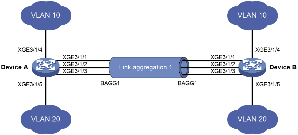

Example: Configuring a Layer 2 static aggregation group
On the network shown in Figure 7, perform the following tasks:
·     Configure a Layer 2 static aggregation group on both Device A and Device B.
·     Enable VLAN 10 at one end of the aggregate link to communicate with VLAN 10 at the other end.
·     Enable VLAN 20 at one end of the aggregate link to communicate with VLAN 20 at the other end.
Figure 7 Network diagram
1.     Configure Device A:
# Create VLAN 10, and assign port Ten-GigabitEthernet 3/1/4 to VLAN 10.
<DeviceA> system-view
[DeviceA] vlan 10
[DeviceA-vlan10] port ten-gigabitethernet 3/1/4
[DeviceA-vlan10] quit
# Create VLAN 20, and assign port Ten-GigabitEthernet 3/1/5 to VLAN 20.
[DeviceA] vlan 20
[DeviceA-vlan20] port ten-gigabitethernet 3/1/5
[DeviceA-vlan20] quit
# Create Layer 2 aggregate interface Bridge-Aggregation 1.
[DeviceA] interface bridge-aggregation 1
[DeviceA-Bridge-Aggregation1] quit
# Assign ports Ten-GigabitEthernet 3/1/1 through Ten-GigabitEthernet 3/1/3 to link aggregation group 1.
[DeviceA] interface ten-gigabitethernet 3/1/1
[DeviceA-Ten-GigabitEthernet3/1/1] port link-aggregation group 1
[DeviceA-Ten-GigabitEthernet3/1/1] quit
[DeviceA] interface ten-gigabitethernet 3/1/2
[DeviceA-Ten-GigabitEthernet3/1/2] port link-aggregation group 1
[DeviceA-Ten-GigabitEthernet3/1/2] quit
[DeviceA] interface ten-gigabitethernet 3/1/3
[DeviceA-Ten-GigabitEthernet3/1/3] port link-aggregation group 1
[DeviceA-Ten-GigabitEthernet3/1/3] quit
# Configure Layer 2 aggregate interface Bridge-Aggregation 1 as a trunk port and assign it to VLANs 10 and 20.
[DeviceA-Bridge-Aggregation1] port link-type trunk
[DeviceA-Bridge-Aggregation1] port trunk permit vlan 10 20
2.     Configure Device B in the same way Device A is configured. (Details not shown.)
# Display detailed information about all aggregation groups on Device A.
[DeviceA] display link-aggregation verbose
Loadsharing Type: Shar -- Loadsharing, NonS -- Non-Loadsharing
Port Status: S -- Selected, U -- Unselected, I -- Individual
Port: A -- Auto
Flags:  A -- LACP_Activity, B -- LACP_Timeout, C -- Aggregation,
        G -- Defaulted, H -- Expired
Aggregate Interface: Bridge-Aggregation1
Aggregation Mode: Static
  Port             Status  Priority Oper-Key
  XGE3/1/1         S       32768    1
  XGE3/1/2         S       32768    1
  XGE3/1/3         S       32768    1
The output shows that link aggregation group 1 is a Layer 2 static aggregation group that contains three Selected ports.

Example: Configuring S-MLAG
Device B, Device C, and Device D are standalone devices. As shown in Figure 12, configure Device B, Device C, and Device D as S-MLAG devices to establish a multichassis aggregate link with Device A.
Figure 12 Network diagram

# Verify that Ten-GigabitEthernet 3/1/1 through Ten-GigabitEthernet 3/1/3 on Device A are Selected ports.
Port: A -- Auto
Aggregate Interface: Bridge-Aggregation10
Aggregation Mode: Dynamic
System ID: 0x8000, 40fa-264f-0100
Local:
  Port                Status   Priority Index    Oper-Key               Flag
  XGE3/1/1            S        32768    1        1                      {ACDEF}
  XGE3/1/2            S        32768    2        1                      {ACDEF}
  XGE3/1/3            S        32768    3        1                      {ACDEF}
Remote:
  Actor               Priority Index    Oper-Key SystemID               Flag
  XGE3/1/1            32768    16385    50100    0x7b  , 0001-0001-0001 {ACDEF}
  XGE3/1/2            32768    32769    50100    0x7b  , 0001-0001-0001 {ACDEF}
  XGE3/1/3            32768    49153    50100    0x7b  , 0001-0001-0001 {ACDEF}
