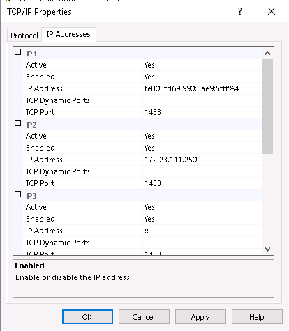

·     Turn off the Windows firewall on the SQL Server host to open TCP port 1443.

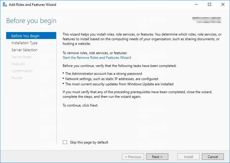

2.     On the page, select Manage > Add Roles and Features.
Figure 3 Add Roles and Features Wizard

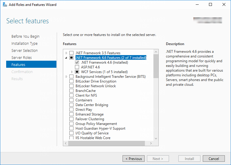

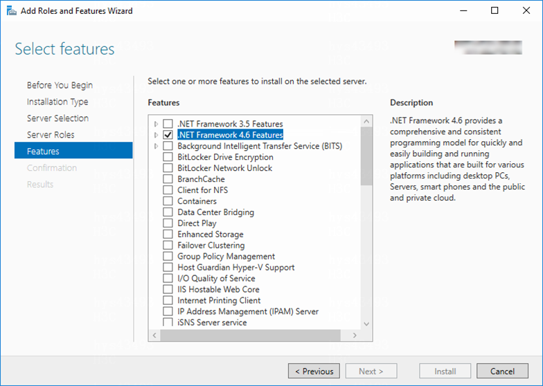

3.     In the Add Roles and Features wizard, click Next until the Features page appears, and select .NET Framework 4.6 Features.
Figure 4 Selecting .NET Framework 4.6 Features

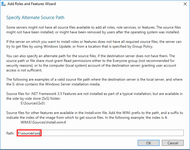

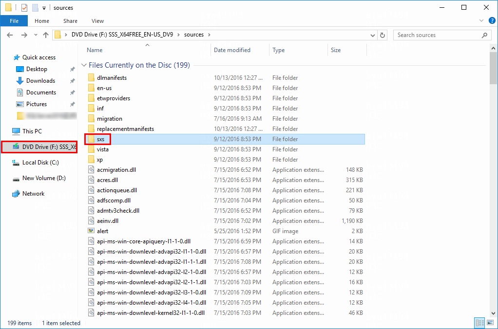

4.     Click Next, and select Specify an alternate source path on the Confirmation page. Enter the alternate source path on the page that opens.
The system sxs folder can be used as an alternate source path. If you do not specify an alternate source path, the installation might fail because source files fail to be found.
Figure 5 Copying the alternate source path
Figure 6 Pasting the alternate source path
5.     Click OK to return to the Confirmation page, and click Install.

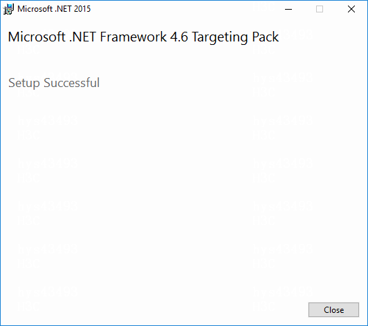

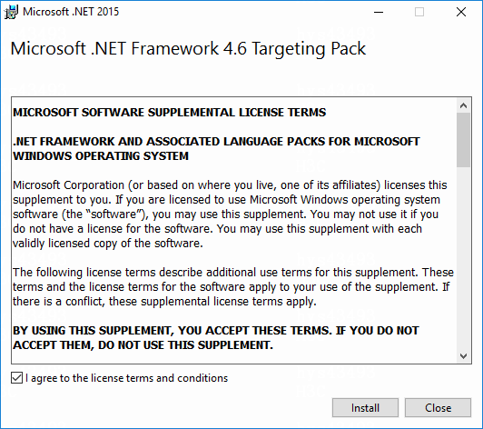

If .NET Framework 4.6 does not exist in the system, you can download it from the Microsoft website and install it directly.
Figure 8 Installing .NET Framework 4.6 directly
Figure 9 .NET Framework 4.6 installed successfully

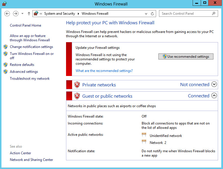

Turning off the Windows firewall

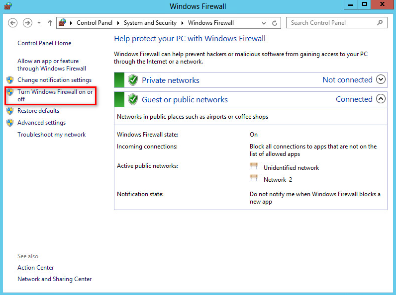

1.     ‍Select Start > Control Panel > System and Security > Windows Firewall.
The Windows Firewall page opens, as shown in Figure 10.
Figure 10 Windows Firewall page
fig7_windows_firewall

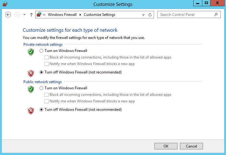

2.     Select Turn Windows Firewall on or off.
The Customize Settings page opens, as shown in Figure 11.
Figure 11 Customize Settings page
fig8_customize_settings
3.     Select Turn off Windows Firewall (not recommended) for both Private network settings and Public network settings, and then click OK.
The Windows Firewall page displays the firewall status.
Figure 12 Disabling Windows firewall
fig9_disabling_windows_firewall

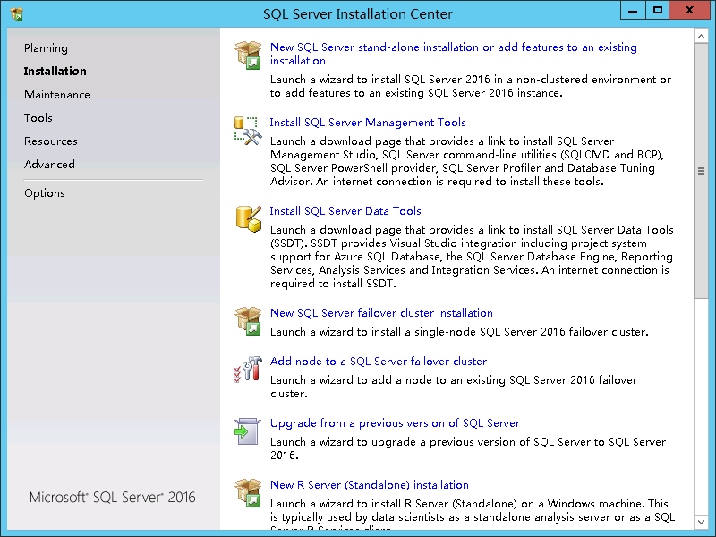

1.     ‍Run the installation program.
The SQL Server Installation Center wizard opens, as shown in Figure 13.
Figure 13 SQL Server Installation Center wizard
2.     Select Installation from the navigation tree, and then select New SQL Server stand-alone installation or add features to an existing installation.

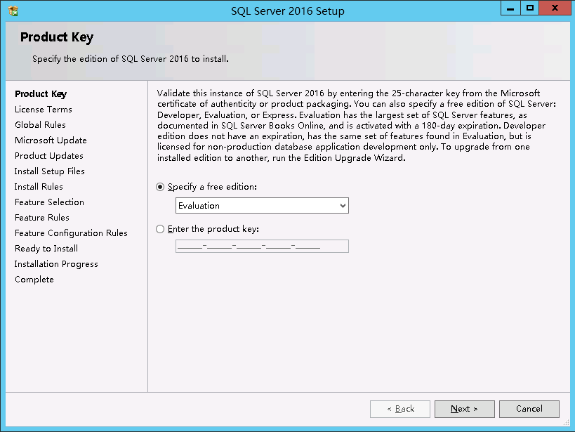

The Product Key page opens, as shown in Figure 14.
Figure 14 Product Key page
3.     Enter the product key and then click Next.

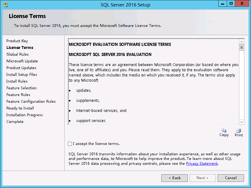

The License Terms page opens, as shown in Figure 15.
Figure 15 License Terms page
4.     Select I accept the license terms and click Next.

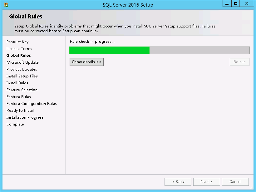

The Global Rules page opens, as shown in Figure 16.
Figure 16 Global Rules page

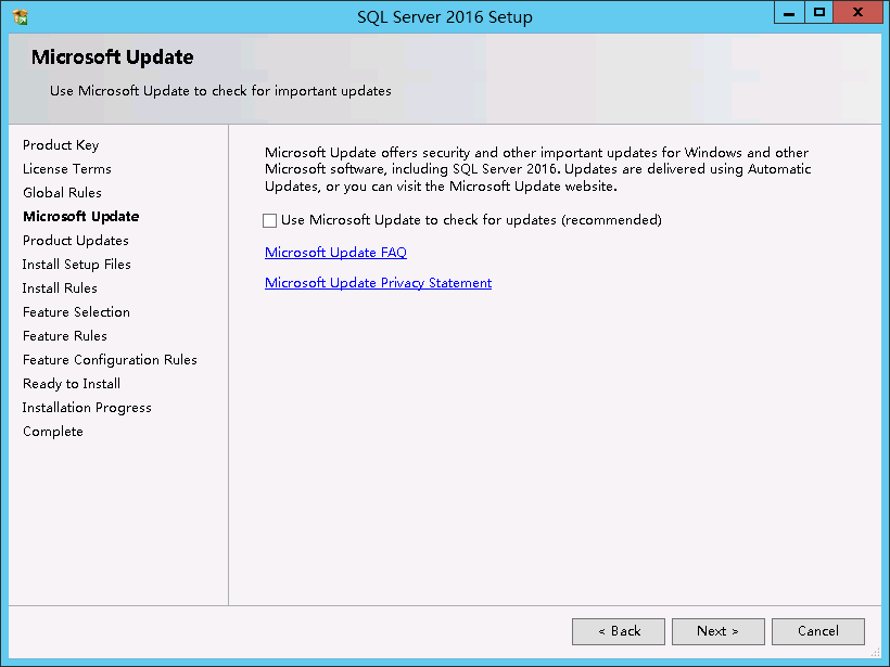

When the check has been passed, the Microsoft Update page opens, as shown in Figure 17.
Figure 17 Microsoft Update page
5.     Update Microsoft if necessary, and then click Next.

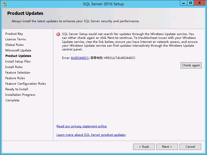

The Product Updates page opens, as shown in Figure 18.
Figure 18 Product Updates page
If the server is not connected to Internet, an error message will be displayed on the Product Updates page, as shown in Figure 19.
Figure 19 Product Updates page
6.     Click Next to continue the installation.

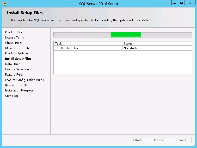

The Install Setup Files page opens, as shown in Figure 20.
Figure 20 Install Setup Files page
When the setup files are installed, the Installing Rules page opens,
7.     Click Next.

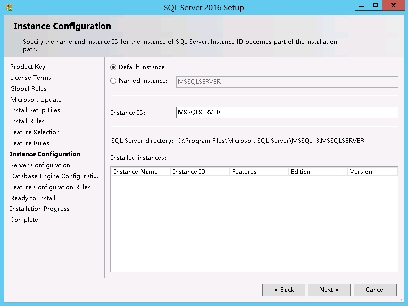

When the feature rules check is complete, the Instance Configuration page opens, as shown in Figure 23.
Figure 23 Instance Configuration page
10.     Install a default instance or a named instance of the SQL Server.
¡     To install the default instance, select Default instance and specify an instance ID. The default instance ID is MSSQLSERVER.
¡     To install a named instance, select Named Instance and specify an instance ID. You are required to provide the instance name during IMC installation.
In this example, select Default instance and use the default instance ID MSSQLSERVER.
11.     Click Next.

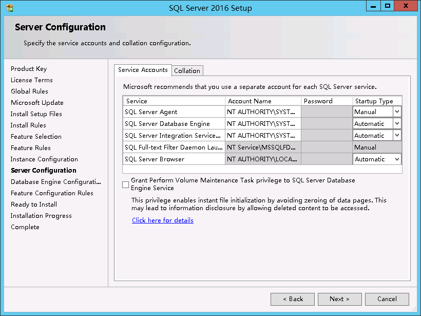

The Server Configuration page opens, as shown in Figure 24.
Figure 24 Server Configuration page

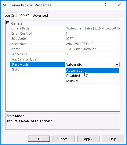

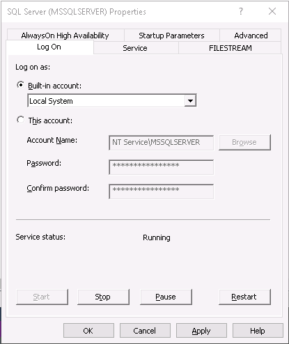

12.     Use the default settings on the Service Accounts tab.
If you selected Named instance for the SQL Server in Figure 23, set Startup Type for the SQL Server Browser service to Automatic.
13.     Click the Collation tab, as shown in Figure 25.
Figure 25 Collation tab
14.     Use the default collation settings or SQL_Latin1_General_CP1_CI_AS, and then click Next.

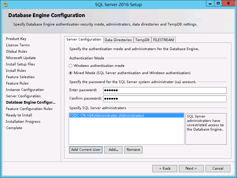

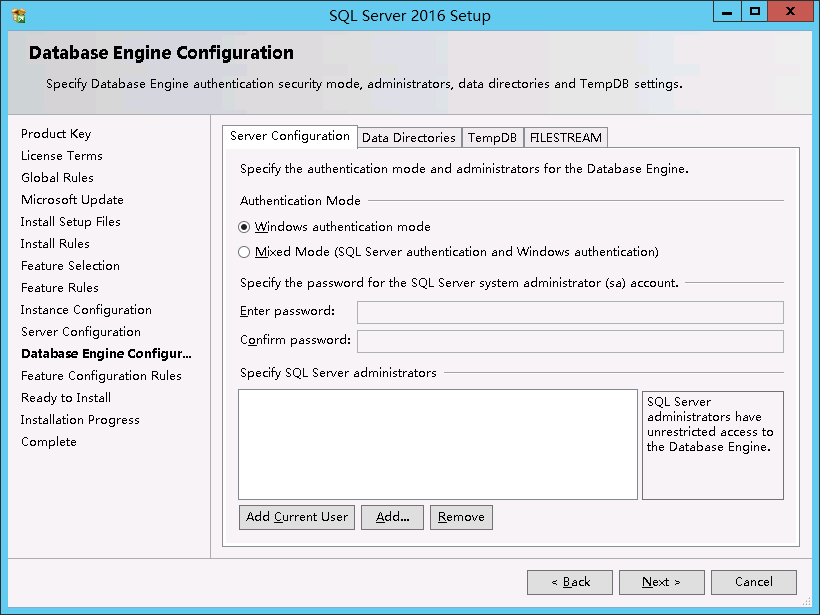

The Database Engine Configuration page opens, as shown in Figure 26.
Figure 26 Database Engine Configuration page
15.     Under Authentication Mode, select Mixed Mode, enter the password for user sa, and add a SQL Server administrator, as shown in Figure 27.
¡     SQL Server 2016 has password complexity requirements. For more information, see the SQL Server 2016 online help.
¡     For IMC to identify the sa logon password during installation, make sure the password does not contain any of the following characters:
-     Left angle bracket (<)
-     Right angle bracket (>)
-     Vertical bar (|)
-     Tab (\t)

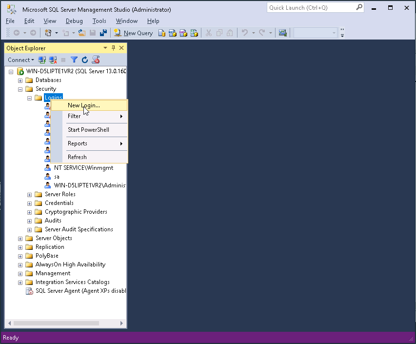

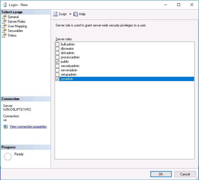

If the password of user sa must contain any of the previous characters, create a superuser with sa user privileges before the IMC installation. Make sure the password of the superuser does not contain any of the previous characters. For information about creating a database superuser, see "Creating a superuser."
Figure 27 Specifying SQL Server administrators

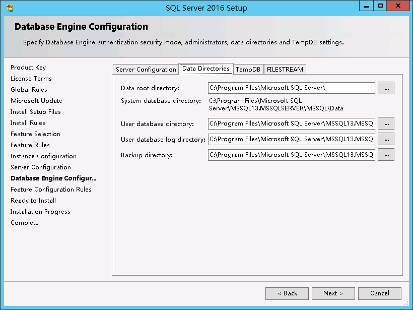

16.     Click the Data Directories tab, and set the data directories after negotiation with the SQL server administrator, as shown in Figure 28.
Figure 28 Data Directories tab

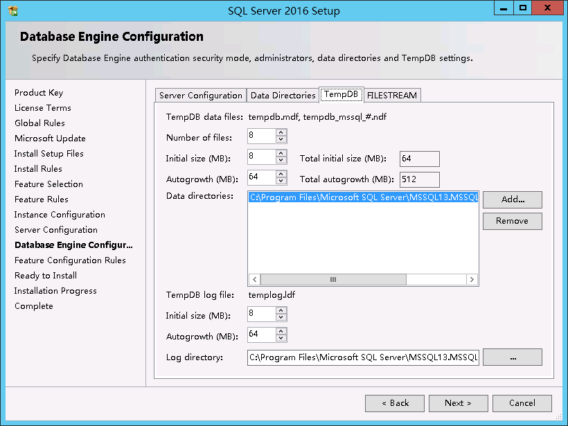

17.     Click the TempDB tab, and set the TempDB file after negotiation with the SQL server administrator, as shown in Figure 29.
Figure 29 TempDB tab

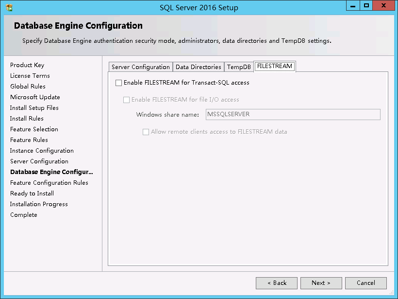

18.     Use the default settings on the FILESTREAM tab, as shown in Figure 30.
Figure 30 FILESTREAM tab

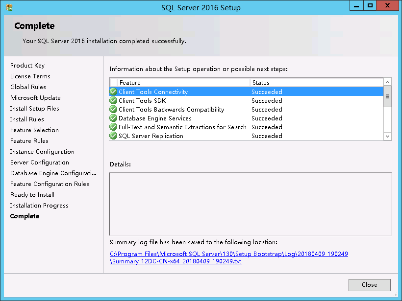

When the installation is complete, the Complete page opens, as shown in Figure 33.
Figure 33 Complete page

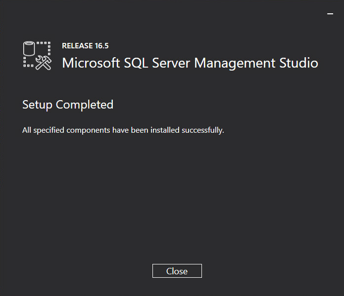

Installing SSMS
The SQL Server 2016 installation package does not provide the Microsoft SQL Server Management Studio (SSMS). Install SSMS after you finish installing SQL Server 2016. In this guide, SSMS 16.5 is installed.
Downloading SSMS
1.     ‍Click Install SQL Server Management Tools, as shown in Figure 34.
Figure 34 SQL Server Installation Center wizard
2.     Download the SMSS installation package.

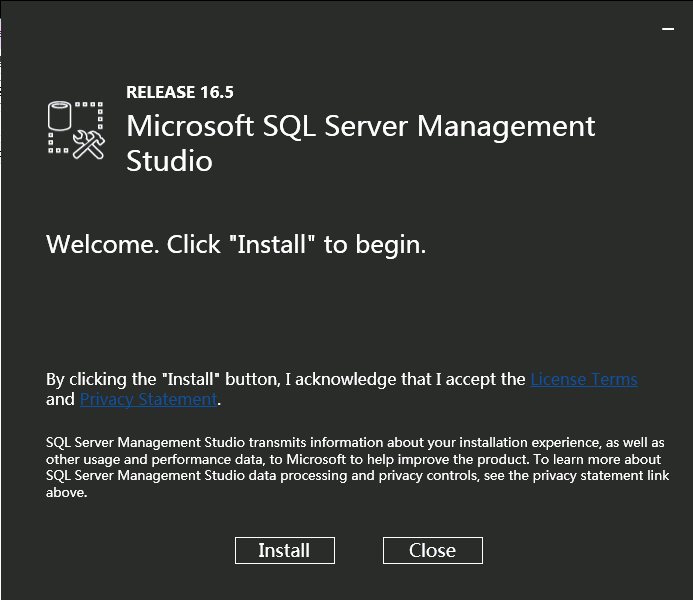

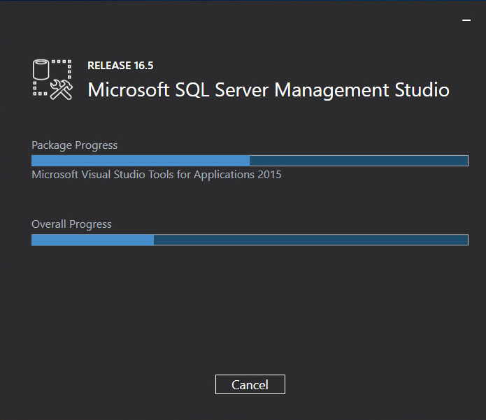

Installing SSMS
1.     ‍Double-click the SSMS installation package.
The installation dialog box opens, as shown in Figure 35.
Figure 35 Installation dialog box
2.     Click Install.
Figure 36 Installation progress
After the installation completes, the confirmation dialog box opens, as shown in Figure 37.
Figure 37 Confirmation dialog box
3.     Click Close.

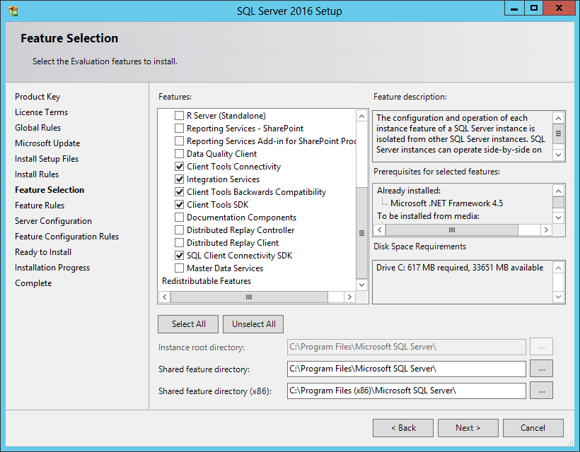

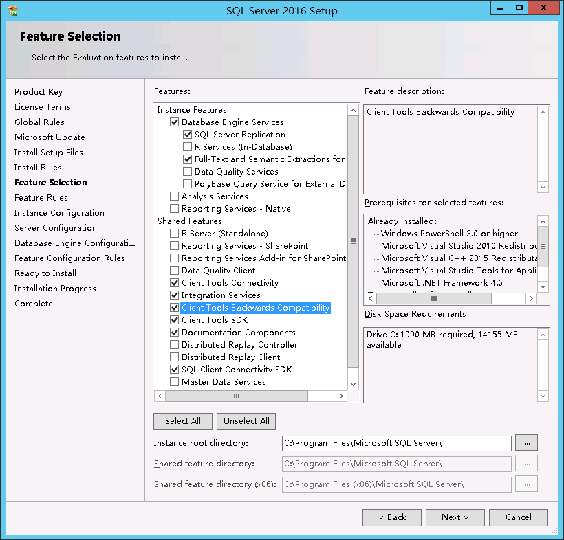

1.     ‍Run the SQL Server 2016 installation program.
2.     In the Feature Selection page, select the features as shown in Figure 40.
For information about accessing the Feature Selection page, see "Installing SQL Server ."
Figure 40 Feature Selection page

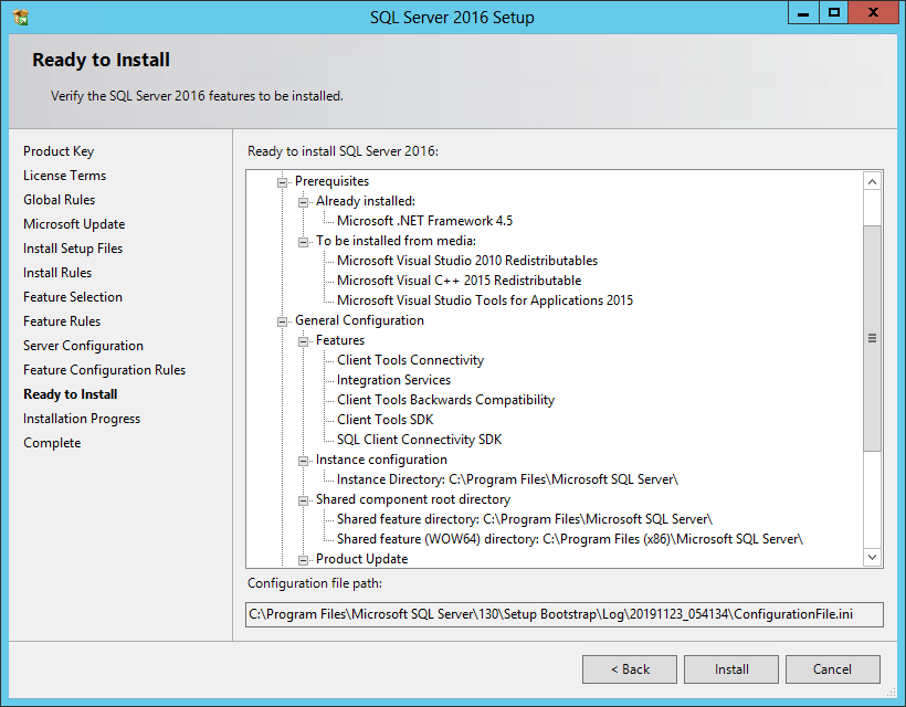

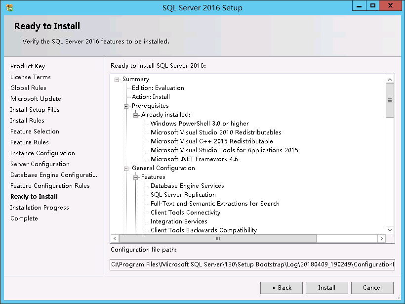

When the feature configuration rules check is complete, the Ready to Install page opens, as shown in Figure 41.
Figure 41 Ready to Install page

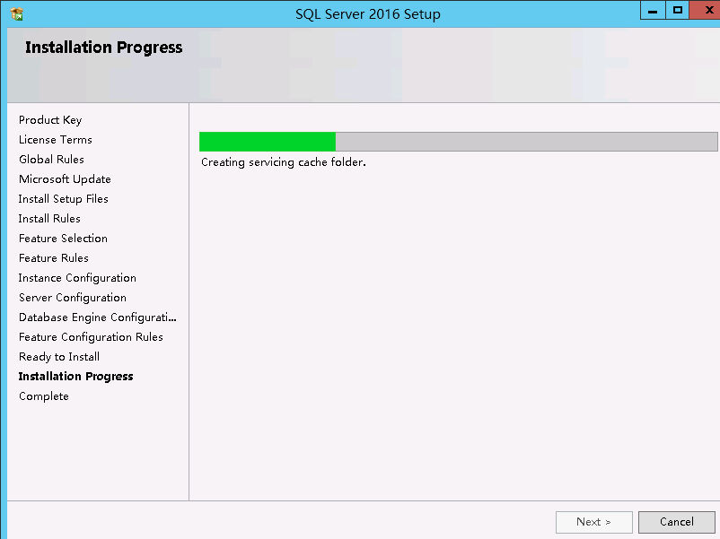

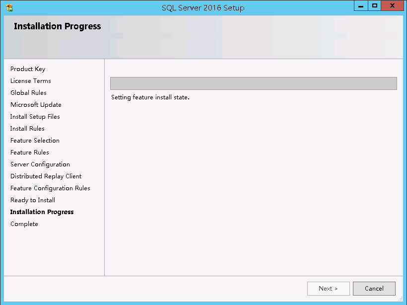

4.     Click Install.
The Installation Progress page opens, as shown in Figure 42.
Figure 42 Installation Progress page

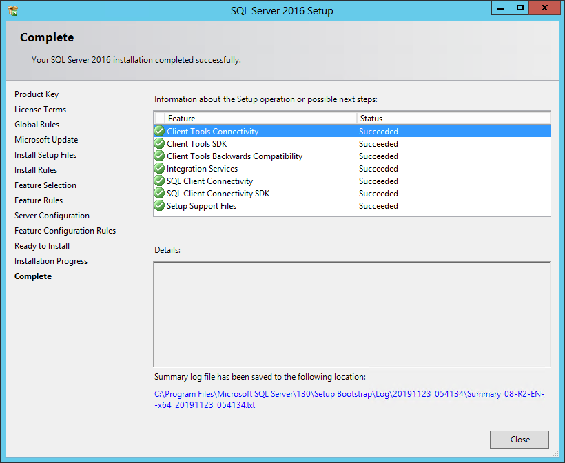

When the installation is complete, the Complete page opens, as shown in Figure 43.
Figure 43 Complete page
5.     Click Close.

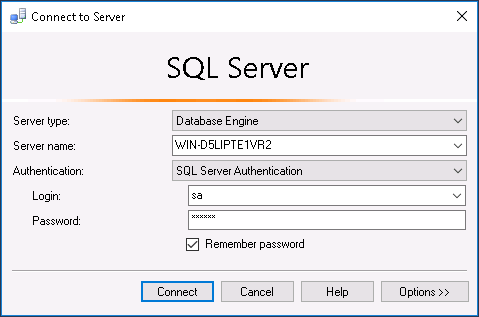

Testing connectivity
To test the connectivity between the client and the SQL Server database:
1.     ‍Select Run from the Start menu, and then enter cmd in the Run dialog box.
2.     In the CMD window, enter one of the following commands:
¡     For the default instance:
osql –S 192.168.7.194 –U sa –P iMC123
¡     For a named instance:
osql –S 192.168.7.194\instancename –U sa –P iMC123

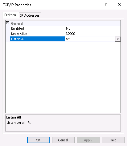

Configuring TCP/IP properties
1.     ‍Select Start > SQL Server 2016 Configuration Manager.
The SQL Server Configuration Manager opens.

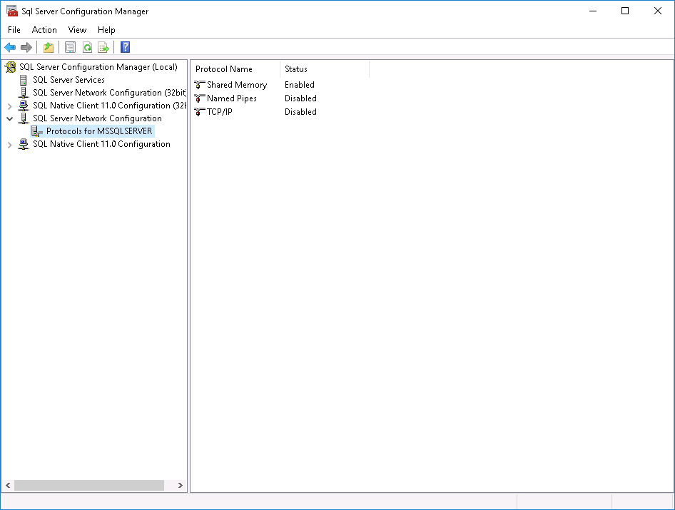

2.     From the navigation tree, select SQL Server Network Configuration > Protocols for MSSQLSERVER, as shown in Figure 44.
Figure 44 SQL Server Configuration Manager
3.     Right-click TCP/IP and select Properties from the shortcut menu.
The TCP/IP Properties dialog box opens, as shown in Figure 45.
Figure 45 TCP/IP Properties dialog box
4.     On the Protocol tab, make sure Yes is selected for Listen All.
5.     Click the IP Addresses tab, select Yes for the Enabled option of each IP address, and set TCP Port to 1433, as shown in Figure 46.
Figure 46 IP Addresses tab

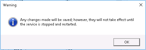

6.     Click OK.
The system displays a message that indicates the database service must be restarted to validate the configuration, as shown in Figure 47.
Figure 47 Prompt message
7.     Click OK.
8.     Restart the SQL Server service. For more information, see "Restarting the SQL Server service."
·     When Yes is selected for Listen All on the Protocol tab, the SQL Server automatically updates IP address settings after an IP address is changed. If you selected No, you must manually update the IP addresses.
·     You can enable the Named Pipes property in the same way.

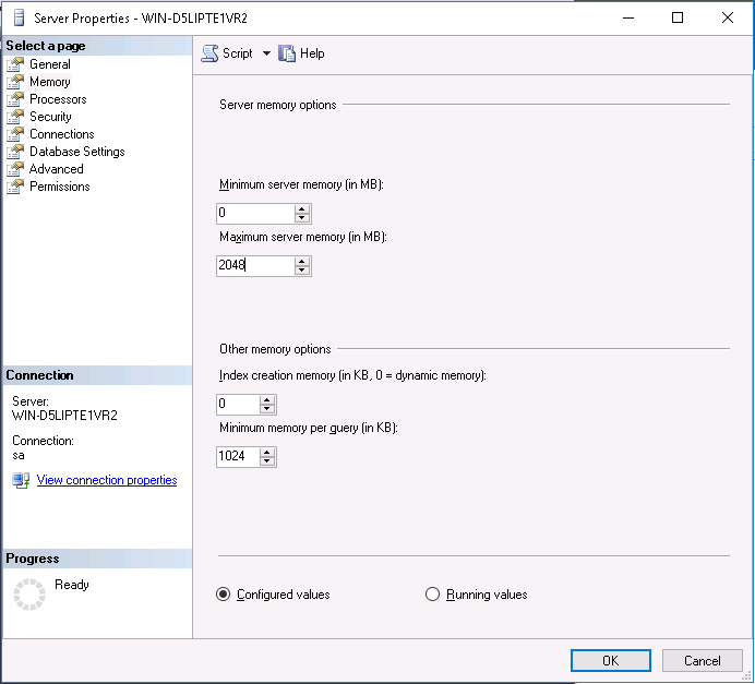

Modifying the maximum server memory for the SQL Server
To ensure the optimum performance, the SQL Server is preemptive and uses a default maximum server memory of 2147483647 MB. When IMC and the SQL Server are installed on the same server, you must reduce the maximum server memory for the SQL Server. As a best practice, set the maximum server memory to half the server's physical memory.
To modify the maximum server memory for the SQL Server:
1.     ‍Select Start > SQL Server 2016 Management Studio.
2.     In the Connect to Server dialog box, configure the following parameters, as shown in Figure 48:
a.     ‍Select SQL Server Authentication for the Authentication field.
b.     Enter sa in the Login field.
c.     Enter the password in the Password field.
Figure 48 Database login dialog box
3.     Click Connect.

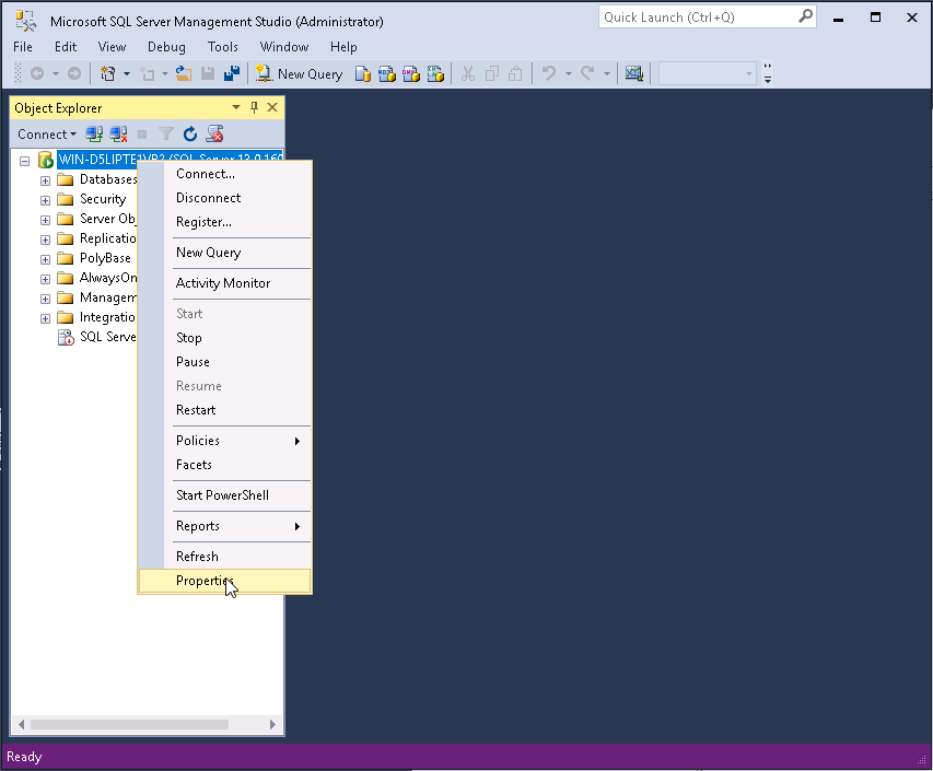

4.     Right-click the server name and select Properties from the shortcut menu.
The Server Properties page opens, as shown in Figure 49.
Figure 49 Server Properties page
5.     Select Memory in the navigation tree, set the maximum server memory to half the server's physical memory, and click OK. This example uses 2048 MB.
Figure 50 Setting memory options for the SQL Server
6.     Restart the operating system to validate the modification.
Starting the SQL Server Browser service
To enable IMC to connect to a named instance of SQL Server 2016, you must start the SQL Server Browser service after the SQL Server installation is complete.
If you set Startup Type for the SQL Server Browser service to Automatic during the SQL Server installation process, you do not need to start the SQL Server Browser service after the installation is complete.
To start the SQL Server Browser service:

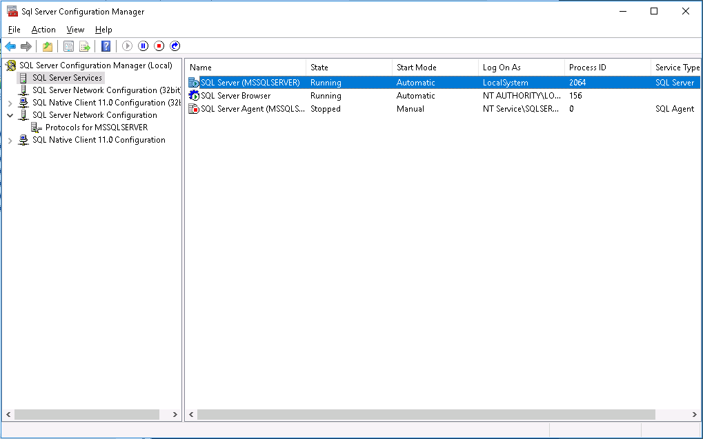

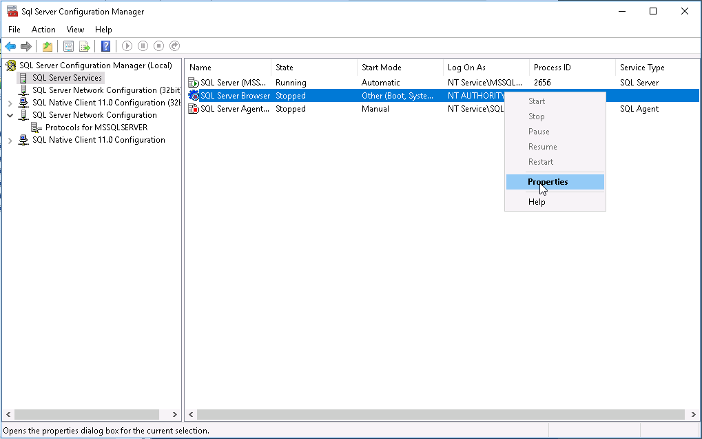

2.     Select SQL Server Services from the navigation tree, right-click SQL Server Browser on the main pane, and then select Properties from the shortcut menu.
Figure 51 Launching the SQL Server Browser Properties dialog box
3.     Click the Service tab and then select Automatic for Start Mode.
Figure 52 Setting the service start mode to Automatic
4.     Click OK.
The dialog box closes.
5.     Right-click SQL Server Browser, and then select Start from the shortcut menu.
Figure 53 Starting the SQL Server Browser service
Changing the SQL Server service startup account
When you specify a superuser for IMC to use a remote SQL Server database, that user must have write permissions to all the disks on the database server. To ensure these user capabilities, you must configure the SQL Server service to start up using the built-in local system account.
To configure the SQL Server service to start up using the built-in local system account:
1.     ‍Select Start > All Programs > Microsoft SQL Server 2016 > Configuration Tools > SQL Server Configuration Manager.
2.     From the navigation tree, select SQL Server Services.
The main pane displays the services installed by SQL Server.
3.     Right-click SQL Server (MSSQLSERVER), and then select Properties from the shortcut menu.
4.     Click the Log On tab.
Figure 54 Log On tab
5.     Make sure Local System is selected for the Built-in account list.
6.     Click OK.
7.     Restart the SQL Server service to validate the configuration.

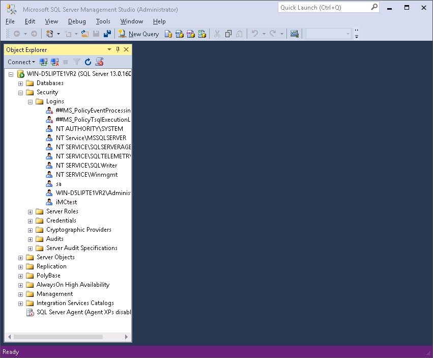

The SQL Server database has a default superuser named sa. To specify another user for database access during IMC installation, first create a login user and grant administrator privilege to the user on the SQL Server.
To create a superuser:
The database login dialog box opens, as shown in Figure 56.
Figure 56 Login dialog box
2.     Select SQL Server Authentication for Authentication, select a login username, enter the password, and then click Connect.
The Microsoft SQL Server Management Studio page opens, as shown in Figure 57.
Figure 57 Microsoft SQL Server Management Studio page

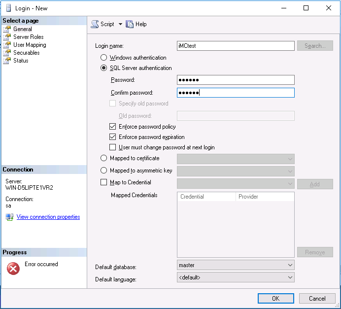

3.     Expand the Security node in the navigation tree, right-click Logins, and select New Login from the shortcut menu.
The Login - New page opens, as shown in Figure 58.
Figure 58 Adding a login user
4.     On the General page, enter the login name, click SQL Server authentication, enter the password, and then clear User must change password at next login. This example uses iMCtest as the login name.
For IMC to correctly identify the password, make sure the password does not contain any of the following characters:
¡     Left angle racket (<)
¡     Right angle bracket (>)
¡     Vertical bar (|)
¡     Tab (\t)
5.     From the navigation tree, select Server Roles.
Figure 59 Setting server roles
6.     Select public and sysadmin and click OK.
The user is granted database administrator privileges and is displayed under the Security > Logins node in the navigation tree of Microsoft SQL Server Management Studio, as shown in Figure 60.
Figure 60 Viewing the new user

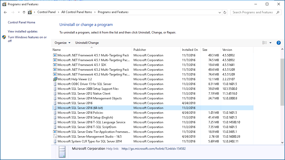

1.     ‍Select Start > Control Panel > Uninstall or Change a program > Uninstall/Change.
2.     Select Microsoft SQL Server 2016 (64-bit), and then click Uninstall.
3.     Follow the same procedure to uninstall other programs shown in Figure 61.
Figure 61 Uninstalling SQL Server 2016

During IMC installation, the following message is displayed: "Failed to run bcp.exe, Database tools not installed or Windows not restarted" after MS SQL Server installed. How do I resolve the issue?
IMC requires using the bcp.exe tool to access a remote database server. Choose one of the following methods to resolve the issue:
·     Method 1: Install the client tool on the SQL Server client, as shown in Figure 64. Restart Windows for the client software bcp.exe to take effect after the installation.
Figure 64 Feature Selection page
·     Method 2: Install ODBC driver and MS SQL Cmd Utility on the SQL Server client, as shown in Figure 65.
Figure 65 Downloading ODBC driver and MS SQL Cmd Utility
