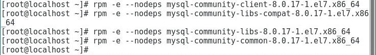

Removing the built-in MariaDB
Before you install the MySQL 8.0 database, you must remove the built-in MariaDB built in Red Hat Enterprise Linux 8.3.
1.     ‍Query the installed MariaDB and related programs.
rpm –qa | grep mariadb
2.     Remove the software packages.
rpm –e software package name
3.     Remove the components depended on MariaDB if a message about the components dependent on MariaDB is displayed.
rpm –e --nodeps software package name

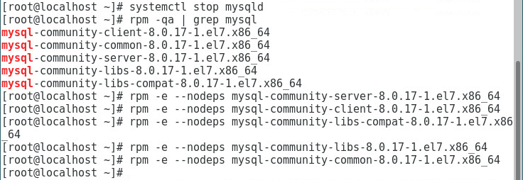

4.     Query the installed MySQL database and related programs.
rpm –qa | grep mysql
rpm –qa | grep MySQL
5.     Remove the software package.
rpm –e ––nodeps software package name

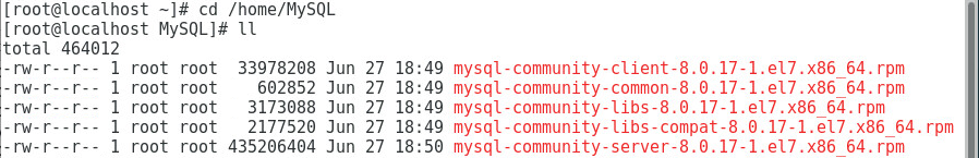

Copying the installation programs to the Linux server
Before installing the MySQL database, copy the installation programs to the Linux server.
This document uses the installation programs mysql-community-server-8.0.17-1.el7.x86_64.rpm and mysql-community-client-8.0.17-1.el7.x86_64.rpm, as shown in Figure 1.
Figure 1 MySQL installation programs on Linux

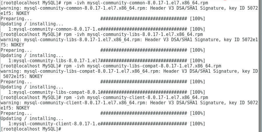

Installing the MySQL client
The MySQL client provides tools for MySQL management and user interaction, for example, mysqladmin and mysql. You must install the MySQL client on the IMC server to communicate with the MySQL server (locally or remotely).
Go to the directory where the MySQL installation programs are located and install the MySQL client, as shown in Figure 2.
rpm –ivh mysql-community-common-8.0.17-1.el7.x86_64.rpm,
rpm –ivh mysql-community-libs-8.0.17-1.el7.x86_64.rpm,
rpm –ivh mysql-community-libs-compat-8.0.17-1.el7.x86_64.rpm,
rpm –ivh mysql-community-client-8.0.17-1.el7.x86_64.rpm,
Figure 2 Installing the MySQL client

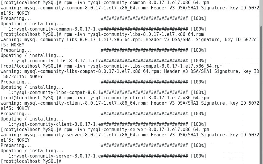

Installing the MySQL server
1.     ‍Go to the directory where the MySQL installation programs are located, and install the MySQL server, as shown in Figure 3.
rpm -ivh mysql-community-common-8.0.17-1.el7.x86_64.rpm,
rpm -ivh mysql-community-client-8.0.17-1.el7.x86_64.rpm,
rpm -ivh mysql-community-server-8.0.17-1.el7.x86_64.rpm,
Figure 3 Installing the MySQL server

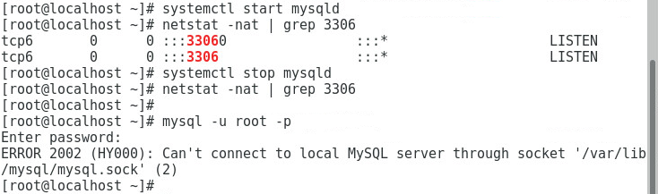

2.     Start the MySQL service after the installation is complete.
systemctl start mysqld
3.     Verify that the MySQL service has started (3306 is the default port).
netstat –nat | grep 3306
Figure 4 shows that the MySQL service has started.

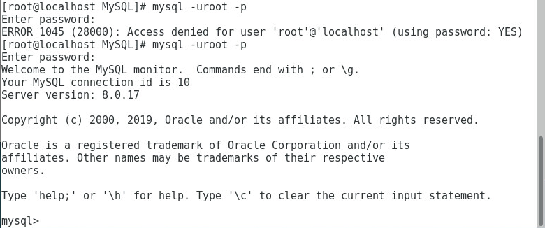

The MySQL server is installed on the IMC server. Run the following command and enter the root user password at the prompt Enter password:
mysql –u root –p
The root user password is randomly generated during the MySQL server installation. To view the password, see "Changing the MySQL password."
If the MySQL command line interface is displayed, the MySQL client was installed successfully, as shown in Figure 5.

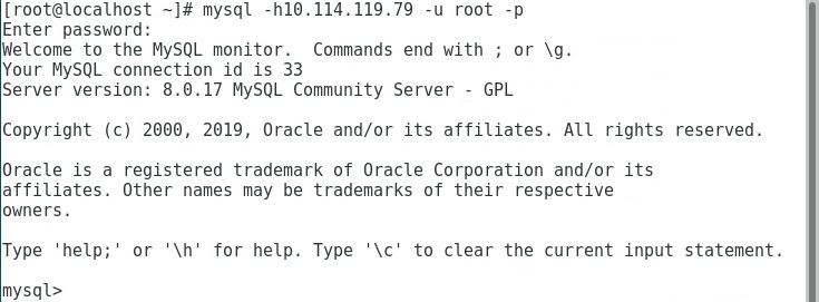

IMC with a remote database
The IMC server is installed with the MySQL client only. Run the following command and enter the new root user password at the prompt Enter password:
mysql -h 10.114.119.79 –u root -p
Before verifying the MySQL client installation, make sure a remote root user account has been created on the MySQL server. For information about how to create a remote root user account, see "Creating a remote root user account."
Figure 6 Verifying the connection between the MySQL client and server
In the output, 10.114.119.79 is the IP address of the MySQL server, and root is the remote root user account. The root user password is randomly generated during the MySQL server installation. To view the password, see "Changing the MySQL password."
The prompt mysql indicates that the client has connected successfully to the MySQL server.

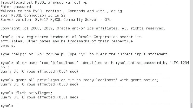

The MySQL server randomly generates a temporary password for the root user during the installation and stores the password in the /var/log//mysqld.log file. At the first startup of the MySQL service, you must modify the password. Otherwise, the MySQL service cannot run correctly.
To modify the password:
1.     ‍Query the temporary password in the log file, as shown in Figure 7.
sudo grep 'temporary password' /var/log/mysqld.log
Figure 7 Opening the log file
2.     Log in to the database with the temporary password.
mysql –u root –p
3.     Enter the temporary password at the prompt Enter password.
The prompt mysql is displayed, as shown in Figure 8.
Figure 8 Entering the MySQL command line interface

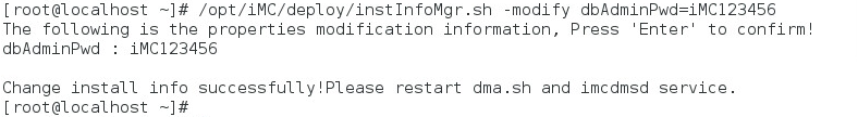

4.     Change the root user password. This example uses iMC_123456 as the new password.
alter user 'root'@'localhost' identified with mysql_native_password by 'iMC_123456';
For the password to be recognized during IMC installation, make sure the password of the root user does not include spaces, tabs (\t), or any characters in Figure 9Table 1.
According to the default password policy in MySQL 8.0, the root password must contain a minimum of eight characters that include uppercase and lowercase letters, digits, and special characters.
Figure 9 shows that the password has been changed successfully.
Figure 9 Changing the root user password

Starting and stopping the MySQL service
MySQL is configured automatically as the system service after the MySQL server is installed.
You can start or stop the MySQL service as a common system service.
systemctl stop mysqld

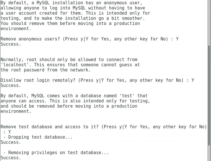

Setting security options

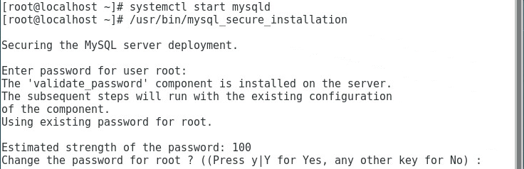

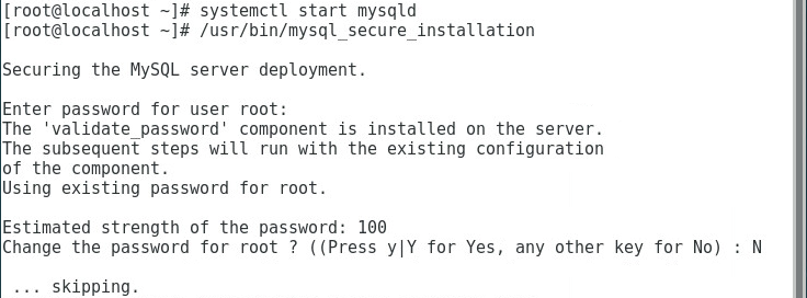

1.     ‍Run the mysql_secure_installation program.
/usr/bin/mysql_secure_installation
2.     Enter the root user password to set security options, such as setting a root user password, removing anonymous users, and removing a test database, as shown in Figure 11.
Figure 11 Setting the root user password
3.     Enter N when the system asks you to change the root password, as shown in Figure 12.
Figure 12 Choosing not to change the root user password
4.     Remove anonymous users and the database named test, as shown in Figure 13.
If you want to use IMC with a local database, you must disable remote root login.
Figure 13 Configuring anonymous users, remote access, and the test database

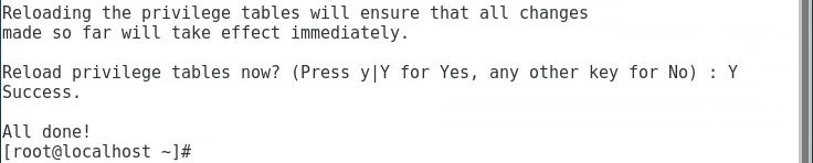

6.     Reload the privilege tables to make the changes take effect, as shown in Figure 14.
Figure 14 Reloading the privilege tables

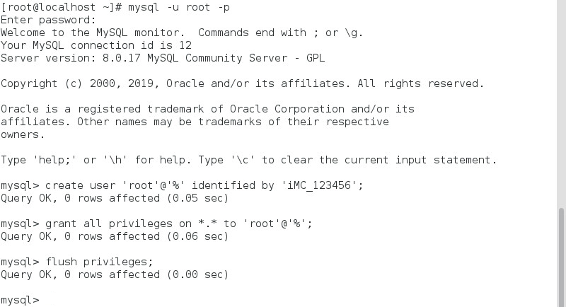

By default, the MySQL server has only one local root user account. If you want to use IMC with a remote database, install MySQL client and configure a remote root user account on the database server.
To create a remote root user account:
1.     ‍Log in to MySQL.
mysql –u root –p
2.     Enter the new MySQL password.
3.     Alter database users.
create user 'root'@'%' identified by 'iMC_123456';  //iMC_123456 is the password of remote user root. Please set the password as needed.
alter user 'root'@'%' identified with mysql_native_password by 'iMC_123456';
4.     Create a remote root user account.
grant all privileges on *.* to root@'%' with grant option;
5.     Refresh privileges.
flush privileges;
Figure 15 Creating a remote root user account

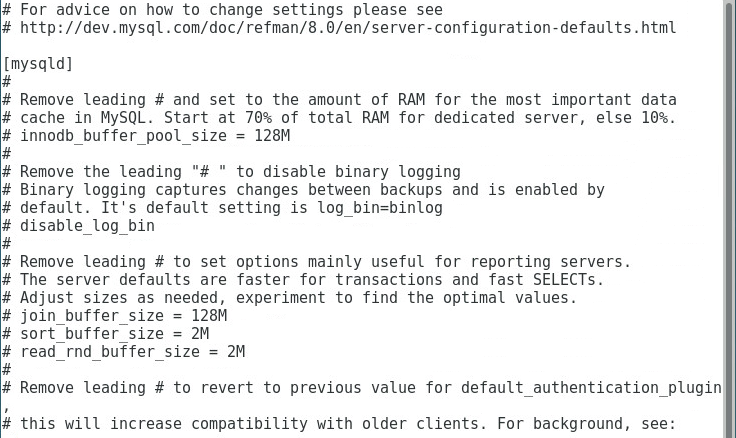

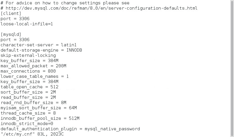

Configuring parameters in the my.cnf file
The default configuration file /etc/my.cnf determines the performance and behavior of the MySQL server and defines the path for saving MySQL files. Before you configure the my.cnf file, stop the MySQL service. Restart the MySQL service after you finish the file configuration.
To configure parameters in the my.cnf file:
1.     ‍Stop the MySQL service and open the my.cnf file, as shown in Figure 16.
Figure 16 Opening the my.cnf file
2.     Enter i to enter edit mode, as shown in Figure 17.
Figure 17 Entering edit mode
3.     Add parameters under [mysqld], as shown in Figure 18. Figure 18Table 2 describes the parameters that you can configure in the my.cnf file.
IMPORTANT
IMPORTANT:
For regions that use different daylight hours between summer and winter, set the default time zone according to the actual time zone. For specific time zone settings, access the website https://dev.mysql.com/doc/refman/8.0/en/time-zone-support.html.
[client]
port= 3306
loose-local-infile=1
[mysqld]
port= 3306
character-set-server = latin1
default-storage-engine = INNODB
skip-external-locking
key_buffer_size = 384M
max_allowed_packet = 200M
max_connections = 800
lower_case_table_names = 1
table_open_cache = 512
sort_buffer_size = 2M
read_buffer_size = 2M
read_rnd_buffer_size = 8M
myisam_sort_buffer_size = 64M
thread_cache_size = 8
innodb_buffer_pool_size = 512M
innodb_strict_mode = 0
default_authentication_plugin = mysql_native_password
default-time-zone = '+8:00'
local_infile=1
[mysqldump]
quick
[mysql]
no-auto-rehash
default_character_set=latin1
local_infile=1
[myisamchk]
key_buffer_size = 128M
sort_buffer_size = 128M
read_buffer = 2M
write_buffer = 2M
[mysqlhotcopy]
interactive-timeout
Figure 18 Adding parameters under [mysqld]
Character set required by the MySQL database. The character set for English is latin1.
MySQL database engine types:
·     MyISAM
·     InnoDB
·     MEMORY
·     MERGE
Size of the InnoDB buffer pool.
innodb_strict_mode
Mode that affects the handling of syntax errors for CREATE TABLE, ALTER TABLE and CREATE INDEX statements:
·     0—InnoDB ignores conflicting clauses and creates the table or index, with only a warning in the message log.
·     1—InnoDB returns errors rather than warnings for certain conditions.
Indicates whether a table name is case sensitive.
·     0—Yes
·     1—No
max_allowed_packet
Maximum allowed size for a packet.
default-time-zone
Sets the default server time zone. Named time zones can be used only if the time zone information tables in the MySQL database have been created and populated, for example, Europe/Helsinki.
local_infile
Whether to allow using the load data local infile command for data import and export.
·     0—Disallowed
·     1—Allowed
transaction_isolation
Transaction isolation level.
Check whether the transaction_isolation parameter exists under [mysqld] when installing EIA:
·     If that parameter does not exist, add transaction_isolation=READ-COMMITTED under [mysqld].
·     If that parameter exists, change the value to READ-COMMITTED.

Uninstallation
1.     ‍Stop the MySQL service.
2.     Uninstall the MySQL database, as shown in Figure 20.
rpm -qa | grep mysql
rpm –e –-nodeps mysql-community -server-8.0.17-1.el7.x86_64
rpm –e –-nodeps mysql-community -client-8.0.17-1.el7.x86_64
rpm –e –-nodeps mysql-community -libs-8.0.17-1.el7.x86_64
rpm –e –-nodeps mysql-community-libs-compat-8.0.17-1.el7.x86_64.rpm
rpm –e –-nodeps mysql-community -common-8.0.17-1.el7.x86_64
You can use the following command to query the component name:
Figure 20 Uninstalling the MySQL database
3.     Manually remove the database files in the default directory /var/lib/mysql after uninstallation.
rm -rf /var/lib/mysql
After the directory is removed, the MySQL database is removed successfully.
Uninstall the MySQL database, as shown in Figure 21.
Figure 21 Uninstalling the MySQL database

How do I update the database password for the IMC server?
If the password of the account that IMC uses to connect to a database is changed, the IMC server will fail to connect to the database. To resolve this problem, modify the database user password saved in IMC:
1.     ‍Execute the /opt/iMC/deploy/instInfoMgr.sh –modify dbAdminPwd=yourpassword command to modify the database password on the IMC server. For example, change the password to iMC123456, as shown in Figure 22.
Figure 22 Changing the database password on the IMC server
2.     Click the Environment tab in the Intelligent Deployment Monitoring Agent window, and then click Refresh in the Database Space Usage area.
