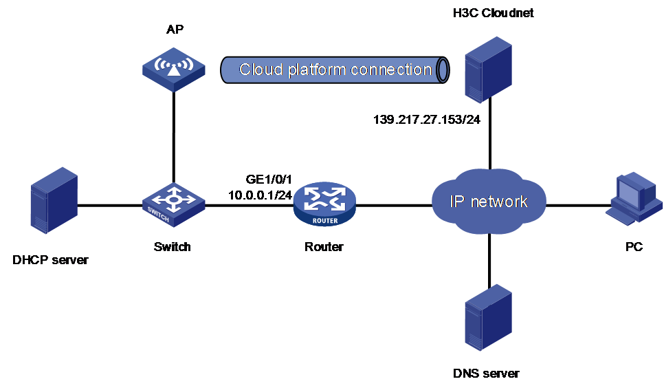

Switching the operating mode from the Cloudnet platform
This method enables you switch the operating mode for an AP only from fit to cloud.
Both APs operating in cloud mode and fit mode can come online from the Cloudnet platform. You can manage APs operating in cloud mode from the Cloudnet platform. You cannot manage fit APs from the Cloudnet platform, but you can switch the operating mode and upgrade the software for an AP operating in fit mode from the Cloudnet platform.
·     The AP will search for an AC and Cloudnet platform after startup. The AP can come online from the Cloudnet platform it has not registered to an AC. If it has registered to an AC, it will come online from the AC. Make sure the AP is not registered to an AC.
·     Register the AP to the Cloudnet platform by its model and serial number.
·     Connect the AP to the network and enable it to obtain an IP address through DHCP. Make sure the obtained IP address and public network are reachable to each other.
·     Make sure the DNS server can translate the Cloudnet server address correctly.
Figure 1 Network diagram
