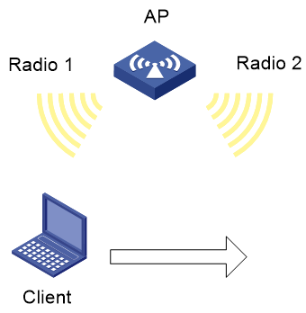

As shown in Figure 1, the client roams from radio 1 to radio 2 as follows:
1.     The client comes online from radio 1, and the AP creates a roaming entry for the client.
The entry records the initial SSID at association, PMKID, authentication method, security mode, and roaming VLAN.
2.     The client roams to radio 2. The AP examines the roaming entry for the client.
3.     The client performs reauthentication and then comes online from radio 2.
Figure 1 WLAN roaming mechanism

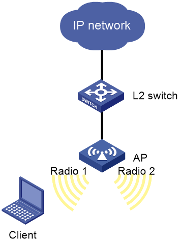

Example: Configuring intra-AP roaming
As shown in Figure 2, configure intra-AP roaming to enable the client to roam from radio 1 to radio 2.
Figure 2 Network diagram

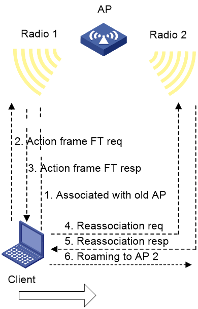

As shown in Figure 3, 802.1X fast roaming operates as follows:
1.     The client comes online from radio 1 after passing RSN+802.1X authentication. The AP creates a roaming entry for the client.
For more information about 802.1X authentication, see User Access and Authentication Configuration Guide.
2.     The client roams to radio 2. The AP examines the roaming entry for the client and triggers 802.1X fast forwarding if the client carries the same PMKID as the AP.
The system uses the cached PMK to perform key negotiation and the client can associate with radio 2 without reauthentication.
The system supports using the following methods to cache PMKID:
·     Sticky Key Caching (SKC)—Directly caches the PMKIDs generated during 802.1X authentication of clients.
·     Opportunistic Key Caching (OKC)—Uses the currently associated BSSID, client MAC address, and cached PMK to generate a PMKID.
Both methods support 802.1X fast roaming without manual intervention.
Figure 3 802.1X fast roaming

Over-the-air intra-AP FT
As shown in Figure 4, the client is associated with radio 1. Intra-AP roaming through over-the-air FT uses the following process:
1.     The client sends an FT authentication request to radio 2.
2.     Radio 2 sends an FT authentication response to the client.
3.     The client sends a reassociation request to radio 2.
4.     Radio 2 sends a reassociation response to the client.
5.     The client roams to radio 2.
Figure 4 Over-the-air intra-AP FT

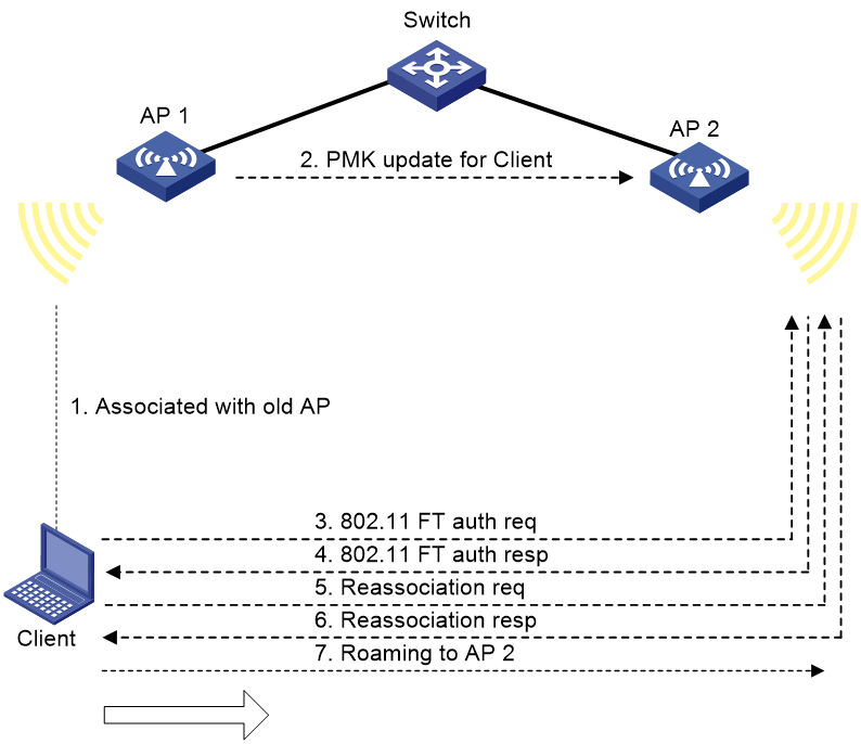

Over-the-air inter-AP FT
As shown in Figure 5, the client is associated with AP 1. Inter-AP roaming through over-the-air FT uses the following process:
1.     The client sends an FT authentication request to AP 2.
2.     AP 2 sends an FT authentication response to the client.
3.     The client sends a reassociation request to AP 2.
4.     AP 2 sends a reassociation response to the client.
5.     The client roams to AP 2.
Figure 5 Over-the-air inter-AP FT

Example: Configuring over-the-DS FT (802.1X authentication)
As shown in Figure 7, configure intra-AP roaming through over-the-DS FT to enable the client to roam between radio 1 and radio 2. Configure 802.1X as the authentication and key management mode.

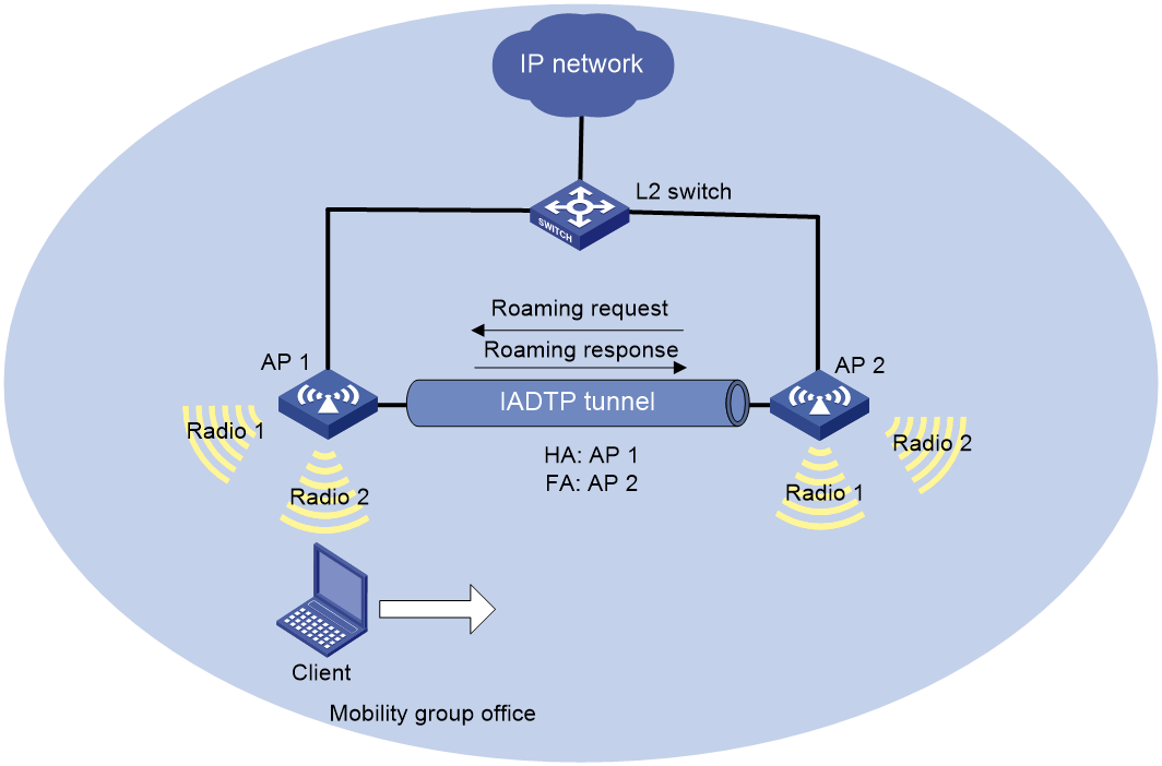

Mobility group mechanism
A mobility group enables clients to roam among different APs. These APs must be in the same mobility group and have established an IADTP tunnel with each other.
Figure 8 Mobility group mechanism
As shown in Figure 8, inter-AP roaming uses the following procedure:
1.     The client comes online from AP 1. AP 1 creates a roaming entry for the client and sends the information to AP 2 through the IADTP tunnel.
2.     The client roams to AP 2. AP 2 examines the roaming entry for the client and determines whether to perform fast roaming.
If the client uses RSN + 802.1X authentication and carries the same PMKID as the AP, fast roaming is used, and the client can associate with AP 2 without reauthentication If it is not, the client must be reauthenticated before associating with AP 2.
3.     The client associates with AP 2. AP 2 sends a roaming request to AP 1.
4.     AP 1 verifies the roaming request and performs either of the following operations:
¡     Sends a roaming response that indicates roaming failure to AP 2 if the request is invalid. AP 2 logs off the client.
¡     Saves the roaming trace and roam-out information and sends a roaming response that indicates roaming success to AP 2 if the request is valid. AP 2 saves roaming-in information for the client.
IADTP tunnel establishment
A device in a mobility group can act as a client to initiate connection requests or act as a server to listen for and respond to the connection requests.
Figure 9 Establishing an IADTP tunnel
As shown in Figure 9, two devices establish an IADTP tunnel by using the following procedure:
1.     Device A sends a join request to Device B.
2.     Upon receiving the join request, Device B uses the local configuration and packet content to identify whether Device A is in the same mobility group.
¡     If they are in the same mobility group, Device B returns a join response with a result code representing success.
¡     If they are in different mobility groups, Device B returns a join response with a result code representing failure.
3.     Upon receiving the join response, Device A examines the result code in the response.
¡     If the result code represents failure, Device A does not return any packets.

Example: Configuring inter-AP roaming
As shown in Figure 10, configure inter-AP roaming to enable the client to roam from AP 1 to AP 2.
Figure 10 Network diagram
1.     Configure AP 1:
# Create a service template named service1, set the SSID to trade-off, and enable the service template.
<AP1> system-view
[AP1] wlan service-template service1
[AP1-wlan-st-service1] ssid trade-off
[AP1-wlan-st-service1] service-template enable
[AP1-wlan-st-service1] quit
# Bind the service template to interface WLAN-Radio 1/0/1.
[AP1] interface wlan-radio 1/0/1
[AP1-WLAN-Radio1/0/1] undo shutdown
[AP1-WLAN-Radio1/0/1] service-template service1
[AP1-WLAN-Radio1/0/1] quit
# Bind the service template to interface WLAN-Radio 1/0/2.
[AP1] interface wlan-radio 1/0/2
[AP1-WLAN-Radio1/0/2] undo shutdown
[AP1-WLAN-Radio1/0/2] service-template service1
[AP1-WLAN-Radio1/0/2] quit
# Create a mobility group named office.
[AP1] wlan mobility group office
# Specify the IP address type for IADTP tunnels as IPv4.
[AP1-wlan-mg-office] tunnel-type ipv4
# Specify the source IP address for establishing IADTP tunnels as 10.1.4.22.
[AP1-wlan-mg-office] source ip 10.1.4.22
# Add AP 2 to the mobility group.
[AP1-wlan-mg-office] member ip 10.1.4.23
# Enable the mobility group.
[AP1-wlan-mg-office] group enable
[AP1-wlan-mg-office] quit
2.     Configure AP 2:
# Create a service template named service1, specify the SSID as trade-off, and enable the service template.
<AP2> system-view
[AP2] wlan service-template service1
[AP2-wlan-st-service1] ssid trade-off
[AP2-wlan-st-service1] service-template enable
[AP2-wlan-st-service1] quit
[AP2] interface wlan-radio 1/0/1
[AP2-WLAN-Radio1/0/2] undo shutdown
[AP2-WLAN-Radio1/0/2] service-template service1
[AP2-WLAN-Radio1/0/2] quit
[AP2] interface wlan-radio 1/0/2
[AP2] wlan mobility group office
[AP2-wlan-mg-office] tunnel-type ipv4
# Specify the source IP address for establishing IADTP tunnels as 10.1.4.23.
[AP2-wlan-mg-office] source ip 10.1.4.23
# Add AP 1 to the mobility group.
[AP2-wlan-mg-office] member ip 10.1.4.22
[AP2-wlan-mg-office] group enable
[AP2-wlan-mg-office] quit
# Verify that a mobility group has been created on AP 1.
[AP1] display wlan mobility group
Mobility group name: office
 Tunnel type: IPv4
 Source IPv4: 10.1.4.22
 Source IPv6: Not configured
 Authentication method: Not configured
 Mobility group status: Enabled
 Member entries: 1
 IP address                              State          Online time
 10.1.4.23                               Up             00hr 00min 12sec
# Verify that a mobility group has been created on AP 2.
[AP2] display wlan mobility group
 Tunnel type: IPv4
 Source IPv4: 10.1.4.23
 Member entries: 1
 10.1.4.22                               Up             00hr 00min 05sec
# Get the client online on AP 1 and then make the client roam to AP 2. (Details not shown.)
# Display client roaming information on AP 1 to verify that the client has come online from AP 1 and roamed to AP 2.
[AP1] display wlan mobility roam-track mac-address bce2-659a-3232
Total entries  : 2
Current entries: 2
BSSID           Created at           Online time       AP IP address  RID  AP name
74ea-c8fd-c200  2016-06-14 11:12:28  00hr 06min 56sec  10.1.4.23      2    ap2
74ea-c8fd-c1e0  2016-06-14 11:11:28  00hr 03min 30sec  127.0.0.1      1    ap1
# On AP 1, verify that the client has roamed to AP 2.
[AP1] display wlan mobility roam-out
Total entries: 1
MAC address     BSSID           VLAN ID  Online time       FA IP address
bce2-659a-3232  74ea-c8fd-c200  1        00hr 01min 59sec  10.1.4.23
# On AP 2, verify that the client has associated with AP 2, and the roaming status is Inter-AP roam.
[AP2] display wlan client verbose
Total number of clients: 1
 MAC address                       : bce2-659a-3232
 IPv4 address                      : 192.168.0.5
 IPv6 address                      : N/A
 Username                          : N/A
 AID                               : 978
 Radio ID                          : 2
Channel                            : 36
 SSID                              : trade-off
 BSSID                             : 74ea-c8fd-c200
 VLAN ID                           : 1
 Sleep count                       : 49
 Wireless mode                     : 802.11gn
 Channel bandwidth                 : 20MHz
 20/40 BSS Coexistence Management  : Not supported
 SM power save                     : Disabled
 Short GI for 20MHz                : Supported
 Short GI for 40MHz                : Supported
 STBC RX capability                : Supported
 STBC TX capability                : Not supported
 LDPC RX capability                : Not supported
 Block Ack                         : TID 0  In
 Supported HT MCS set              : 0, 1, 2, 3, 4, 5, 6, 7
 Supported rates                   : 1, 2, 5.5, 6, 9, 11,
                                     12, 18, 24, 36, 48, 54 Mbps
 QoS mode                          : WMM
 Listen interval                   : 3
 RSSI                              : 40
 Rx/Tx rate                        : 6.5/6.5 Mbps
 Authentication method             : Open system
 Security mode                     : PRE-RSNA
 AKM mode                          : Not configured
 Cipher suite                      : N/A
 User authentication mode          : Bypass
 Authorization ACL ID              : N/A
 Authorization user profile        : N/A
 Authorization CAR                 : N/A
 Roam status                       : Inter-AP roam
 Key derivation                    : N/A
