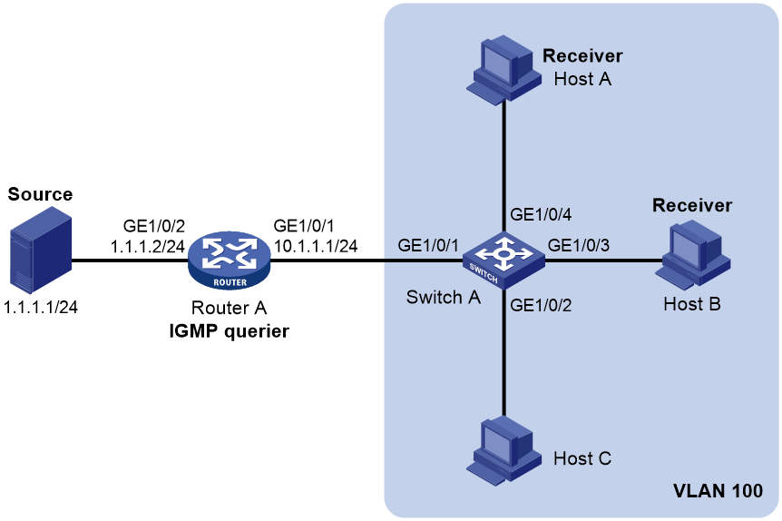

IGMP snooping ports
As shown in Figure 2, IGMP snooping runs on Switch A and Switch B, and Host A and Host C are receivers in a multicast group. IGMP snooping ports are divided into member ports and router ports.
Figure 2 IGMP snooping ports
Router ports
On an IGMP snooping Layer 2 device, the ports toward Layer 3 multicast devices are called router ports. In Figure 2, Port A1 of Switch A and Port B1 of Switch B are router ports.
Router ports contain the following types:
·     Dynamic router port—When a port receives an IGMP general query whose source address is not 0.0.0.0 or receives a PIM hello message, the port is added into the dynamic router port list. At the same time, an aging timer is started for the port. If the port receives another IGMP general query or PIM hello message before the timer expires, the timer is reset. If the port does not receive another IGMP general query or PIM hello message when the timer expires, the port is removed from the dynamic router port list.
·     Static router port—When a port is statically configured as a router port, it is added into the static router port list. The static router port does not age out, and it can be deleted only manually.
Do not confuse the "router port" in IGMP snooping with the "routed interface" commonly known as the "Layer 3 interface." The router port in IGMP snooping is a Layer 2 interface.
Member ports
On an IGMP snooping Layer 2 device, the ports toward receiver hosts are called member ports. In Figure 2, Port A2 and Port A3 of Switch A and Port B2 of Switch B are member ports.
Member ports contain the following types:
·     Dynamic member port—When a port receives an IGMP report, it is added to the associated dynamic IGMP snooping forwarding entry as an outgoing interface. At the same time, an aging timer is started for the port. If the port receives an IGMP report before the timer expires, the timer is reset. If the port does not receive an IGMP report when the timer expires, the port is removed from the associated dynamic forwarding entry.
·     Static member port—When a port is statically configured as a member port, it is added to the associated static IGMP snooping forwarding entry as an outgoing interface. The static member port does not age out, and it can be deleted only manually.
Unless otherwise specified, router ports and member ports in this document include both static and dynamic router ports and member ports.

Configuring a static member port
You can configure a port as a static member port for a multicast group so that hosts attached to the port can always receive multicast for the group. The static member port does not respond to IGMP queries. When you complete or cancel this configuration on a port, the port does not send an unsolicited IGMP report or leave message.
2.     Enter Layer 2 interface view.
¡     Enter Layer 2 Ethernet interface view.
¡     Enter Layer 2 aggregate interface view.
3.     Configure the port as a static member port.
igmp-snooping static-group group-address [ source-ip source-address ] vlan vlan-id
By default, a port is not a static member port.
Configuring a static router port
You can configure a port as a static router port for a multicast group so that all multicast data for the group received on the port will be forwarded.
3.     Configure the port as a static router port.
igmp-snooping static-router-port vlan vlan-id
By default, a port is not a static router port.
Configuring a port as a simulated member host
When a port is configured as a simulated member host, it is equivalent to an independent host in the following ways:
·     It sends an unsolicited IGMP report when you complete the configuration.
·     It responds to IGMP general queries with IGMP reports.
·     It sends an IGMP leave message when you cancel the configuration.
The version of IGMP running on the simulated member host is the same as the version of IGMP snooping running on the port. The port ages out in the same way as a dynamic member port.
3.     Configure the port as a simulated member host.
igmp-snooping host-join group-address [ source-ip source-address ] vlan vlan-id
By default, the port is not a simulated member host.

IGMP snooping configuration examples
Example: Configuring VLAN-based IGMP snooping group polices and simulated joining
As shown in Figure 3, Router A runs IGMPv2 and acts as the IGMP querier. Switch A runs IGMPv2 snooping.
Configure a multicast group policy and simulated joining to meet the following requirements:
·     Host A and Host B receive only the multicast data addressed to multicast group 224.1.1.1. Multicast data can be forwarded through GigabitEthernet 1/0/3 and GigabitEthernet 1/0/4 of Switch A uninterruptedly, even though Host A and Host B fail to receive the multicast data.
·     Switch A will drop unknown multicast data instead of flooding it in VLAN 100.
Figure 3 Network diagram
1.     Assign an IP address and subnet mask to each interface, as shown in Figure 3. (Details not shown.)
2.     Configure Router A:
# Enable IP multicast routing.
<RouterA> system-view
[RouterA] multicast routing
[RouterA-mrib] quit
# Enable IGMP on GigabitEthernet 1/0/1.
[RouterA] interface gigabitethernet 1/0/1
[RouterA-GigabitEthernet1/0/1] igmp enable
[RouterA-GigabitEthernet1/0/1] quit
# Enable PIM-DM on GigabitEthernet 1/0/2.
[RouterA] interface gigabitethernet 1/0/2
[RouterA-GigabitEthernet1/0/2] pim dm
[RouterA-GigabitEthernet1/0/2] quit
3.     Configure Switch A:
# Enable the IGMP snooping feature.
<SwitchA> system-view
[SwitchA] igmp-snooping
[SwitchA-igmp-snooping] quit
# Create VLAN 100, and assign GigabitEthernet 1/0/1 through GigabitEthernet 1/0/4 to the VLAN.
[SwitchA] vlan 100
[SwitchA-vlan100] port gigabitethernet 1/0/1 to gigabitethernet 1/0/4
# Enable IGMP snooping, and enable dropping unknown multicast data for VLAN 100.
[SwitchA-vlan100] igmp-snooping enable
[SwitchA-vlan100] igmp-snooping drop-unknown
[SwitchA-vlan100] quit
# Configure a multicast group policy so that hosts in VLAN 100 can join only multicast group 224.1.1.1.
[SwitchA] acl basic 2001
[SwitchA-acl-ipv4-basic-2001] rule permit source 224.1.1.1 0
[SwitchA-acl-ipv4-basic-2001] quit
[SwitchA-igmp-snooping] group-policy 2001 vlan 100
# Configure GigabitEthernet 1/0/3 and GigabitEthernet 1/0/4 as simulated member hosts of multicast group 224.1.1.1.
[SwitchA] interface gigabitethernet 1/0/3
[SwitchA-GigabitEthernet1/0/3] igmp-snooping host-join 224.1.1.1 vlan 100
[SwitchA-GigabitEthernet1/0/3] quit
[SwitchA] interface gigabitethernet 1/0/4
[SwitchA-GigabitEthernet1/0/4] igmp-snooping host-join 224.1.1.1 vlan 100
[SwitchA-GigabitEthernet1/0/4] quit
# Send IGMP reports from Host A and Host B to join multicast groups 224.1.1.1 and 224.2.2.2. (Details not shown.)
# Display dynamic IGMP snooping group entries for VLAN 100 on Switch A.
[SwitchA] display igmp-snooping group vlan 100
Total 1 entries.
VLAN 100: Total 1 entries.
  (0.0.0.0, 224.1.1.1)
    Host ports (2 in total):
      GE1/0/3                              (00:03:23)
      GE1/0/4                              (00:04:10)
The output shows the following information:
·     Host A and Host B have joined multicast group 224.1.1.1 through the member ports GigabitEthernet 1/0/4 and GigabitEthernet 1/0/3 on Switch A, respectively.
·     Host A and Host B have failed to join multicast group 224.2.2.2.
