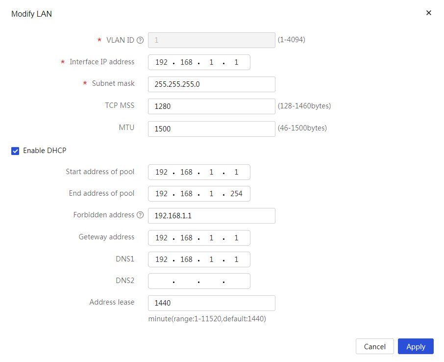

1.     Change the IP address of VLAN-interface 1 to 192.168.1.1/24 as required:
a.     From the left navigation pane, select Network > LAN Settings.
b.     Click the Edit icon in the Actions column for VLAN-interface 1 to access the page for editing the LAN settings.
c.     In the Interface IP address field, change the IP address of the interface to 192.168.1.1.
d.     In the Subnet Mask field, change the subnet mask to 255.255.255.0.
e.     Clear the Enable DHCP option to disable DHCP.
f.     Use the default settings for the other parameters, and then click Apply.
Figure 2 Editing the LAN

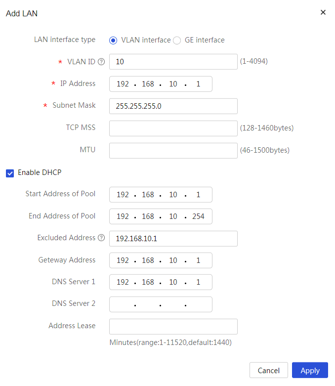

2.     Create VLAN 10, configure an IP address for the VLAN interface, and enable DHCP on the interface:
b.     Click Add.
c.     In the LAN interface type field, select VLAN interface.
d.     In the VLAN ID field, enter 10.
e.     In the Interface IP address field, enter 192.168.10.1.
f.     In the Subnet Mask field, enter 255.255.255.0.
g.     Select the Enable DHCP option to enable DHCP.
h.     Use the default settings for the other parameters, and then click Apply.
Figure 3 Configuring VLAN 10
3.     Create VLAN 20, configure an IP address for the VLAN interface, and enable DHCP on the interface:
b.     Click Add.
d.     In the VLAN ID field, enter 20.
e.     In the Interface IP address field, enter 192.168.20.1.
Figure 4 Configuring VLAN 20

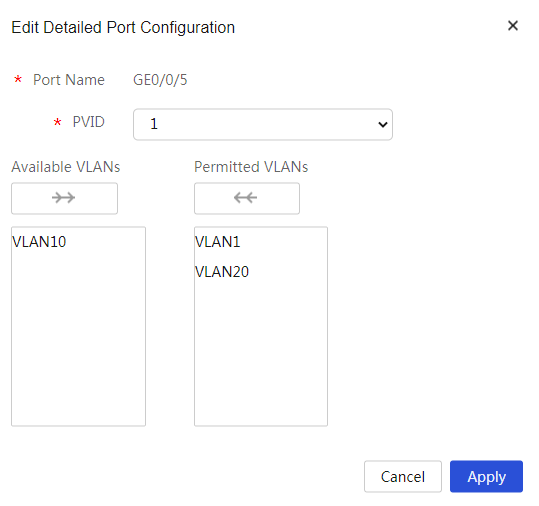

5.     Assign interface GE 0/0/5 to VLAN 1 and VLAN 20:
b.     Click the VLAN Division tab.
c.     Click the Edit icon in the Actions column for interface GE 0/0/5.
The detailed port configuration page opens.
d.     Click VLAN 20 in the Available VLANs area to add VLAN 20 to the Selected VLANs area.
e.     Use the default settings for the other parameters, and then click Apply.
Figure 6 Configuring interface GE 0/0/5
