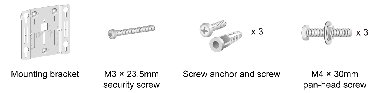

Installation accessories
Figure 1-1 Accessories provided with the AP

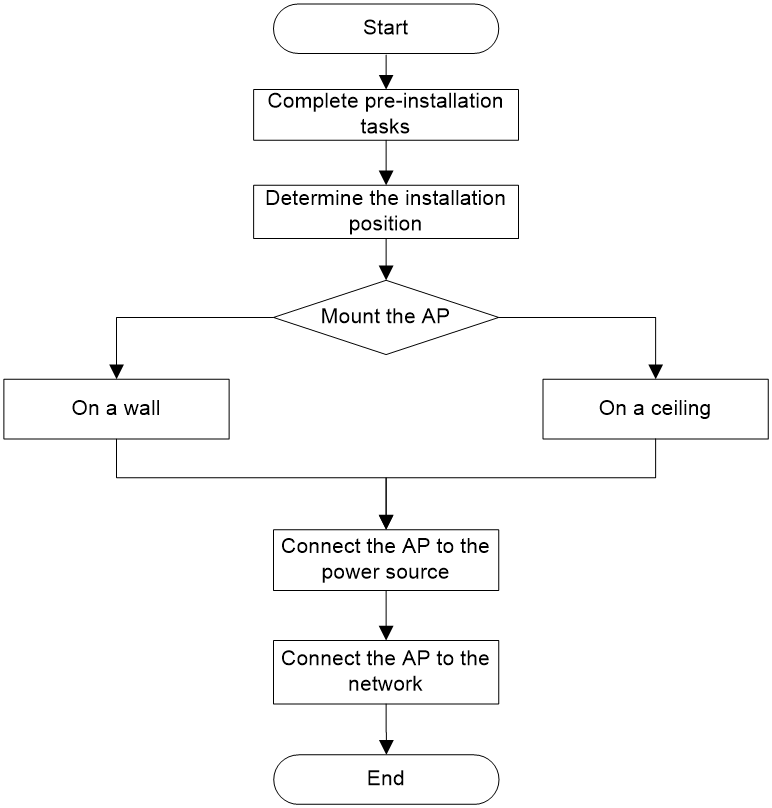

Installation flowchart
Figure 2-1 Installation flowchart

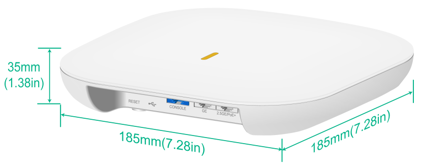

APs and the mounting bracket

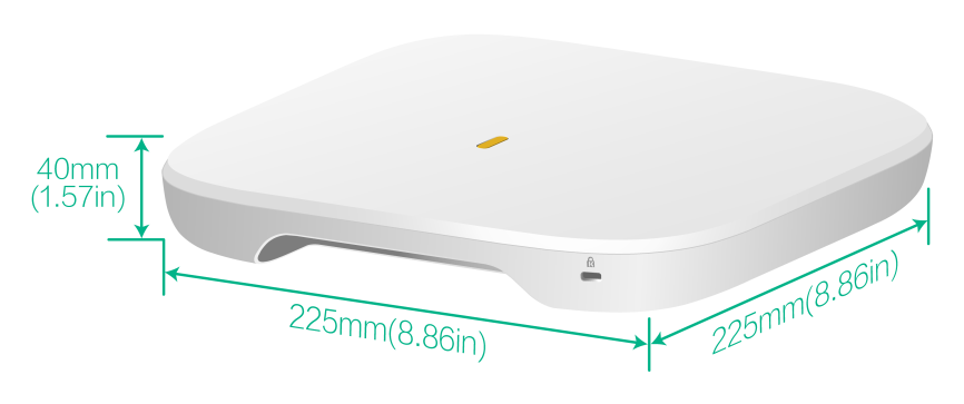

Figure 2-1 WA6126 AP
Figure 2-2 WA6526 AP
Figure 2-3 WA6526E AP
Figure 2-4 WA6528i AP

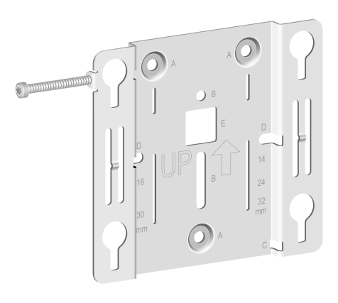

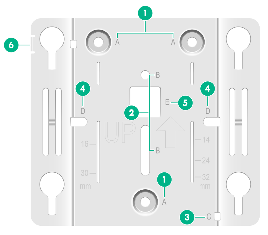

Figure 2-5 Mounting bracket
(1) Installation hole for securing the mounting bracket to a wall or ceiling (point A)
(2) T-rail installation hole (reserved)(point B)
(3) Auxiliary hole for securing cables by using cable tie (point C)
(4) Installation hole reserved for electrical outlet box installation (point D)
(5) Auxiliary hole for threading a cable to connect to the AP (point E)
(6) Security hole for an M3 × 23.5 security screw

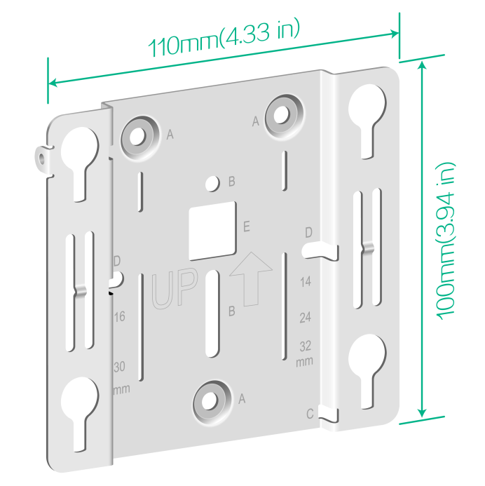

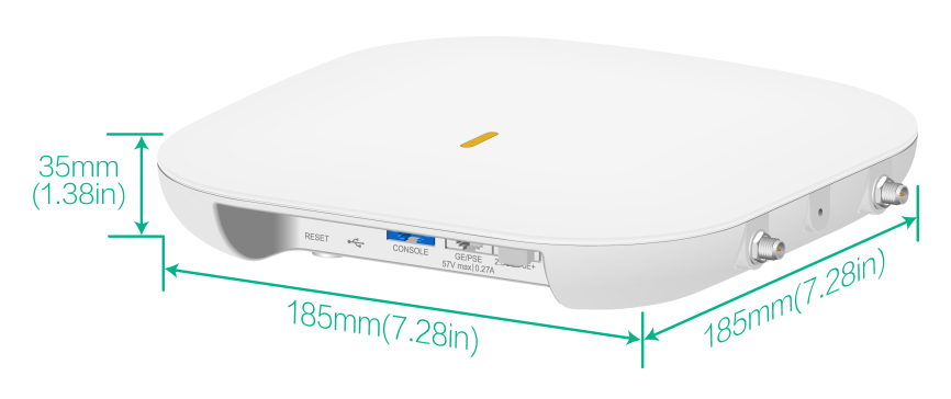

Figure 2-6 Mounting bracket dimensions

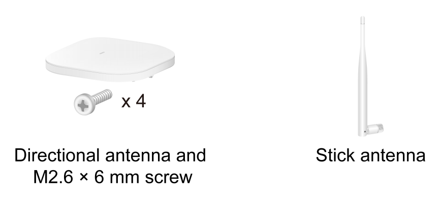

Installing antennas

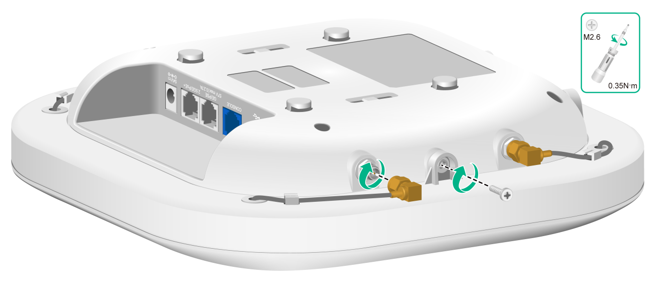

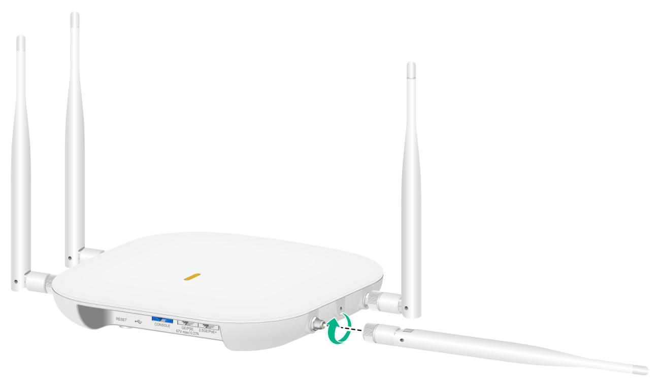

Only the WA6526E supports external antennas. Install a directional antenna or stick antennas as needed.
To install a directional antenna, put the antenna over the AP front, use M2.6 × 6 mm screws to secure the antenna, and then connect the SMA connectors on the antenna to the R-SMA connectors on the AP. See Figure 2-7.
To install a stick antenna, attach the antenna to an R-SMA connector on the AP. See Figure 2-8.
To use single-frequency antennas for the 2.4G band, connect the antennas to the ANT2 and ANT4 ports. To use single-frequency antennas for the 5G band, connect the antennas to the ANT1 and ANT3 ports.
Figure 2-7 Installing a directional antenna
Figure 2-8 Installing stick antennas

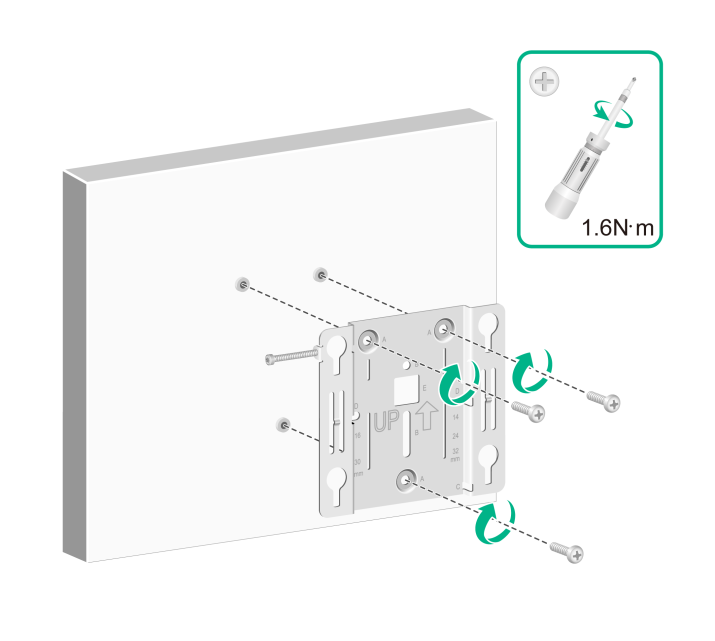

1.     Place the mounting bracket against the wall and mark the installation holes on the wall.
Figure 2-9 Marking the installation holes on the wall

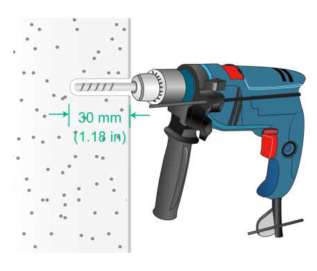

2.     Drill three holes with a diameter of 6 mm (0.24 in) and a depth of 30 mm (1.18 in) at the marked locations, as shown in Figure 2-10.
Figure 2-10 Drilling holes in the wall

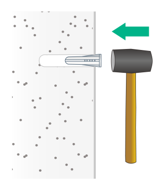

3.     Insert a screw anchor into each hole, and tap the screw anchor with a rubber hammer until it is all flush with the wall surface, as shown in Figure 2-11.
Figure 2-11 Hammering the screw anchor into the wall
4.     Thread the M3 × 23.5 security screw through the security hole in the mounting bracket. Make sure the screw does not block the keyhole slot.
Figure 2-12 Inserting the security screw
5.     Insert the screws through the installation holes in the mounting bracket into the holes in the wall. Fasten the screws to secure the mounting bracket to the wall, as shown in Figure 2-13.
Figure 2-13 Attaching the mounting bracket to the wall

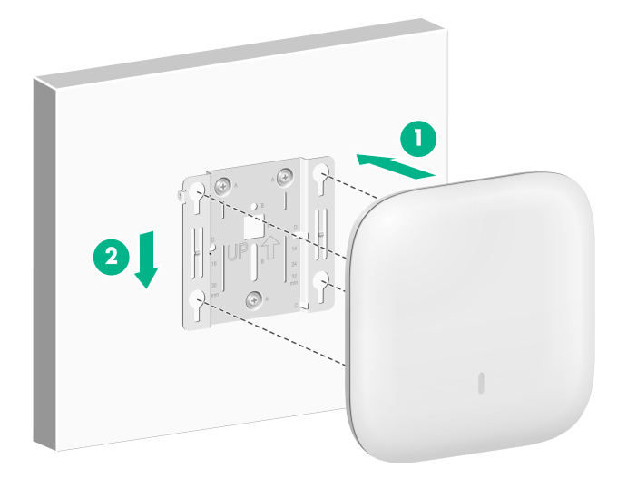

6.     Position the four pegs at the AP rear into the keyhole slots in the mounting bracket and then slide the AP down until it sits securely in the keyhole slots, as shown in Figure 2-14.
Figure 2-14 Attaching the AP to the mounting bracket

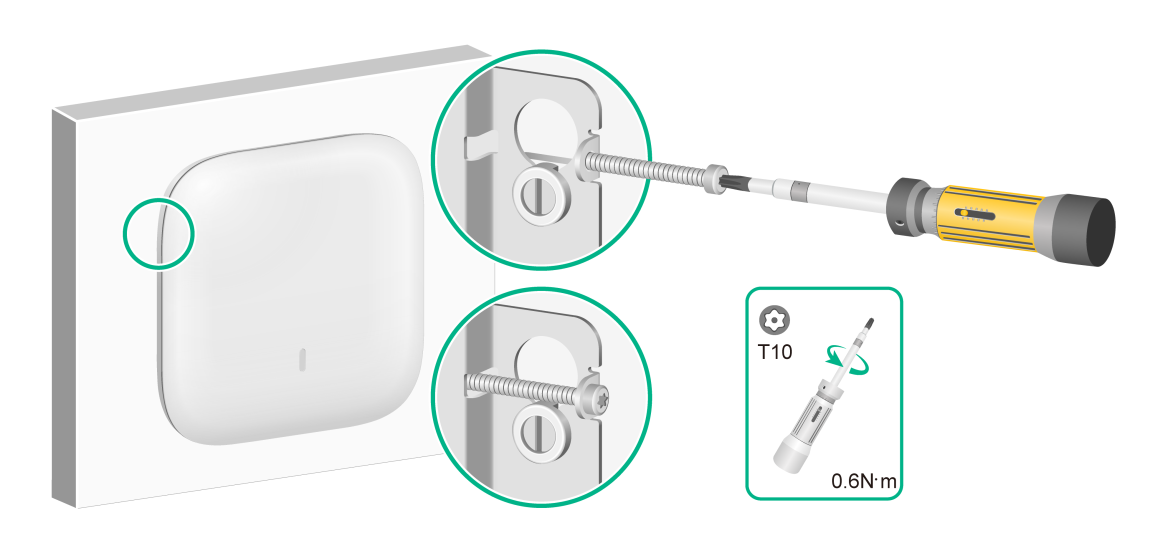

7.     Use a security Torx screwdriver to fasten the M3 × 23.5 security screw.
Figure 2-15 Fastening the M3 × 23.5 security screw

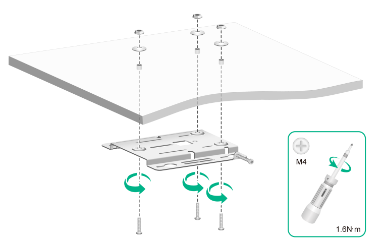

Mounting the AP on a ceiling
CAUTION
CAUTION:

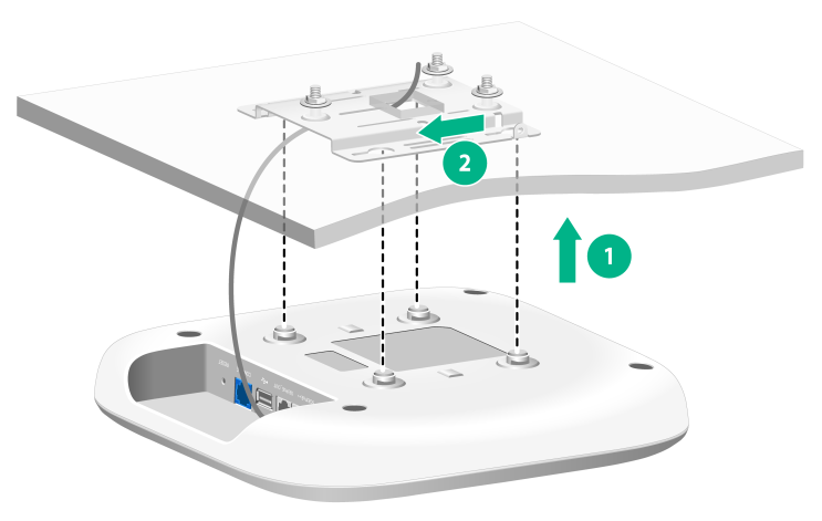

The ceiling for installing the AP must be less than 18 mm (0.71 in) in thickness, and can bear a load of 5 kg (11.02 lb). If you must install the AP on a ceiling not strong enough, use boards to reinforce the ceiling.
The installation method for the M3 × 23.5 security screw is similar when the AP is mounted on the wall and on the ceiling.
To mount the AP on a ceiling:

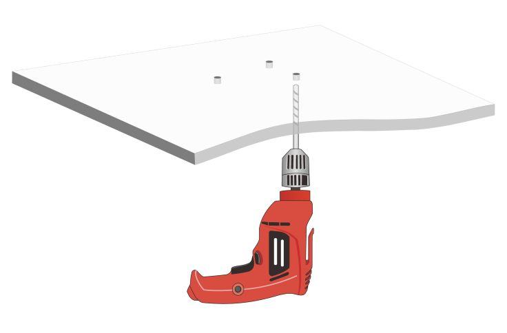

1.     Remove the ceiling tile.
2.     Place the mounting bracket against the ceiling tile and mark the installation holes on the ceiling tile. Drill three holes with a diameter of 6 mm (0.24 in) at the marked positions, as shown in Figure 2-16.
Figure 2-16 Drilling holes in the ceiling tile
3.     Thread the pan-head screws through the installation holes in the mounting bracket and into the holes in the ceiling tile. Fasten washers and nuts at the other side of the ceiling to secure the mounting bracket to the ceiling, as shown in Figure 2-17.
Figure 2-17 Attaching the mounting bracket to the ceiling

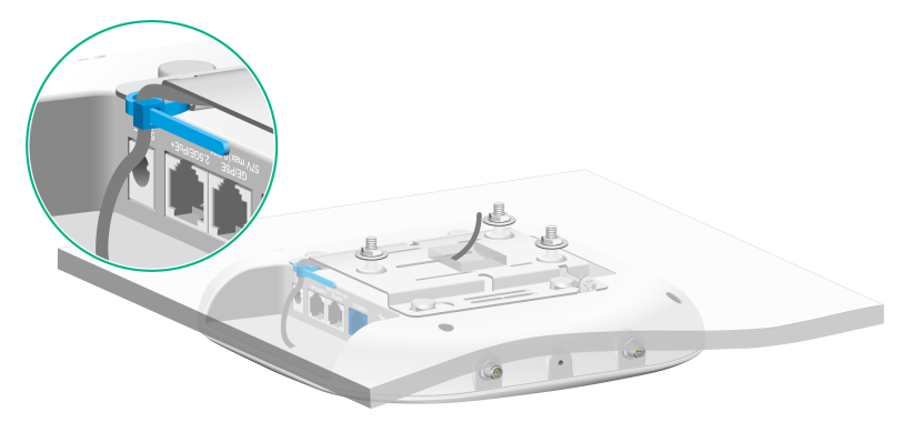

4.     Connect a cable to the AP. Then position the four pegs at the AP rear into the keyhole slots in the mounting bracket and slide the AP until it sits securely in the keyhole slots.
Figure 2-18 Attaching the AP to the mounting bracket
(Optional.) You can use a cable tie to secure the cable before attaching the AP to the mounting bracket. First thread the cable tie through the auxiliary hole in the mounting bracket, leaving the cable tie unfastened, and then adjust the cable length and fasten the cable tie to secure the cable.
No cable tie is provided with the AP. Prepare one yourself as required.
Figure 2-19 Using a cable tie to secure the cable

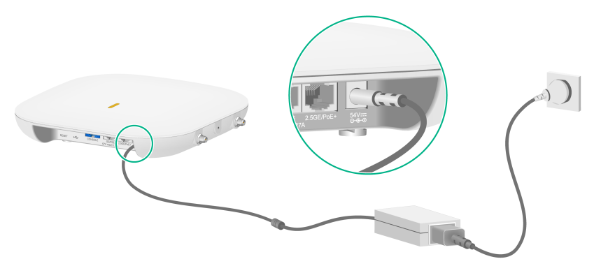

Connecting a local power source
You can use an AC/DC power adapter to connect the AP to a local power source. No power adapter is provided with the AP. Purchase a power adapter from H3C as required. Table 2-1 describes the power adapter specifications.
Table 2-1 Power adapter specifications
Item
Specification
Input
100 VAC to 240 VAC
Output
+48 VDC to +55 VDC
Figure 2-20 Using a power adapter to connect the AP to a local power source

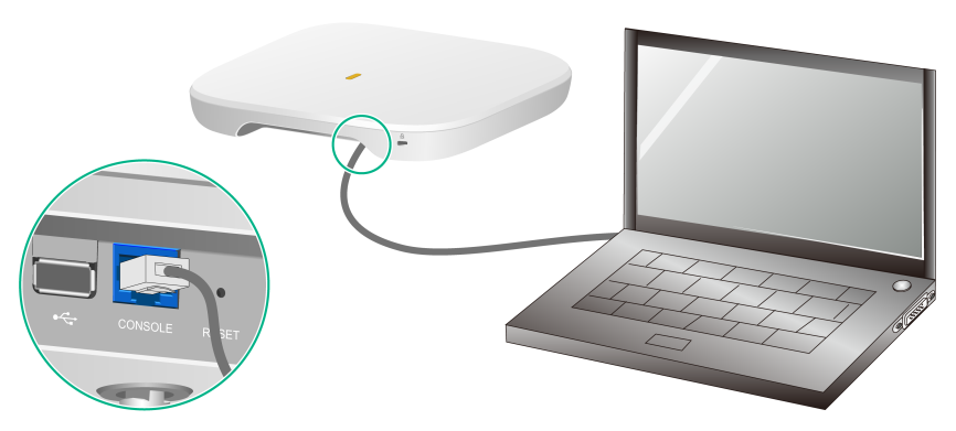

Prepare the following items for accessing the device from the console port:
·     An 8-core console cable, with a crimped RJ-45 connector at one end, and a DB-9 connector at the other end.
·     A configuration terminal. It can be a standard character terminal with an RS-232 port, or a PC.
Connecting the AP to a configuration terminal from the console port
CAUTION
CAUTION:
·     To connect a PC to the AP, first connect the PC end. To disconnect a PC from the AP, first disconnect the AP end.
·     If the PC does not have an RS-232 port but a USB port, use a USB-to-RS-232 converter to connect the USB port to the console cable and install the driver on the PC.
To connect the AP to a configuration terminal from the console port:
1.     Connect the DB-9 connector of the console cable to the serial port on the configuration terminal, for example, a PC.
2.     Connect the RJ-45 connector of the console cable to the console port on the AP.
Figure 3-1 Connecting the AP to a PC from the console port
