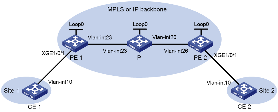

As shown in Figure 1, the remote connection model connects two CEs through a PW on an MPLS or IP backbone.
Figure 1 Remote connection model

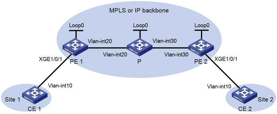

As shown in Figure 2, the local connection model connects two CEs to the same PE so the CEs can communicate through the PE.
Figure 2 Local connection model
The local connection model is not supported in the current software version.

Example: Configuring a static PW
Create a static PW between PE 1 and PE 2 over the backbone to allow communication between CE 1 and CE 2 within VLAN 10.
Create Ethernet service instance 10 on Ten-GigabitEthernet 1/0/1 to match packets with an outer VLAN ID of 10 on each PE.
Figure 3 Network diagram
Device
Interface
IP address
Device
Interface
IP address
CE 1
Vlan-int10
100.1.1.1/24
P
Loop0
192.4.4.4/32
PE 1
Loop0
192.2.2.2/32
Vlan-int30
10.2.2.2/24
Vlan-int20
10.1.1.1/24
Vlan-int20
10.1.1.2/24
CE 2
Vlan-int10
100.1.1.2/24
PE 2
Loop0
192.3.3.3/32
Vlan-int30
10.2.2.1/24
1.     Configure VLANs and add ports to VLANs on each switch. (Details not shown.)
2.     Configure CE 1.
<CE1> system-view
[CE1] interface vlan-interface 10
[CE1-Vlan-interface10] ip address 100.1.1.1 24
[CE1-Vlan-interface10] quit
3.     Configure PE 1:
# Configure an LSR ID.
<PE1> system-view
[PE1] interface loopback 0
[PE1-LoopBack0] ip address 192.2.2.2 32
[PE1-LoopBack0] quit
[PE1] mpls lsr-id 192.2.2.2
# Enable L2VPN.
[PE1] l2vpn enable
# Enable global LDP.
[PE1] mpls ldp
[PE1-ldp] quit
# Configure VLAN-interface 20 (the interface connected to the P device), and enable LDP on the interface.
[PE1] interface vlan-interface 20
[PE1-Vlan-interface20] ip address 10.1.1.1 24
[PE1-Vlan-interface20] mpls enable
[PE1-Vlan-interface20] mpls ldp enable
[PE1-Vlan-interface20] quit
# Configure OSPF for LDP to create LSPs.
[PE1] ospf
[PE1-ospf-1] area 0
[PE1-ospf-1-area-0.0.0.0] network 10.1.1.1 0.0.0.255
[PE1-ospf-1-area-0.0.0.0] network 192.2.2.2 0.0.0.0
[PE1-ospf-1-area-0.0.0.0] quit
[PE1-ospf-1] quit
# Create VLAN 10 and assign Ten-GigabitEthernet 1/0/1 to the VLAN.
[PE1] vlan 10
[PE1-vlan10] port ten-gigabitethernet 1/0/1
[PE1-vlan10] quit
# Create Ethernet service instance 10 on Ten-GigabitEthernet 1/0/1 to match packets with an outer VLAN ID of 10.
[PE1] interface ten-gigabitethernet 1/0/1
[PE1-Ten-GigabitEthernet1/0/1] service-instance 10
[PE1-Ten-GigabitEthernet1/0/1-srv10] encapsulation s-vid 10
[PE1-Ten-GigabitEthernet1/0/1-srv10] quit
[PE1-Ten-GigabitEthernet1/0/1] quit
# Create a cross-connect group named vpna, create a cross-connect named svc in the group, and bind Ethernet service instance 10 on Ten-GigabitEthernet 1/0/1 to the cross-connect.
[PE1] xconnect-group vpna
[PE1-xcg-vpna] connection svc
[PE1-xcg-vpna-svc] ac interface ten-gigabitethernet 1/0/1 service-instance 10
[PE1-xcg-vpna-svc-Ten-GigabitEthernet1/0/1-srv10] quit
# Create a static PW for the cross-connect to bind the AC to the PW.
[PE1-xcg-vpna-svc] peer 192.3.3.3 pw-id 3 in-label 100 out-label 200
[PE1-xcg-vpna-svc-192.3.3.3-3] quit
[PE1-xcg-vpna-svc] quit
[PE1-xcg-vpna] quit

Example: Configuring an LDP PW
Create an LDP PW between PE 1 and PE 2, and use flexible mode to match packets from each AC to allow communication between CE 1 and CE 2 within VLAN 10 without consuming VLAN resources on PEs.
Figure 4 Network diagram
Table 3 Interface and IP address assignment
Device
Interface
IP address
Device
Interface
IP address
CE 1
Vlan-int10
100.1.1.1/24
P
Loop0
192.4.4.4/32
PE 1
Loop0
192.2.2.2/32
Vlan-int23
23.1.1.2/24
Vlan-int23
23.1.1.1/24
Vlan-int26
26.2.2.2/24
CE 2
Vlan-int10
100.1.1.2/24
PE 2
Loop0
192.3.3.3/32
Vlan-int26
26.2.2.1/24

Example: Configuring a BGP PW
Create a BGP PW between PE 1 and PE 2 to allow communication between CE 1 and CE 2 within VLAN 10.
Figure 5 Network diagram
Table 4 Interface and IP address assignment
Device
Interface
IP address
Device
Interface
IP address
CE 1
Vlan-int10
100.1.1.1/24
P
Loop0
192.4.4.4/32
PE 1
Loop0
192.2.2.2/32
Vlan-int20
10.1.1.2/24
Vlan-int20
10.1.1.1/24
Vlan-int30
10.2.2.2/24
CE 2
Vlan-int10
100.1.1.2/24
PE 2
Loop0
192.3.3.3/32
Vlan-int30
10.2.2.1/24

Example: Configuring a remote CCC connection
Create a remote CCC connection between PE 1 and PE 2 to allow communication between CE 1 and CE 2 within VLAN 10.
Figure 6 Network diagram
Table 5 Interface and IP address assignment
Device
Interface
IP address
Device
Interface
IP address
CE 1
Vlan-int10
100.1.1.1/24
P
Loop0
192.4.4.4/32
PE 1
Loop0
192.2.2.2/32
Vlan-int20
10.1.1.2/24
Vlan-int20
10.1.1.1/24
Vlan-int30
10.2.2.2/24
CE 2
Vlan-int10
100.1.1.2/24
PE 2
Loop0
192.3.3.3/32
Vlan-int30
10.2.2.1/24
2.     Configure CE 1.
<CE1> system-view
3.     Configure PE 1:
<PE1> system-view
# Enable L2VPN.
[PE1] l2vpn enable
# Configure VLAN-interface 20 (the interface connected to the P device), and enable MPLS on the interface.
[PE1] vlan 10
[PE1-vlan10] quit
[PE1-Ten-GigabitEthernet1/0/1-srv10]encapsulation s-vid 10
# Create a cross-connect group named ccc, and create a remote CCC connection that has incoming label 101, outgoing label 201, and next hop 10.1.1.2.
[PE1] xconnect-group ccc
[PE1-xcg-ccc] connection ccc
[PE1-xcg-ccc-ccc] ccc in-label 101 out-label 201 nexthop 10.1.1.2
# Bind Ethernet service instance 10 on Ten-GigabitEthernet 1/0/1 to the CCC connection.
[PE1-xcg-ccc-ccc] ac interface ten-gigabitethernet 1/0/1 service-instance 10
[PE1-xcg-ccc-ccc-Ten-GigabitEthernet1/0/1-srv10] quit
[PE1-xcg-ccc-ccc] quit
[PE1-xcg-ccc] quit
4.     Configure the P device:
<P> system-view
[P] interface loopback 0
[P-LoopBack0] ip address 192.4.4.4 32
[P-LoopBack0] quit
[P] mpls lsr-id 192.4.4.4
# Configure VLAN-interface 20 (the interface connected to PE 1), and enable MPLS on the interface.
[P] interface vlan-interface 20
[P-Vlan-interface20] ip address 10.1.1.2 24
[P-Vlan-interface20] mpls enable
[P-Vlan-interface20] quit
# Configure VLAN-interface 30 (the interface connected to PE 2), and enable MPLS on the interface.
[P] interface vlan-interface 30
[P-Vlan-interface30] ip address 10.2.2.2 24
[P-Vlan-interface30] mpls enable
[P-Vlan-interface30] quit
# Configure a static LSP to forward packets from PE 1 to PE 2.
[P] static-lsp transit pe1-pe2 in-label 201 nexthop 10.2.2.1 out-label 202
# Configure a static LSP to forward packets from PE 2 to PE 1.
[P] static-lsp transit pe2-pe1 in-label 102 nexthop 10.1.1.1 out-label 101
5.     Configure PE 2:
<PE2> system-view
[PE2] interface loopback 0
[PE2-LoopBack0] ip address 192.3.3.3 32
[PE2-LoopBack0] quit
[PE2] mpls lsr-id 192.3.3.3
# Enable L2VPN.
[PE2] l2vpn enable
# Configure VLAN-interface 30 (the interface connected to the P device), and enable MPLS on the interface.
[PE2] interface vlan-interface 30
[PE2-Vlan-interface30] ip address 10.2.2.1 24
[PE2-Vlan-interface30] mpls enable
[PE2-Vlan-interface30] quit
[PE2] vlan 10
[PE2-vlan10] port ten-gigabitethernet 1/0/1
[PE2-vlan10] quit
[PE2] interface ten-gigabitethernet 1/0/1
[PE2-Ten-GigabitEthernet1/0/1] service-instance 10
[PE2-Ten-GigabitEthernet1/0/1-srv10]encapsulation s-vid 10
[PE2-Ten-GigabitEthernet1/0/1-srv10] quit
[PE2-Ten-GigabitEthernet1/0/1] quit
# Create a cross-connect group named ccc, and create a remote CCC connection that has incoming label 202, outgoing label 102, and next hop 10.2.2.2.
[PE2] xconnect-group ccc
[PE2-xcg-ccc] connection ccc
[PE2-xcg-ccc-ccc] ccc in-label 202 out-label 102 nexthop 10.2.2.2
[PE2-xcg-ccc-ccc] ac interface ten-gigabitethernet 1/0/1 service-instance 10
[PE2-xcg-ccc-ccc-Ten-GigabitEthernet1/0/1-srv10] quit
[PE2-xcg-ccc-ccc] quit
[PE2-xcg-ccc] quit
6.     Configure CE 2.
<CE2> system-view
[CE2] interface vlan-interface 10
[CE2-Vlan-interface10] ip address 100.1.1.2 24
[CE2-Vlan-interface10] quit
# Verify that a remote CCC connection (identified by PW ID/Rmt Site "-" and Proto Static) has been established on PE 1.
[PE1] display l2vpn pw
Flags: M - main, B - backup, E - ecmp, BY - bypass, H - hub link, S - spoke link
       N - no split horizon, A - administration, ABY - ac-bypass
       PBY - pw-bypass
Total number of PWs: 1
1 up, 0 blocked, 0 down, 0 defect, 0 idle, 0 duplicate
Xconnect-group Name: ccc
Peer            PW ID/Rmt Site    In/Out Label    Proto   Flag  Link ID  State
10.1.1.2        -                 101/201         Static  M     0        Up
# Verify that a remote CCC connection has been established on PE 2.
[PE2] display l2vpn pw
       PBY - pw-bypass
10.2.2.2        -                 202/102         Static  M     0        Up
# Verify that CE 1 and CE 2 can ping each other. (Details not shown.)
