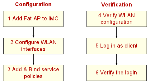

Recommended Configuration Flow
Step1   Add Fat AP to iMC
l          Add the Fat AP to iMC through iMC PLAT.
l          Check that the added device is recognized by the iMC as a Fat AP.
Step2   Configure WLAN interface
l          Add a WLAN interface.
l          Specify the VLAN to which the WLAN interface belongs.
Step3   Add & Bind service policy
l          Add a service policy for the specified Fat AP.
l          Set radio parameters and bind the radio to the service policy.
Step4   Verify WLAN configuration
l          Check that the added WLAN exists in the ESS list, and check the counts of online Fat APs and clients.
l          Check that the Fat AP is connected.
Step5   Log in as client
The PC or laptop with a wireless network card is used to log in to the WLAN as a wireless client.
Step6   Verify the client login
l          Synchronize the information of the Fat AP
l          Verify the login information in client view
l          View the client information
