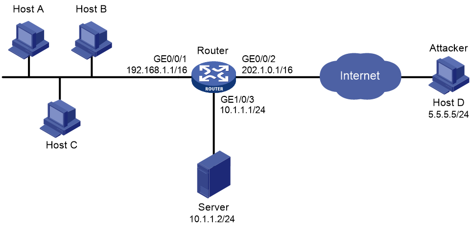

Example: Configuring interface-based attack detection and prevention
As shown in Figure 1, the router is the gateway for the internal network.
Configure an attack defense policy and apply the policy to GigabitEthernet 0/0/2 to meet the following requirements:
·     Provide low-level scanning attack detection for internal hosts and servers. If a scanning attack is detected, log the attack and drop the packets sent by the attacker.
·     Protect internal hosts and servers against smurf attacks. If a smurf attack is detected, log the attack.
·     Protect the internal server against SYN flood attacks. If the number of SYN packets sent to the server per second reaches or exceeds 5000, log the attack and drop subsequent packets.
Figure 1 Network diagram
# Configure IP addresses for the interfaces on the router. (Details not shown.)
# Create attack defense policy a1.
<Router> system-view
[Router] attack-defense policy a1
# Configure signature detection for smurf attacks, and specify logging as the prevention action.
[Router-attack-defense-policy-a1] signature detect smurf action logging
# Configure low-level scanning attack detection, specify logging and drop as the prevention actions.
[Router-attack-defense-policy-a1] scan detect level low action logging drop
# Configure SYN flood attack detection for 10.1.1.2, set the attack prevention triggering threshold to 5000, and specify logging and drop as the prevention actions.
[Router-attack-defense-policy-a1] syn-flood detect ip 10.1.1.2 threshold 5000 action logging drop
[Router-attack-defense-policy-a1] quit
# Apply attack defense policy a1 to GigabitEthernet 0/0/2.
[Router] interface gigabitethernet 0/0/2
[Router-GigabitEthernet0/0/2] attack-defense apply policy a1
[Router-GigabitEthernet0/0/2] quit
