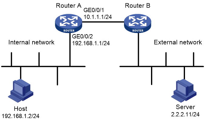

Figure 4 Network diagram
# Configure ACL 3111 to deny all IP packets.
<RouterA> system-view
[RouterA] acl advanced 3111
[RouterA-acl-ipv4-adv-3111] rule deny ip
[RouterA-acl-ipv4-adv-3111] quit
# Create ASPF policy 1.
[RouterA] aspf-policy 1
# Enable ICMP error message dropping.
[RouterA-aspf-policy-1] icmp-error drop
# Enable TCP SYN check.
[RouterA-aspf-policy-1] tcp syn-check
[RouterA-aspf-policy-1] quit
# Enable ASPF policy 1 to inspect FTP packets.
[RouterA-aspf-policy-1] detect ftp
# Apply ACL 3111 to deny all incoming IP packets on GigabitEthernet 0/0/1.
[RouterA] interface gigabitethernet 0/0/1
[RouterA-GigabitEthernet0/0/1] packet-filter 3111 inbound
# Apply ASPF policy 1 to outgoing traffic on GigabitEthernet 0/0/1.
[RouterA-GigabitEthernet0/0/1] aspf apply policy 1 outbound
[RouterA-GigabitEthernet0/0/1] quit
# Display the configuration of ASPF policy 1.
[RouterA] display aspf policy 1
ASPF policy configuration:
  Policy number: 1
    ICMP error message check: Enabled
    TCP SYN packet check: Enabled
    Inspected protocol    Action
      FTP                  None
Router A can recognize faked ICMP error messages from external networks, and drop the non-SYN packets that are the first packets to establish TCP connections.

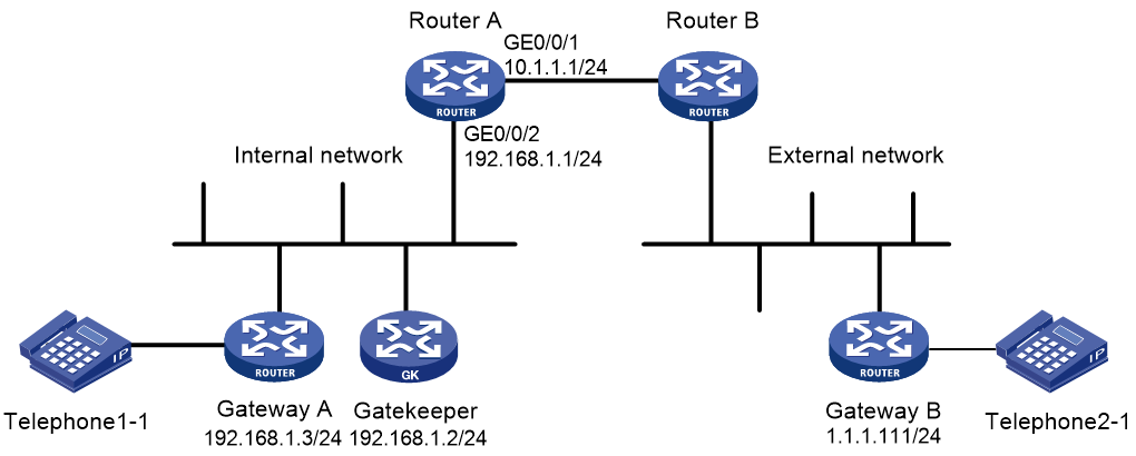

Figure 5 displays a typical H.323 application network. Gateway B on the external network needs to access the H.323 Gatekeeper, and with the assistance of Gatekeeper, to establish a connection with the H.323 Gateway A. Other protocol packets from the external network are dropped.
Configure a packet filter on Router A to permit only packets destined to the Gatekeeper. Configure an ASPF policy on Router A to detect H.323 protocol packets so that return packets to the external network can be passed through GigabitEthernet 0/0/1.
Figure 5 Network diagram
# Create ACL 3200 and configure two rules in the ACL: one to permit packets destined to Gatekeeper to pass, and one to deny all IP packets.
[RouterA] acl advanced 3200
[RouterA-acl-ipv4-adv-3200] rule 0 permit ip destination 192.168.1.2 0
[RouterA-acl-ipv4-adv-3200] rule 5 deny ip
[RouterA-acl-ipv4-adv-3200] quit
# Create ASPF policy 1 for H.323 inspection.
[RouterA] aspf policy 1
[RouterA-aspf-policy-1] detect h323
# Apply ACL 3200 to filter incoming packets on GigabitEthernet 0/0/1.
[RouterA-GigabitEthernet0/0/1] packet-filter 3200 inbound
# Apply ASPF policy 1 to incoming traffic on GigabitEthernet 0/0/1.
[RouterA-GigabitEthernet0/0/1] aspf apply policy 1 inbound
# Verify that ASPF sessions have been created between Gateway B and Gatekeeper/Gateway A.
[RouterA] display aspf session ipv4
Slot 0:
Initiator:
  Source      IP/port: 1.1.1.111/33184
  Destination IP/port: 192.168.1.3/32828
  VPN instance/VLAN ID/Inline ID: -/-/-
  Protocol: UDP(17)
  Inbound interface: GigabitEthernet0/0/1
Initiator:
  Source      IP/port: 1.1.1.111/1719
  Destination IP/port: 192.168.1.2/1719
  Protocol: UDP(17)
Initiator:
  Source      IP/port: 1.1.1.111/3521
  Destination IP/port: 192.168.1.2/20155
  Protocol: TCP(6)
Initiator:
  Source      IP/port: 1.1.1.111/33185
  Destination IP/port: 192.168.1.3/32829
  Protocol: UDP(17)
Initiator:
  Source      IP/port: 1.1.1.111/3688
  Destination IP/port: 192.168.1.2/1720
  Protocol: TCP(6)
Total sessions found: 5
# Verify that only return packets that match the entries can pass through GigabitEthernet 0/0/1. (Details not shown.)
