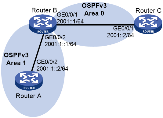

Configuring OSPFv3 FRR
About OSPFv3 FRR
A primary link failure can cause packet loss and even a routing loop until OSPFv3 completes routing convergence based on the new network topology. OSPFv3 FRR enables fast rerouting to minimize the failover time.
Figure 3 Network diagram for OSPFv3 FRR
As shown in Figure 3, configure FRR on Router B. OSPFv3 FRR automatically calculates a backup next hop or specifies a backup next hop by using a routing policy. When the primary link fails, OSPFv3 directs packets to the backup next hop. At the same time, OSPFv3 calculates the shortest path based on the new network topology. It forwards packets over the path after network convergence.
You can configure OSPFv3 FRR to calculate a backup next hop by using the loop free alternate (LFA) algorithm, or specify a backup next hop by using a routing policy.
Configuring OSPFv3 FRR to use the LFA algorithm to calculate a backup next hop
Do not use the fast-reroute lfa command together with the vlink-peer command.

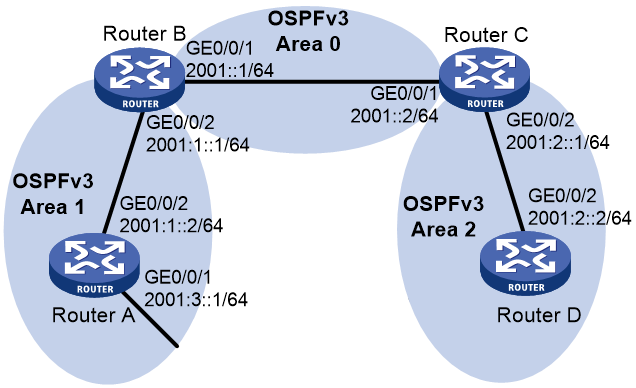

Example: Configuring OSPFv3 stub area
As shown in Figure 5:
·     Enable OSPFv3 on all routers.
·     Split the AS into three areas.
·     Configure Router B and Router C as ABRs to forward routing information between areas.
·     Configure Area 2 as a stub area to reduce LSAs in the area without affecting route reachability.
Figure 5 Network diagram
1.     Configure IPv6 addresses for interfaces. (Details not shown.)
2.     Configure basic OSPFv3:
# On Router A, enable OSPFv3 and specify the router ID as 1.1.1.1.
<RouterA> system-view
[RouterA] ospfv3 1
[RouterA-ospfv3-1] router-id 1.1.1.1
[RouterA-ospfv3-1] quit
[RouterA] interface gigabitethernet 0/0/1
[RouterA-GigabitEthernet0/0/1] ospfv3 1 area 1
[RouterA-GigabitEthernet0/0/1] quit
[RouterA] interface gigabitethernet 0/0/2
[RouterA-GigabitEthernet0/0/2] ospfv3 1 area 1
[RouterA-GigabitEthernet0/0/2] quit
# On Router B, enable OSPFv3 and specify the router ID as 2.2.2.2.
<RouterB> system-view
[RouterB] ospfv3 1
[RouterB-ospfv3-1] router-id 2.2.2.2
[RouterB-ospfv3-1] quit
[RouterB] interface gigabitethernet 0/0/1
[RouterB-GigabitEthernet0/0/1] ospfv3 1 area 0
[RouterB-GigabitEthernet0/0/1] quit
[RouterB] interface gigabitethernet 0/0/2
[RouterB-GigabitEthernet0/0/2] ospfv3 1 area 1
[RouterB-GigabitEthernet0/0/2] quit
# On Router C, enable OSPFv3 and specify the router ID as 3.3.3.3.
<RouterC> system-view
[RouterC] ospfv3 1
[RouterC-ospfv3-1] router-id 3.3.3.3
[RouterC-ospfv3-1] quit
[RouterC] interface gigabitethernet 0/0/1
[RouterC-GigabitEthernet0/0/1] ospfv3 1 area 0
[RouterC-GigabitEthernet0/0/1] quit
[RouterC] interface gigabitethernet 0/0/2
[RouterC-GigabitEthernet0/0/2] ospfv3 1 area 2
[RouterC-GigabitEthernet0/0/2] quit
# On Router D, enable OSPFv3 and specify the router ID as 4.4.4.4.
<RouterD> system-view
[RouterD] ospfv3 1
[RouterD-ospfv3-1] router-id 4.4.4.4
[RouterD-ospfv3-1] quit
[RouterD] interface gigabitethernet 0/0/2
[RouterD-GigabitEthernet0/0/2] ospfv3 1 area 2
[RouterD-GigabitEthernet0/0/2] quit
# Display OSPFv3 neighbors on Router B.
[RouterB] display ospfv3 peer
               OSPFv3 Process 1 with Router ID 2.2.2.2
 Area: 0.0.0.0
 Router ID       Pri State             Dead-Time InstID Interface
 3.3.3.3         1   Full/BDR          00:00:40  0      GE0/0/1
 Area: 0.0.0.1
 1.1.1.1         1   Full/DR           00:00:40  0      GE0/0/2
# Display OSPFv3 neighbors on Router C.
[RouterC] display ospfv3 peer
               OSPFv3 Process 1 with Router ID 3.3.3.3
 Area: 0.0.0.0
 2.2.2.2         1   Full/DR           00:00:40  0      GE0/0/1
 Area: 0.0.0.2
 4.4.4.4         1   Full/BDR          00:00:40  0      GE0/0/2
# Display OSPFv3 neighbors on Router D.
[RouterD] display ospfv3 routing
               OSPFv3 Process 1 with Router ID 4.4.4.4
 I  - Intra area route,  E1 - Type 1 external route,  N1 - Type 1 NSSA route
 IA - Inter area route,  E2 - Type 2 external route,  N2 - Type 2 NSSA route
 *  - Selected route
*Destination: 2001::/64
  Type       : IA                        Area       : 0.0.0.2
  AdvRouter  : 3.3.3.3                   Preference : 10
  NibID      : 0x23000004                Cost       : 2
  Interface  : GE1/0/2                   BkInterface: N/A
  Nexthop    : FE80::48C0:26FF:FEDA:305
  BkNexthop  : N/A
  Status     : Rely
 *Destination: 2001:1::/64
  NibID      : 0x23000004                Cost       : 3
  BkNexthop  : N/A
  Status     : Rely
 *Destination: 2001:2::/64
  Type       : I                         Area       : 0.0.0.2
  AdvRouter  : 4.4.4.4                   Preference : 10
  NibID      : 0x23000002                Cost       : 1
  Nexthop    : ::
  BkNexthop  : N/A
  Status     : Direct
 *Destination: 2001:3::1/128
  BkNexthop  : N/A
  Status     : Rely
 Total: 4
 Intra area: 1         Inter area: 3         ASE: 0         NSSA: 0
3.     Configure Area 2 as a stub area:
# Configure Router D.
[RouterD] ospfv3
[RouterD-ospfv3-1] area 2
[RouterD-ospfv3-1-area-0.0.0.2] stub
[RouterD-ospfv3-1-area-0.0.0.2] quit
# Configure Router C, and specify the cost of the default route sent to the stub area as 10.
[RouterC] ospfv3
[RouterC-ospfv3-1] area 2
[RouterC-ospfv3-1-area-0.0.0.2] stub
[RouterC-ospfv3-1-area-0.0.0.2] default-cost 10
# Display OSPFv3 routing table on Router D.
 *  - Selected route
*Destination: ::/0
  NibID      : 0x23000003                Cost       : 11
  BkNexthop  : N/A
  Status     : Rely
  NibID      : 0x23000003                Cost       : 2
  BkNexthop  : N/A
  Status     : Rely
  NibID      : 0x23000003                Cost       : 3
  BkNexthop  : N/A
  Status     : Rely
  NibID      : 0x23000001                Cost       : 1
  Nexthop    : ::
  BkNexthop  : N/A
  Status     : Direct
  BkNexthop  : N/A
  Status     : Rely
 Total: 5
 Intra area: 1         Inter area: 4         ASE: 0         NSSA: 0
The output shows that a default route is added and its cost is the cost of a direct route plus the configured cost.
4.     Configure Area 2 as a totally stub area to further reduce the stub area routing table size:
# Configure Area 2 as a totally stub area on Router C.
[RouterC-ospfv3-1-area-0.0.0.2] stub no-summary
 *  - Selected route
*Destination: ::/0
  BkNexthop  : N/A
  Status     : Rely
  Nexthop    : ::
  BkNexthop  : N/A
  Status     : Direct
 Total: 2
 Intra area: 1         Inter area: 1         ASE: 0         NSSA: 0

Example: Configuring OSPFv3 NSSA area
As shown in Figure 6:
·     Configure OSPFv3 on all routers and split the AS into three areas.
·     Configure Area 1 as an NSSA area and configure Router A as an ASBR to redistribute static routes into the AS.
Figure 6 Network diagram
2.     Configure basic OSPFv3 (see "Example: Configuring OSPFv3 stub area").
3.     Configure Area 1 as an NSSA area:
# Configure Router A.
[RouterA] ospfv3
[RouterA-ospfv3-1] area 1
[RouterA-ospfv3-1-area-0.0.0.1] nssa
[RouterA-ospfv3-1-area-0.0.0.1] quit
# Configure Router B.
[RouterB] ospfv3
[RouterB-ospfv3-1] area 1
[RouterB-ospfv3-1-area-0.0.0.1] nssa
[RouterB-ospfv3-1-area-0.0.0.1] quit
# Display OSPFv3 routing information on Router D.
[RouterD] display ospfv3 1 routing
 *  - Selected route
  BkNexthop  : N/A
  Status     : Rely

4.     Configure route redistribution:
# Configure an IPv6 static route, and configure OSPFv3 to redistribute the static route on Router A.
[RouterA] ipv6 route-static 1234:: 64 null 0
[RouterA] ospfv3 1
[RouterA-ospfv3-1] import-route static
 *  - Selected route
  NibID      : 0x23000002                Cost       : 2
  BkNexthop  : N/A
  Status     : Rely
  NibID      : 0x23000002                Cost       : 3
  BkNexthop  : N/A
  Status     : Rely
  NibID      : 0x23000004                Cost       : 1
  Nexthop    : ::
  BkNexthop  : N/A
  Status     : Direct
 *Destination: 2001:3::/64
  NibID      : 0x23000002                Cost       : 4
  BkNexthop  : N/A
  Status     : Rely
 *Destination: 1234::/64
  Type       : E2                        Tag        : 1
  AdvRouter  : 2.2.2.2                   Preference : 150
  BkNexthop  : N/A
  Status     : Normal
 Total: 5
 Intra area: 1         Inter area: 3         ASE: 1         NSSA: 0
The output shows an AS external route imported from the NSSA area exists on Router D.

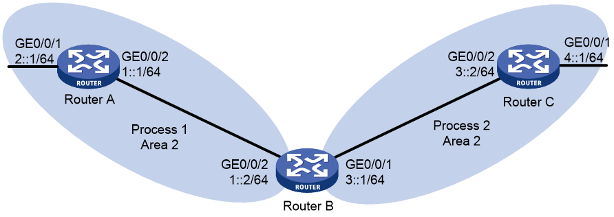

Example: Configuring OSPFv3 route redistribution
As shown in Figure 8:
·     Router A, Router B, and Router C are in Area 2.
·     OSPFv3 process 1 and OSPFv3 process 2 run on Router B. Router B communicates with Router A and Router C through OSPFv3 process 1 and OSPFv3 process 2.
·     Configure OSPFv3 process 2 to redistribute direct routes and the routes from OSPFv3 process 1 on Router B, and set the metric for redistributed routes to 3. Router C can then learn the routes destined for 1::0/64 and 2::0/64, and Router A cannot learn the routes destined for 3::0/64 or 4::0/64.
Figure 8 Network diagram
# Enable OSPFv3 process 1 on Router A.
[RouterA] ospfv3 1
[RouterA-GigabitEthernet0/0/2] ospfv3 1 area 2
[RouterA-GigabitEthernet0/0/1] ospfv3 1 area 2
# Enable OSPFv3 process 1 and OSPFv3 process 2 on Router B.
[RouterB] ospfv3 1
[RouterB-GigabitEthernet0/0/2] ospfv3 1 area 2
[RouterB] ospfv3 2
[RouterB-ospfv3-2] router-id 3.3.3.3
[RouterB-ospfv3-2] quit
[RouterB-GigabitEthernet0/0/1] ospfv3 2 area 2
# Enable OSPFv3 process 2 on Router C.
[RouterC] ospfv3 2
[RouterC-ospfv3-2] router-id 4.4.4.4
[RouterC-ospfv3-2] quit
[RouterC-GigabitEthernet0/0/2] ospfv3 2 area 2
[RouterC-GigabitEthernet0/0/1] ospfv3 2 area 2
# Display the routing table on Router C.
[RouterC] display ipv6 routing-table
Destinations : 7 Routes : 7
Destination: ::1/128                                     Protocol  : Direct
NextHop    : ::1                                         Preference: 0
Interface  : InLoop0                                     Cost      : 0
Destination: 3::/64                                      Protocol  : Direct
NextHop    : ::                                          Preference: 0
Interface  : GE1/0/2                                     Cost      : 0
Destination: 3::2/128                                    Protocol  : Direct
Destination: 4::/64                                      Protocol  : Direct
Interface  : GE1/0/1                                     Cost      : 0
Destination: 4::1/128                                    Protocol  : Direct
Destination: FE80::/10                                   Protocol  : Direct
Interface  : NULL0                                       Cost      : 0
Destination: FF00::/8                                    Protocol  : Direct
3.     Configure OSPFv3 route redistribution:
# Configure OSPFv3 process 2 to redistribute direct routes and the routes from OSPFv3 process 1 on Router B, and set the metric for redistributed routes to 3.
[RouterB] ospfv3 2
[RouterB-ospfv3-2] import-route ospfv3 1 cost 3
[RouterB-ospfv3-2] import-route direct cost 3
Destinations : 9 Routes : 9
Destination: 1::/64                                      Protocol  : O_ASE2
NextHop    : FE80::200:CFF:FE01:1C03                     Preference: 150
Interface  : GE1/0/2                                     Cost      : 3
Destination: 2::/64                                      Protocol  : O_ASE2

Example: Configuring OSPFv3 route summarization
As shown in Figure 9:
·     OSPFv3 process 1 and OSPFv3 process 2 run on Router B. Router B communicates with Router A and Router C through OSPFv3 process 1 and OSPFv3 process 2, respectively.
·     On Router A, configure IPv6 addresses 2:1:1::1/64, 2:1:2::1/64, and 2:1:3::1/64 for GigabitEthernet 0/0/1.
·     On Router B, configure OSPFv3 process 2 to redistribute direct routes and the routes from OSPFv3 process 1. Router C can then learn the routes destined for 2::/64, 2:1:1::/64, 2:1:2::/64, and 2:1:3::/64.
·     On Router B, configure route summarization to advertise only summary route 2::/16 to Router C.
Figure 9 Network diagram
2.     Configure OSPFv3:
[RouterA] ospfv3 1
[RouterA-GigabitEthernet0/0/1] ipv6 address 2:1:1::1 64
[RouterA-GigabitEthernet0/0/1] ipv6 address 2:1:2::1 64
[RouterA-GigabitEthernet0/0/1] ipv6 address 2:1:3::1 64
[RouterB] ospfv3 1
[RouterB] ospfv3 2
[RouterC] ospfv3 2
# Configure OSPFv3 process 2 to redistribute direct routes and the routes from OSPFv3 process 1 on Router B.
[RouterB] ospfv3 2
Destinations : 12 Routes : 12
Interface  : GE1/0/2                                     Cost      : 1
Destination: 2:1:1::/64                                  Protocol  : O_ASE2
Destination: 2:1:2::/64                                  Protocol  : O_ASE2
Destination: 2:1:3::/64                                  Protocol  : O_ASE2
NextHop    : 3::2                                        Preference: 0
NextHop    : 4::1                                        Preference: 0

Example: Configuring OSPFv3 IPsec profile
As shown in Figure 14, all routers run OSPFv3, and the AS is divided into two areas.
Configure IPsec profiles on the routers to authenticate OSPFv3 packets.
Figure 14 Network diagram
2.     Configure OSPFv3 basic features:
[RouterA] ospfv3 1
[RouterB] ospfv3 1
[RouterC] ospfv3 1
3.     Configure OSPFv3 IPsec profiles:
¡     On Router A:
# Create an IPsec transform set named trans.
[RouterA] ipsec transform-set trans
# Specify the encapsulation mode as transport.
[RouterA-ipsec-transform-set-trans] encapsulation-mode transport
# Specify the ESP encryption and authentication algorithms.
[RouterA-ipsec-transform-set-trans] protocol esp
[RouterA-ipsec-transform-set-trans] esp encryption-algorithm aes-cbc-128
[RouterA-ipsec-transform-set-trans] esp authentication-algorithm sha1
[RouterA-ipsec-transform-set-trans] quit
# Create a manual IPsec profile named profile001.
[RouterA] ipsec profile profile001 manual
# Use IPsec transform set trans.
[RouterA-ipsec-profile-manual-profile001] transform-set trans
# Configure the inbound and outbound SPIs for ESP.
[RouterA-ipsec-profile-manual-profile001] sa spi outbound esp 123456
[RouterA-ipsec-profile-manual-profile001] sa spi inbound esp 123456
# Configure the inbound and outbound SA keys for ESP.
[RouterA-ipsec-profile-manual-profile001] sa string-key outbound esp simple abcdefg
[RouterA-ipsec-profile-manual-profile001] sa string-key inbound esp simple abcdefg
[RouterA-ipsec-profile-manual-profile001] quit
¡     On Router B:
[RouterB] ipsec transform-set trans
[RouterB-ipsec-transform-set-trans] encapsulation-mode transport
[RouterB-ipsec-transform-set-trans] protocol esp
[RouterB-ipsec-transform-set-trans] esp encryption-algorithm aes-cbc-128
[RouterB-ipsec-transform-set-trans] esp authentication-algorithm sha1
[RouterB-ipsec-transform-set-trans] quit
[RouterB] ipsec profile profile001 manual
[RouterB-ipsec-profile-manual-profile001] transform-set trans
[RouterB-ipsec-profile-manual-profile001] sa spi outbound esp 123456
[RouterB-ipsec-profile-manual-profile001] sa spi inbound esp 123456
[RouterB-ipsec-profile-manual-profile001] sa string-key outbound esp simple abcdefg
[RouterB-ipsec-profile-manual-profile001] sa string-key inbound esp simple abcdefg
[RouterB-ipsec-profile-manual-profile001] quit
# Create a manual IPsec profile named profile002.
[RouterB] ipsec profile profile002 manual
[RouterB-ipsec-profile-manual-profile002] transform-set trans
[RouterB-ipsec-profile-manual-profile002] sa spi outbound esp 256
[RouterB-ipsec-profile-manual-profile002] sa spi inbound esp 256
[RouterB-ipsec-profile-manual-profile002] sa string-key outbound esp simple byebye
[RouterB-ipsec-profile-manual-profile002] sa string-key inbound esp simple byebye
[RouterB-ipsec-profile-manual-profile002] quit
¡     On Router C:
[RouterC] ipsec transform-set trans
[RouterC-ipsec-transform-set-trans] encapsulation-mode transport
[RouterC-ipsec-transform-set-trans] protocol esp
[RouterC-ipsec-transform-set-trans] esp encryption-algorithm aes-cbc-128
[RouterC-ipsec-transform-set-trans] esp authentication-algorithm sha1
[RouterC-ipsec-transform-set-trans] quit
[RouterC] ipsec profile profile002 manual
[RouterC-ipsec-profile-manual-profile002] transform-set trans
[RouterC-ipsec-profile-manual-profile002] sa spi outbound esp 256
[RouterC-ipsec-profile-manual-profile002] sa spi inbound esp 256
[RouterC-ipsec-profile-manual-profile002] sa string-key outbound esp simple byebye
[RouterC-ipsec-profile-manual-profile002] sa string-key inbound esp simple byebye
[RouterC-ipsec-profile-manual-profile002] quit
4.     Apply the IPsec profiles to OSPFv3 areas:
[RouterA] ospfv3 1
[RouterA-ospfv3-1-area-0.0.0.1] enable ipsec-profile profile001
[RouterB] ospfv3 1
[RouterB-ospfv3-1] area 0
[RouterB-ospfv3-1-area-0.0.0.0] enable ipsec-profile profile002
[RouterB-ospfv3-1-area-0.0.0.0] quit
[RouterB-ospfv3-1-area-0.0.0.1] enable ipsec-profile profile001
# Configure Router C.
[RouterC] ospfv3 1
[RouterC-ospfv3-1] area 0
[RouterC-ospfv3-1-area-0.0.0.0] enable ipsec-profile profile002
[RouterC-ospfv3-1-area-0.0.0.0] quit
# Verify that OSPFv3 packets between Routers A, B, and C are protected by IPsec. (Details not shown.)
