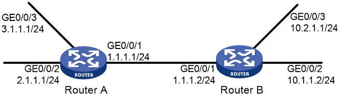

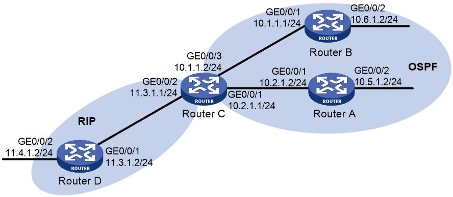

As shown in Figure 3, enable RIPv2 on all interfaces on Router A and Router B. Configure Router B to not advertise route 10.2.1.0/24 to Router A, and to accept only route 2.1.1.0/24 from Router A.
Figure 3 Network diagram
1.     Configure IP addresses for the interfaces. (Details not shown.)
2.     Enable RIP.
# Enable RIP on the specified networks on Router A.
<RouterA> system-view
[RouterA] rip
[RouterA-rip-1] network 1.0.0.0
[RouterA-rip-1] network 2.0.0.0
[RouterA-rip-1] network 3.0.0.0
[RouterA-rip-1] quit
# Enable RIP on the specified interfaces on Router B.
<RouterB> system-view
[RouterB] rip
[RouterB-rip-1] quit
[RouterB] interface gigabitethernet 0/0/1
[RouterB-GigabitEthernet0/0/1] rip 1 enable
[RouterB-GigabitEthernet0/0/1] quit
[RouterB] interface gigabitethernet 0/0/2
[RouterB-GigabitEthernet0/0/2] rip 1 enable
[RouterB-GigabitEthernet0/0/2] quit
[RouterB] interface gigabitethernet 0/0/3
[RouterB-GigabitEthernet0/0/3] rip 1 enable
[RouterB-GigabitEthernet0/0/3] quit
# Display the RIP routing table on Router A.
[RouterA] display rip 1 route
 Route Flags: R - RIP, T - TRIP
              P - Permanent, A - Aging, S - Suppressed, G - Garbage-collect
              D - Direct, O - Optimal, F - Flush to RIB
 Peer 1.1.1.2 on GigabitEthernet0/0/1
      Destination/Mask        Nexthop           Cost    Tag     Flags   Sec
      10.0.0.0/8              1.1.1.2           1       0       RAOF    9
 Local route
      1.1.1.0/24              0.0.0.0           0       0       RDOF    -
      2.1.1.0/24              0.0.0.0           0       0       RDOF    -
      3.1.1.0/24              0.0.0.0           0       0       RDOF    -
The output shows that RIPv1 uses natural masks to advertise routing information.

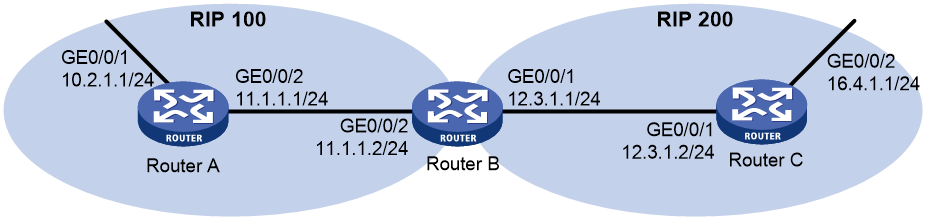

Example: Configuring RIP route redistribution
As shown in Figure 4, Router B communicates with Router A through RIP 100 and with Router C through RIP 200.
Configure RIP 200 to redistribute direct routes and routes from RIP 100 on Router B so Router C can learn routes destined for 10.2.1.0/24 and 11.1.1.0/24. Router A cannot learn routes destined for 12.3.1.0/24 and 16.4.1.0/24.
2.     Configure basic RIP settings:
# Enable RIP 100, and configure RIPv2 on Router A.
[RouterA] rip 100
[RouterA-rip-100] network 10.0.0.0
[RouterA-rip-100] network 11.0.0.0
[RouterA-rip-100] version 2
[RouterA-rip-100] undo summary
[RouterA-rip-100] quit
# Enable RIP 100 and RIP 200, and configure RIPv2 on Router B.
[RouterB] rip 100
[RouterB-rip-100] network 11.0.0.0
[RouterB-rip-100] version 2
[RouterB-rip-100] undo summary
[RouterB-rip-100] quit
[RouterB] rip 200
[RouterB-rip-200] network 12.0.0.0
[RouterB-rip-200] version 2
[RouterB-rip-200] undo summary
[RouterB-rip-200] quit
# Enable RIP 200, and configure RIPv2 on Router C.
<RouterC> system-view
[RouterC] rip 200
[RouterC-rip-200] network 12.0.0.0
[RouterC-rip-200] network 16.0.0.0
[RouterC-rip-200] version 2
[RouterC-rip-200] undo summary
[RouterC-rip-200] quit
# Display the IP routing table on Router C.
[RouterC] display ip routing-table
Destinations : 16        Routes : 16
0.0.0.0/32          Direct 0    0            127.0.0.1       InLoop0
12.3.1.0/24         Direct 0    0            12.3.1.2        GE0/0/1
12.3.1.0/32         Direct 0    0            12.3.1.2        GE0/0/1
12.3.1.2/32         Direct 0    0            127.0.0.1       InLoop0
12.3.1.255/32       Direct 0    0            12.3.1.2        GE0/0/1
16.4.1.0/24         Direct 0    0            16.4.1.1        GE0/0/2
16.4.1.0/32         Direct 0    0            16.4.1.1        GE0/0/2
16.4.1.1/32         Direct 0    0            127.0.0.1       InLoop0
16.4.1.255/32       Direct 0    0            16.4.1.1        GE0/0/2
127.0.0.0/8         Direct 0    0            127.0.0.1       InLoop0
127.0.0.0/32        Direct 0    0            127.0.0.1       InLoop0
127.0.0.1/32        Direct 0    0            127.0.0.1       InLoop0
127.255.255.255/32  Direct 0    0            127.0.0.1       InLoop0
224.0.0.0/4         Direct 0    0            0.0.0.0         NULL0
224.0.0.0/24        Direct 0    0            0.0.0.0         NULL0
255.255.255.255/32  Direct 0    0            127.0.0.1       InLoop0
3.     Configure RIP route redistribution:
# Configure RIP 200 to redistribute direct routes and routes from RIP 100 on Router B.
[RouterB] rip 200
[RouterB-rip-200] import-route rip 100
[RouterB-rip-200] import-route direct
Destinations : 15        Routes : 15
10.2.1.0/24         RIP    100  1            12.3.1.1        GE0/0/1
11.1.1.0/24         RIP    100  1            12.3.1.1        GE0/0/1

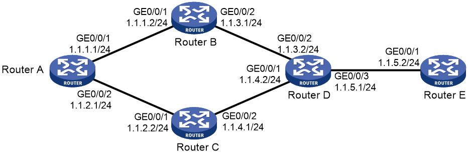

Example: Configuring an additional metric for a RIP interface
As shown in Figure 5, run RIPv2 on all the interfaces of Router A, Router B, Router C, Router D, and Router E.
Router A has two links to Router D. The link from Router B to Router D is more stable than that from Router C to Router D. Configure an additional metric for RIP routes received from GigabitEthernet 0/0/2 on Router A so Router A prefers route 1.1.5.0/24 learned from Router B.
Figure 5 Network diagram
1.     Configure IP addresses for the the interfaces. (Details not shown.)
# Configure Router A.
[RouterA] rip
[RouterA-rip-1] version 2
[RouterA-rip-1] undo summary
# Configure Router B.
[RouterB] rip
[RouterB-rip-1] network 1.0.0.0
[RouterB-rip-1] version 2
[RouterB-rip-1] undo summary
# Configure Router C.
[RouterC] rip
[RouterC-rip-1] network 1.0.0.0
[RouterC-rip-1] version 2
[RouterC-rip-1] undo summary
# Configure Router D.
<RouterD> system-view
[RouterD] rip
[RouterD-rip-1] network 1.0.0.0
[RouterD-rip-1] version 2
[RouterD-rip-1] undo summary
# Configure Router E.
<RouterE> system-view
[RouterE] rip
[RouterE-rip-1] network 1.0.0.0
[RouterE-rip-1] version 2
[RouterE-rip-1] undo summary
# Display all active routes in the RIP database on Router A.
[RouterA] display rip 1 database
   1.0.0.0/8, auto-summary
       1.1.1.0/24, cost 0, nexthop 1.1.1.1, RIP-interface
       1.1.2.0/24, cost 0, nexthop 1.1.2.1, RIP-interface
       1.1.3.0/24, cost 1, nexthop 1.1.1.2
       1.1.4.0/24, cost 1, nexthop 1.1.2.2
       1.1.5.0/24, cost 2, nexthop 1.1.1.2
       1.1.5.0/24, cost 2, nexthop 1.1.2.2
The output shows two RIP routes destined for network 1.1.5.0/24. The next hops of the routes are Router B (1.1.1.2) and Router C (1.1.2.2). The cost of the routes is 2.

Example: Configuring RIP to advertise a summary route
As shown in Figure 6, Router A and Router B run OSPF, Router D runs RIP, and Router C runs OSPF and RIP.
·     Configure RIP to redistribute OSPF routes on Router C so Router D can learn routes destined for networks 10.1.1.0/24, 10.2.1.0/24, 10.5.1.0/24, and 10.6.1.0/24.
·     To reduce the routing table size of Router D, configure route summarization on Router C to advertise only the summary route 10.0.0.0/8 to Router D.
Figure 6 Network diagram
2.     Configure basic OSPF settings:
[RouterA] ospf
[RouterA-ospf-1] area 0
[RouterA-ospf-1-area-0.0.0.0] network 10.5.1.0 0.0.0.255
[RouterA-ospf-1-area-0.0.0.0] network 10.2.1.0 0.0.0.255
[RouterA-ospf-1-area-0.0.0.0] quit
[RouterB] ospf
[RouterB-ospf-1] area 0
[RouterB-ospf-1-area-0.0.0.0] network 10.1.1.0 0.0.0.255
[RouterB-ospf-1-area-0.0.0.0] network 10.6.1.0 0.0.0.255
[RouterB-ospf-1-area-0.0.0.0] quit
[RouterC] ospf
[RouterC-ospf-1] area 0
[RouterC-ospf-1-area-0.0.0.0] network 10.1.1.0 0.0.0.255
[RouterC-ospf-1-area-0.0.0.0] network 10.2.1.0 0.0.0.255
[RouterC-ospf-1-area-0.0.0.0] quit
[RouterC-ospf-1] quit
3.     Configure basic RIP settings:
[RouterC] rip 1
[RouterC-rip-1] network 11.3.1.0
[RouterD] rip 1
[RouterD-rip-1] network 11.0.0.0
[RouterD-rip-1] quit
# Configure RIP to redistribute routes from OSPF process 1 and direct routes on Router C.
[RouterC-rip-1] import-route direct
[RouterC-rip-1] import-route ospf 1
[RouterC-rip-1] quit
# Display the IP routing table on Router D.
[RouterD] display ip routing-table
10.1.1.0/24         RIP    100  1            11.3.1.1        GE0/0/1
10.2.1.0/24         RIP    100  1            11.3.1.1        GE0/0/1
10.5.1.0/24         RIP    100  1            11.3.1.1        GE0/0/1
10.6.1.0/24         RIP    100  1            11.3.1.1        GE0/0/1
11.3.1.0/24         Direct 0    0            11.3.1.2        GE0/0/1
11.3.1.0/32         Direct 0    0            11.3.1.2        GE0/0/1
11.3.1.2/32         Direct 0    0            127.0.0.1       InLoop0
11.4.1.0/24         Direct 0    0            11.4.1.2        GE0/0/2
11.4.1.0/32         Direct 0    0            11.4.1.2        GE0/0/2
11.4.1.2/32         Direct 0    0            127.0.0.1       InLoop0
4.     Configure route summarization:
# Configure route summarization on Router C to advertise only the summary route 10.0.0.0/8.
[RouterC] interface gigabitethernet 0/0/2
[RouterC-GigabitEthernet0/0/2] rip summary-address 10.0.0.0 8
Destinations : 12        Routes : 12
10.0.0.0/8          RIP    100  1            11.3.1.1        GE0/0/1
Example: Configuring RIP GR
As shown in Figure 7, Router A, Router B, and Router C run RIPv2.
·     Enable GR on Router A. Router A acts as the GR restarter.
·     Router B and Router C act as GR helpers to synchronize their routing tables with Router A by using GR.
Figure 7 Network diagram
1.     Configure IP addresses and subnet masks for the interfaces on the routers. (Details not shown.)
2.     Configure RIPv2 on the routers to ensure the following: (Details not shown.)
¡     Router A, Router B, and Router C can communicate with each other at Layer 3.
¡     Dynamic route update can be implemented among them with RIPv2.
3.     Enable RIP GR on Router A.
[RouterA] rip
[RouterA-rip-1] graceful-restart
# Restart RIP or trigger an active/standby process switchover, and then display GR status on Router A.
<RouterA> display rip graceful-restart
 RIP process: 1
 Graceful Restart capability     : Enabled
 Current GR state                : Normal
 Graceful Restart period         : 60  seconds
 Graceful Restart remaining time : 0   seconds

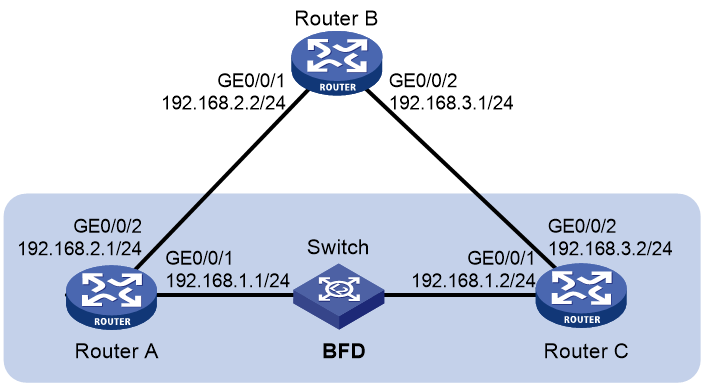

Example: Configuring BFD for RIP (single-hop echo detection for a directly connected neighbor)
As shown in Figure 9, GigabitEthernet 0/0/1 of Router A and Router C runs RIP process 1. GigabitEthernet 0/0/2 of Router A runs RIP process 2. GigabitEthernet 0/0/2 of Router C and GigabitEthernet 0/0/1 and GigabitEthernet 0/0/2 of Router B run RIP process 1.
·     Configure a static route destined for 100.1.1.1/24 and enable static route redistribution into RIP on Router C. This allows Router A to learn two routes destined for 100.1.1.1/24 through GigabitEthernet 0/0/1 and GigabitEthernet 0/0/2 respectively, and uses the one through GigabitEthernet 0/0/1.
·     Enable BFD for RIP on GigabitEthernet 0/0/1 of Router A. When the link over GigabitEthernet 0/0/1 fails, BFD can quickly detect the failure and notify RIP. RIP deletes the neighbor relationship and route information learned on GigabitEthernet 0/0/1, and uses the route destined for 100.1.1.1 24 through GigabitEthernet 0/0/2.
Figure 9 Network diagram
1.     Configure IP addresses for interfaces. (Details not shown.)
[RouterA] rip 1
[RouterA-rip-1] network 192.168.1.0
[RouterA] rip 2
[RouterA-rip-2] network 192.168.2.0
[RouterA-rip-2] quit
[RouterB] rip 1
[RouterB-rip-1] network 192.168.2.0
[RouterB-rip-1] network 192.168.3.0
[RouterC] rip 1
[RouterC-rip-1] network 192.168.1.0
[RouterC-rip-1] network 192.168.3.0
[RouterC-rip-1] import-route static
3.     Enable BFD and configure BFD parameters on Router A.
[RouterA] bfd echo-source-ip 11.11.11.11
[RouterA] interface gigabitethernet 0/0/1
[RouterA-GigabitEthernet0/0/1] rip bfd enable
[RouterA-GigabitEthernet0/0/1] bfd min-echo-receive-interval 500
[RouterA-GigabitEthernet0/0/1] bfd detect-multiplier 7
[RouterA-GigabitEthernet0/0/1] quit
4.     Configure a static route on Router C.
[RouterC] ip route-static 120.1.1.1 24 null 0
# Display the BFD session information on Router A.
<RouterA> display bfd session
 Total sessions: 1        Up sessions: 1        Init mode: Active
 IPv4 session working in echo mode:
 LD               SourceAddr      DestAddr        State Running Up for Holdtime
   Interface
 4                192.168.1.1     192.168.1.2     Up    00:04:19       2000ms
   GE0/0/1
# Display RIP routes destined for 120.1.1.0/24 on Router A.
<RouterA> display ip routing-table 120.1.1.0 24
Summary count : 1
Destination/Mask   Proto   Pre Cost        NextHop         Interface
120.1.1.0/24       RIP     100 1           192.168.1.2     GE0/0/1
The output shows that Router A communicates with Router C through GigabitEthernet 0/0/1. Then the link over GigabitEthernet 0/0/1 fails.
Summary count : 1
120.1.1.0/24       RIP     100 2           192.168.2.2     GE0/0/2
The output shows that Router A communicates with Router C through GigabitEthernet 0/0/2.

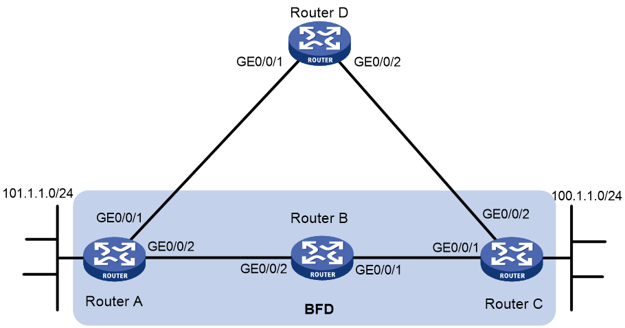

Example: Configuring BFD for RIP (single-hop echo detection for a specific destination)
As shown in Figure 10, GigabitEthernet 0/0/2 of Router A and GigabitEthernet 0/0/1 of Router B run RIP process 1. GigabitEthernet 0/0/2 of Router B and Router C runs RIP process 1.
·     Configure a static route destined for 100.1.1.0/24 and enable static route redistribution into RIP on both Router A and Router C. This allows Router B to learn two routes destined for 100.1.1.0/24 through GigabitEthernet 0/0/1 and GigabitEthernet 0/0/2. The route redistributed from Router A has a smaller cost than that redistributed from Router C, so Router B uses the route through GigabitEthernet 0/0/1.
·     Enable BFD for RIP on GigabitEthernet 0/0/2 of Router A, and specify GigabitEthernet 0/0/1 of Router B as the destination. When a unidirectional link occurs between Router A and Router B, BFD can quickly detect the link failure and notify RIP. RIP then deletes the neighbor relationship and the route information learned on GigabitEthernet 0/0/2. It does not receive or send any packets on GigabitEthernet 0/0/2. When the route learned from Router A ages out, Router B uses the route destined for 100.1.1.1/24 through GigabitEthernet 0/0/2.
Figure 10 Network diagram
[RouterA] rip 1
[RouterA-rip-1] network 192.168.2.0
[RouterA-rip-1] import-route static
[RouterB] rip 1
[RouterC] rip 1
[RouterC-rip-1] import-route static cost 3
[RouterA] interface gigabitethernet 0/0/2
[RouterA-GigabitEthernet0/0/2] rip bfd enable destination 192.168.2.2
[RouterA-GigabitEthernet0/0/2] bfd min-echo-receive-interval 500
[RouterA-GigabitEthernet0/0/2] quit
4.     Configure static routes:
# Configure a static route on Router A.
[RouterA] ip route-static 100.1.1.0 24 null 0
# Configure a static route on Router C.
[RouterC] ip route-static 100.1.1.0 24 null 0
   Interface
 3                192.168.2.1     192.168.2.2     Up    00:04:19       2000ms
   GE0/0/2
# Display routes destined for 100.1.1.0/24 on Router B.
<RouterB> display ip routing-table 100.1.1.0 24 verbose
Summary count : 1
Destination: 100.1.1.0/24
   Protocol: RIP
  Process ID: 1
   SubProtID: 0x1                        Age: 00h02m47s
        Cost: 1                   Preference: 100
       IpPre: N/A                 QosLocalID: N/A
         Tag: 0                        State: Active Adv
   OrigTblID: 0x0                    OrigVrf: default-vrf
     TableID: 0x2                     OrigAs: 0
       NibID: 0x12000002              LastAs: 0
      AttrID: 0xffffffff            Neighbor: 192.168.2.1
       Flags: 0x1008c            OrigNextHop: 192.168.2.1
       Label: NULL               RealNextHop: 192.168.2.1
     BkLabel: NULL                 BkNextHop: N/A
     SRLabel: NULL                 Interface: GigabitEthernet0/0/1
   BkSRLabel: NULL               BkInterface: N/A
   Tunnel ID: Invalid            IPInterface: GigabitEthernet0/0/1
 BkTunnel ID: Invalid          BKIPInterface: N/A
     InLabel: NULL            ColorInterface: N/A
    SIDIndex: NULL          BKColorInterface: N/A
    FtnIndex: 0x0            TunnelInterface: N/A
TrafficIndex: N/A          BKTunnelInterface: N/A
   Connector: N/A                     PathID: 0x0
  SRTunnelID: Invalid
    SID Type: N/A                        NID: Invalid
    FlushNID: Invalid                  BkNID: Invalid
  BkFlushNID: Invalid              StatFlags: 0x0
         Exp: N/A
   VpnPeerId: N/A                       Dscp: N/A
         SID: N/A           OrigLinkID: 0x0
       BkSID: N/A           RealLinkID: 0x0
CommBlockLen: 0
# Display routes destined for 100.1.1.0/24 on Router B when the link between Router A and Router B fails.
Summary count : 1
   Protocol: RIP
  Process ID: 1
   SubProtID: 0x1                        Age: 00h21m23s
        Cost: 4                   Preference: 100
       NibID: 0x12000003              LastAs: 0
      AttrID: 0xffffffff            Neighbor: 192.168.3.2
       Flags: 0x1008c            OrigNextHop: 192.168.3.2
       Label: NULL               RealNextHop: 192.168.3.2
     SRLabel: NULL                 Interface: GigabitEthernet0/0/2
   Tunnel ID: Invalid            IPInterface: GigabitEthernet0/0/2
  SRTunnelID: Invalid
         Exp: N/A
CommBlockLen: 0

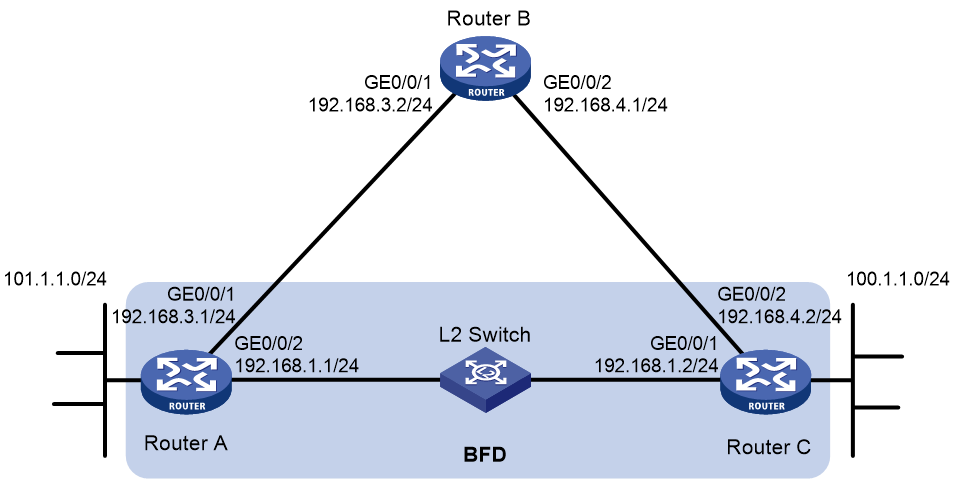

Example: Configuring BFD for RIP (bidirectional control detection for an indirectly connected neighbor)
As shown in Figure 11, GigabitEthernet 0/0/2 of Router A and GigabitEthernet 0/0/1 of Router C run RIP process 1. GigabitEthernet 0/0/1 on Router A runs RIP process 2. GigabitEthernet 0/0/2 on Router C, and GigabitEthernet 0/0/1 and GigabitEthernet 0/0/2 on Router D run RIP process 1.
·     Configure a static route destined for 100.1.1.0/24 on Router A.
·     Configure a static route destined for 101.1.1.0/24 on Router C.
·     Enable static route redistribution into RIP on Router A and Router C. This allows Router A to learn two routes destined for 100.1.1.0/24 through GigabitEthernet 0/0/2 and GigabitEthernet 0/0/1. It uses the route through GigabitEthernet 0/0/2.
·     Enable BFD for RIP on GigabitEthernet 0/0/2 of Router A and GigabitEthernet 0/0/1 of Router C.
When the link over GigabitEthernet 0/0/2 fails, BFD can quickly detect the link failure and notify RIP. RIP deletes the neighbor relationship and the route information learned on GigabitEthernet 0/0/2, and uses the route destined for 100.1.1.0/24 through GigabitEthernet 0/0/1.
Figure 11 Network diagram
2.     Configure basic RIP settings and enable static route redistribution into RIP so Router A and Router C have routes to send to each other:
[RouterA] rip 1
[RouterA-rip-1] network 101.1.1.0
[RouterA-rip-1] peer 192.168.2.2
[RouterA-rip-1] undo validate-source-address
[RouterA] rip 2
[RouterA-rip-2] version 2
[RouterA-rip-2] undo summary
[RouterA-rip-2] network 192.168.3.0
[RouterC] rip 1
[RouterC-rip-1] network 192.168.2.0
[RouterC-rip-1] network 192.168.4.0
[RouterC-rip-1] network 100.1.1.0
[RouterC-rip-1] peer 192.168.1.1
[RouterC-rip-1] undo validate-source-address
[RouterD] rip 1
[RouterD-rip-1] network 192.168.3.0
[RouterD-rip-1] network 192.168.4.0
3.     Configure BFD settings:
# Enable BFD and configure BFD parameters on Router A.
[RouterA] bfd session init-mode active
[RouterA-GigabitEthernet0/0/2] bfd min-transmit-interval 500
[RouterA-GigabitEthernet0/0/2] bfd min-receive-interval 500
[RouterA-GigabitEthernet0/0/2] bfd detect-multiplier 7
# Enable BFD and configure BFD parameters on Router C.
[RouterC] bfd session init-mode active
[RouterC] interface gigabitethernet 0/0/1
[RouterC-GigabitEthernet0/0/1] rip bfd enable
[RouterC-GigabitEthernet0/0/1] bfd min-transmit-interval 500
[RouterC-GigabitEthernet0/0/1] bfd min-receive-interval 500

Example: Configuring BFD for RIP (bidirectional control detection for a directly connected neighbor)
As shown in Figure 12, GigabitEthernet 0/0/2 of Router A and GigabitEthernet 0/0/1 of Router C run RIP process 1. GigabitEthernet 0/0/1 on Router A runs RIP process 2. GigabitEthernet 0/0/2 on Router C, and GigabitEthernet 0/0/1 and GigabitEthernet 0/0/2 on Router B run RIP process 1.
When link Router A—L2 Switch—Router C fails, BFD can quickly detect the link failure and notify RIP. RIP immediately switches to the Router A—Router B—Router C.
Figure 12 Network diagram
[RouterA] rip 1
[RouterA] rip 2
[RouterB] rip 1
[RouterB-rip-1] network 192.168.4.0
[RouterC] rip 1
[RouterA-GigabitEthernet0/0/2] rip bfd enable ctrl
[RouterC-GigabitEthernet0/0/1] rip bfd enable ctrl
[RouterC-GigabitEthernet0/0/1] bfd detect-multiplier 6
[RouterC-GigabitEthernet0/0/1] quit
[RouterA] display bfd session
 IPv4 session working in control mode:
 LD/RD            SourceAddr      DestAddr        State Running Up for Holdtime
   Interface
 513/513          192.168.1.1     192.168.1.2     Up    00:04:19       1700ms
   GE0/0/2
# Display RIP routes destined for 100.1.1.0/24 learned on Router A.
[RouterA] display ip routing-table 100.1.1.0 24
Summary count : 1
100.1.1.0/24       RIP     100 1           192.168.1.2     GE0/0/2
The output shows that Router A communicates with Router C through L2 Switch.
# When Router A—L2 Switch—Router C fails, display RIP routes destined for 100.1.1.0/24 on Router A.
Summary count : 1
100.1.1.0/24       RIP     100 2           192.168.3.2     GE0/0/1
The output shows that Router A communicates with Router C through Router B.
Example: Configuring RIP FRR
As shown in Figure 13, Router A, Router B, and Router C run RIPv2. Configure RIP FRR so that when Link A becomes unidirectional, traffic can be switched to Link B immediately.
Figure 13 Network diagram
Device
Interface
IP address
Router A
12.12.12.1/24
Router A
13.13.13.1/24
Router A
Loopback 0
1.1.1.1/32
Router B
24.24.24.4/24
Router B
13.13.13.2/24
Router B
Loopback 0
4.4.4.4/32
Router C
12.12.12.2/24
Router C
24.24.24.2/24
2.     Configure RIPv2 on the routers to make sure Router A, Router B, and Router C can communicate with each other at the network layer. (Details not shown.)
