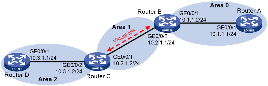

In practice, these requirements might not be met due to lack of physical links. OSPF virtual links can solve this issue.
Virtual links

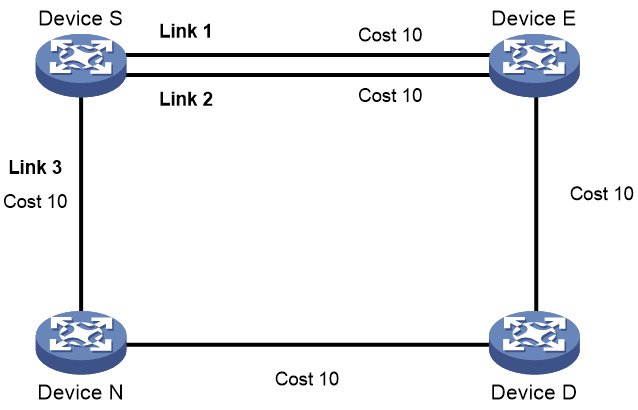

A virtual link is established between two ABRs through a non-backbone area. It must be configured on both ABRs to take effect. The non-backbone area is called a transit area.

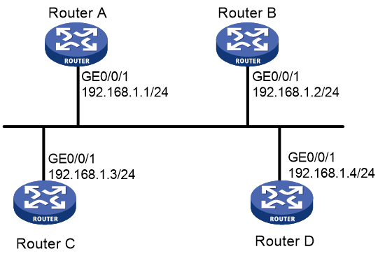

As shown in Figure 2, Area 2 has no direct physical link to the backbone Area 0. You can configure a virtual link between the two ABRs to connect Area 2 to the backbone area.
Figure 2 Virtual link application 1
Virtual links can also be used as redundant links. If a physical link failure breaks the internal connectivity of the backbone area, you can configure a virtual link to replace the failed physical link, as shown in Figure 3.
Figure 3 Virtual link application 2
The virtual link between the two ABRs acts as a point-to-point connection. You can configure interface parameters, such as hello interval, on the virtual link as they are configured on a physical interface.
The two ABRs on the virtual link unicast OSPF packets to each other, and the OSPF routers in between convey these OSPF packets as normal IP packets.

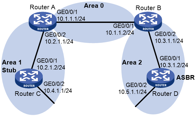

A stub area does not distribute Type-5 LSAs to reduce the routing table size and LSAs advertised within the area. The ABR of the stub area advertises a default route in a Type-3 LSA so that the routers in the area can reach external networks through the default route.
To further reduce the routing table size and advertised LSAs, you can configure the stub area as a totally stub area. The ABR of a totally stub area does not advertise inter-area routes or external routes. It advertises a default route in a Type-3 LSA so that the routers in the area can reach external networks through the default route.

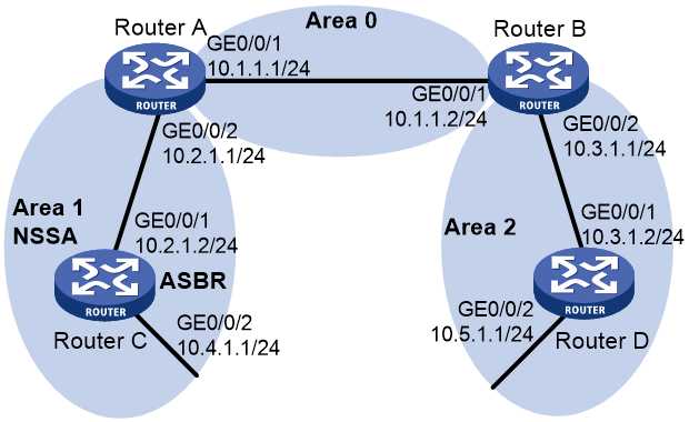

An NSSA area does not import AS external LSAs (Type-5 LSAs) but can import Type-7 LSAs generated by the NSSA ASBR. The NSSA ABR translates Type-7 LSAs into Type-5 LSAs and advertises the Type-5 LSAs to other areas.
As shown in Figure 4, the OSPF AS contains Area 1, Area 2, and Area 0. The other two ASs run RIP. Area 1 is an NSSA area where the ASBR redistributes RIP routes in Type-7 LSAs into Area 1. Upon receiving the Type-7 LSAs, the NSSA ABR translates them to Type-5 LSAs, and advertises the Type-5 LSAs to Area 0.
The ASBR of Area 2 redistributes RIP routes in Type-5 LSAs into the OSPF routing domain. However, Area 1 does not receive Type-5 LSAs because it is an NSSA area.

As shown in Figure 6, solid lines are Ethernet physical links, and dashed lines represent OSPF adjacencies. With the DR and BDR, only seven adjacencies are established.
Figure 6 DR and BDR in a network
In OSPF, neighbor and adjacency are different concepts. After startup, OSPF sends a hello packet on each OSPF interface. A receiving router checks parameters in the packet. If the parameters match its own, the receiving router considers the sending router an OSPF neighbor. Two OSPF neighbors establish an adjacency relationship after they synchronize their LSDBs through exchange of DD packets and LSAs.
DR and BDR election
DR election is performed on broadcast or NBMA networks but not on P2P and P2MP networks.
Routers in a broadcast or NBMA network elect the DR and BDR by router priority and ID. Routers with a router priority value higher than 0 are candidates for DR and BDR election.
The election votes are hello packets. Each router sends the DR elected by itself in a hello packet to all the other routers. If two routers on the network declare themselves as the DR, the router with the higher router priority wins. If router priorities are the same, the router with the higher router ID wins.
If a router with a higher router priority becomes active after DR and BDR election, the router cannot replace the DR or BDR until a new election is performed. Therefore, the DR of a network might not be the router with the highest priority, and the BDR might not be the router with the second highest priority.

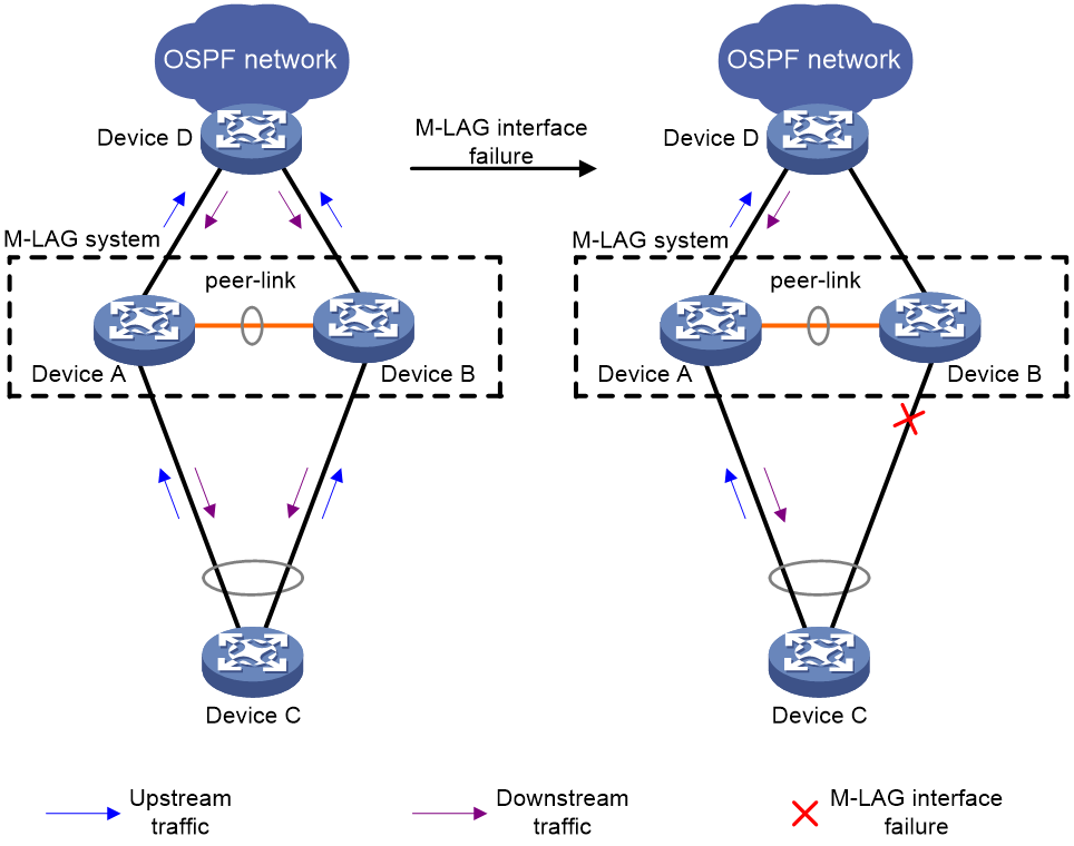

Establishing OSPF neighbor relationships on an M-LAG network
When a customer-side device accesses the OSPF network through both M-LAG member devices in an M-LAG system, the M-LAG member devices provide Layer 3 gateway services. The gateway interfaces (such as VLAN or VSI interfaces) on different M-LAG member devices might have the same IP address and the same MAC address. In this case, the M-LAG member devices cannot establish OSPF neighbor relationships with the customer-side device.
To resolve this issue, configure the gateway interfaces to use M-LAG virtual IPv4 addresses for OSPF neighbor relationship establishment. For more information about M-LAG, see M-LAG configuration in Layer 2—LAN Switching Configuration Guide.
As shown in Figure 9, Device C accesses the OSPF network through the M-LAG system that consists of Device A and Device B. Device A and Device B provide Layer 3 gateway services. The gateway interface VLAN-interface 100 on Device A and the gateway interface VLAN-interface 100 on Device B have the same IP address and the same MAC address. To ensure that both Device A and Device B can establish an OSPF neighbor relationship with Device C, perform the following tasks:
1.     Configure different M-LAG virtual IPv4 addresses for the VLAN interfaces on Device A and Device B.
2.     Configure the VLAN interface to use the M-LAG virtual IPv4 address for OSPF neighbor relationship establishment on both Device A and Device B.
Figure 9 OSPF neighbor relationship establishment on an M-LAG network
2.     Enter interface view.
3.     Configure an M-LAG virtual IPv4 address for the interface.
port m-lag virtual-ip ipv4-address { mask-length | mask }
By default, no M-LAG virtual IPv4 address is configured for an interface.
An M-LAG virtual IPv4 address is similar to a secondary IP address. For more information about this command, see M-LAG commands in Layer 2—LAN Switching Command Reference.
4.     Configure the interface to use the M-LAG virtual IPv4 address for OSPF neighbor relationship establishment.
ospf peer sub-address enable ip-address
By default, an interface uses the primary IP address for OSPF neighbor relationship establishment.
The IP address specified in this command must be the same as the IPv4 address specified in the port m-lag virtual-ip command.

Configuring a virtual link
You can configure a virtual link to maintain connectivity between a non-backbone area and the backbone, or in the backbone itself.
A virtual link cannot traverse a stub area, totally stub area, NSSA area, or totally NSSA area.
2.     Enter OSPF view.
ospf [ process-id | router-id { auto-select | router-id } | vpn-instance vpn-instance-name ] *
3.     Enter OSPF area view.
area area-id
4.     Configure a virtual link.
vlink-peer router-id [ dead seconds | hello seconds | { authentication-none | { hmac-md5 | hmac-sha-256 | hmac-sm3 | md5 } [ key-id { cipher | plain } string ] | keychain keychain-name | simple [ { cipher | plain } string ] } | retransmit seconds | trans-delay seconds ] *
Configure this command on both ends of a virtual link. The hello and dead intervals must be identical on both ends of the virtual link.

When a customer side device is dual-homed to an OSPF network through M-LAG, you can configure this feature to prevent the traffic from detouring through the M-LAG peer link. As shown in Figure 10, customer-side device Device C is dual-homed to the OSPF network through an M-LAG system formed by Device A and Device B. Device A and Device B share the traffic load between Device D and Device C. When the DR interface that connects Device B to Device C fails, the upstream traffic and downstream traffic are forwarded as follows:
·     Device C detects the M-LAG interface failure, and traffic from Device C to Device D is switched from path Device C->Device B->Device D to path Device C->Device A->Device D.
·     Device D cannot detect the M-LAG interface failure and still forwards traffic through Device B. Because the link between Device B and Device C fails, traffic from Device D to Device C is switched from path Device D->Device B->Device C to path Device D->Device B->Device A->Device C.
Figure 10 Traffic forwarding path after M-LAG interface failure
To prevent the downstream traffic from detouring through the M-LAG peer link, perform the following tasks on Device B:
1.     Execute the track interface command to create a track entry and associate it with the link state of the M-LAG interface. For more information about the track interface command, see track commands in High Availability Command Reference.
2.     Execute the ospf track adjust-cost command to associate the gateway interface with the track entry.
Then, Device B adjusts the cost of the gateway interface based on the state of the associated track entry:
·     When the M-LAG interface fails, the track entry state becomes negative, and OSPF increases the cost of the gateway interface. Then, traffic from Device D to Device C is switched to path Device D->Device A->Device C.
·     When the M-LAG interface recovers, the track entry state becomes positive, and OSPF restores the cost of the gateway interface to the original value. Then, traffic from Device D to Device C is switched back to path Device D->Device B->Device C.
Figure 11 Traffic forwarding path after associating OSPF with Track

OSPF might find multiple optimal equal-cost routes to the same destination, which can be used to share the traffic load. This task allows you to set the maximum number of ECMP routes for OSPF.
As shown in Figure 12, Device A and Device B run OSPF. There are three equal-cost routes between Device A and Device B. You can use these routes to implement load sharing.
Figure 12 Equal-cost routes

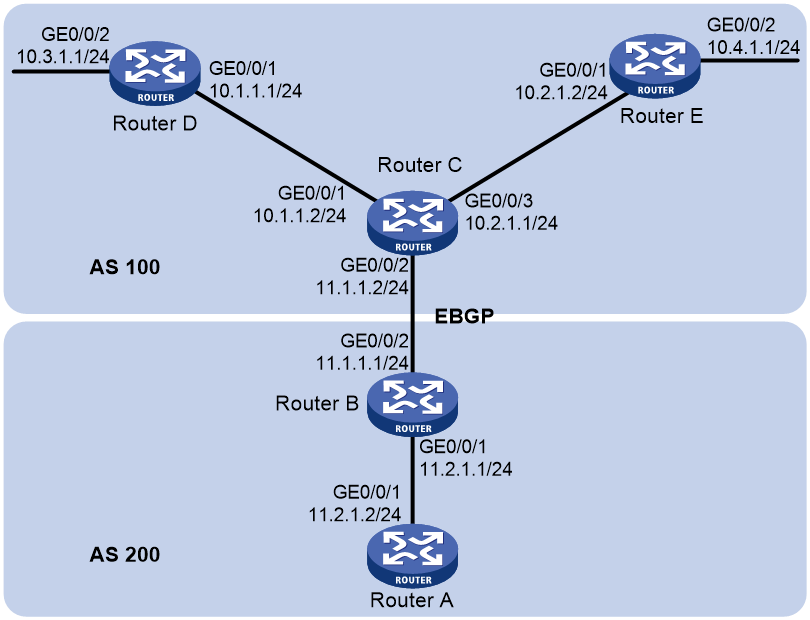

As shown in Figure 13, Device A, Device B, Device C, and Device D run OSPF. Device C is the backup device for Device B. Device A and Device B, Device A and Device C, Device B and Device D, and Device C and Device D are IBGP peers.
When the network is stable, BGP and OSPF can finish route convergence completely. Device A forwards traffic destined for 10.3.1.0/30 to Device B. If Device B fails, Device C will take over to forward the traffic from Device A.
After Device B recovers, Device A immediately forwards the traffic to Device B. However, BGP might have not finished route convergence after OSPF has finished route convergence, because OSPF has a higher route convergence speed than BGP. In this situation, Device B does not have a route to 10.3.1.0/30 and will discard the traffic destined for 10.3.1.0/30. To resolve this issue, configure Device B to act as a stub router during BGP route convergence. Device A will forward traffic to Device C instead of Device B until Device B finishes BGP route convergence.
Figure 13 Network diagram

Figure 14 Network diagram for OSPF FRR
As shown in Figure 14, configure OSPF FRR on Router B to calculate a backup next hop by using the LFA algorithm. When the primary link fails, OSPF directs packets to the backup next hop. At the same time, OSPF calculates the shortest path based on the new network topology. It forwards packets over the path after network convergence.

As shown in Figure 15, the traffic forwarding path is PE 1—P 1—P 2—PE 2. To avoid traffic loss caused by link failures between P 1 and P 2, the system establishes an LDP tunnel between P 1 and P 4, which is the PQ node. When the link between P 1 and P 2 fails, P 1 encapsulates IP packets in MPLS packets and sends the MPLS packets to P 4 through the LDP tunnel. After receiving the MPLS packets, P 4 removes the MPLS labels of the packets and then forwards the packets to the next hop based on the IP routing table.
The system determines P 4 as the PQ node as follows:
1.     Uses P 1 (source node of the protected link) and its neighbors except P 2 (which passes the protected link) as the roots to establish shortest path trees.
2.     Finds out all nodes that are reachable from P 1 or one of its neighbors without passing the protected link, which are PE 1, P 1, P 3, and P 4.
These nodes form the extended P space.
3.     Uses P 2 (destination node of the protected link) as the root to establish a reverse shortest path tree.
4.     Finds out all nodes that are reachable from P 2 without passing the protected link, which are PE 2 and P 4.
These nodes form the Q space.
5.     Finds out all nodes that reside in both the extended P space and the Q space.
Only P 4 resides in both the extended P space and the Q space, so P 4 is the PQ node of the protected link.

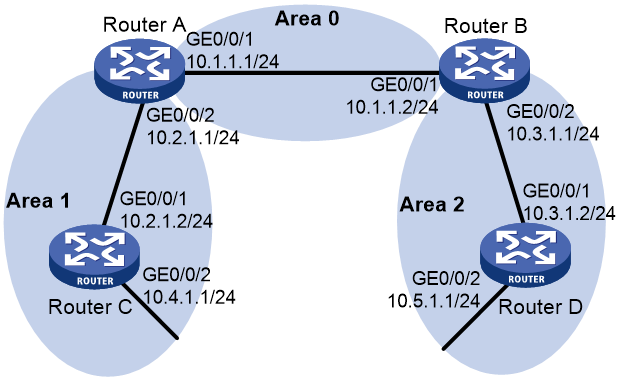

OSPF configuration examples
Example: Configuring basic OSPF
As shown in Figure 19:
·     Enable OSPF on all routers, and split the AS into three areas.
·     Configure Router A and Router B as ABRs.
Figure 19 Network diagram
1.     Configure IP addresses for interfaces. (Details not shown.)
2.     Enable OSPF:
# Configure Router A.
<RouterA> system-view

# Display the OSPF neighbors of Router A.
[RouterA] display ospf peer verbose
          OSPF Process 1 with Router ID 10.2.1.1
                  Neighbors
 Area 0.0.0.0 interface 10.1.1.1(GigabitEthernet0/0/1)'s neighbors
 Router ID: 10.3.1.1         Address: 10.1.1.2         GR State: Normal
   State: Full  Mode: Nbr is master  Priority: 1
   DR: 10.1.1.1  BDR: 10.1.1.2  MTU: 0
   Options is 0x02 (-|-|-|-|-|-|E|-)
   Dead timer due in 37  sec
   Neighbor is up for 06:03:59
   Authentication Sequence: [ 0 ]
   Neighbor state change count: 5
   BFD status: Disabled
 Area 0.0.0.1 interface 10.2.1.1(GigabitEthernet0/0/2)'s neighbors
 Router ID: 10.4.1.1         Address: 10.2.1.2         GR State: Normal
   DR: 10.2.1.1  BDR: 10.2.1.2  MTU: 0
   Dead timer due in 32  sec
   Neighbor is up for 06:03:12
# Display OSPF routing information on Router A.
[RouterA] display ospf routing
                   Routing Table
                Topology base (MTID 0)
 Routing for network
 Destination        Cost     Type    NextHop         AdvRouter       Area
 10.2.1.0/24        1        Transit 10.2.1.1        10.2.1.1        0.0.0.1
 10.3.1.0/24        2        Inter   10.1.1.2        10.3.1.1        0.0.0.0
 10.4.1.0/24        2        Stub    10.2.1.2        10.4.1.1        0.0.0.1
 10.5.1.0/24        3        Inter   10.1.1.2        10.3.1.1        0.0.0.0
 10.1.1.0/24        1        Transit 10.1.1.1        10.2.1.1        0.0.0.0
 Total nets: 5
 Intra area: 3  Inter area: 2  ASE: 0  NSSA: 0
# Display OSPF routing information on Router D.
[RouterD] display ospf routing
          OSPF Process 1 with Router ID 10.5.1.1
                   Routing Table
 Routing for network
 10.2.1.0/24        3        Inter   10.3.1.1        10.3.1.1        0.0.0.2
 10.3.1.0/24        1        Transit 10.3.1.2        10.3.1.1        0.0.0.2
 10.4.1.0/24        4        Inter   10.3.1.1        10.3.1.1        0.0.0.2
 10.5.1.0/24        1        Stub    10.5.1.1        10.5.1.1        0.0.0.2
 10.1.1.0/24        2        Inter   10.3.1.1        10.3.1.1        0.0.0.2
 Total nets: 5
 Intra area: 2  Inter area: 3  ASE: 0  NSSA: 0
# Ping 10.4.1.1 to test reachability.
[RouterD] ping 10.4.1.1
Ping 10.4.1.1 (10.4.1.1): 56 data bytes, press CTRL+C to break
56 bytes from 10.4.1.1: icmp_seq=0 ttl=253 time=1.549 ms
56 bytes from 10.4.1.1: icmp_seq=1 ttl=253 time=1.539 ms
56 bytes from 10.4.1.1: icmp_seq=2 ttl=253 time=0.779 ms
56 bytes from 10.4.1.1: icmp_seq=3 ttl=253 time=1.702 ms
56 bytes from 10.4.1.1: icmp_seq=4 ttl=253 time=1.471 ms
--- Ping statistics for 10.4.1.1 ---
round-trip min/avg/max/std-dev = 0.779/1.408/1.702/0.323 ms

Example: Configuring OSPF route summarization
As shown in Figure 21:
·     Configure OSPF on Router A and Router B in AS 200.
·     Configure OSPF on Router C, Router D, and Router E in AS 100.
·     Configure an EBGP connection between Router B and Router C. Configure Router B and Router C to redistribute OSPF routes and direct routes into BGP and BGP routes into OSPF.
·     Configure Router B to advertise only summary route 10.0.0.0/8 to Router A.
Figure 21 Network diagram
2.     Enable OSPF:
[RouterA] router id 11.2.1.2
[RouterA] ospf
[RouterA-ospf-1] area 0
[RouterA-ospf-1-area-0.0.0.0] network 11.2.1.0 0.0.0.255
[RouterA-ospf-1-area-0.0.0.0] quit
[RouterA-ospf-1] quit
# Configure Router B.
<RouterB> system-view
[RouterB] router id 11.2.1.1
[RouterB] ospf
[RouterB-ospf-1] area 0
[RouterB-ospf-1-area-0.0.0.0] network 11.2.1.0 0.0.0.255
[RouterB-ospf-1-area-0.0.0.0] quit
[RouterB-ospf-1] quit
# Configure Router C.
<RouterC> system-view
[RouterC] router id 11.1.1.2
[RouterC] ospf
[RouterC-ospf-1] area 0
[RouterC-ospf-1-area-0.0.0.0] network 10.1.1.0 0.0.0.255
[RouterC-ospf-1-area-0.0.0.0] network 10.2.1.0 0.0.0.255
[RouterC-ospf-1-area-0.0.0.0] quit
[RouterC-ospf-1] quit
# Configure Router D.
<RouterD> system-view
[RouterD] router id 10.3.1.1
[RouterD] ospf
[RouterD-ospf-1] area 0
[RouterD-ospf-1-area-0.0.0.0] network 10.1.1.0 0.0.0.255
[RouterD-ospf-1-area-0.0.0.0] network 10.3.1.0 0.0.0.255
[RouterD-ospf-1-area-0.0.0.0] quit
[RouterD-ospf-1] quit
# Configure Router E.
<RouterE> system-view
[RouterE] router id 10.4.1.1
[RouterE] ospf
[RouterE-ospf-1] area 0
[RouterE-ospf-1-area-0.0.0.0] network 10.2.1.0 0.0.0.255
[RouterE-ospf-1-area-0.0.0.0] network 10.4.1.0 0.0.0.255
[RouterE-ospf-1-area-0.0.0.0] quit
[RouterE-ospf-1] quit
3.     Configure BGP to redistribute OSPF routes and direct routes:
[RouterB] bgp 200
[RouterB-bgp-default] peer 11.1.1.2 as-number 100
[RouterB-bgp-default] address-family ipv4 unicast
[RouterB-bgp-default-ipv4] peer 11.1.1.2 enable
[RouterB-bgp-default-ipv4] import-route ospf
[RouterB-bgp-default-ipv4] import-route direct
[RouterB-bgp-default-ipv4] quit
[RouterB-bgp-default] quit
[RouterC] bgp 100
[RouterC-bgp-default] peer 11.1.1.1 as-number 200
[RouterC-bgp-default] address-family ipv4 unicast
[RouterC-bgp-default-ipv4] peer 11.1.1.1 enable
[RouterC-bgp-default-ipv4] import-route ospf
[RouterC-bgp-default-ipv4] import-route direct
[RouterC-bgp-default] quit
4.     Configure Router B and Router C to redistribute BGP routes into OSPF:
# Configure OSPF to redistribute routes from BGP on Router B.
[RouterB] ospf
[RouterB-ospf-1] import-route bgp
# Configure OSPF to redistribute routes from BGP on Router C.
[RouterC] ospf
[RouterC-ospf-1] import-route bgp
# Display the IP routing table on Router A.
[RouterA] display ip routing-table
         Destinations : 16        Routes : 16
0.0.0.0/32          Direct 0    0            127.0.0.1       InLoop0
10.1.1.0/24         O_ASE2 150  1            11.2.1.1        GE0/0/1
10.2.1.0/24         O_ASE2 150  1            11.2.1.1        GE0/0/1
10.3.1.0/24         O_ASE2 150  1            11.2.1.1        GE0/0/1
10.4.1.0/24         O_ASE2 150  1            11.2.1.1        GE0/0/1
11.2.1.0/24         Direct 0    0            11.2.1.2        GE0/0/1
11.2.1.0/32         Direct 0    0            11.2.1.2        GE0/0/1
11.2.1.2/32         Direct 0    0            127.0.0.1       InLoop0
11.2.1.255/32       Direct 0    0            11.2.1.2        GE0/0/1
127.0.0.0/8         Direct 0    0            127.0.0.1       InLoop0
127.0.0.0/32        Direct 0    0            127.0.0.1       InLoop0
127.0.0.1/32        Direct 0    0            127.0.0.1       InLoop0
127.255.255.255/32  Direct 0    0            127.0.0.1       InLoop0
224.0.0.0/4         Direct 0    0            0.0.0.0         NULL0
224.0.0.0/24        Direct 0    0            0.0.0.0         NULL0
255.255.255.255/32  Direct 0    0            127.0.0.1       InLoop0
5.     Configure route summarization:
# Configure route summarization on Router B to advertise a single route 10.0.0.0/8.
[RouterB-ospf-1] asbr-summary 10.0.0.0 8
         Destinations : 13        Routes : 13
10.0.0.0/8          O_ASE2 150  1            11.2.1.1        GE0/0/1
The output shows that routes 10.1.1.0/24, 10.2.1.0/24, 10.3.1.0/24 and 10.4.1.0/24 are summarized into a single route 10.0.0.0/8.
Example: Configuring OSPF stub area
As shown in Figure 22:
·     Configure Router A and Router B as ABRs to forward routing information between areas.
·     Configure Router D as the ASBR to redistribute static routes.
·     Configure Area 1 as a stub area to reduce advertised LSAs without influencing reachability.
Figure 22 Network diagram
2.     Enable OSPF (see "Example: Configuring basic OSPF").
3.     Configure route redistribution:
# Configure Router D to redistribute static routes.
[RouterD] ip route-static 3.1.2.1 24 10.5.1.2
[RouterD] ospf
[RouterD-ospf-1] import-route static
# Display ABR/ASBR information on Router C.
<RouterC> display ospf abr-asbr
          OSPF Process 1 with Router ID 10.4.1.1
                  Routing Table to ABR and ASBR
 Type        Destination     Area            Cost  Nexthop         RtType
 Intra       10.2.1.1        0.0.0.1         3     10.2.1.1        ABR
 Inter       10.5.1.1        0.0.0.1         7     10.2.1.1        ASBR
# Display OSPF routing information on Router C.
<RouterC> display ospf routing
                   Routing Table
 Routing for network
 10.2.1.0/24        3        Transit 0.0.0.0         10.2.1.1        0.0.0.1
 10.3.1.0/24        7        Inter   10.2.1.1        10.2.1.1        0.0.0.1
 10.4.1.0/24        3        Stub    10.4.1.1        10.4.1.1        0.0.0.1
 10.5.1.0/24        17       Inter   10.2.1.1        10.2.1.1        0.0.0.1
 10.1.1.0/24        5        Inter   10.2.1.1        10.2.1.1        0.0.0.1
 Routing for ASEs
 Destination        Cost     Type    Tag         NextHop         AdvRouter
 3.1.2.0/24         1        Type2   1           10.2.1.1        10.5.1.1
 Total nets: 6
 Intra area: 2  Inter area: 3  ASE: 1  NSSA: 0
The output shows that Router C's routing table contains an AS external route.
4.     Configure Area 1 as a stub area:
[RouterA] ospf
[RouterA-ospf-1] area 1
[RouterA-ospf-1-area-0.0.0.1] stub
[RouterA-ospf-1-area-0.0.0.1] quit
[RouterC] ospf
[RouterC-ospf-1] area 1
[RouterC-ospf-1-area-0.0.0.1] stub
[RouterC-ospf-1-area-0.0.0.1] quit
[RouterC] display ospf routing
                   Routing Table
 Routing for network
 0.0.0.0/0          4        Inter   10.2.1.1        10.2.1.1        0.0.0.1
 Total nets: 6
 Intra area: 2  Inter area: 4  ASE: 0  NSSA: 0
The output shows that a default route replaces the AS external route.
# Configure Area 1 as a totally stub area.
[RouterA] ospf
[RouterA-ospf-1-area-0.0.0.1] stub no-summary
                   Routing Table
 Routing for network
 10.2.1.0/24        3        Transit 0.0.0.0         10.4.1.1        0.0.0.1
 Total nets: 3
 Intra area: 2  Inter area: 1  ASE: 0  NSSA: 0
The output shows that inter-area routes are removed, and only one external route (a default route) exists on Router C.
Example: Configuring OSPF NSSA area
As shown in Figure 23:
·     Configure OSPF on all routers and split AS into three areas.
·     Configure Area 1 as an NSSA area and configure Router C as an ASBR to redistribute static routes into the AS.
Figure 23 Network diagram
3.     Configure Area 1 as an NSSA area:
[RouterA] ospf
[RouterA-ospf-1-area-0.0.0.1] nssa
[RouterC] ospf
[RouterC-ospf-1-area-0.0.0.1] nssa
# Display routing information on Router C.
                   Routing Table
 Routing for network
 10.2.1.0/24        3        Transit 10.2.1.2        10.4.1.1        0.0.0.1
 Total nets: 5
4.     Configure route redistribution:
# Configure OSPF to redistribute the static route on Router C.
[RouterC] ip route-static 3.1.2.1 24 10.4.1.2
[RouterC] ospf
[RouterC-ospf-1] import-route static
# Display routing information on Router D.
<RouterD> display ospf routing
                   Routing Table
 Routing for network
 10.2.1.0/24        22       Inter   10.3.1.1        10.3.1.1        0.0.0.2
 10.3.1.0/24        10       Transit 10.3.1.2        10.3.1.1        0.0.0.2
 10.4.1.0/24        25       Inter   10.3.1.1        10.3.1.1        0.0.0.2
 10.5.1.0/24        10       Stub    10.5.1.1        10.5.1.1        0.0.0.2
 10.1.1.0/24        12       Inter   10.3.1.1        10.3.1.1        0.0.0.2
 Routing for ASEs
 3.1.2.0/24         1        Type2   1           10.3.1.1        10.2.1.1
 Total nets: 6
The output shows that an AS external route imported from the NSSA area exists on Router D.
Example: Configuring OSPF DR election
As shown in Figure 24:
·     Enable OSPF on Routers A, B, C, and D on the same network.
·     Configure Router D as the DR, and configure Router C as the BDR.
·     Change the router priorities on the interfaces to configure Router A as the DR and Router C as the BDR.
Figure 24 Network diagram
If the network already has a DR or BDR, the router priority settings configured on interfaces do not take effect immediately.
The Full neighbor state means an adjacency has been established. The 2-Way neighbor state means the two routers are not the DR or BDR, and they do not exchange LSAs.
The interface state DROther means the interface is not the DR or BDR.
2.     Configure basic OSPF settings on all routers (see "Example: Configuring basic OSPF").
3.     Display neighbor information on Router A.
          OSPF Process 1 with Router ID 1.1.1.1
                  Neighbors
 Area 0.0.0.0 interface 192.168.1.1(GigabitEthernet0/0/1)'s neighbors
 Router ID: 2.2.2.2          Address: 192.168.1.2      GR State: Normal
   State: 2-Way  Mode: None  Priority: 1
   DR: 192.168.1.4  BDR: 192.168.1.3  MTU: 0
   Dead timer due in 38  sec
   Neighbor is up for 00:01:31
   Neighbor state change count: 6
 Router ID: 3.3.3.3          Address: 192.168.1.3      GR State: Normal
   Dead timer due in 31  sec
   Neighbor is up for 00:01:28
 Router ID: 4.4.4.4          Address: 192.168.1.4      GR State: Normal
The output shows that Router D is the DR and Router C is the BDR.

Example: Configuring OSPF virtual link
As shown in Figure 25, configure a virtual link between Router B and Router C to connect Area 2 to the backbone area. After configuration, Router B can learn routes to Area 2.
Figure 25 Network diagram
2.     Enable OSPF:
[RouterA] ospf 1 router-id 1.1.1.1
[RouterA-ospf-1-area-0.0.0.0] network 10.1.1.0 0.0.0.255
[RouterB] ospf 1 router-id 2.2.2.2
[RouterB-ospf-1-area-0.0.0.0] network 10.1.1.0 0.0.0.255
[RouterB-ospf-1] area 1
[RouterB–ospf-1-area-0.0.0.1] network 10.2.1.0 0.0.0.255
[RouterB–ospf-1-area-0.0.0.1] quit
[RouterC] ospf 1 router-id 3.3.3.3
[RouterD] ospf 1 router-id 4.4.4.4
[RouterD-ospf-1] area 2
[RouterD-ospf-1-area-0.0.0.2] network 10.3.1.0 0.0.0.255
[RouterD-ospf-1-area-0.0.0.2] quit
# Display OSPF routing information on Router B.
[RouterB] display ospf routing
          OSPF Process 1 with Router ID 2.2.2.2
                   Routing Table
 Routing for network
 10.2.1.0/24        2        Transit 10.2.1.1        3.3.3.3         0.0.0.1
 10.1.1.0/24        2        Transit 10.1.1.2        2.2.2.2         0.0.0.0
 Total nets: 2
 Intra area: 2  Inter area: 0  ASE: 0  NSSA: 0
The output shows that Router B does not have routes to Area 2 because Area 0 is not directly connected to Area 2.
3.     Configure a virtual link:
[RouterB] ospf
[RouterB-ospf-1-area-0.0.0.1] vlink-peer 3.3.3.3
[RouterB-ospf-1-area-0.0.0.1] quit
[RouterC] ospf
[RouterC-ospf-1-area-0.0.0.1] vlink-peer 2.2.2.2
                   Routing Table
 Routing for network
 10.3.1.0/24        5        Inter   10.2.1.2        3.3.3.3         0.0.0.0
 Total nets: 3
The output shows that Router B has learned the route 10.3.1.0/24 to Area 2.

As shown in Figure 26:
·     Router A, Router B, and Router C that belong to the same autonomous system and the same OSPF routing domain are GR capable.
·     Router A acts as the non-IETF GR restarter. Router B and Router C are the GR helpers, and synchronize their LSDBs with Router A through OOB communication of GR.
Figure 26 Network diagram

As shown in Figure 27, Router S, Router A, and Router B belong to the same OSPF routing domain. Enable OSPF NSR on Router S to ensure correct routing when an active/standby switchover occurs on Router S.
Figure 27 Network diagram

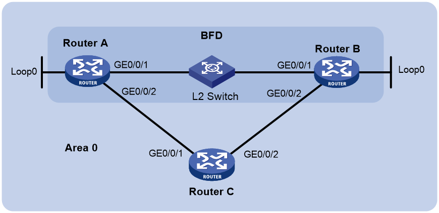

As shown in Figure 28, run OSPF on Router A, Router B, and Router C so that they can reach each other at the network layer.
·     When the link over which Router A and Router B communicate through a Layer 2 switch fails, BFD can quickly detect the failure and notify OSPF of the failure.
·     Router A and Router B then communicate through Router C.
Figure 28 Network diagram
2.     Enable OSPF:
[RouterA] ospf
[RouterA-ospf-1-area-0.0.0.0] network 192.168.0.0 0.0.0.255
[RouterA-ospf-1-area-0.0.0.0] network 121.1.1.1 0.0.0.0
[RouterB] ospf
[RouterB-ospf-1-area-0.0.0.0] network 192.168.0.0 0.0.0.255
[RouterB-ospf-1-area-0.0.0.0] network 13.1.1.0 0.0.0.255
[RouterB-ospf-1-area-0.0.0.0] network 120.1.1.1 0.0.0.0
[RouterC] ospf
[RouterC-ospf-1-area-0.0.0.0] network 13.1.1.0 0.0.0.255
3.     Configure BFD:
# Enable BFD on Router A and configure BFD parameters.
[RouterA] bfd session init-mode active
[RouterA] interface gigabitethernet 0/0/1
[RouterA-GigabitEthernet0/0/1] ospf bfd enable
[RouterA-GigabitEthernet0/0/1] bfd min-transmit-interval 500
[RouterA-GigabitEthernet0/0/1] bfd min-receive-interval 500
[RouterA-GigabitEthernet0/0/1] bfd detect-multiplier 7
[RouterA-GigabitEthernet0/0/1] quit
# Enable BFD on Router B and configure BFD parameters.
[RouterB] bfd session init-mode active
[RouterB] interface gigabitethernet 0/0/1
[RouterB-GigabitEthernet0/0/1] ospf bfd enable
[RouterB-GigabitEthernet0/0/1] bfd min-transmit-interval 500
[RouterB-GigabitEthernet0/0/1] bfd min-receive-interval 500
[RouterB-GigabitEthernet0/0/1] bfd detect-multiplier 6
[RouterB-GigabitEthernet0/0/1] quit
# Display the BFD information on Router A.
<RouterA> display bfd session
 Total sessions: 1     Up sessions: 1     Init mode: Active
 IPv4 session working in control mode:
 LD/RD            SourceAddr      DestAddr        State Running Up for Holdtime
   Interface
 3/1              192.168.0.102   192.168.0.100   Up    00:00:03       1700ms
   GE0/0/1

Example: Configuring OSPF FRR
As shown in Figure 29, Router A, Router B, and Router C reside in the same OSPF domain. Configure OSPF FRR so that when Link A fails, traffic is immediately switched to Link B.
Figure 29 Network diagram
Table 5 Interface and IP address assignment
Device
Interface
IP address
Router A
GE0/0/1
12.12.12.1/24
Router A
GE0/0/2
13.13.13.1/24
Router A
Loop0
1.1.1.1/32
Router B
GE0/0/1
24.24.24.4/24
Router B
GE0/0/2
13.13.13.2/24
Router B
Loop0
4.4.4.4/32
Router C
GE0/0/1
12.12.12.2/24
Router C
GE0/0/2
24.24.24.2/24
1.     Configure IP addresses and subnet masks for interfaces on the routers. (Details not shown.)
2.     Configure OSPF on the routers to ensure that Router A, Router B, and Router C can communicate with each other at the network layer. (Details not shown.)
3.     Configure OSPF FRR:
You can enable OSPF FRR to either calculate a backup next hop by using the LFA algorithm, or specify a backup next hop by using a routing policy.
¡     (Method 1.) Enable OSPF FRR to calculate a backup next hop by using the LFA algorithm:
[RouterA] ospf 1
[RouterA-ospf-1] fast-reroute lfa
[RouterB] ospf 1
[RouterB-ospf-1] fast-reroute lfa
¡     (Method 2.) Enable OSPF FRR to specify a backup next hop by using a routing policy:
[RouterA] ip prefix-list abc index 10 permit 4.4.4.4 32
[RouterA] route-policy frr permit node 10
[RouterA-route-policy-frr-10] if-match ip address prefix-list abc
[RouterA-route-policy-frr-10] apply fast-reroute backup-interface gigabitethernet 0/0/1 backup-nexthop 12.12.12.2
[RouterA-route-policy-frr-10] quit
[RouterA] ospf 1
[RouterA-ospf-1] fast-reroute route-policy frr
[RouterB] ip prefix-list abc index 10 permit 1.1.1.1 32
[RouterB] route-policy frr permit node 10
[RouterB-route-policy-frr-10] if-match ip address prefix-list abc
[RouterB-route-policy-frr-10] apply fast-reroute backup-interface gigabitethernet 0/0/1 backup-nexthop 24.24.24.2
[RouterB-route-policy-frr-10] quit
[RouterB] ospf 1
[RouterB-ospf-1] fast-reroute route-policy frr
