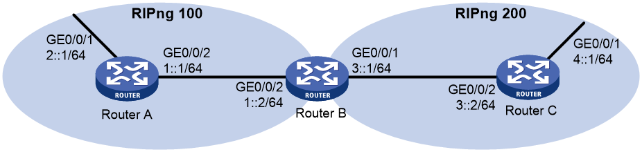

For example, RIPng has two specific routes to be advertised through an interface: 1:11:11::24 with a metric of a 2 and 1:11:12::34 with a metric of 3. Configure route summarization on the interface, so RIPng advertises a single route 11::0/16 with a metric of 2.
2.     Enter interface view.
3.     Advertise a summary IPv6 prefix.
ripng summary-address ipv6-address prefix-length
By default, no summary IPv6 prefix is configured on the interface.

Configuring RIPng route redistribution
2.     Enter RIPng view.
ripng [ process-id ] [ vpn-instance vpn-instance-name ]
3.     Configure route redistribution.
import-route protocol [ as-number | process-id ] [ allow-ibgp ] [ allow-direct | cost cost-value | route-policy route-policy-name ] *
By default, RIPng does not redistribute routes.
4.     (Optional.) Set a default routing metric for redistributed routes.
default cost cost-value
The default metric of redistributed routes is 0.

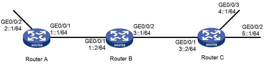

Example: Configuring basic RIPng
As shown in Figure 2, Router A, Router B, and Router C learn IPv6 routing information through RIPng. Configure route filtering on Router B to accept all received routes except the route 2::/64 and to advertise only the route 4::/64.
Figure 2 Network diagram

As shown in Figure 3, Router B communicates with Router A through RIPng 100 and with Router C through RIPng 200.
Configure route redistribution on Router B, so the two RIPng processes can redistribute routes from each other.
Figure 3 Network diagram
1.     Configure IPv6 addresses for the interfaces. (Details not shown.)
2.     Configure basic RIPng settings:
# Enable RIPng 100 on Router A.
<RouterA> system-view
[RouterA] ripng 100
[RouterA-ripng-100] quit
[RouterA] interface gigabitethernet 0/0/1
[RouterA-GigabitEthernet0/0/1] ripng 100 enable
[RouterA-GigabitEthernet0/0/1] quit
[RouterA] interface gigabitethernet 0/0/2
[RouterA-GigabitEthernet0/0/2] ripng 100 enable
# Enable RIPng 100 and RIPng 200 on Router B.
<RouterB> system-view
[RouterB] ripng 100
[RouterB-ripng-100] quit
[RouterB] interface gigabitethernet 0/0/2
[RouterB-GigabitEthernet0/0/2] ripng 100 enable
[RouterB-GigabitEthernet0/0/2] quit
[RouterB] ripng 200
[RouterB-ripng-200] quit
[RouterB] interface gigabitethernet 0/0/1
[RouterB-GigabitEthernet0/0/1] ripng 200 enable
#  Enable RIPng 200 on Router C.
<RouterC> system-view
[RouterC] ripng 200
[RouterC] interface gigabitethernet 0/0/1
[RouterC-GigabitEthernet0/0/1] ripng 200 enable
[RouterC-GigabitEthernet0/0/1] quit
[RouterC] interface gigabitethernet 0/0/2
[RouterC-GigabitEthernet0/0/2] ripng 200 enable
[RouterC-GigabitEthernet0/0/2] quit

Example: Configuring RIPng GR
As shown in Figure 4, Router A, Router B, and Router C learn IPv6 routing information through RIPng.
Configure Router A as the GR restarter. Configure Router B and Router C as the GR helpers to synchronize their routing tables with Router A by using GR.
Figure 4 Network diagram
2.     Configure RIPng on the routers to ensure the following: (Details not shown.)
¡     Router A, Router B, and Router C can communicate with each other at Layer 3.
¡     Dynamic route update can be implemented among them with RIPng.
3.     Enable RIPng GR on Router A.
[RouterA] ripng 1
[RouterA-ripng-1] graceful-restart
# Restart RIPng or trigger an active/standby process switchover, and then display GR status on Router A.
<RouterA> display ripng 1 graceful-restart
RIPng process: 1
 Graceful Restart capability    : Enabled
 Current GR state               : Normal
 Graceful Restart period        : 60  seconds
 Graceful Restart remaining time: 0   seconds
