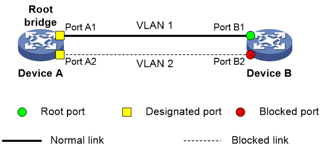

As shown in Figure 6, Device A is the root bridge. The priority of Device B is higher than the priority of Device C. Port C2 on Device C is blocked.
When the link between Device A and Device B fails, the following events occur:
1.     Device B sends an RSTP BPDU with itself as the root bridge to Device C.
2.     Device C compares the RSTP BPDU with its own BPDU.
3.     Because the RSTP BPDU from Device B has a lower priority, Device C sends its own BPDU to Device B.
4.     Device B considers that Port B2 is the root port and stops sending RSTP BPDUs to Device C.
Figure 6 BPDU processing in RSTP

Rapid transition mechanism
In STP, a port must wait twice the forward delay (30 seconds by default) before it transits from the blocking state to the forwarding state. The forward delay is related to the hello time and network diameter. If the forward delay is too short, loops might occur. This affects the stability of the network.
RSTP, PVST, and MSTP all use the rapid transition mechanism to speed up port state transition for edge ports, root ports, and designated ports. The rapid transition mechanism for designated ports is also known as the proposal/agreement (P/A)_transition.
Edge port rapid transition
As shown in Figure 12, Port C3 is an edge port connected to a host. When a network topology change occurs, the port can immediately transit from the blocking state to the forwarding state because no loop will be caused.
Because a device cannot determine whether a port is directly connected to a terminal, you must manually configure the port as an edge port.
Figure 12 Edge port rapid transition

Ignoring the specified VLANs
Traffic of a VLAN on a complex network might be blocked by the spanning tree, as shown in Figure 16.
·     Port A1 on Device A allows the traffic of VLAN 1 to pass through.
·     Port A2 on Device A allows the traffic of VLAN 2 to pass through.
·     Port B1 on Device B allows the traffic of VLAN 1 to pass through.
·     Port B2 on Device B allows the traffic of VLAN 2 to pass through.
·     Device A and Device B run a spanning tree protocol. Device A is the root bridge, and Port A1 and Port A2 are designated ports. On Device B, Port B1 is the root port, and Port B2 is the blocked port. Traffic of VLAN 2 is blocked.
Figure 16 VLAN connectivity blocked by MSTP
Ignoring a VLAN can make ports of the VLAN forward frames correctly rather than comply with the spanning tree calculation result.
2.     Ignore the specified VLANs.
stp ignored vlan vlan-id-list
By default, no VLAN is ignored.

About dispute guard
Dispute guard is enabled by default. You do not need to manually configure this feature.
Dispute guard can be triggered by unidirectional link failures. If an upstream port receives inferior BPDUs from a downstream designated port in forwarding or learning state because of a unidirectional link failure, a loop appears. Dispute guard blocks the upstream designated port to prevent the loop.
As shown in Figure 20, in normal conditions, the spanning tree calculation result is as follows:
·     Device A is the root bridge, and Port A1 is a designated port.
·     Port B1 is blocked.
When the link between Port A1 and Port B1 fails in the direction of Port A1 to Port B1 and becomes unidirectional, the following events occur:
1.     Port A1 can only receive BPDUs and cannot send BPDUs to Port B1.
2.     Port B1 does not receive BPDUs from Port A1 for a certain period of time.
3.     Device B determines itself as the root bridge.
4.     Port B1 sends its BPDUs to Port A1.
5.     Port A1 determines the received BPDUs are inferior to its own BPDUs. A dispute is detected.
6.     Dispute guard is triggered and blocks Port A1 to prevent a loop.
Figure 20 Dispute guard triggering scenario
