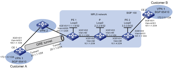

As shown in Figure 1, Customer A and Customer B belong to VPN 1. A network VPN 2 exists between CE 1 and PE 1. Configure MPLS L3VPN for Customer A and Customer B to communicate with each other through VPN.
Figure 1 Network diagram
Analysis
For packets to be transported over the MPLS network, configure an IGP on the MPLS backbone to ensure IP connectivity, and configure LDP to distribute public network labels (outer labels).
To transport VPN routes and distribute private network labels (inner labels), configure MP-BGP and establish BGP peers between the PEs.
For CE1 to access MPLS L3VPN successfully, establish a GRE tunnel between CE 1 and PE 1 to implement logical direct connection between them.
Binding a VPN instance to an interface deletes some configuration (such as the IP address) of the interface. Therefore, bind the VPN instance before configure other settings on an interface.

2.        Configure CE 2:
Configure IP addresses for the CE according to Figure 1. (Details not shown.)
3.        Verify the VPN instance configuration on PE 2.
[PE2] display ip vpn-instance
  Total VPN-Instances configured : 1
  VPN-Instance Name               RD                     Create time
  vpn1                            100:1                  2016/06/22 13:20:08
4.        Verify that PE 2 can ping CE 2.
[PE2] ping -vpn-instance vpn1 101.1.1.2
Ping 10.1.4.2 (101.1.1.2): 56 data bytes, press CTRL_C to break
56 bytes from 101.1.1.2: icmp_seq=0 ttl=255 time=1.000 ms
56 bytes from 101.1.1.2: icmp_seq=1 ttl=255 time=2.000 ms
56 bytes from 101.1.1.2: icmp_seq=2 ttl=255 time=0.000 ms
56 bytes from 101.1.1.2: icmp_seq=3 ttl=255 time=1.000 ms
56 bytes from 101.1.1.2: icmp_seq=4 ttl=255 time=0.000 ms
--- Ping statistics for 10.1.1.1 ---
round-trip min/avg/max/std-dev = 0.000/0.800/2.000/0.748 ms
Establishing EBGP peer relationships between PEs and CEs, and redistributing VPN routes into BGP
1.        Configure PE 1:
# Create BGP process 100.
[PE1] bgp 100
# Specify CE 1 as a BGP peer, and redistribute the direct routes of PE 1 to the routing table of the BGP VPN instance.
[PE1-bgp-default] ip vpn-instance vpn1
[PE1-bgp-default-vpn1] peer 20.1.1.1 as-number 65410
[PE1-bgp-default-vpn1] address-family ipv4 unicast
[PE1-bgp-default-ipv4-vpn1] peer 20.1.1.1 enable
[PE1-bgp-default-ipv4-vpn1] import-route direct
[PE1-bgp-default-ipv4-vpn1] quit
[PE1-bgp-default-vpn1] quit
2.        Configure PE 2:
[PE2] bgp 100
# Specify CE 2 as a BGP peer, and redistribute the direct routes of PE 2 to the routing table of the BGP VPN instance.
[PE2-bgp-default] ip vpn-instance vpn1
[PE2-bgp-default-vpn1] peer 101.1.1.2 as-number 65410
[PE2-bgp-default-vpn1] address-family ipv4 unicast
[PE2-bgp-default-ipv4-vpn1] peer 101.1.1.2 enable
[PE2-bgp-default-ipv4-vpn1] import-route direct
[PE2-bgp-default-ipv4-vpn1] quit
[PE2-bgp-default-vpn1] quit
3.        Configure CE 1:
# Create BGP process 65410 on CE 1, and specify PE 1 as a BGP peer and set the AS number to 100.
<CE1> system-view
[CE1] bgp 65410
[CE1-bgp-default] peer 20.1.1.2 as-number 100
# Enable IPv4 unicast route exchange with peer PE 1.
[CE1-bgp-default] address-family ipv4 unicast
[CE1-bgp-default-ipv4] peer 20.1.1.2 enable
# Redistribute the direct routes of CE 1 into EBGP.
[CE1-bgp-default-ipv4] import-route direct
[CE1-bgp-default-ipv4] quit
[CE1-bgp-default] quit
4.        Configure CE 2:
# Create BGP process 65410 on CE 2, and specify PE 2 as a BGP peer and set the AS number to 100.
<CE2> system-view
[CE2] bgp 65410
[CE2-bgp-default] peer 101.1.1.1 as-number 100
# Enable IPv4 unicast route exchange with peer PE 2.
[CE2-bgp-default] address-family ipv4 unicast
[CE2-bgp-default-ipv4] peer 101.1.1.1 enable
# Redistribute the direct routes of CE 2 into EBGP.
[CE2-bgp-default-ipv4] import-route direct
[CE2-bgp-default-ipv4] quit
[CE2-bgp-default] quit
5.        Verify that a BGP peer relationship in Established state has been established between a PE and a CE.
This example uses PE 2 and CE 2.
[PE2] display bgp peer ipv4 vpn-instance vpn1
 BGP local router ID: 3.3.3.9
 Local AS number: 100
 Total number of peers: 1                  Peers in established state: 1
  Peer             AS        MsgRcvd  MsgSent OutQ PrefRcv Up/Down    State
  101.1.1.2        65430     4        4       0    2       13:35:25   Established
Creating an MP-IBGP peer relationship between PEs
1.        Configure PE 1:
# Configure PE 2 as a BGP peer, and specify interface Loopback 0 as the source interface for TCP connections to the peer.
[PE1] bgp 100
[PE1-bgp-default] peer 3.3.3.9 as-number 100
[PE1-bgp-default] peer 3.3.3.9 connect-interface loopback 0
# Enable BGP VPNv4 route exchange with peer PE 2.
[PE1-bgp-default] address-family vpnv4
[PE1-bgp-default-vpnv4] peer 3.3.3.9 enable
[PE1-bgp-default-vpnv4] quit
[PE1-bgp-default] quit
2.        Configure PE 2:
# Configure PE 1 as a BGP peer, and specify interface Loopback 0 as the source interface for TCP connections to the peer.
[PE2] bgp 100
[PE2-bgp-default] peer 1.1.1.9 as-number 100
[PE2-bgp-default] peer 1.1.1.9 connect-interface loopback 0
# Enable BGP VPNv4 route exchange with peer PE 1.
[PE2-bgp-default] address-family vpnv4
[PE2-bgp-default-vpnv4] peer 1.1.1.9 enable
[PE2-bgp-default-vpnv4] quit
[PE2-bgp-default] quit
3.        Verify that a BGP peer relationship in Established state has been established between the PEs.
[PE1] display bgp peer vpnv4
BGP local router ID: 1.1.1.9
  3.3.3.9                100        8        8    0       0 00:00:08 Established
# Display the VPN routing table of a PE and verify that the PE has a route to the peer CE. (This example uses PE 1.)
[PE1] display ip routing-table vpn-instance vpn1
Destinations : 13        Routes : 13
0.0.0.0/32          Direct 0    0            127.0.0.1       InLoop0
20.1.1.0/24         Direct  0   0            20.1.1.2        Tun0
20.1.1.0/32         Direct  0   0            20.1.1.2        Tun0
20.1.1.2/32         Direct  0   0            127.0.0.1       InLoop0
200.1.1.0/24        Direct 0    0            200.1.1.2       Vlan100
200.1.1.0/32        Direct 0    0            200.1.1.2       Vlan100
200.1.1.2/32        Direct 0    0            127.0.0.1       InLoop0
200.1.1.255/32      Direct 0    0            100.1.1.2       Vlan100
101.1.1.0/24        BGP    255  0            3.3.3.9         Vlan2
127.0.0.0/8         Direct 0    0            127.0.0.1       InLoop0
127.0.0.0/32        Direct 0    0            127.0.0.1       InLoop0
127.0.0.1/32        Direct 0    0            127.0.0.1       InLoop0
127.255.255.255/32  Direct 0    0            127.0.0.1       InLoop0
224.0.0.0/4         Direct 0    0            0.0.0.0         NULL0
224.0.0.0/24        Direct 0    0            0.0.0.0         NULL0
255.255.255.255/32  Direct 0    0            127.0.0.1       InLoop0
