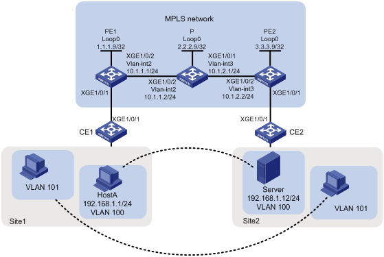

As shown in Figure 1, configure remote CCC connections between PE 1 and PE 2 to allow communication between the two sites as if they were in the same LAN. The same VLAN in different sites can communicate with each other.
Figure 1 Network diagram

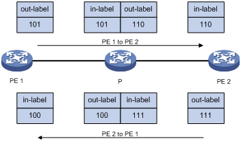

To establish a remote CCC connection, specify the incoming and outgoing labels on the PEs, and create a static LSP for each direction of the connection on the P device. The outgoing label specified on a device must be the same as the incoming label specified on the next hop device as shown in Figure 2.
Figure 2 Incoming and outgoing label assignment

1.        Configure VLAN interfaces and enable basic MPLS on the interfaces:
# On PE 1, configure an LSR ID.
<PE1> system-view
[PE1] interface loopback 0
[PE1-LoopBack0] ip address 1.1.1.9 32
[PE1-LoopBack0] quit
[PE1] mpls lsr-id 1.1.1.9
# On PE 1, enable MPLS L2VPN globally.
[PE1] l2vpn enable
# On PE 1, create VLAN 2 and assign Ten-GigabitEthernet 1/0/2 to the VLAN.
[PE1] vlan 2
[PE1-vlan2] port Ten-GigabitEthernet 1/0/2
[PE1-vlan2] quit
# On PE 1, configure VLAN-interface 2 and enable MPLS on it.
[PE1] interface vlan-interface 2
[PE1-Vlan-interface2] ip address 10.1.1.1 24
[PE1-Vlan-interface2] mpls enable
[PE1-Vlan-interface2] quit
# On P, configure an LSR ID.
<P> system-view
[P] interface loopback 0
[P-LoopBack0] ip address 2.2.2.9 32
[P-LoopBack0] quit
[P] mpls lsr-id 2.2.2.9
# On P, create VLAN 3 and assign Ten-GigabitEthernet 1/0/1 to the VLAN.
[P] vlan3
[P-vlan3] port Ten-GigabitEthernet1/0/1
[P-vlan3] quit
# On P, configure VLAN-interface 3 and enable MPLS on it.
[P] interface vlan-interface 3
[P-Vlan-interface3] ip address 10.1.2.1 24
[P-Vlan-interface3] mpls enable
[P-Vlan-interface3] quit
# On P, create VLAN 2 and assign Ten-GigabitEthernet 1/0/2 to the VLAN.
[P] vlan2
[P-vlan2] port Ten-GigabitEthernet1/0/2
[P-vlan2] quit
# On P, configure VLAN-interface 2 and enable MPLS on it.
[P] interface vlan-interface 2
[P-Vlan-interface2] ip address 10.1.1.2 24
[P-Vlan-interface2] mpls enable
[P-Vlan-interface2] quit
# On PE 2, configure an LSR ID.
<PE2> system-view
[PE2] interface loopback 0
[PE2-LoopBack0] ip address 3.3.3.9 32
[PE2-LoopBack0] quit
[PE2] mpls lsr-id 3.3.3.9
# On PE 2, enable MPLS L2VPN globally.
[PE2] l2vpn enable
# On PE 2, create VLAN 3 and assign Ten-GigabitEthernet 1/0/2 to the VLAN.
[PE2] vlan 3
[PE2-vlan3] port Ten-GigabitEthernet 1/0/2
[PE2-vlan3] quit
# On PE 2, configure VLAN-interface 3 and enable MPLS on it.
[PE2] interface vlan-interface 3
[PE2-Vlan-interface3] ip address 10.1.2.2 24
[PE2-Vlan-interface3] mpls enable
[PE2-Vlan-interface3] quit
2.        Configure remote CCC connections on PEs and configure static LSPs on P:
# On PE 1, create service instance 100 on Ten-GigabitEthernet 1/0/1 to match packets from VLAN 100.
[PE1] interface ten-gigabitethernet1/0/1
[PE1-Ten-GigabitEthernet1/0/1] service-instance 100
[PE1-Ten-GigabitEthernet1/0/1-srv100] encapsulation s-vid 100
[PE1-Ten-GigabitEthernet1/0/1-srv100] quit
# On PE 1, create service instance 101 on Ten-GigabitEthernet 1/0/1 to match packets from VLAN 101.
[PE1-Ten-GigabitEthernet1/0/1] service-instance 101
[PE1-Ten-GigabitEthernet1/0/1-srv101] encapsulation s-vid 101
[PE1-Ten-GigabitEthernet1/0/1-srv101] quit
[PE1-Ten-GigabitEthernet1/0/1] quit
# On PE 1, create cross-connect group vpna, and create remote CCC connection CCC that has incoming label 100, outgoing label 101, and next hop 10.1.1.2.
[PE1] xconnect-group vpna
[PE1-xcg-vpna] connection ccc
[PE1-xcg-vpna-ccc] ccc in-label 100 out-label 101 nexthop 10.1.1.2
# On PE 1, bind service instance 100 on Ten-GigabitEthernet 1/0/1 to the CCC connection.
[PE1-xcg-vpna-ccc] ac interface ten-gigabitethernet 1/0/1 service-instance 100
[PE1-xcg-vpna-ccc] quit
[PE1-xcg-vpna] quit
# On PE 1, create cross-connect group vpnb, and create remote CCC connection CCC that has incoming label 200, outgoing label 201, and next hop 10.1.1.2.
[PE1] xconnect-group vpnb
[PE1-xcg-vpnb] connection ccc
[PE1-xcg-vpnb-ccc] ccc in-label 200 out-label 201 nexthop 10.1.1.2
# On PE 1, bind service instance 101 on Ten-GigabitEthernet 1/0/1 to the CCC connection.
[PE1-xcg-vpnb-ccc] ac interface ten-gigabitethernet 1/0/1 service-instance 101
[PE1-xcg-vpnb-ccc] quit
[PE1-xcg-vpnb] quit
# On P, create a static LSP for forwarding packets of VLAN 100 from PE 1 to PE 2.
[P] static-lsp transit pe1-pe2-100 in-label 101 nexthop 10.1.2.2 out-label 110
# On P, create a static LSP for forwarding packets of VLAN 101 from PE 1 to PE 2.
[P] static-lsp transit pe1-pe2-101 in-label 201 nexthop 10.1.2.2 out-label 210
# On P, create a static LSP for forwarding packets of VLAN 100 from PE 2 to PE 1.
[P] static-lsp transit pe2-pe1-100 in-label 111 nexthop 10.1.1.1 out-label 100
# On P, create a static LSP for forwarding packets of VLAN 101 from PE 2 to PE 1.
[P] static-lsp transit pe2-pe1-101 in-label 211 nexthop 10.1.1.1 out-label 200
# On PE 2, create service instance 100 on Ten-GigabitEthernet 1/0/1 to match packets from VLAN 100.
[PE2] interface ten-gigabitethernet1/0/1
[PE2-Ten-GigabitEthernet1/0/1] service-instance 100
[PE2-Ten-GigabitEthernet1/0/1-srv100] encapsulation s-vid 100
[PE2-Ten-GigabitEthernet1/0/1-srv100] quit
# On PE 2, create service instance 101 on Ten-GigabitEthernet 1/0/1 to match packets from VLAN 101.
[PE2-Ten-GigabitEthernet1/0/1] service-instance 101
[PE2-Ten-GigabitEthernet1/0/1-srv101] encapsulation s-vid 101
[PE2-Ten-GigabitEthernet1/0/1-srv101] quit
[PE2-Ten-GigabitEthernet1/0/1] quit
# On PE 2, create cross-connect group vpna, and create remote CCC connection CCC that has incoming label 110, outgoing label 111, and next hop 10.1.2.1.
[PE2] xconnect-group vpna
[PE2-xcg-vpna] connection ccc
[PE2-xcg-vpna-ccc] ccc in-label 110 out-label 111 nexthop 10.1.2.1
# On PE 2, bind service instance 100 on Ten-GigabitEthernet 1/0/1 to the CCC connection.
[PE2-xcg-vpna-ccc] ac interface ten-gigabitethernet 1/0/1 service-instance 100
[PE2-xcg-vpna-ccc] quit
[PE2-xcg-vpna] quit
# On PE 2, create cross-connect group vpnb, and create remote CCC connection CCC that has incoming label 210, outgoing label 211, and next hop 10.1.2.1.
[PE2] xconnect-group vpnb
[PE2-xcg-vpnb] connection ccc
[PE2-xcg-vpnb-ccc] ccc in-label 210 out-label 211 nexthop 10.1.2.1
# On PE 2, bind service instance 101 on Ten-GigabitEthernet 1/0/1 to the CCC connection.
[PE2-xcg-vpnb-ccc] ac interface ten-gigabitethernet 1/0/1 service-instance 101
[PE2-xcg-vpnb-ccc] quit
[PE2-xcg-vpnb] quit
3.        Allow CE access to PEs:
# On CE 1, configure Ten-GigabitEthernet 1/0/1 as a trunk port and assign the port to VLAN 100 and VLAN 101.
<CE1> system-view
[CE1] vlan 100 to 101
[CE1] interface Ten-GigabitEthernet 1/0/1
[CE1-Ten-GigabitEthernet1/0/1] port link-type trunk
[CE1-Ten-GigabitEthernet1/0/1] port trunk permit vlan 100 101
# On CE 2, configure Ten-GigabitEthernet 1/0/1 as a trunk port and assign the port to VLAN 100 and VLAN 101.
<CE2> system-view
[CE2] vlan 100 to 101
[CE2] interface Ten-GigabitEthernet 1/0/1
[CE2-Ten-GigabitEthernet1/0/1] port link-type trunk
[CE2-Ten-GigabitEthernet1/0/1] port trunk permit vlan 100 101
# Display L2VPN PW information on PE 1. The output shows that two remote CCC connections (identified by PW ID/Rmt Site "-" and Proto Static) have been established.
[PE1] display l2vpn pw
Flags: M - main, B - backup, H - hub link, S - spoke link, N - no split horizon
Total number of PWs: 2, 2 up, 0 blocked, 0 down, 0 defect
Xconnect-group Name: vpna
Peer            PW ID/Rmt Site    In/Out Label    Proto   Flag  Link ID  State
10.1.1.2        -                 100/101         Static  M     1        Up
Xconnect-group Name: vpnb
10.1.1.2        -                 200/201         Static  M     1        Up
# Display L2VPN PW information on PE 2. The output shows that two remote CCC connections have been established.
[PE2] display l2vpn pw
10.1.2.1        -                 110/111         Static  M     1        Up
10.1.2.1        -                 210/211         Static  M     1        Up
# Verify that Host A and Server can ping each other and hosts of VLAN 101 in different sites can ping each other. (Details not shown.)

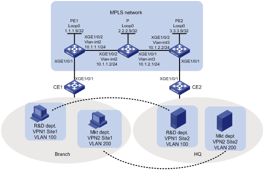

Example: Configuring static PWs
As shown in Figure 3, the MPLS network provides L2VPN services for two customers. Each customer has two fixed sites. Configure static PWs between PE 1 and PE 2 to allow communication between the sites of the same customer.
Figure 3 Network diagram
Analysis
To use static PWs to implement MPLS L2VPN, configure two levels of labels:
·          Inner labels—PW labels specified manually.
·          Outer labels—Public tunnel labels dynamically generated by LDP in this example.
To ensure that a static PW can be successfully established for the sites of a customer, specify the incoming label on the local PE the same as the outgoing label on the remote PE.
Procedures
1.        Configure OSPF on the MPLS backbone to ensure IP connectivity within the backbone:
# On PE 1, configure an IP address for Loopback 0.
<PE1> system-view
[PE1] vlan 2
[PE1-vlan2] quit
# On PE 1, configure VLAN-interface 2.
# On PE 1, configure OSPF.
[PE1] ospf
[PE1-ospf-1] area 0
[PE1-ospf-1-area-0.0.0.0] network 10.1.1.0 0.0.0.255
[PE1-ospf-1-area-0.0.0.0] network 1.1.1.9 0.0.0.0
[PE1-ospf-1-area-0.0.0.0] quit
[PE1-ospf-1] quit
# On P, configure an IP address for Loopback 0.
<P> system-view
[P-LoopBack0] quit
[P] vlan 2
[P-vlan2] quit
# On P, configure VLAN-interface 2.
[P] vlan 3
[P-vlan3] quit
# On P, configure VLAN-interface 3.
# On P, configure OSPF.
[P] ospf
[P-ospf-1] area 0
[P-ospf-1-area-0.0.0.0] network 10.1.1.0 0.0.0.255
[P-ospf-1-area-0.0.0.0] network 10.1.2.0 0.0.0.255
[P-ospf-1-area-0.0.0.0] network 2.2.2.9 0.0.0.0
[P-ospf-1-area-0.0.0.0] quit
[P-ospf-1] quit
# On PE 2, configure an IP address for Loopback 0.
<PE2> system-view
[PE2] vlan 3
[PE2-vlan3] quit
# On PE 2, configure VLAN-interface 3.
# On PE 2, configure OSPF.
[PE2] ospf
[PE2-ospf-1] area 0
[PE2-ospf-1-area-0.0.0.0] network 10.1.2.0 0.0.0.255
[PE2-ospf-1-area-0.0.0.0] network 3.3.3.9 0.0.0.0
[PE2-ospf-1-area-0.0.0.0] quit
[PE2-ospf-1] quit
2.        Configure basic MPLS and MPLS LDP on the MPLS backbone to establish LDP LSPs:
# On PE 1, enable LDP globally.
[PE1] mpls ldp
[PE1-ldp] quit
# On PE 1, enable MPLS and LDP on VLAN-interface 2.
[PE1-Vlan-interface2] mpls ldp enable
# On P, enable LDP globally.
[P] mpls ldp
[P-ldp] quit
# On P, enable MPLS and LDP on VLAN-interface 2.
[P-Vlan-interface2] mpls ldp enable
# On P, enable MPLS and LDP on VLAN-interface 3.
[P-Vlan-interface3] mpls ldp enable
# On PE 2, enable LDP globally.
[PE2] mpls ldp
[PE2-ldp] quit
# On PE 2, enable MPLS and LDP on VLAN-interface 3.
[PE2-Vlan-interface3] mpls ldp enable
3.        Enable MPLS L2VPN and assign inner labels to customers:
[PE1] l2vpn enable
# On PE 1, create cross-connect group vpna, create cross-connect svc in the group, and bind service instance 100 on Ten-GigabitEthernet 1/0/1 to the cross-connect.
[PE1-xcg-vpna] connection svc
[PE1-xcg-vpna-svc] ac interface Ten-GigabitEthernet 1/0/1 service-instance 100
# On PE 1, create a static PW for the cross-connect to bind the AC to the PW.
[PE1-xcg-vpna-svc] peer 3.3.3.9 pw-id 100 in-label 101 out-label 100
[PE1-xcg-vpna-svc-3.3.3.9-100] quit
[PE1-xcg-vpna-svc] quit
[PE1-xcg-vpna] quit
# On PE 1, create service instance 200 on Ten-GigabitEthernet 1/0/4 to match packets from VLAN 200.
[PE1] interface ten-gigabitethernet1/0/4
[PE1-Ten-GigabitEthernet1/0/4] service-instance 200
[PE1-Ten-GigabitEthernet1/0/4-srv200] encapsulation s-vid 200
[PE1-Ten-GigabitEthernet1/0/4-srv200] quit
[PE1-Ten-GigabitEthernet1/0/4] quit
# On PE 1, create cross-connect group vpnb, create cross-connect svc in the group, and bind service instance 200 on Ten-GigabitEthernet 1/0/4 to the cross-connect.
[PE1-xcg-vpnb] connection svc
[PE1-xcg-vpnb-svc] ac interface Ten-GigabitEthernet 1/0/4 service-instance 200
[PE1-xcg-vpnb-svc] peer 3.3.3.9 pw-id 200 in-label 201 out-label 200
[PE1-xcg-vpnb-svc-3.3.3.9-200] quit
[PE1-xcg-vpnb-svc] quit
[PE1-xcg-vpnb] quit
[PE2] l2vpn enable
# On PE 2, create service instance 200 on Ten-GigabitEthernet 1/0/4 to match packets from VLAN 200.
[PE2] interface ten-gigabitethernet1/0/4
[PE2-Ten-GigabitEthernet1/0/4] service-instance 200
[PE2-Ten-GigabitEthernet1/0/4-srv200] encapsulation s-vid 200
[PE2-Ten-GigabitEthernet1/0/4-srv200] quit
[PE2-Ten-GigabitEthernet1/0/4] quit
# On PE 2, create cross-connect group vpna, create cross-connect svc in the group, and bind service instance 100 on Ten-GigabitEthernet 1/0/1 to the cross-connect.
[PE2-xcg-vpna] connection svc
[PE2-xcg-vpna-svc] ac interface Ten-GigabitEthernet 1/0/1 service-instance 100
# On PE 2, create a static PW for the cross-connect to bind the AC to the PW.
[PE2-xcg-vpna-svc] peer 1.1.1.9 pw-id 100 in-label 100 out-label 101
[PE2-xcg-vpna-svc-1.1.1.9-100] quit
[PE2-xcg-vpna-svc] quit
[PE2-xcg-vpna] quit
# On PE 2, create cross-connect group vpnb, create cross-connect svc in the group, and bind service instance 200 on Ten-GigabitEthernet 1/0/4 to the cross-connect.
[PE2-xcg-vpnb] connection svc
[PE2-xcg-vpnb-svc] ac interface Ten-GigabitEthernet 1/0/4 service-instance 200
[PE2-xcg-vpnb-svc] peer 1.1.1.9 pw-id 200 in-label 200 out-label 201
[PE2-xcg-vpnb-svc-1.1.1.9-200] quit
[PE2-xcg-vpnb-svc] quit
[PE2-xcg-vpnb] quit
4.        Allow CE access to PEs:
# On CE 1, configure the interface connected to the PE to permit tagged packets from the customer VLAN.
<CE1> system-view
[CE1] vlan 100
[CE1-vlan100] quit
# Configure other CEs in the same way that CE 1 is configured. (Details not shown.)
# Display L2VPN PW information on PE 1. The output shows that two static PWs have been established.
Peer            PW ID      In/Out Label    Proto  Flag  Link ID    State
3.3.3.9         100        101/100         Static M     1          Up
3.3.3.9         200        201/200         Static M     1          Up
# Display L2VPN PW information on PE 2. The output shows that two static PWs have been established.
1.1.1.9         100        100/101         Static M     1          Up
1.1.1.9         200        200/201         Static M     1          Up
# Verify that the host and the server of the same customer in different sites can ping each other. (Details not shown.)

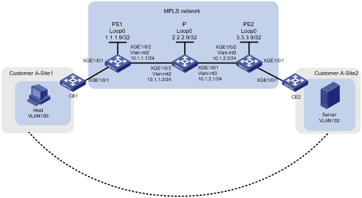

Figure 4 Network diagram
Analysis
To use LDP PWs to implement MPLS L2VPN, configure two levels of labels:
·          Inner labelsPW labels dynamically generated by LDP.
To identify packets to be transported by MPLS L2VPN, configure service instances and match criteria on the CE-facing ports of PEs.

# Display L2VPN PW information on PE 1. The output shows that two LDP PWs have been established.
3.3.3.9         100        65663/65663     LDP    M     1          Up
3.3.3.9         200        65662/65662     LDP    M     1          Up
# Display L2VPN PW information on PE 2. The output shows that two LDP PWs have been established.
1.1.1.9         100        65663/65663     LDP    M     1          Up
1.1.1.9         200        65662/65662     LDP    M     1          Up
# Verify that the host and the server in the same VLAN can ping each other. (Details not shown.)

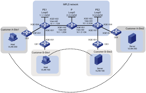

As shown in Figure 5, a customer has two VPN sites and will add eight sites in the future. Configure a BGP PW between PE 1 and PE 2 to allow VPN communication between the two sites and reserve enough VPN resources for future extension.
Figure 5 Network diagram
Analysis
To use BGP PWs to implement MPLS L2VPN, configure two levels of labels:
·          Inner labelsPW labels dynamically generated by BGP.
To use BGP to transmit inner labels between PEs, create a service instance and an IBGP connection, and specify the peer PE as a BGP peer on each PE.
To simplify configuration required by future expansion of the customer network, set the maximum number of CEs in the VPN to 10.
Procedures
[P] vlan3
[P-vlan3] quit
# On P, configure an IP address for VLAN-interface 3.
[P] ospf
[P-ospf-1] area 0
[P-ospf-1] quit
<PE2> system-view
[PE2] vlan 3
[PE2-vlan3] quit
# On PE 2, configure an IP address for VLAN-interface 3.
[PE2] ospf
[PE2-ospf-1] area 0
[PE2-ospf-1] quit
# On PE 1, enable MPLS L2VPN and LDP globally.
[PE1] l2vpn enable
[PE1] mpls ldp
[PE1-ldp] quit
[P] mpls ldp
[P-ldp] quit
# On PE 2, enable MPLS L2VPN and LDP globally.
[PE2] l2vpn enable
[PE2] mpls ldp
[PE2-ldp] quit
3.        Establish IBGP connections between PEs:
# On PE 1, establish an IBGP connection to PE 2.
[PE1] bgp 100
[PE1-bgp] peer 3.3.3.9 as-number 100
[PE1-bgp] peer 3.3.3.9 connect-interface loopback 0
# On PE 1, enable BGP to exchange L2VPN information with PE 2.
[PE1-bgp] address-family l2vpn
[PE1-bgp-l2vpn] peer 3.3.3.9 enable
[PE1-bgp-l2vpn] quit
[PE1-bgp] quit
# On PE 1, create cross-connect group vpna, create local site site 1, and create a BGP PW from site 1 to the remote site site 2.
[PE1-xcg-vpna] auto-discovery bgp
[PE1-xcg-vpna-auto] route-distinguisher 2:2
[PE1-xcg-vpna-auto] vpn-target 2:2 export-extcommunity
[PE1-xcg-vpna-auto] vpn-target 2:2 import-extcommunity
[PE1-xcg-vpna-auto] site 1 range 10 default-offset 0
[PE1-xcg-vpna-auto-1] connection remote-site-id 2
# On PE 1, bind service instance 100 on Ten-GigabitEthernet 1/0/1 to the PW.
[PE1-xcg-vpna-auto-1-2] ac interface Ten-GigabitEthernet 1/0/1 service-instance 100
[PE1-xcg-vpna-auto-1-2] return
# On PE 2, establish an IBGP connection to PE 1.
[PE2] bgp 100
[PE2-bgp] peer 1.1.1.9 as-number 100
[PE2-bgp] peer 1.1.1.9 connect-interface loopback 0
# On PE 2, enable BGP to exchange L2VPN information with PE 1.
[PE2-bgp] address-family l2vpn
[PE2-bgp-l2vpn] peer 1.1.1.9 enable
[PE2-bgp-l2vpn] quit
[PE2-bgp] quit
# On PE 2, create cross-connect group vpna, create local site site 2, and create a BGP PW from site 2 to the remote site site 1.
[PE2-xcg-vpna] auto-discovery bgp
[PE2-xcg-vpna-auto] route-distinguisher 2:2
[PE2-xcg-vpna-auto] vpn-target 2:2 export-extcommunity
[PE2-xcg-vpna-auto] vpn-target 2:2 import-extcommunity
[PE2-xcg-vpna-auto] site 2 range 10 default-offset 0
[PE2-xcg-vpna-auto-2] connection remote-site-id 1
# On PE 2, bind service instance 100 on Ten-GigabitEthernet 1/0/1 to the PW.
[PE2-xcg-vpna-auto-2-1] ac interface Ten-GigabitEthernet 1/0/1 service-instance 100
[PE2-xcg-vpna-auto-2-1] return
<CE1> system-view
[CE1] vlan 100
[CE1-vlan100] quit
# Display L2VPN PW information on PE 1. The output shows that a BGP PW has been established.
<PE1> display l2vpn pw
Total number of PWs: 1, 1 up, 0 blocked, 0 down, 0 defect
3.3.3.9         2                 65538/65537     BGP     M     1        Up
# Display L2VPN PW information on PE 2. The output shows that a BGP PW has been established.
<PE2> display l2vpn pw
1.1.1.9         1                 65537/65538     BGP     M     1        Up
# Verify that the host and the server can ping each other. (Details not shown.)
Configuration files
·          CE 1 and CE 2:
 vlan 100
interface Ten-GigabitEthernet1/0/1
 port trunk permit vlan 1 100
·          PE 1:
ospf 1
 area 0.0.0.0
 mpls lsr-id 1.1.1.9
vlan 2
mpls ldp
 l2vpn enable
interface LoopBack0
 ip address 1.1.1.9 255.255.255.255
interface Vlan-interface2
 mpls enable
 mpls ldp enable
 port link-mode bridge
interface Ten-GigabitEthernet1/0/2
 port access vlan 2
bgp 100
 peer 3.3.3.9 connect-interface LoopBack0
  peer 3.3.3.9 enable
xconnect-group vpna
 auto-discovery bgp
    ac interface Ten-GigabitEthernet1/0/1 service-instance 100
·          P:
ospf 1
 area 0.0.0.0
 mpls lsr-id 2.2.2.9
vlan 2
vlan 3
mpls ldp
interface LoopBack0
 ip address 2.2.2.9 255.255.255.255
 ip address 10.1.1.2 255.255.255.0
 mpls enable
 mpls ldp enable
interface Vlan-interface3
 ip address 10.1.2.1 255.255.255.0
 mpls enable
 mpls ldp enable
 port access vlan 3
 port access vlan 2
·          PE 2:
ospf 1
 area 0.0.0.0
 mpls lsr-id 3.3.3.9
vlan 3
mpls ldp
 l2vpn enable
interface LoopBack0
 ip address 3.3.3.9 255.255.255.255
 ip address 10.1.2.2 255.255.255.0
 mpls enable
 mpls ldp enable
 port access vlan 3
bgp 100
 peer 1.1.1.9 connect-interface LoopBack0
  peer 1.1.1.9 enable
xconnect-group vpna
 auto-discovery bgp
Related documentation
·          H3C S10500 Switch Series MPLS Command Reference-R757X
·          H3C S10500 Switch Series MPLS Configuration Guide-R757X
