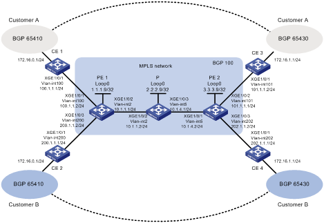

As shown in Figure 1, configure MPLS L3VPN to allow communication between different sites of a customer and to isolate different customers.
Figure 1 Network diagram
Analysis
To generate inner labels, and deliver VPN routing information to the remote PE, configure MP-BGP peers between PEs.
To generate outer labels to tunnel the VPN packets over the MPLS backbone, configure a routing protocol and MPLS LDP on the MPLS backbone.
To identify routing information for different customers on PEs, perform the following tasks on each PE:
·          Create a VPN instance for each customer.
·          Configure an RD and route targets for each VPN instance.
·          Redistribute internal routes of each site to the corresponding VPN instance.
Associating an interface with a VPN instance deletes the IP address of the interface. You must reconfigure the interface's IP address after the association.

1.        Configure OSPF on the MPLS backbone to ensure IP connectivity within the backbone:
# On PE 1, configure IP addresses for the loopback interface and the core-facing interface.
<PE1> system-view
[PE1] interface loopback 0
[PE1-LoopBack0] ip address 1.1.1.9 32
[PE1-LoopBack0] quit
[PE1] vlan 2
[PE1-vlan2] port ten-gigabitethernet 1/0/2
[PE1-vlan2] quit
[PE1] interface vlan-interface 2
[PE1-Vlan-interface2] ip address 10.1.1.1 24
[PE1-Vlan-interface2] quit

3.        Configure VPN instances on PEs to allow CE access:
# On PE 1, create VPN instance customerA for Customer A.
[PE1] ip vpn-instance customerA
# On PE 1, configure the RD as 100:1 for the VPN instance.
[PE1-vpn-instance-customerA] route-distinguisher 100:1
# On PE 1, specify the import target as 111:1 and the export target as 222:1 for the VPN instance. You can configure the same value for both the import and export targets to simplify management.
[PE1-vpn-instance-customerA] vpn-target 111:1 import-extcommunity
[PE1-vpn-instance-customerA] vpn-target 222:1 export-extcommunity
[PE1-vpn-instance-customerA] quit
# On PE 1, create VPN instance customerB for Customer B.
[PE1] ip vpn-instance customerB
# On PE 1, configure the RD as 200:1 for the VPN instance.
[PE1-vpn-instance-customerB] route-distinguisher 200:1
# On PE 1, specify the import target and export target for the VPN instance as 333:1 and 444:1.
[PE1-vpn-instance-customerB] vpn-target 333:1 import-extcommunity
[PE1-vpn-instance-customerB] vpn-target 444:1 export-extcommunity
[PE1-vpn-instance-customerB] quit
# On PE 1, associate VLAN-interface 100 with VPN instance customerA.
[PE1] vlan 100
[PE1-vlan100] port ten-gigabitethernet 1/0/1
[PE1-vlan100] quit
[PE1] interface vlan-interface 100
[PE1-Vlan-interface100] ip binding vpn-instance customerA
[PE1-Vlan-interface100] ip address 100.1.1.2 24
[PE1-Vlan-interface100] quit
# On PE 1, associate VLAN-interface 200 with VPN instance customerB.
[PE1] vlan 200
[PE1-vlan200] port ten-gigabitethernet 1/0/3
[PE1-vlan200] quit
[PE1] interface vlan-interface 200
[PE1-Vlan-interface200] ip binding vpn-instance customerB
[PE1-Vlan-interface200] ip address 200.1.1.2 24
[PE1-Vlan-interface200] quit

4.        Establish EBGP peer relationships between PEs and CEs, and redistribute VPN routes into BGP:
# On PE 1, create BGP process 100.
[PE1] bgp 100
# On PE 1, specify CE 1 as a peer and redistribute direct routes of CE 1 into the BGP routing table of VPN instance customerA.
[PE1-bgp-default] ip vpn-instance customerA

# On PE 1, specify CE 2 as a peer and redistribute direct routes of CE 2 into the BGP routing table of VPN instance customerB.
[PE1-bgp-default] ip vpn-instance customerB

# On PE 2, create BGP process 100.
[PE2] bgp 100
# On PE 2, specify CE 3 as a peer and redistribute direct routes of CE 3 into the BGP routing table of VPN instance customerA.
[PE2-bgp-default] ip vpn-instance customerA

# On PE 2, specify CE 4 as a peer and redistribute direct routes of CE 4 into the BGP routing table of VPN instance customerB.
[PE2-bgp-default] ip vpn-instance customerB

# Verify that a BGP peer relationship in Established state has been established between a PE and a CE.
[PE1] display bgp peer ipv4 vpn-instance customerA
 BGP local router ID: 1.1.1.9
 Local AS number: 100
 Total number of peers: 1                  Peers in established state: 1
  Peer                    AS  MsgRcvd  MsgSent OutQ PrefRcv Up/Down  State
  100.1.1.1            65410        4        4    0       2 13:35:25 Established

Configuration files
·          PE 1:
ospf 1
 area 0.0.0.0
  network 1.1.1.9 0.0.0.0
  network 10.1.1.0 0.0.0.255
 mpls lsr-id 1.1.1.9
vlan 2
vlan 100
vlan 200
mpls ldp
interface LoopBack0
 ip address 1.1.1.9 255.255.255.255
interface Vlan-interface2
 mpls enable
 mpls ldp enable
interface Vlan-interface100
 ip address 100.1.1.2 255.255.255.0
interface Vlan-interface200
 ip address 200.1.1.2 255.255.255.0
interface Ten-GigabitEthernet1/0/1
 port link-mode bridge
 port access vlan 100
interface Ten-GigabitEthernet1/0/2
 port access vlan 2
interface Ten-GigabitEthernet1/0/3
 port access vlan 200
bgp 100
 peer 3.3.3.9 as-number 100
 peer 3.3.3.9 connect-interface LoopBack0
 address-family vpnv4
  peer 3.3.3.9 enable
  peer 100.1.1.1 as-number 65410
  address-family ipv4 unicast
   import-route direct
   peer 100.1.1.1 enable
  peer 200.1.1.1 as-number 65410
   import-route direct
   peer 200.1.1.1 enable
·          P:
ospf 1
 area 0.0.0.0
  network 2.2.2.9 0.0.0.0
  network 10.1.4.0 0.0.0.255
 mpls lsr-id 2.2.2.9
vlan 2
vlan 5
mpls ldp
interface LoopBack0
 ip address 2.2.2.9 255.255.255.255
 ip address 10.1.1.2 255.255.255.0
 mpls enable
 mpls ldp enable
interface Vlan-interface5
 ip address 10.1.4.1 255.255.255.0
 mpls enable
 mpls ldp enable
 port access vlan 2
 port access vlan 5
·          PE 2:
 vpn-target 111:1 export-extcommunity
 vpn-target 222:1 import-extcommunity
 vpn-target 333:1 export-extcommunity
 vpn-target 444:1 import-extcommunity
ospf 1
 area 0.0.0.0
  network 3.3.3.9 0.0.0.0
 mpls lsr-id 3.3.3.9
vlan 5
vlan 101
vlan 202
mpls ldp
interface LoopBack0
 ip address 3.3.3.9 255.255.255.255
 ip address 10.1.4.2 255.255.255.0
 mpls enable
 mpls ldp enable
interface Vlan-interface101
 ip address 101.1.1.1 255.255.255.0
interface Vlan-interface202
 ip address 202.1.1.2 255.255.255.0
 port access vlan 5
 port access vlan 101
 port access vlan 202
bgp 100
 peer 1.1.1.9 as-number 100
 peer 1.1.1.9 connect-interface LoopBack0
  peer 1.1.1.9 enable
  peer 101.1.1.2 as-number 65430
   import-route direct
   peer 101.1.1.2 enable
  peer 202.1.1.1 as-number 65430
   import-route direct
   peer 202.1.1.1 enable
·          CE 1:
vlan 100
 ip address 100.1.1.1 255.255.255.0
bgp 65410
 peer 100.1.1.2 as-number 100
  import-route direct
  peer 100.1.1.2 enable
·          CE 2:
vlan 200
 ip address 200.1.1.1 255.255.255.0
bgp 65410
 peer 200.1.1.2 as-number 100
  import-route direct
  peer 200.1.1.2 enable
·          CE 3:
vlan 101
 ip address 101.1.1.2 255.255.255.0
bgp 65430
 peer 101.1.1.1 as-number 100
  import-route direct
  peer 101.1.1.1 enable
·          CE 4:
vlan 202
 ip address 202.1.1.1 255.255.255.0
bgp 65430
 peer 202.1.1.2 as-number 100
  import-route direct
  peer 202.1.1.2 enable
Related documentation
·          H3C S10500 Switch Series MPLS Command Reference-R757X
·          H3C S10500 Switch Series MPLS Configuration Guide-R757X
