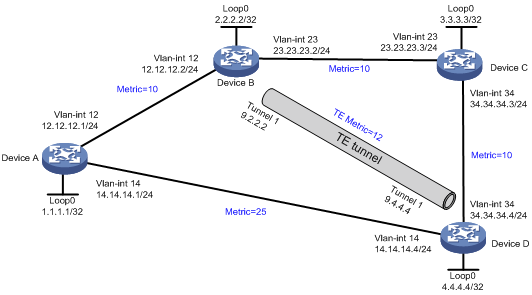

As shown in Figure 1, Device A, Device B, Device C, and Device D run OSPF.
Establish an MPLS TE tunnel from Device B to Device D that uses the path Device B—Device C—Device D, and configure MPLS TE forwarding adjacency for the tunnel.
Before the tunnel is established, traffic from Device A to Device D is forwarded through the direct link Device A—Device D. After the tunnel is established, the traffic is forwarded through the MPLS TE tunnel.
Figure 1 Network diagram
Analysis
·          To make forwarding adjacency take effect, you must establish two MPLS TE tunnels in opposite directions between Device B and Device D, and enable forwarding adjacency on both devices.
·          For the MPLS TE tunnel to use the path Device B—Device C—Device D, configure the path as the explicit path for the tunnel.
·          For traffic from Device A to Device D to be forwarded through the MPLS TE tunnel, make sure the tunnel's metric is less than 15 (metric 25 minus 10). This example uses 12.
